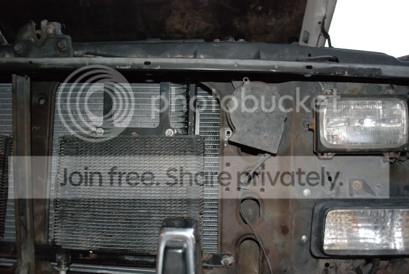

On my "direct replacement" there was a 3 inch difference or so. I did have to use the old mounts but fitting them wasn't a challenge. Take a look:
So it is full-width or does it leave a gap like the picture above? If it is truly parallel flow, the same size as the original giant tube and fin, mounts without mods and has the same fittings on it for $77, that is the mother-lode and we should all be swapping to one when it's time for A/C work.
