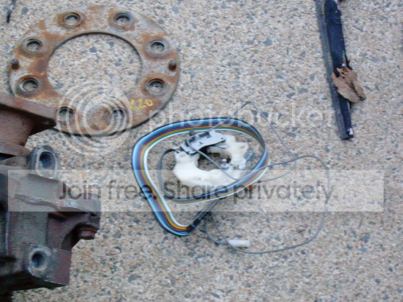

BIGBLAZE433 said:
Not sure what either of these things are:confused:
The circle thingy is for like on a duallyit goes over the wheel then you put on lugnuts.
