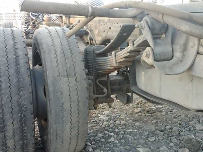

Is there seriously only 2 leafs plus the add a leaf in that rear pack? :eek1:
My 95 donor truck was the same way :dunno:, in comparison my 00 has some monster packs under it with the multiple leaf over load/ helper spring set up.
thats ghay. I guess my 12v trucks never stayed together long enough for me to notice....... :doah:
but seriously thats ghay.............. I say start stacking leafs.
.........I've got the F450 rear leafs in my garage still from that '06 I stripped. man it makes that look like a 1986 chevy Malibu rear pack. just sayin :whistle:
Yeah it's a concern. I think there is actually 3
I was thinking either an add a leaf or going to find some 3500 springs
what the plan there?
My '94 is the same exact way and I'm concerned about it as well. I love how smooth it rides but I think once I get some tongue weight on my trailer it's going to hate life.
My plan is bags, that way I can keep the smooth ride but add the bags in when I need them. Might be an option for you too howdiy. Plus it gives you an excuse to add some OBA. :waytogo:

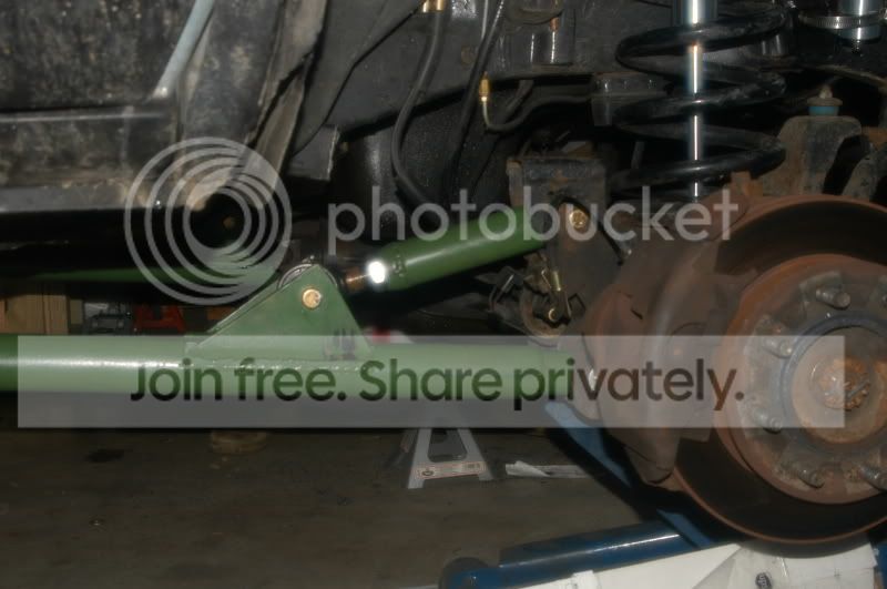

The kits are nice for a package deal but if you're patient '92-'96 SRW F350 knuckles out fit the stock dodge C's which gives you the same thing as the kits but cheaper.
If you click the link I posted, there is a guy that used his dodge knuckles with re drilled d50 stuff.
It seems like everything should be relatively easy to make, just going to be a decent amount for the bushings. I'm not sure what I want to run for the big back joint yet.
Track bar seems like it could be a PITA but I'm not sure because I saw a kit with a straight one.
Upper buckets should be a little tricky, I think I'm going to have to have some stuff cnc cut.
Weld on panhard mount like this
If I use some beef material I should be able to bend it if necessary with my poo pipe kinker
Radius arms, probably around 40" I want to keep the mount where the frame is still boxed
Radius big joint at the Frame. Evolution machine & fabrication Frankenheim. No question there.
