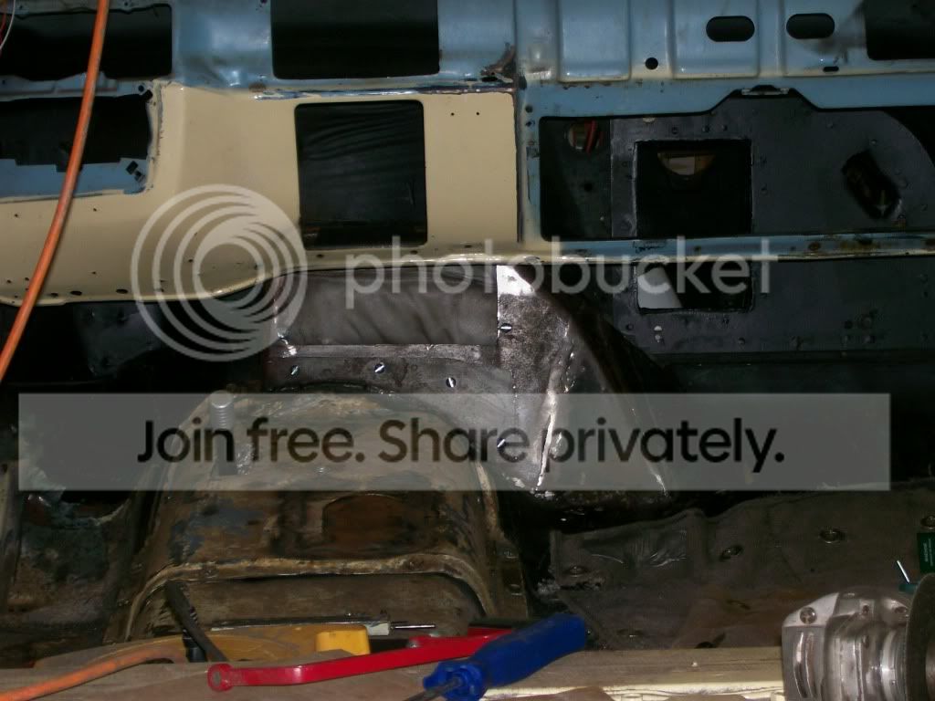

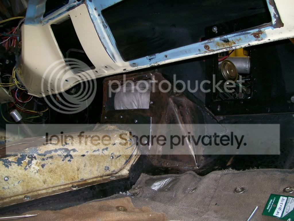

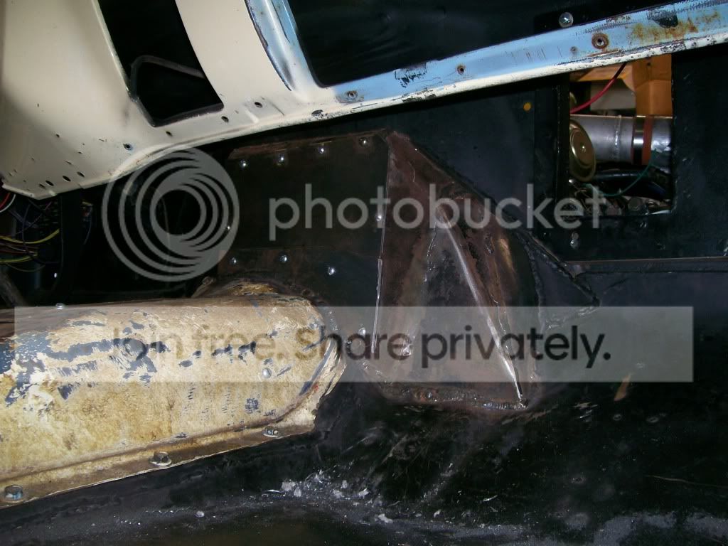

The covering for the exhaust in the cab is not finished. I will covering with 1/8" plate and insulating with heat blankets. I just need to finish mocking it up, and it's a factory 6.5 not 6.2 but close enough I guess;)
o.k. I was just interested, because the stock fire wall is pretty thin and that manifold would put off a ton of heat. I hope your plan works well.

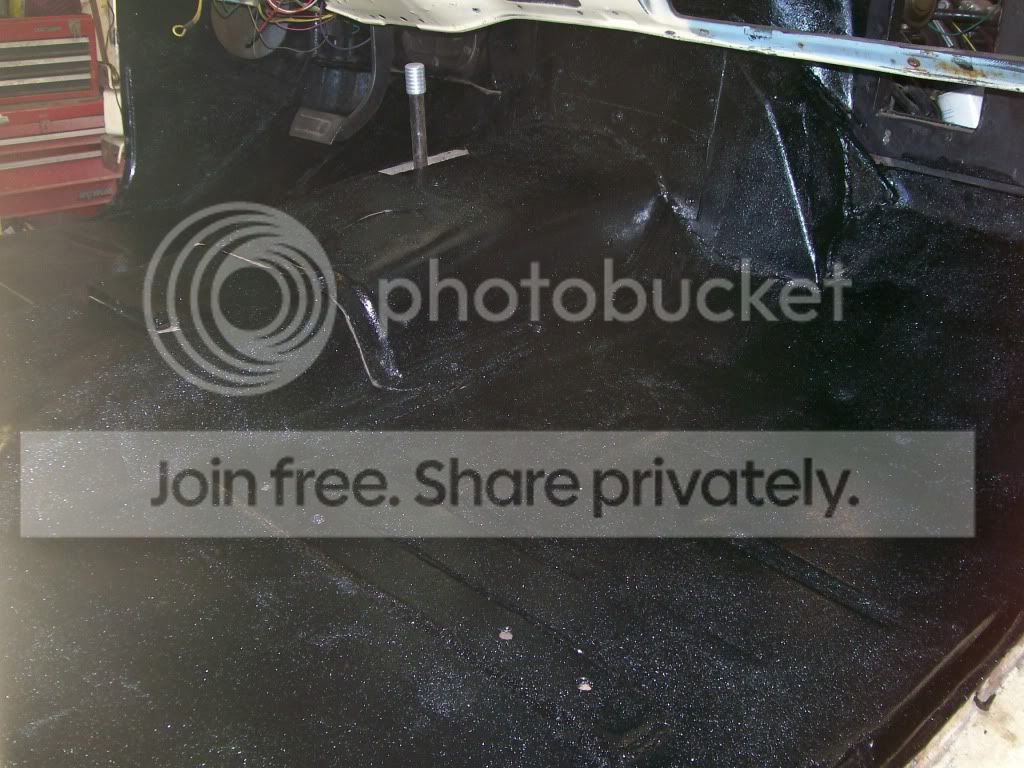

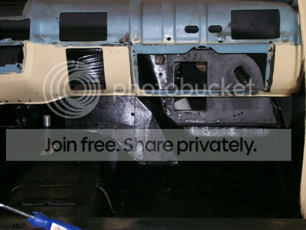

Finished the cover, paint and hurculiner.

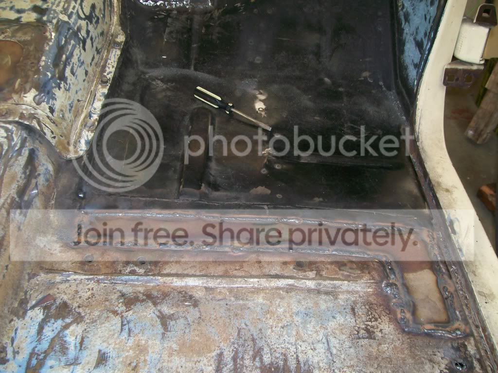

tried plugging some holes but the sheet metal was so rusted it just blew out. I cut it out and patched in some 14guage
damn, someone's been getting some work done.:waytogo:
