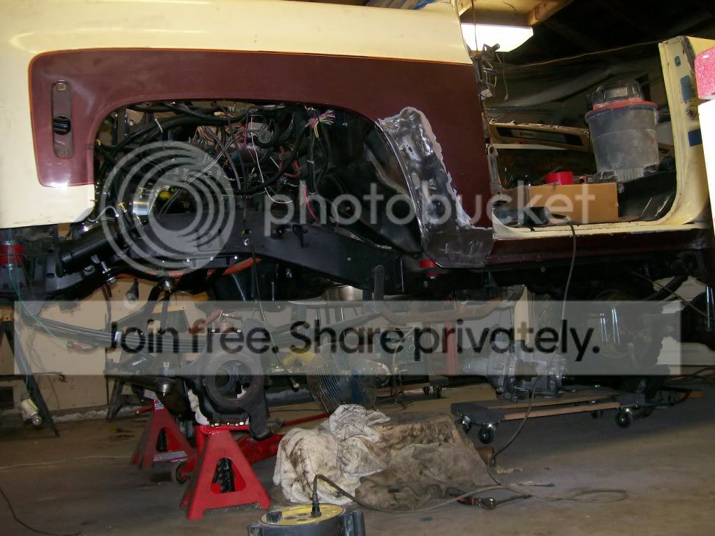

Project K-1 build, 75 jimmy gets the H-1 transplant

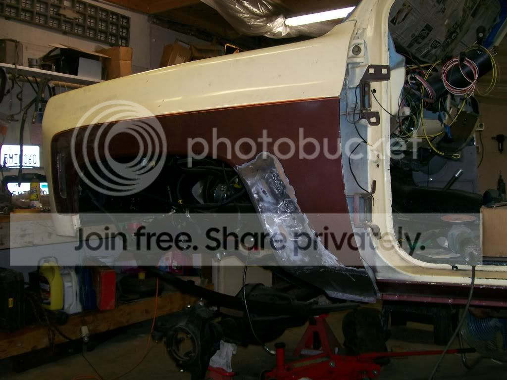

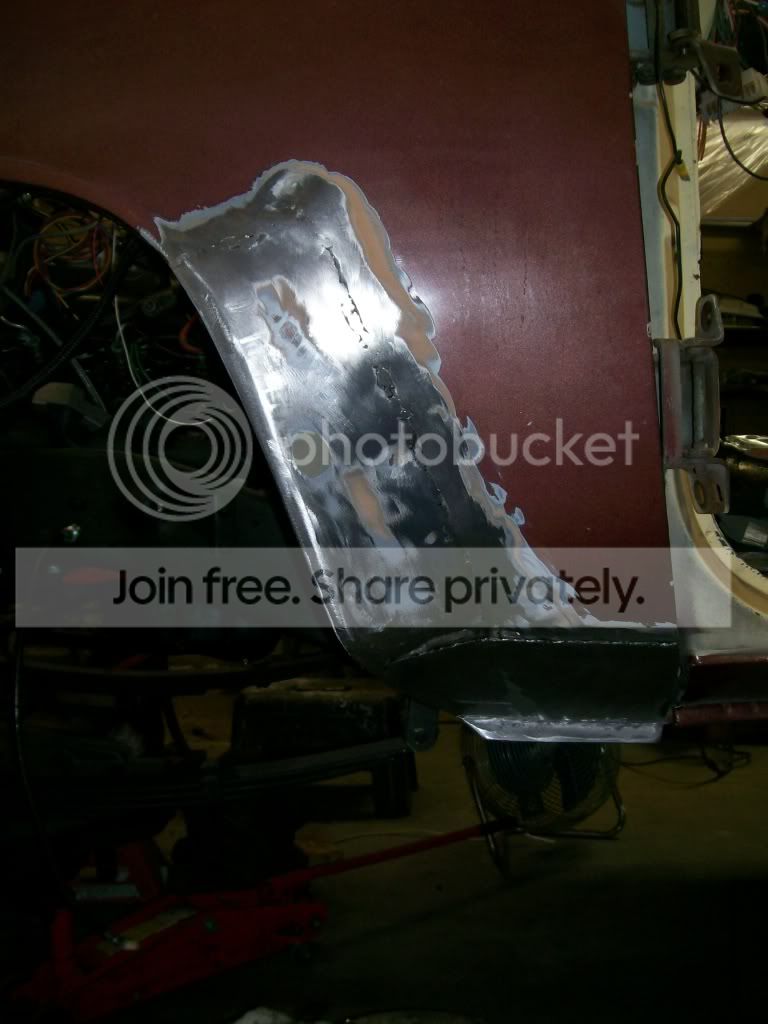

Sanded the crap out of it and fine tuned a little bit..
did you weld the whole joint at once? i see a lot of distortion in the metal. usually thats caused by excessive heat. you should generally spread out the heat load, kind of similar to torquing down a cylinder head. you do it in steps and in a sequence, in a manner that you don't warp it out.
How many HOURS do you have in that one side did you do a mock up with tires and suspension compression.
Well if you look closely you'll see the thick layer of bondo that was used to cover the whole warped ****nessed of the factory sheet metal!! welding this **** is like welding aluminum foil..
I stiched it where it would hold until a crater popped up. you should know that you remember welding the floor panel!!
I went to sand off the bondo on the bottom of the fender and it went all the way through!! the entire bottom was held together with bondo!!:haha:
Hence the 14 gauge overlay.

it was probably 2-3hrs chopped and welded up and an hour sanding. I was really just messing around with a rusted out fender so if it doesn't work I'll just make another set!!
I'm just doing retard **** for now while I'm poor :D
I need to get some 4.56 gears for it, and I would like upgrade the "neckdown" shafts and outers.
but I think bare minimum a regear and some new calipers and I could get it put together and on the road!!

I could not even tell what you did at first i had to go back and look at it. How much did you move the edge back?

you got it man:thumb: tell you what on the 2nd one I'll take some b4 and after pic with measurements..
