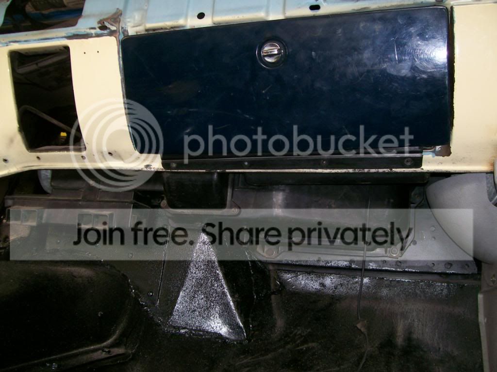

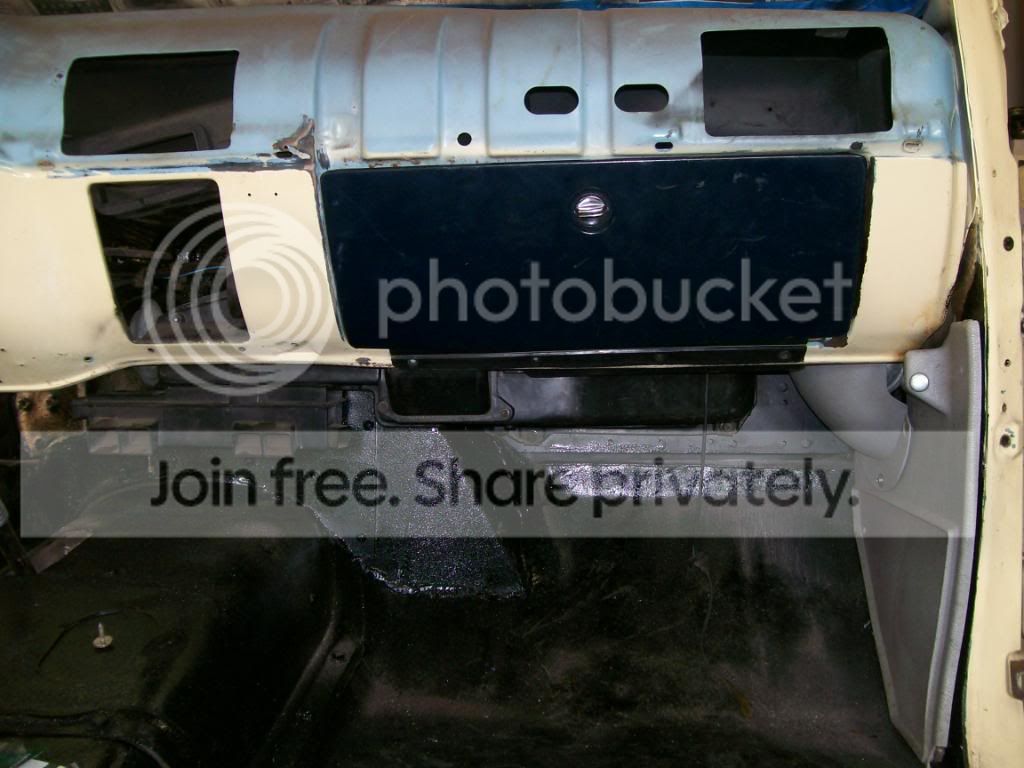

stoked on the liner!! it was easy peasy! I had melia help roll it out "she loves helping out dad"!!
sweet, it looks real nice in the pics. tell melia she did an awesome job.

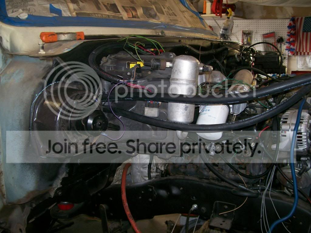

I went with the center mount turbo for a few reasons, the exhaust design is much less complicated "besides the firewall mods" helps spool the turbo quicker and provides the ability to use 3" pipe straight off the turbo.
Provides much easier access to the side of the motor for swaping fuel injectors, glow plugs and other mechanicals.
Gives me more room in the engine bay for dual batts, big honkin air intake canister and on board air set up.

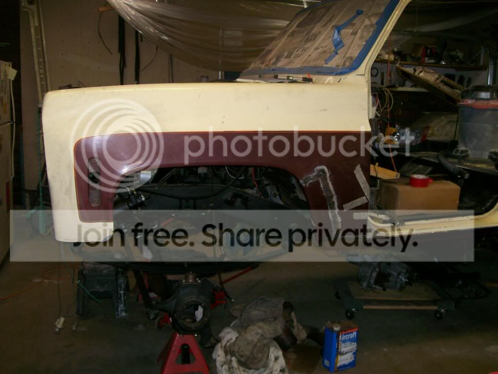

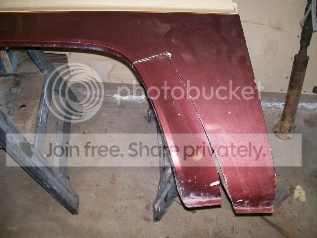

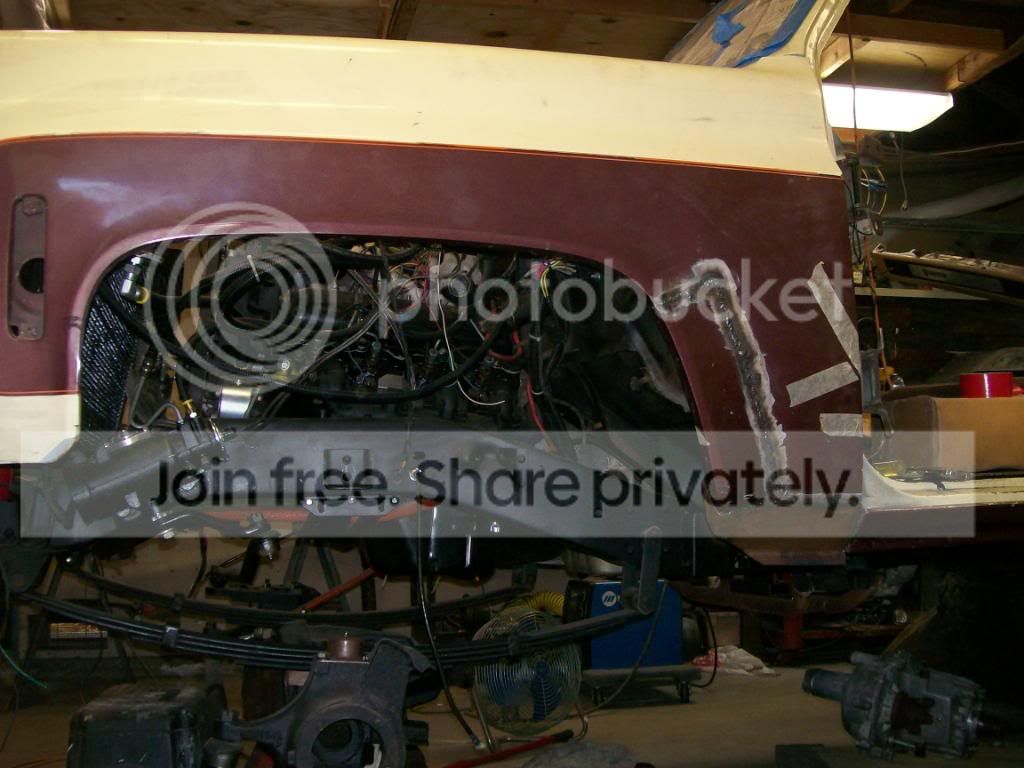

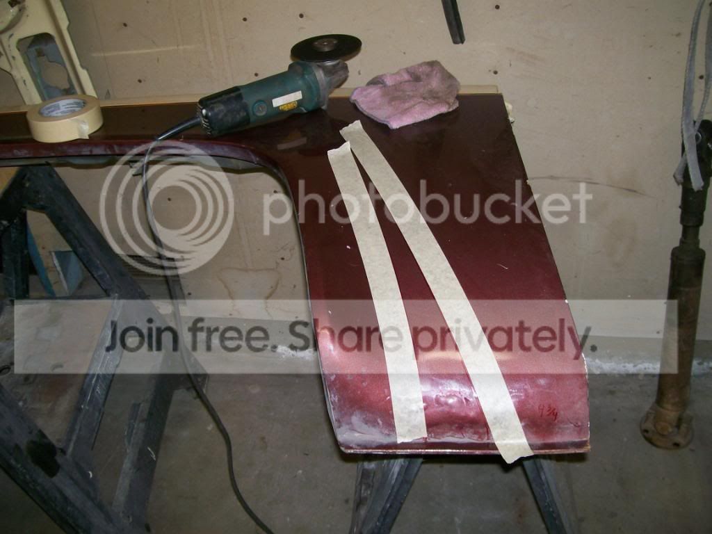

got to work on my fender chop "concept"
used some 14gauge steel to patch in the bottom, still ruff needs to be fine tuned but you get the basic concept
judging by where the tape was in the first pic, i'm guessing you gained about 2 inches of tire clearance towards the bottom of the fender?
Yup exactly 2" measuring 21 1/4" down from upper ridge line. I will trim the front a little more and 14guage plate the front lower ridge scroll detail about 1/3 of the way up.
The inner fender will need to be massaged or modified a little bit.
If I move the axle forward an inch and gain 2" high up in the rear of the front fender well, in theory I should be able stuff a tire roughly 5 inches larger in diameter? going from 35 to say 39"??
Notice the bubbles on the bottom of the fender! That's because the only thing holding it together was literaly about a 1/4" of bondo!!!
