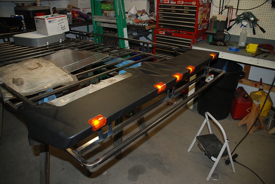

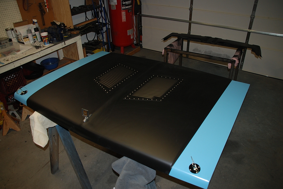

I like that idea. I might have to do that to my sub. Are you going to tape it off like that on your suburban too, so you dont really see it from the ground?
Thanks for the info. I've just added it to my list of to-do items on my Suburban Project. My Sub is always parked outside and so heat is always an issue. This elastomeric coating combined with the Dynamat I'm putting in should help out significantly.
Thanks for sharing
P.S. got this in the mail today
Aren't all of the UPS trucks done like that?
Martin
Almost everything that big has a white roof. All the motor coaches I've ever driven have had white roofs. I'm going to do this to my Yukon as well.

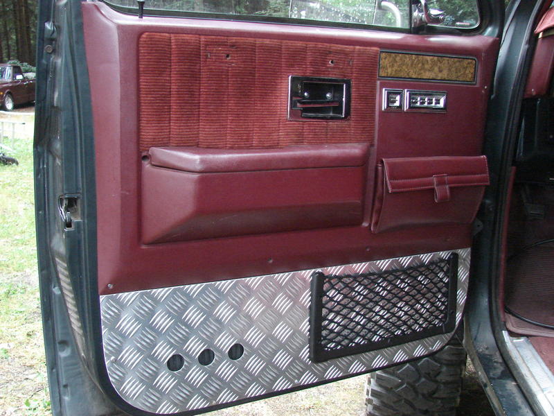

I have a whole 4x8 sheet of 16ga 5051 Aluminum sitting around doing nothing so I have decided to re do some of my door panels. Taking some ideas from this guy on the Expedition portal.
Windows still go up and down. its meant to be a hold it in place and roll window up but this guy and so will I fix it in place but still removable. If you look closely you will see the glass slips into a channel to secure the piece.

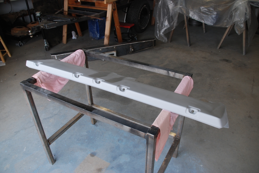

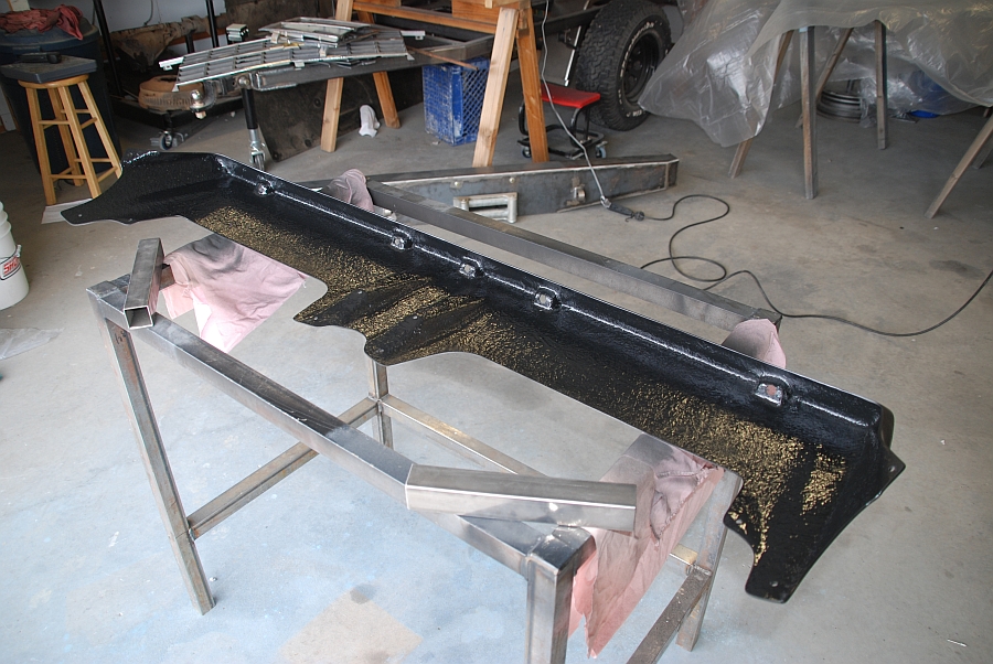

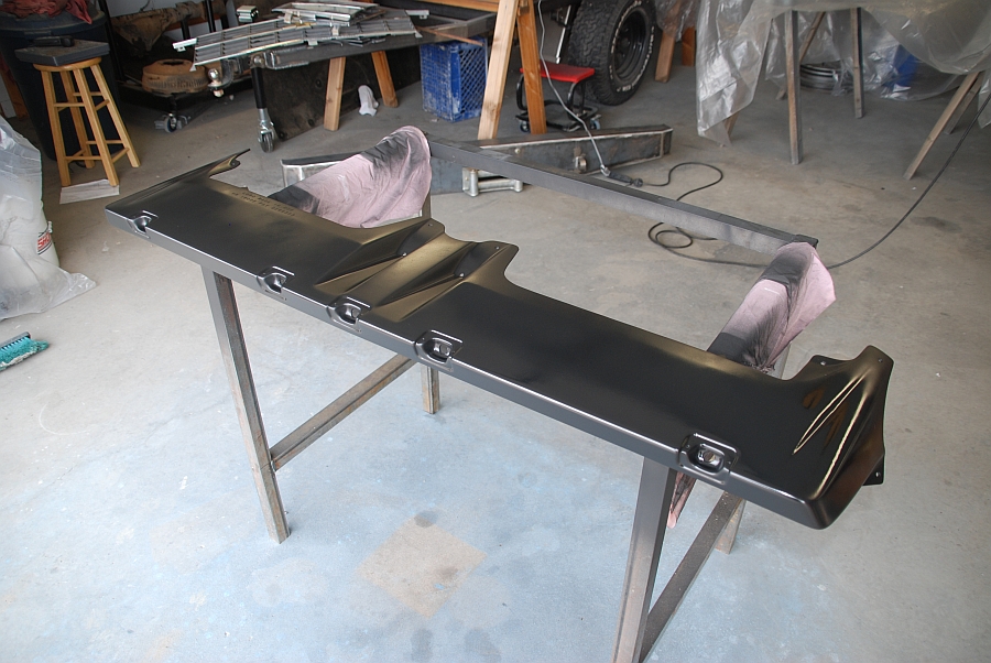

I hope to be painting the grille and Moonvisor this weekend.

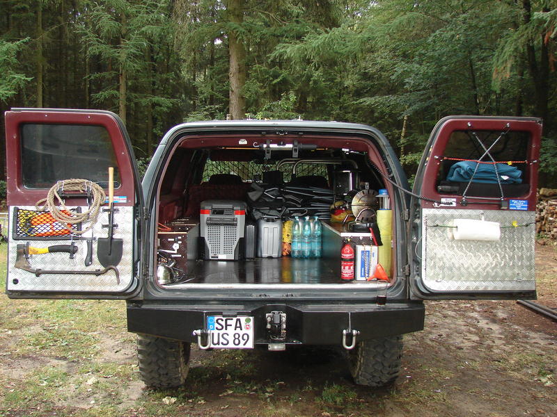

I am wondering what your final plans will be with the rear bumper. Ie: just adding the top part of the cherokee rear bumper you built? I need a rear bumper for the jimmy...but it seems no one will touch the most important part of the equasion...ie: tire carrier swing out...provisions for mounting high lift-shovel-axe-fuel cans-etc.

As for the rear bumper I am still bouncing around the idea between swing outs like on my Cherokee or on the doors. Why won't "no one touch it".
