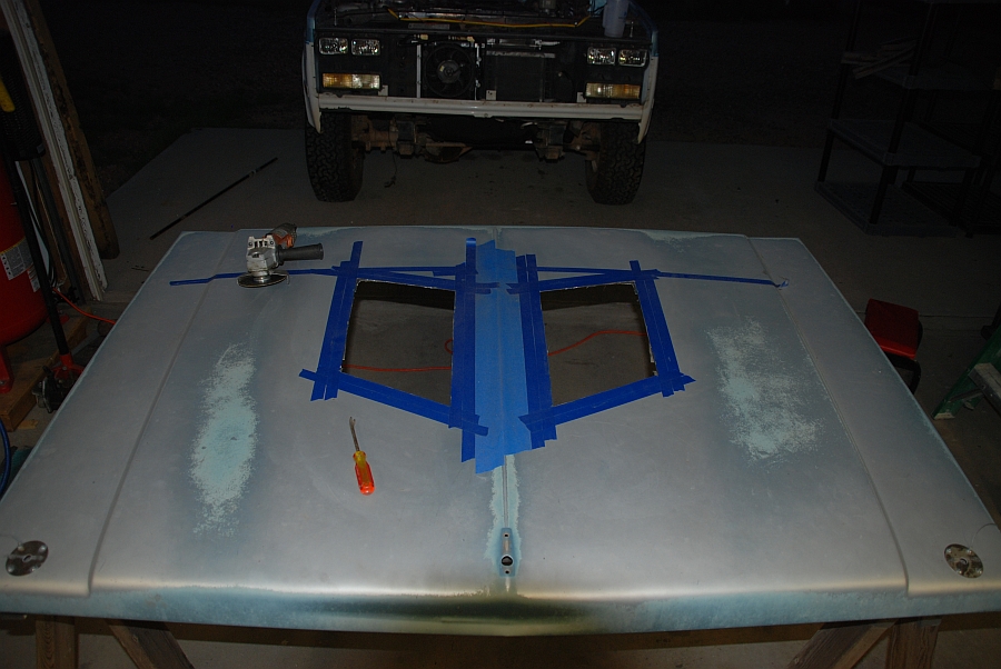

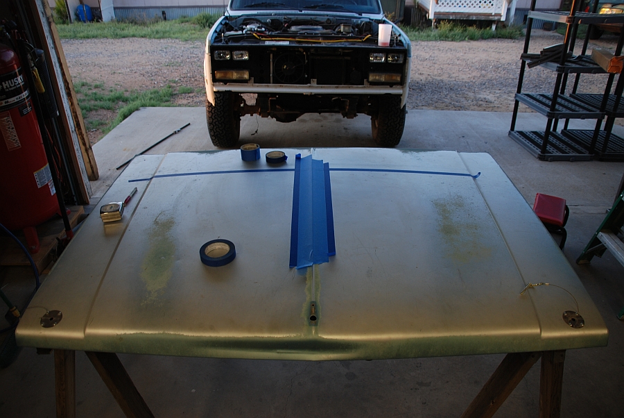

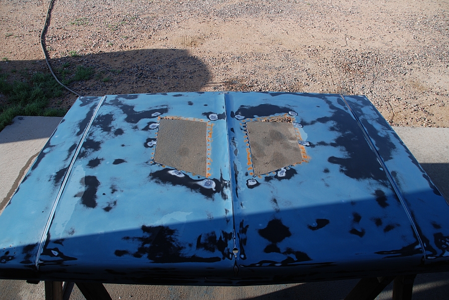

Hood Louvers going in.

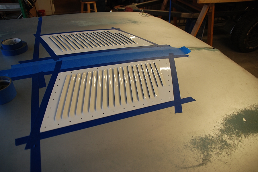

The mirrors. I guess I don't understand the vents either. Are you going to weld them in, or rivet them on?

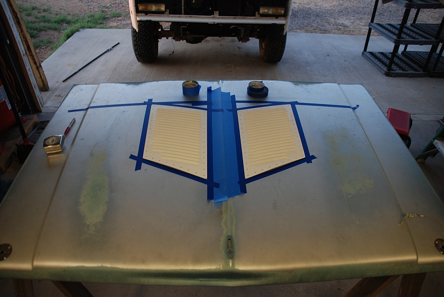

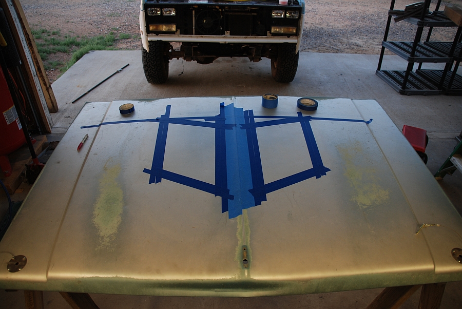

On the vents,

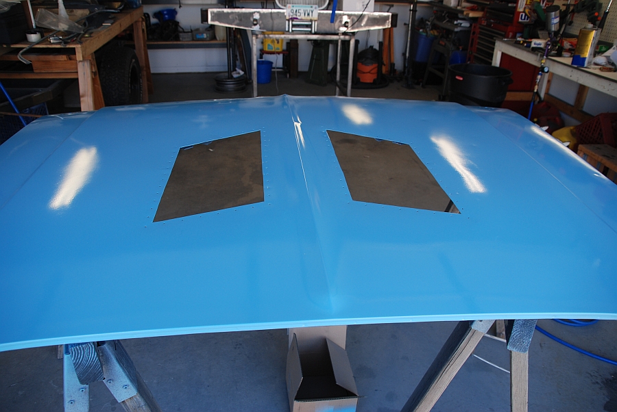

the vents will help keep the engine bay cooler and keep the engine from overheating. This is nothing new, I did them on my Cherokee and there is not even enough room for a mouse under a Cherokee hood. After I did that I could sit in traffic or on the trail with he A/C on and never overheat and that's in the Arizona summer. A cooler engine is a happier engine.
They are designed to be riveted in but I will be painting the hood and the vents and the rivets are powdercoated white to match the vents so I will use SS hardware instead.

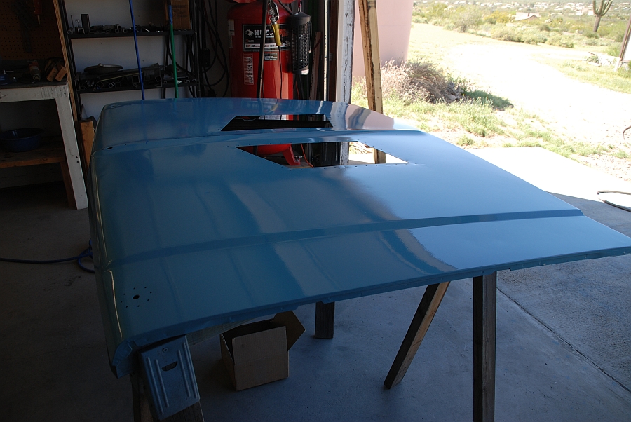

Well the body is off for paint and I am here wet-sanding the hood.:woot:NOT!
After that I have the Moon visor, grille, gutters, side mirrors and vents to sand. Oh...joy:eek1:

I want to do good louvers while mine is all apart. Where did you get those?
I got these in a trade but they are the XL size from hoodlouvers.com. I had actually ordered these and were in mid shipment when I got these in trade. So I sent those back.
