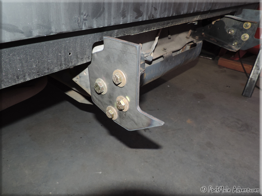

Also, what's with the 1" x 1" or so at the pinch weld? Is that to provide crush protection or just for mounting?
The 1x1 is for mounting the slider to the pinch seam. Then two legs attach at the frame. The 1x1 is welded to the slider itself. the slider now prevents the seam from being crushed.

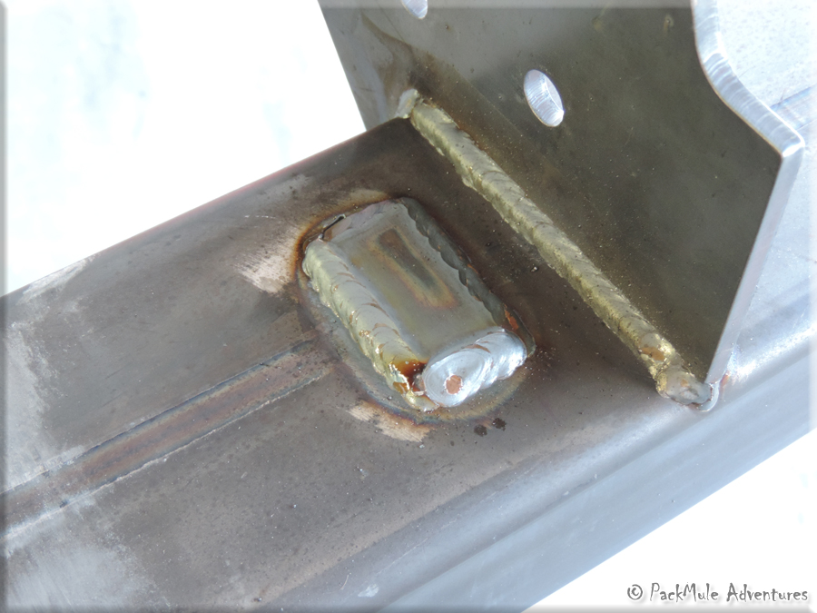

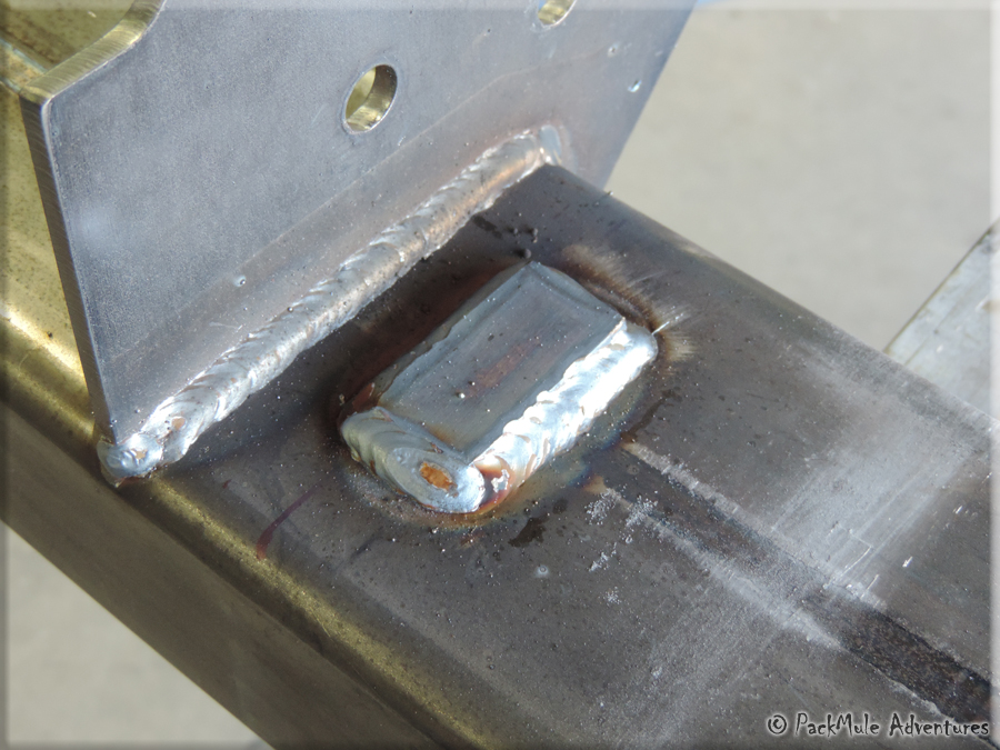

they look excellent on there, very well done Rob! the expanded sheetmetal actually looks really good. got any pics of the frame side? did the tabs just weld onto the frame or did you add some reinforcing?
The tabs are 1/4" thick I just welded them on straight. I will have more pics of these over the weekend.

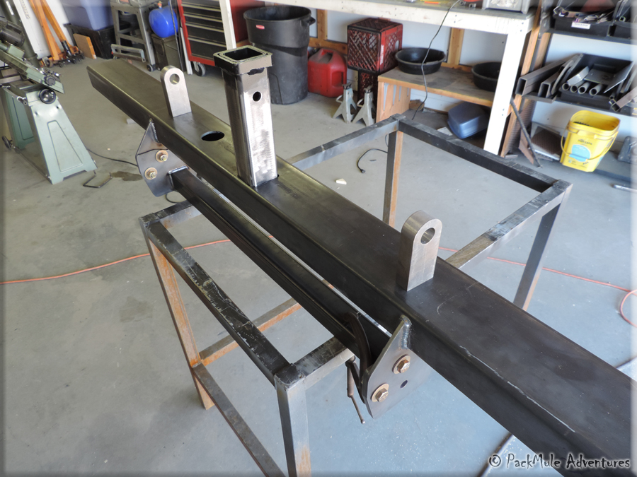

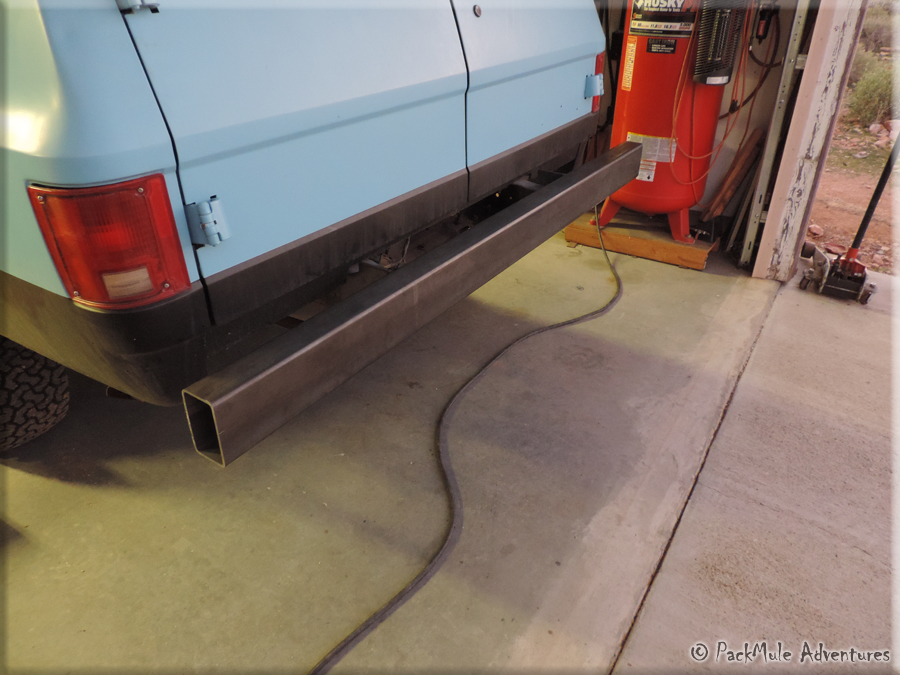

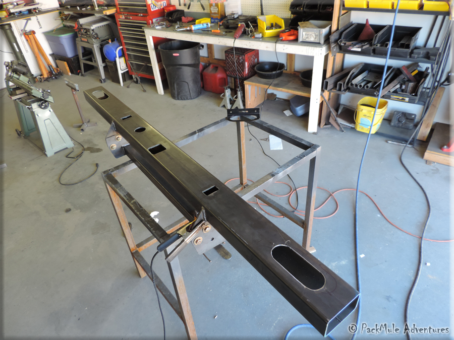

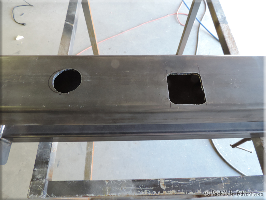

We decided to start on the new rear bumper. I am going with the traditional box iron. This will add the strength I need for the dual swing outs.

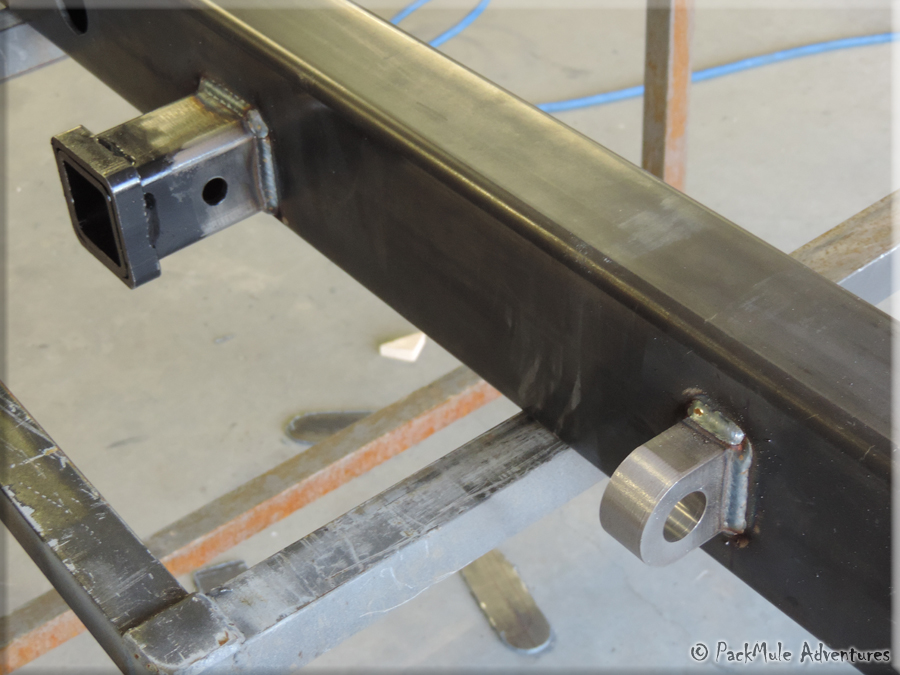

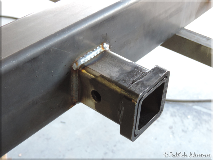

I decided to remove the Class 3 hitch from the frame as we will not be pulling anything that heavy. I will be adding a hitch into the bumper to pull our trailer.

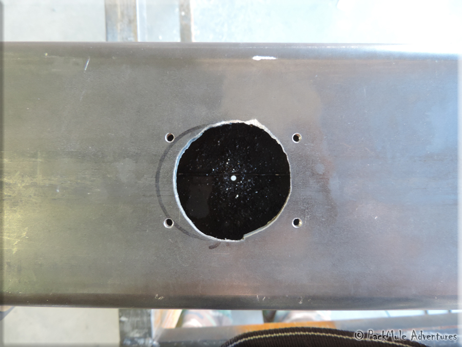

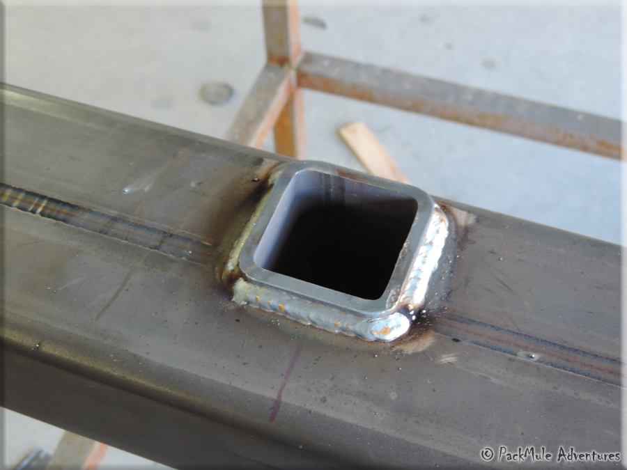

Main bumper section is done. I just need to weld in the spindle shafts at the bottom and then start building the swing out arms.
