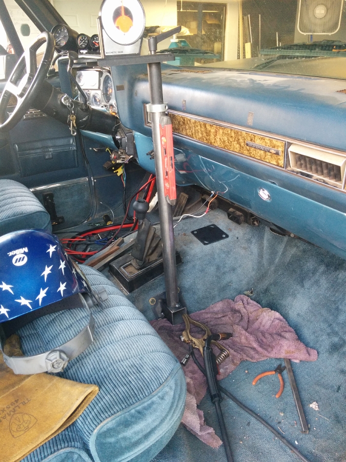

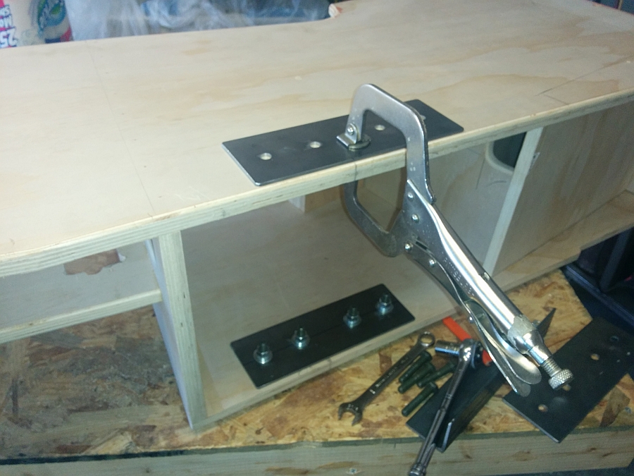

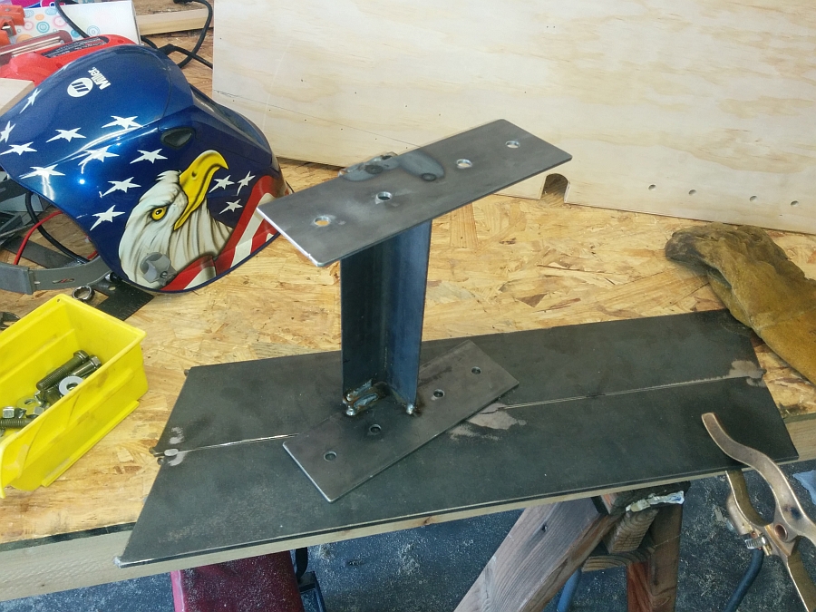

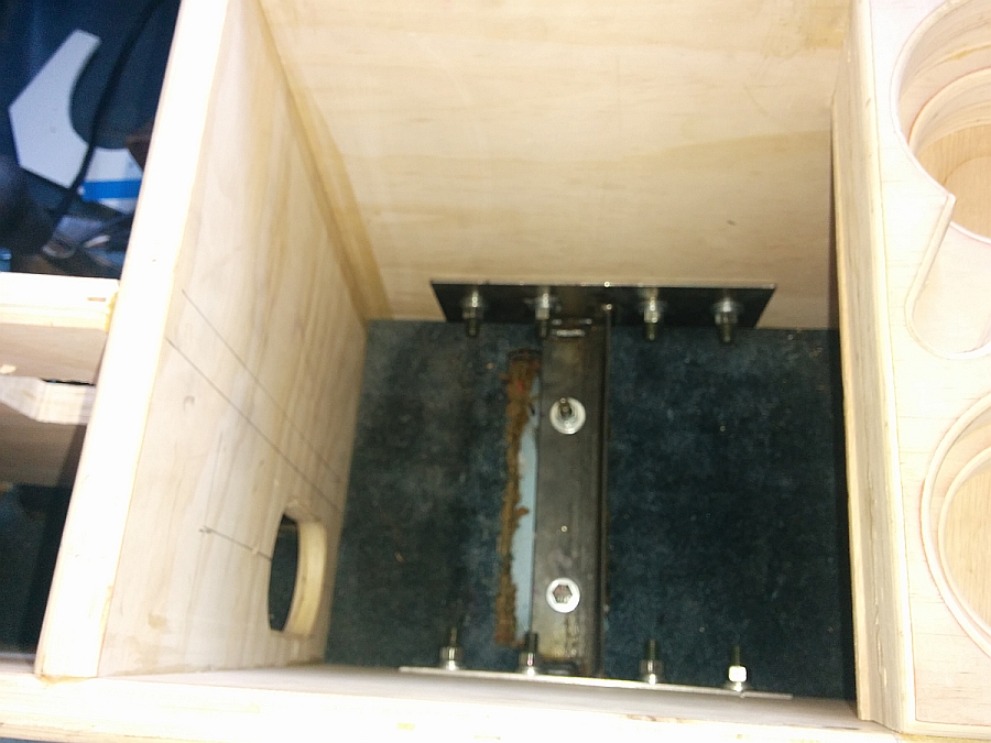

its 3"x5" with a 3/16" wall. It was a certain type of box iron that has (a more than normal) sharper corners so you get more flat surface area. The regular stuff has larger radius corners. I cant remember what it was called though

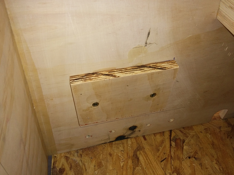

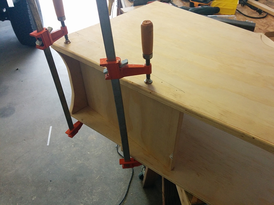

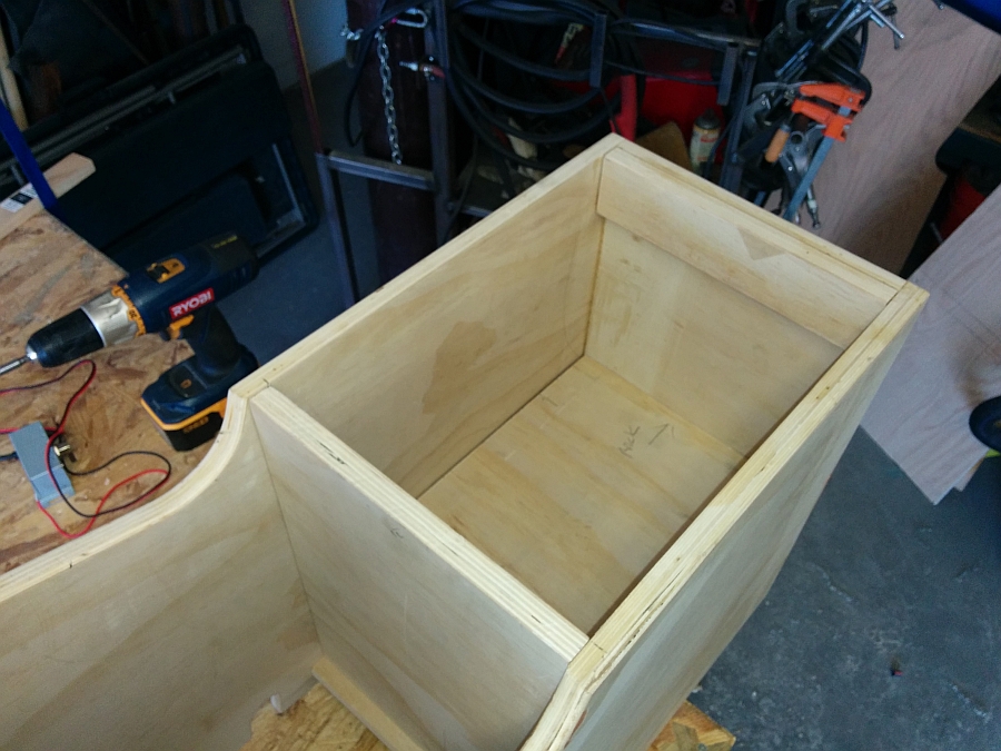

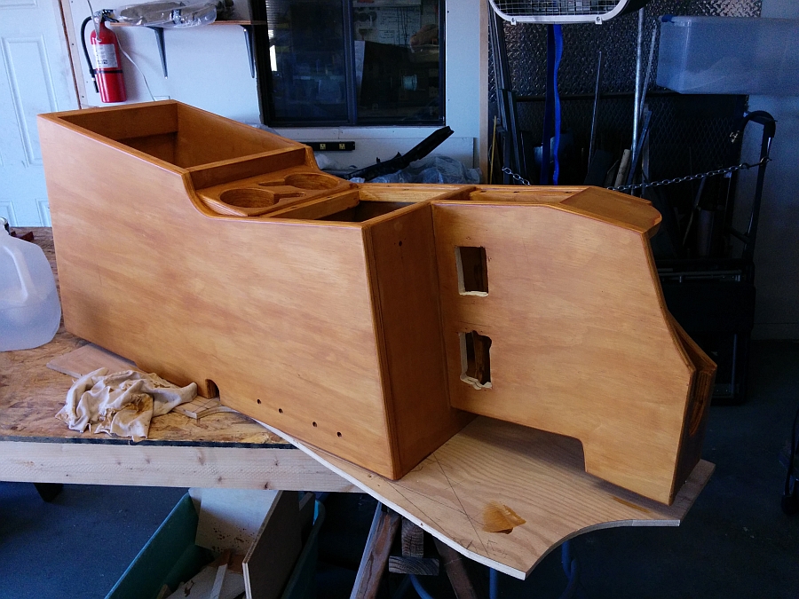

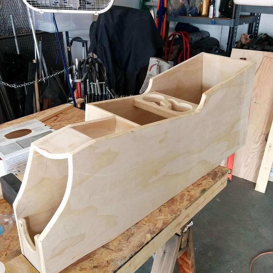

Quick shot update on the center console today.

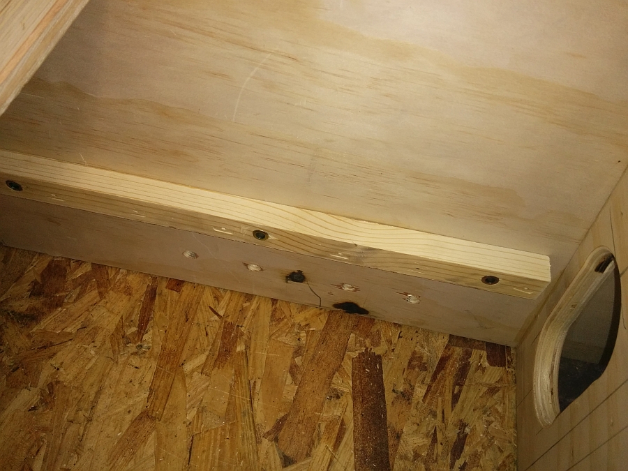

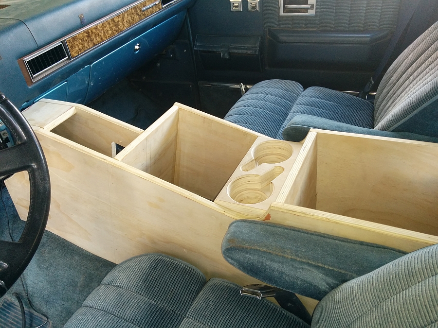

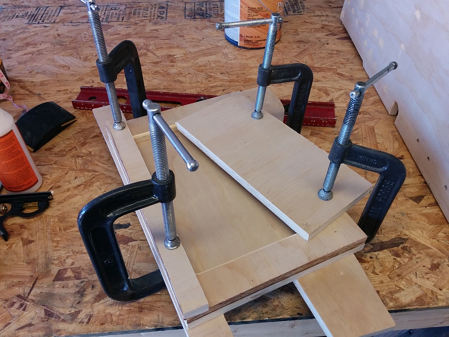

Here is some more for you Greg

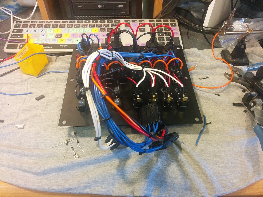

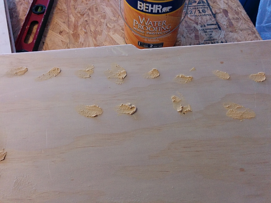

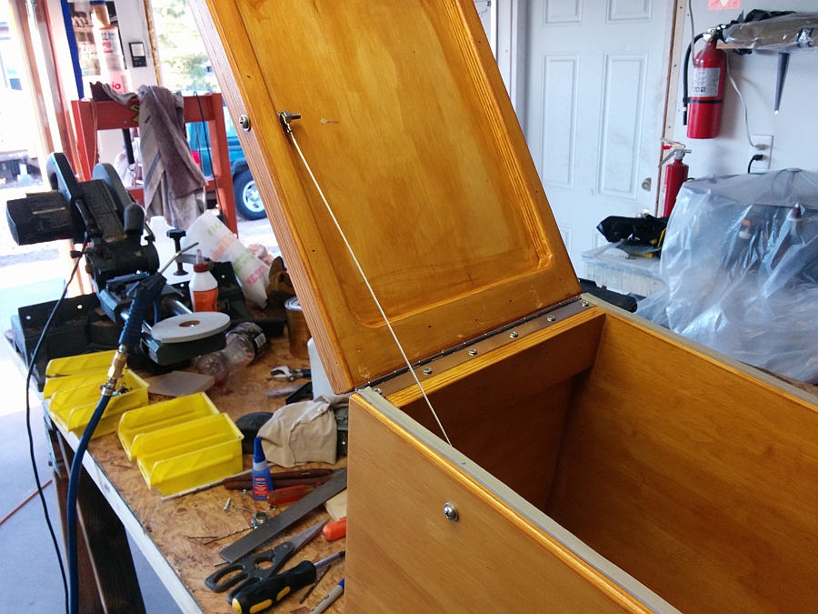

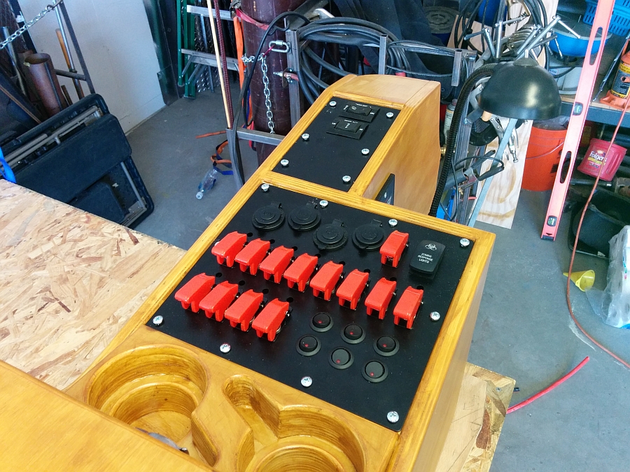

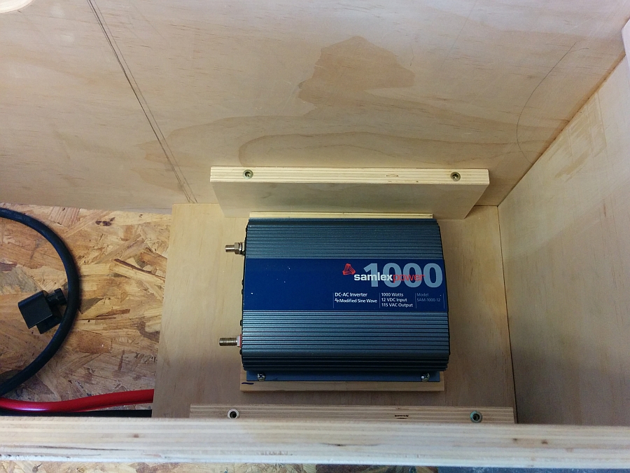

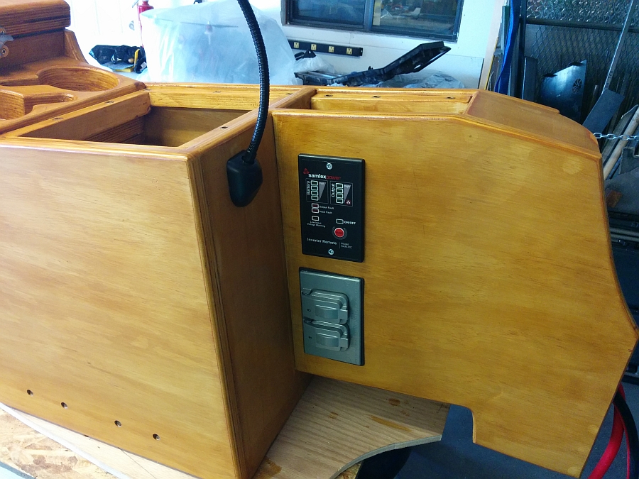

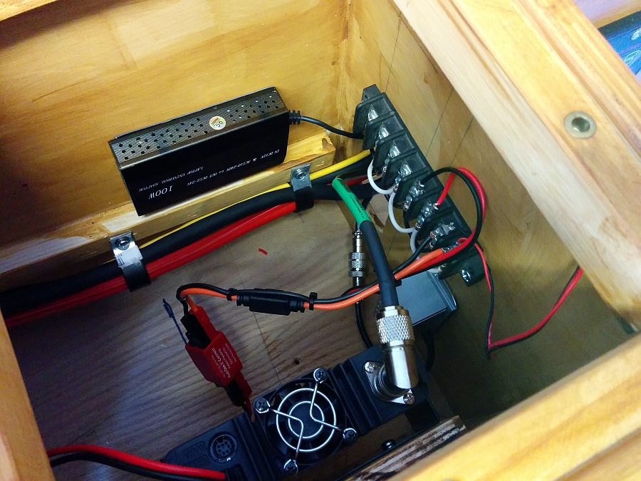

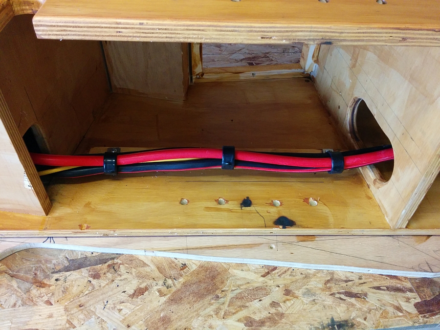

More on the console. Two coats of stain and two coats of polyurethane. Finally got to wiring today. 1000W inverter with remote panel and outlet wired. Map light installed.

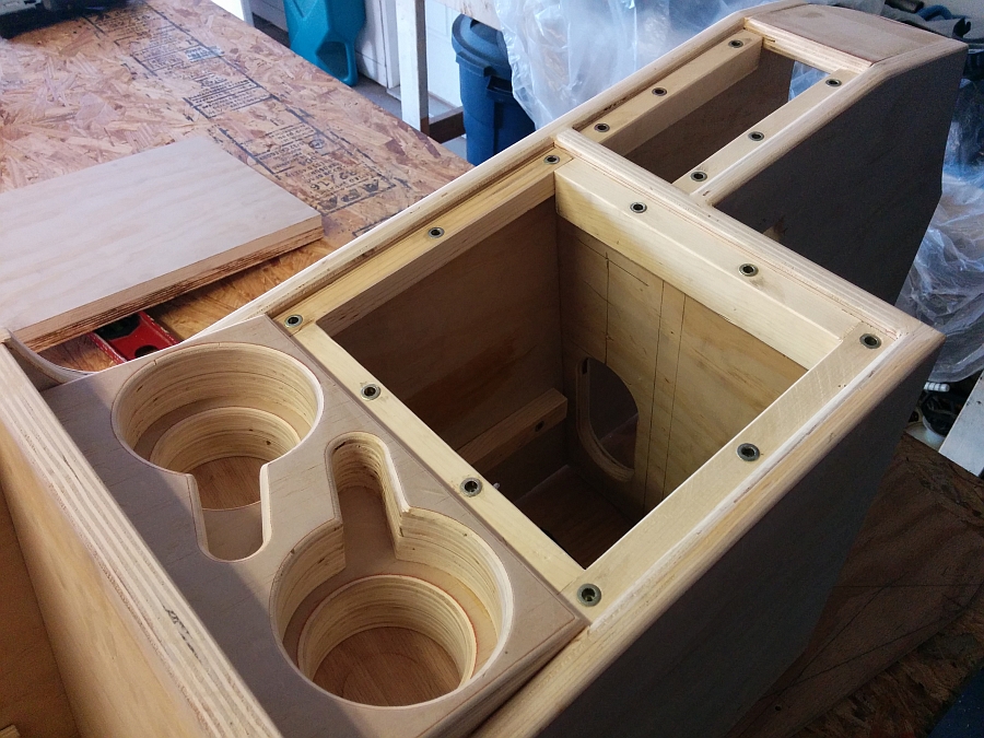

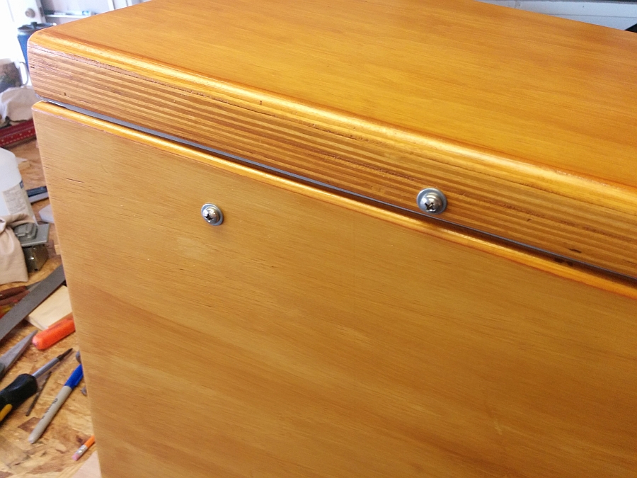

More on the Center console from the last few days. I was hoping to have the console in today but we are breaking rain records here and some are thinking of building arks its so bad. :eek1:

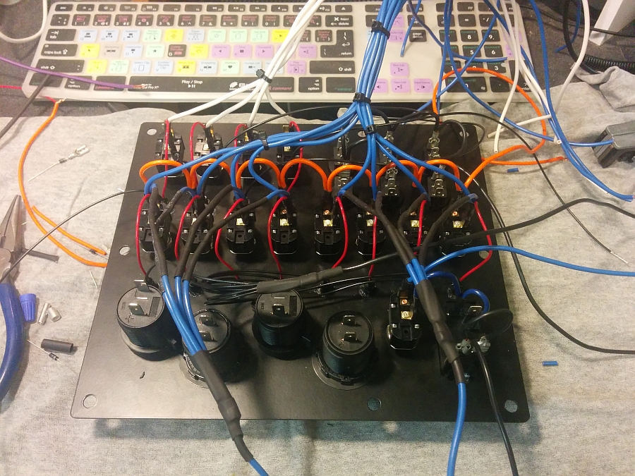

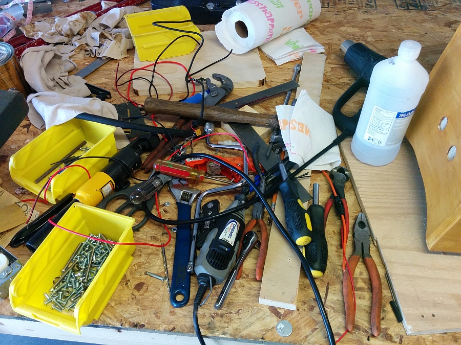

First time I have ever had, electrical tools, metal tools and wood tools out for the same project.

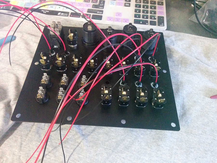

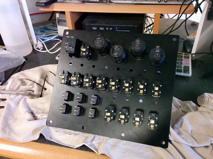

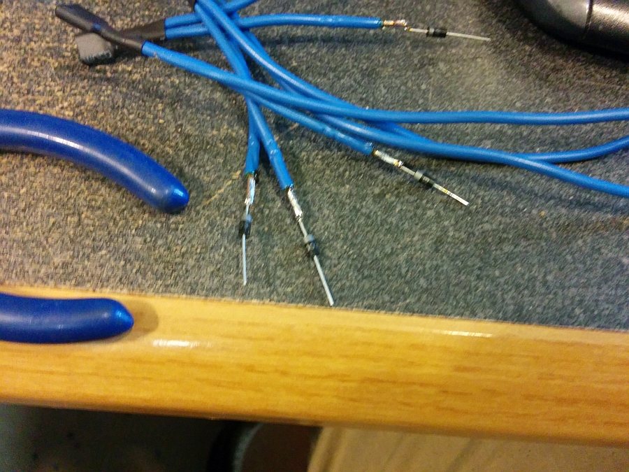

Had to solder some Diodes inline for the master "Zombie Apocalypse" switch to work.

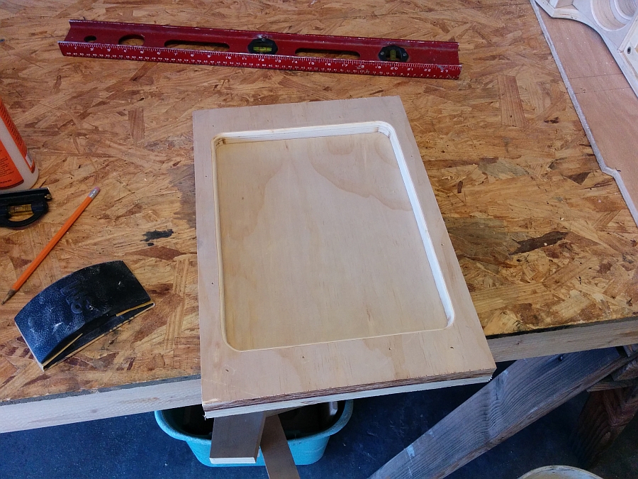

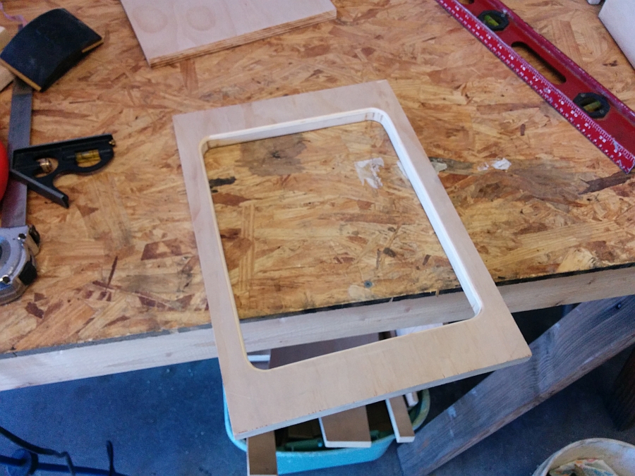

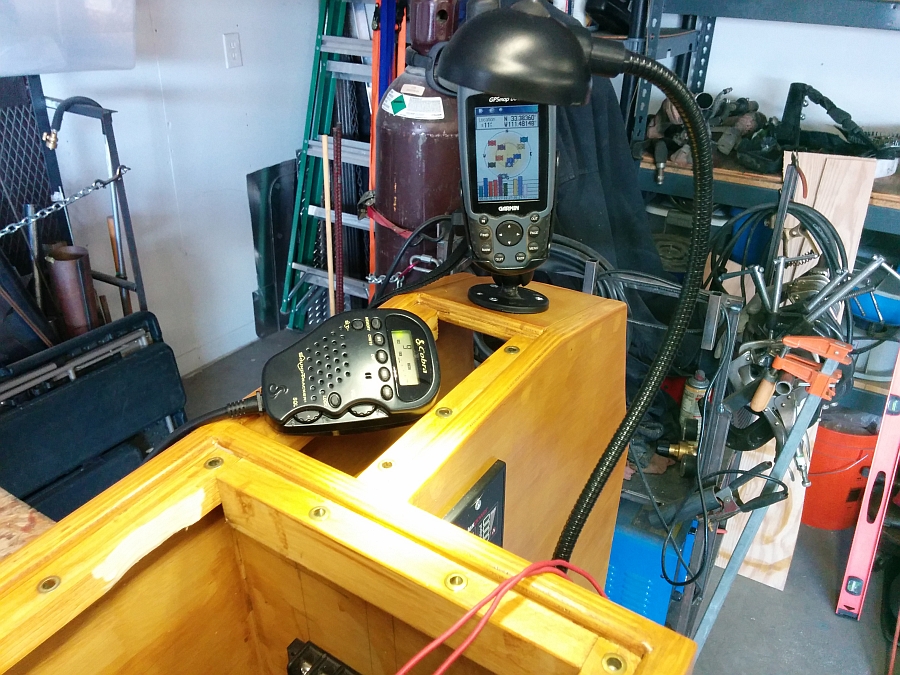

Started the build on the Toughbook mount.
Part of it is to show what we do and what we sell. Plus its a bit novelty.:D I seriously needed extra power ports for all the cameras we need to keep charged.
