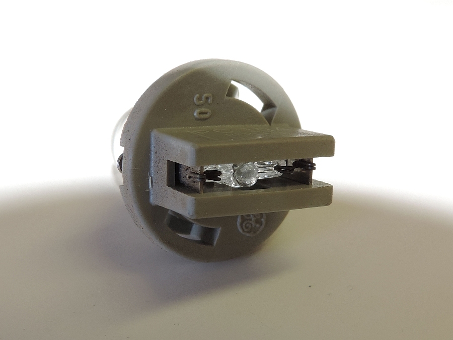

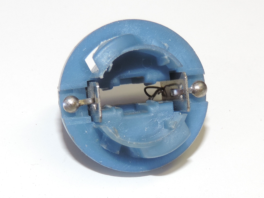

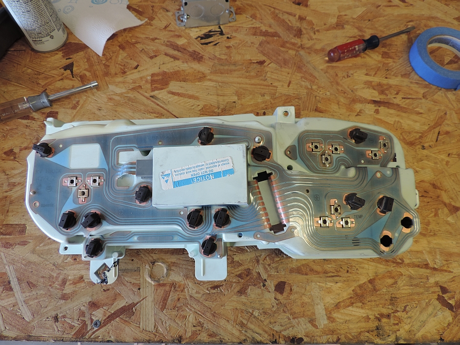

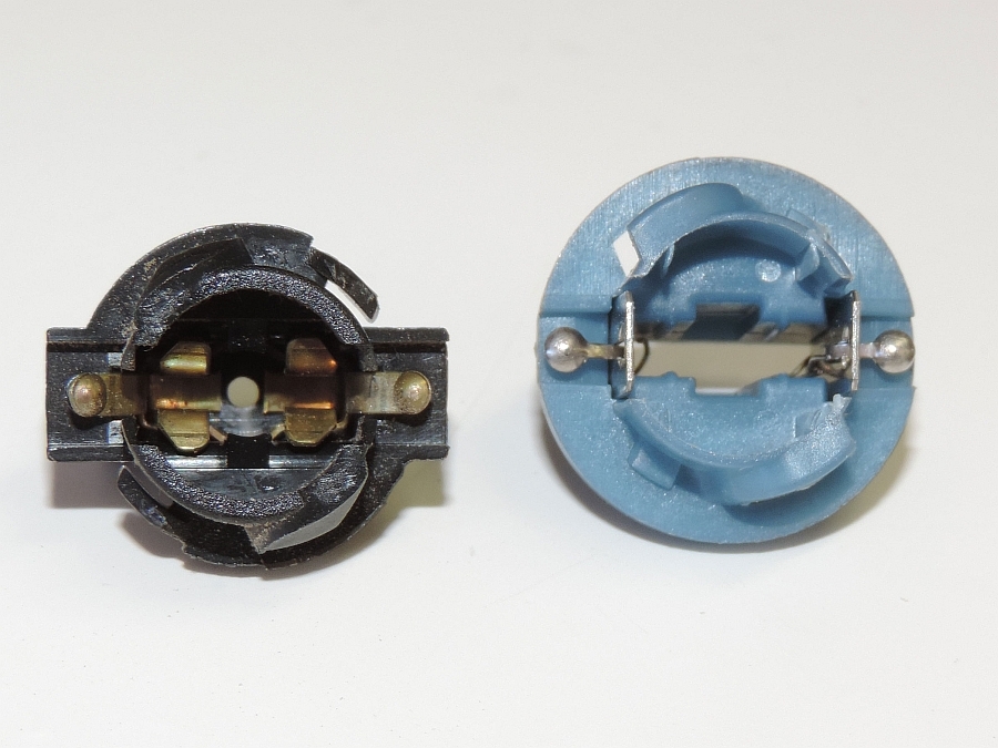

Now LMC shows it for 81-91. Here is the issue in regards tot he instrument lamps. Both the 168s and the 194s are "hardwired" (for lack of better word) into the plastic twist cap. It pretty much self destructs when you pull it out. You can see in the pictures how there is extra wire coming out of the bulb and it wraps over the metal contacts. I hit the yard down the street and got lucky. I found the gauge clusters out of a 88 ford F150 and a mid 90s Ford Ranger have regular twist caps with the tangs on them to make contact on regular 194/168 bulbs.
The grey cap is the factory GM one I took out and the black one is from the Fords. They are slightly different shaped but that twist and lock in just like the GM ones.
Assemble in reverse order.

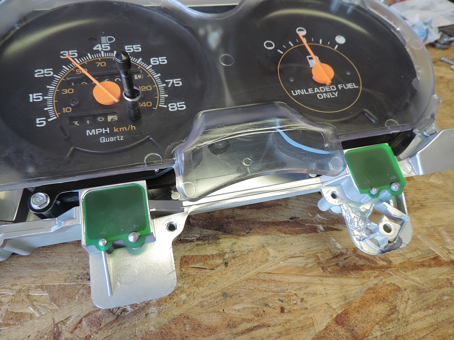

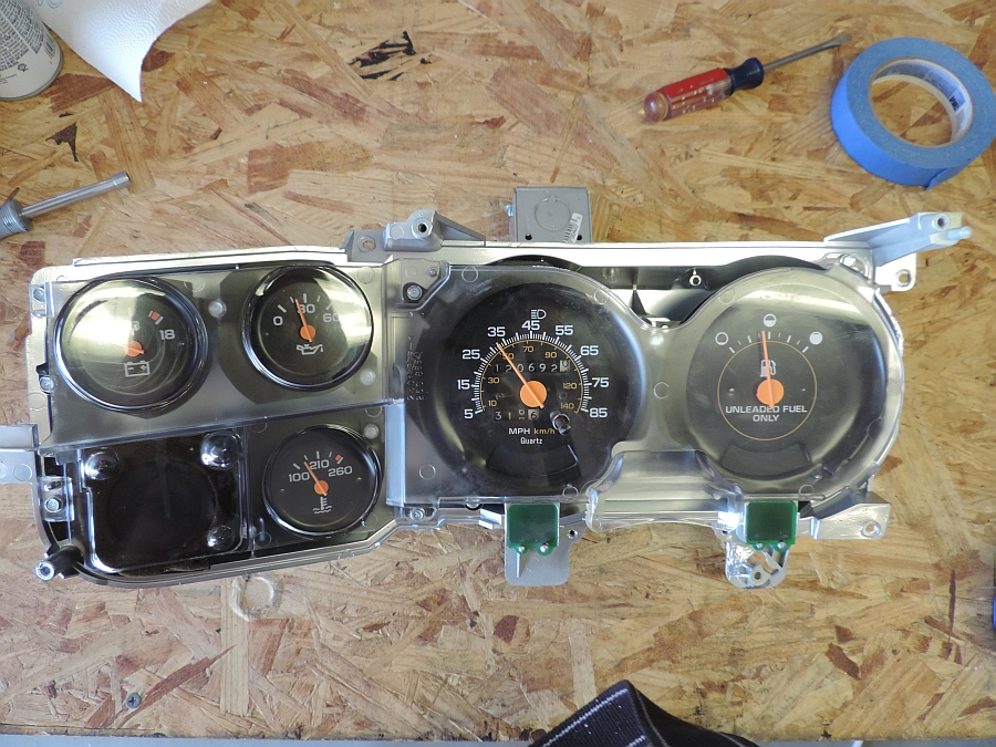

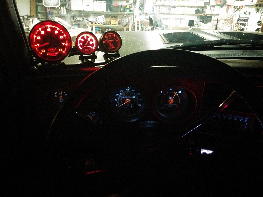

If you want the brightest possible light and get all of that color spectrum from that light you need to match the color of the LED tot he color fo the lens or filter it has to go through.
Below is what I did.
White is the gauge lighting
Orange is the CEL and 4wd indicators
Red is battery, seatbelt and parking brake indicators
Green are turn signal indicators
Blue is High beam.
Can't wait for the night pics. I plan to replace my tail light bulbs with LEDs soon...oh and doing the chrome spray to the reflectors now too. [emoji4]

I went with built backup lights in my bumper so I don't have a part number for that one. The gauge cluster lights are a bit brighter then stock. but adding the chrome paint to the inside of the housing helped a lot. Also I guess when you spray chrome you want to spray gloss black first. It is supposed to add to the reflection properties of the chrome.

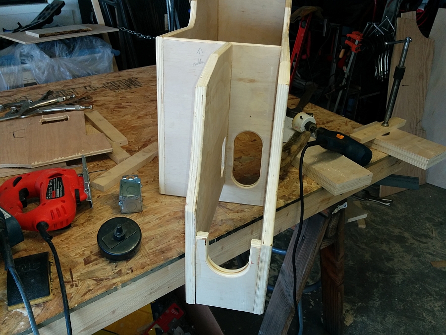

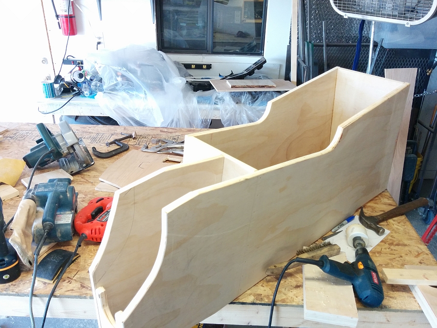

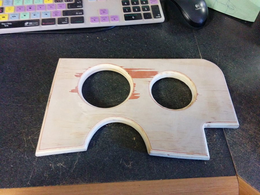

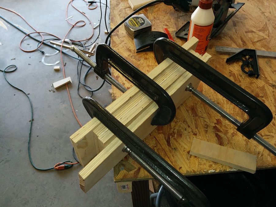

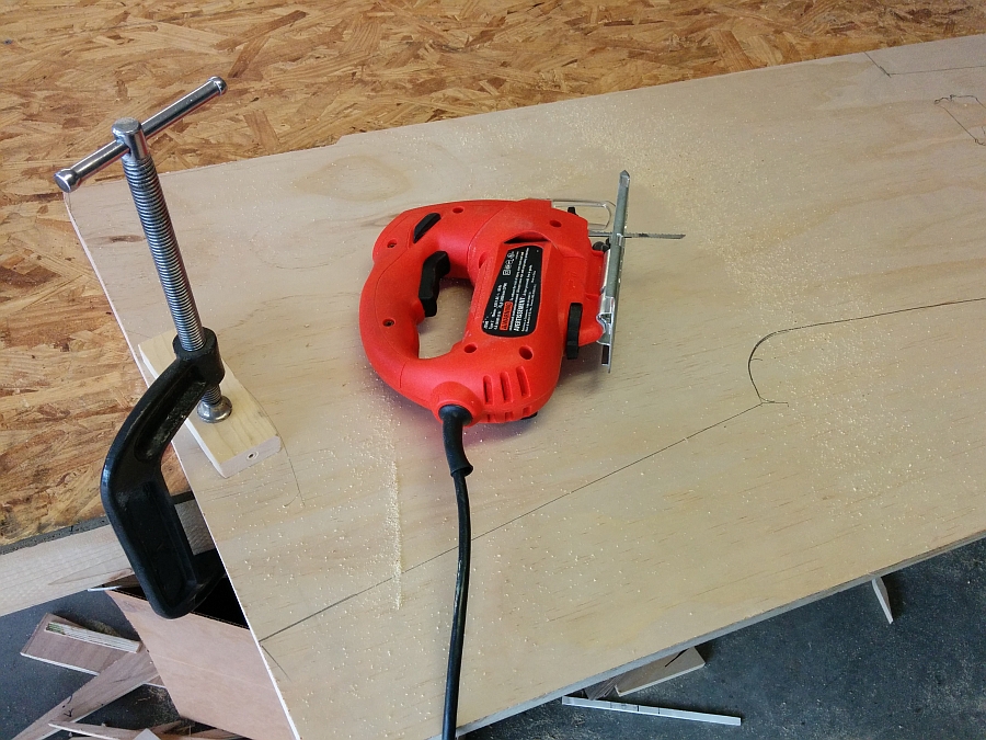

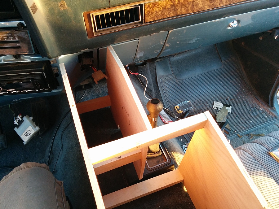

The Center console moves forward.

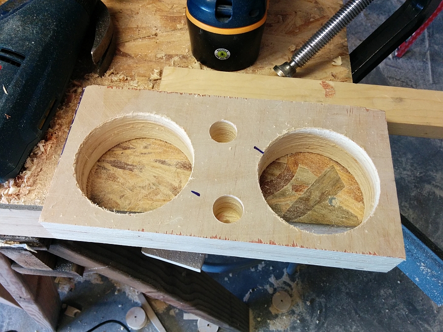

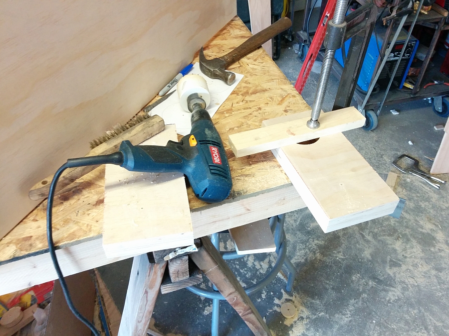

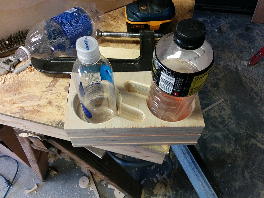

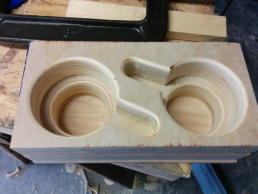

This was just a test piece to figure out which router bit and how it cuts certain edges.
Our new industrial sized and built cup holder!
Is the floor shifter going to fit inside the console? the console I pulled out of one of the Irish Twins was not full length like yours. had a space for the TV and DVD player. Wanted to do a full length but have not come up with a design I like that doesn't interfere with the shifter.
You going to cover this? stain or paint?
I looked back and realized I never posted a pic of the change I did to access the 4wd shifter. The first pic is the change with the test pieces. The second is from the pictures above in the final pieces of wood.
Okay. I see where you are going with it. I was looking at relocating the upper air vent down and out the sides of the console and fitting in a computer tablet/TV in that location.
