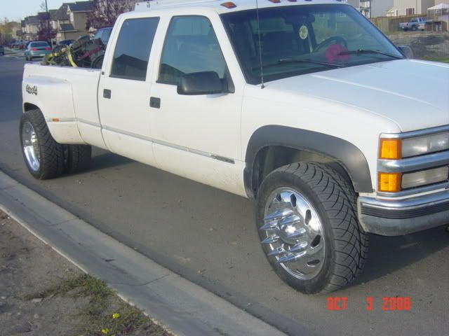

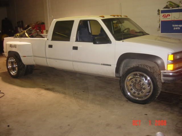

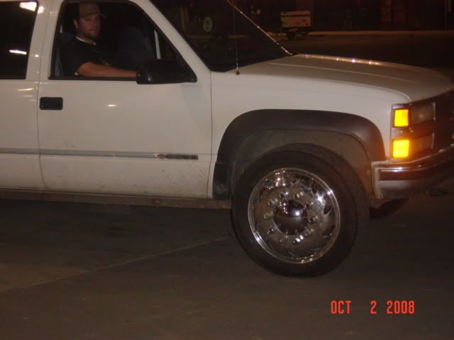

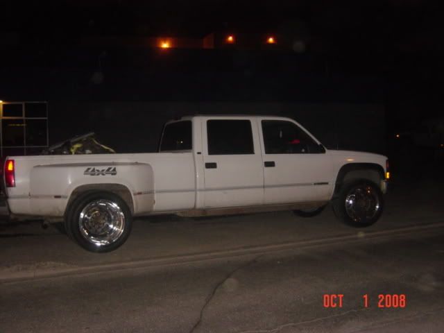

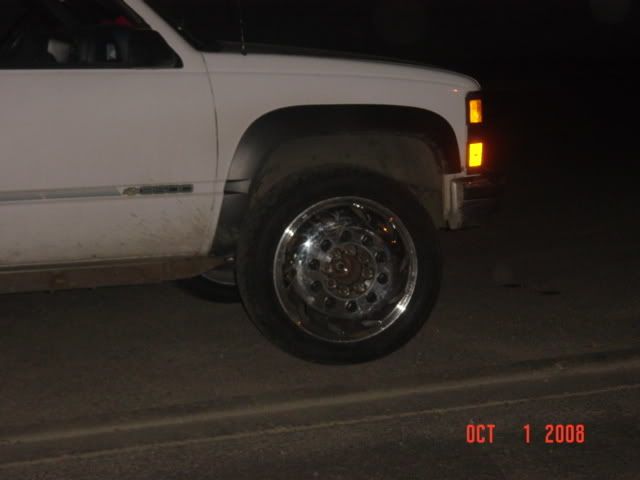

hammered the rims and tires on tonight. night time pics suck but it'll do for now. It's 100.5 " wide...........I think some vehicles shoot for that as a wheelbase :gulp: forgot to bring the centercaps so shes bare for now.
Why did you go with the smaller 32" tires insteard of the 36-37s you had originally planned on using? Are you still lifting it?
Those Alcoas look sweet as hell. Nice build.
mainly because the 4wd shop i ordered my lift kit through decided to jerk me around for a month, so I made a snap decision to go with the low pro look.

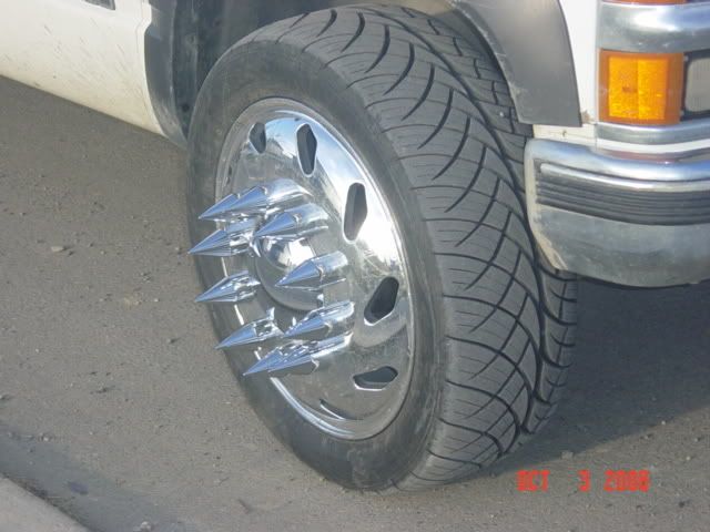

They tidy up pretty good with the covers.......have to get different ones for the rears my dish is not quite deep enough. off to Peterbilt tommorrow :laugh:

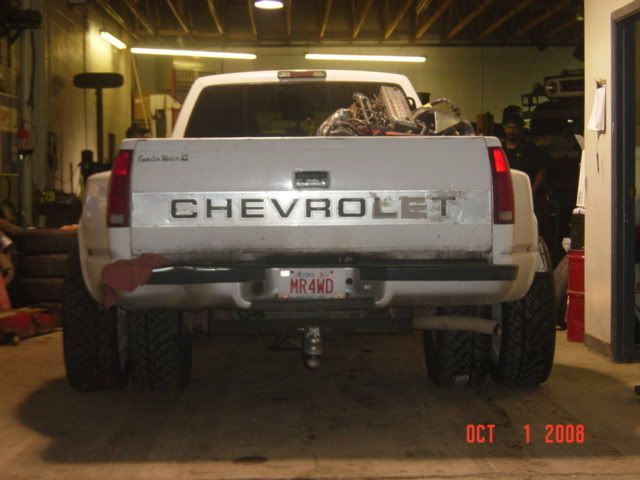

Since I can't leave anything alone for 5 minutes....... Heres the Import shredders.
still looking for the correct cover and caps for the rear though
2nd pic looks like you need wheel well flares on your wheel well flares:haha::haha:
