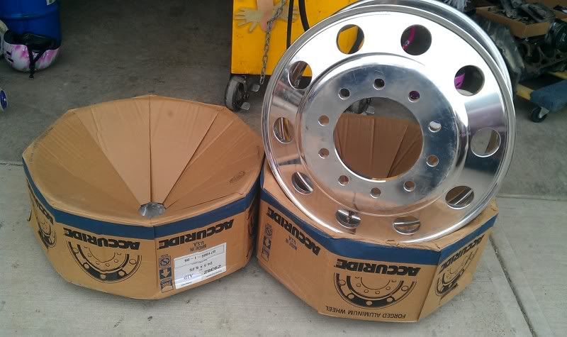

Well going back to duals. the front rim being out of round is too much to handle, I can't drive it anymore. The truck is going to shake itself apart.
This truck supply place in Calgary had a sale on. So they came home with me. new accuride 24.5s. Going to shave them. probably use Interco M16 40/13.50r24" will powdercoat them black. I always wanted a dually on 40s.
I thought you were done with the shaving the wheels thing.
Why not keep it on the cheaper commercial tires?

Ever talked to someone with those M-16's under a heavy truck?
I've heard from a Cummins Ram guy that even his Load Range D or E (forget which but know they weren't C) were wearing faster than he liked. Seems like others agree.
They also remind me enough of the Thornturd that I would steer clear. More looks than function.
Grind down the outer bead lips on a heavy truck style rim so that a 24.5" wheel is now 24".
Not generally done with smaller truck rims.
Yes. I know guys with that tire. one guy has a set on his welding truck.
Truck will weigh 10,000lbs with a metric boatload of horsepower. Not expecting much from any tire. and they're way cheaper than any other in that size.
I disagree. I don't think they look like a thornbird at all. Just because they have side lugs? Ya I don't think so. get a couple pics of the treads side by side and get a look. You'll see.
