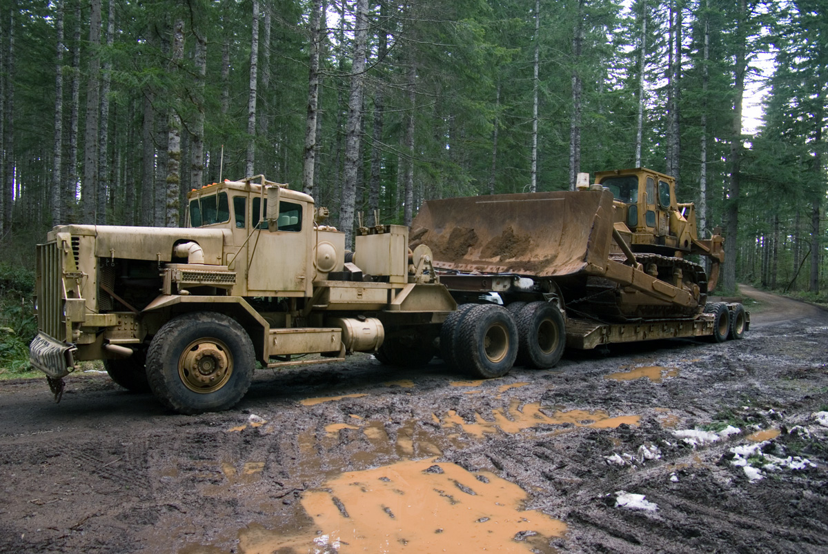

It's a hairy beast for sure. GVWR 88,000lbs, 6x6. GCWR 190,000lbs.

And you haven't seen my backburner deal then have you....... 10tons pffft.....
1978 Oshkosh 8x6 M911 HET

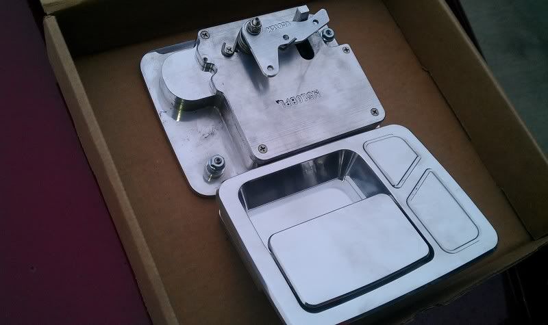

put some billet door handles in, place of the oem plastic ones. hopefully little harder to steal now. turned out pretty good I guess.

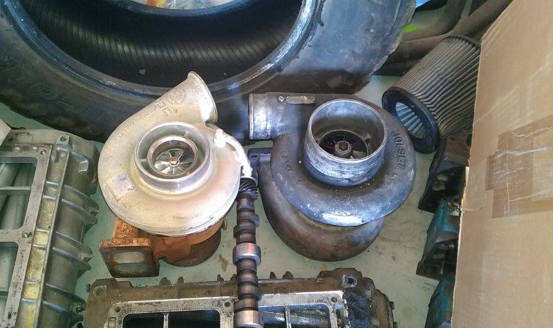

72mm GT42 beside the 88mm HT4C. Was planning on running the GT42 as a single with a bushing, to pull in the 2.6" class. but well see how that turns out. maybe have to put a 64mm over the 88mm and let 'er buck.
lol kinda revealed some of the stash in that pic. 2 big turbos, 2 8-71 blowers, a BBC cam, 3 BBC heads, 37" toyo, one BBC header Shhhhhh....:whistle:
Oh and BTW fire rings are the TITS! :waytogo: had the head off it once when 1st got it home, ohhh sexay. no more orings for this kid. I believe I'm a convert. musta been all horny and amped up cause I forgot to take pics with the head off. :doah: next time. I will for sure.

Dumb question on the door handles...do they have locks? Hidden locks or something?

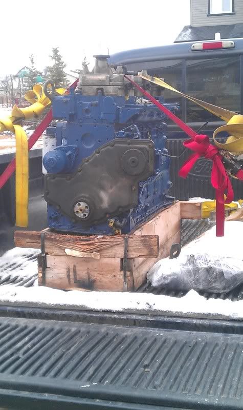

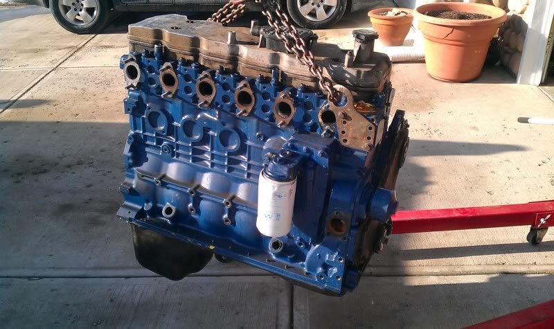

That Cummins is huge! You sure its going to fit?
Btw I do love the MTUs :waytogo:
It's the same size as every other generation of 6B. External Block dimensions are the same so I have no worries.
Sent from my HTC Desire HD A9191 using Tapatalk
Oh, it looked bigger to me :doah:
Was it out of an industrial application with the blue paint?
