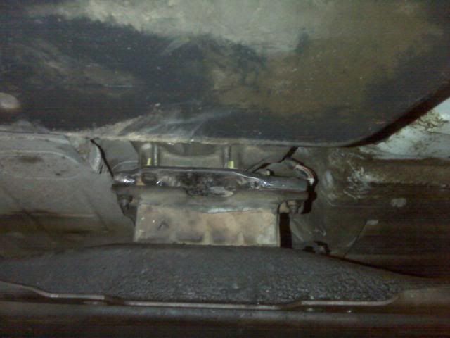

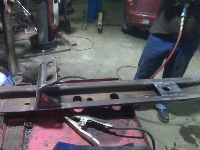

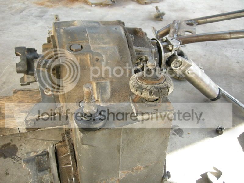

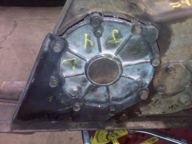

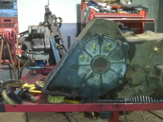

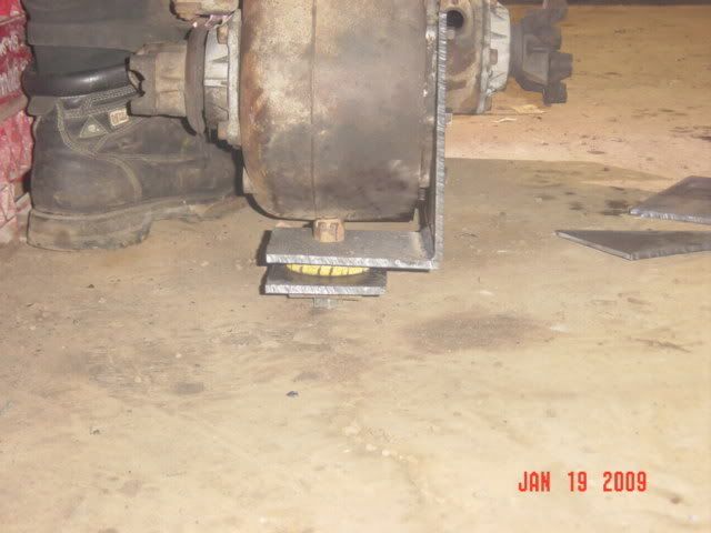

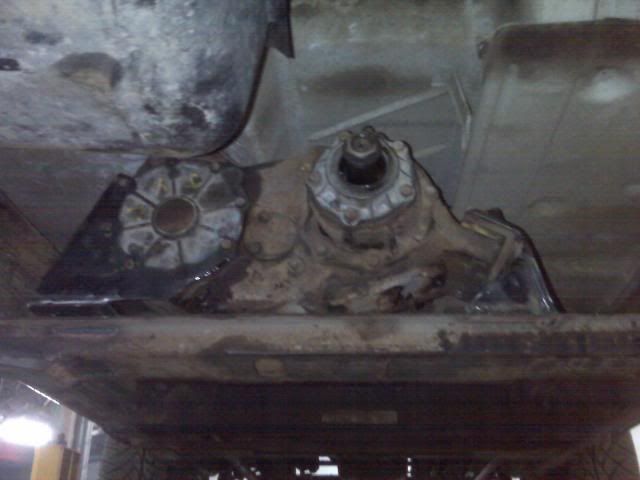

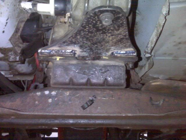

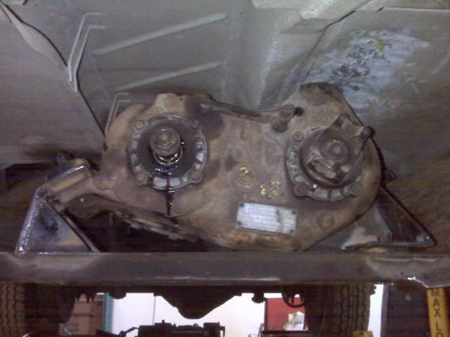

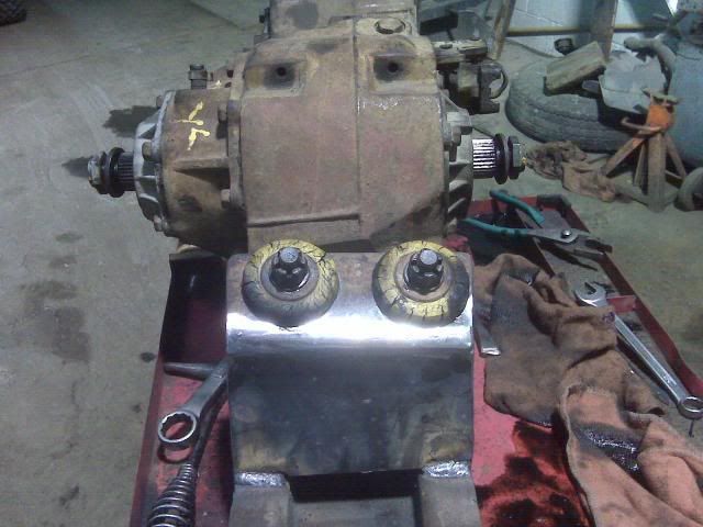

heres my divorced Ford NP205 mount. got it final installed last night. used 3 of the 4 OEM isolators. 3lb sledge for custom clearancing floorpan. grind 2" off the top of the driverside case mount to clear.
on your divorced t-case mount..
ford left the two mounts non connected for a reason, my attempts to have them connected resulted in the mount breaking both times
maybe it was just bad luck, or maybe ford did it for a reason due to movement from the two frame rails, dunno just sharing
also I was able to find some poly bushings at the local off road shop, they are for somewhere on a jeep, made by daystar and very reasonable price wise, 2 different bushings, one with a lip and then a flat one
I dunno. probably to do with framerail deflection offroading it. beats me. maybe bad luck too.
I think this'll work for me. I'm not offroading this truck either though. I would like some new bushings though, I'll have to check out those......daystar. ok.

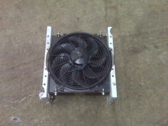

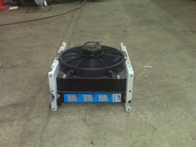

Tranny mount done, tranny cooler and fan rigged up. need to build mount for that still. Using a small hydraulic system cooler for the trans. with the 14" fan on, it should cool the crap out of it when I need it too. It s a ASA hydraulic cooler, it originally had a small hydraulic motor and fan on it.but I need 12v in my truck so it was modifyed. :D
