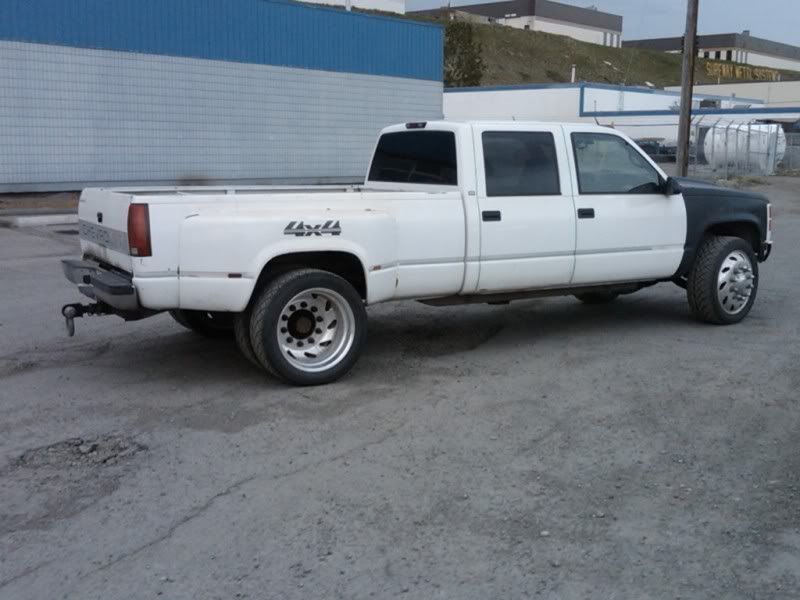

So I set the buraucratic wheels in motion. fast forward to Fri 14th Aug. I seal the deal for it. picked up the wreck for $1500. basically for the diffs rims tires and suspension. the cab and service body is scrap weight. the interior seats and center console. is pretty good too still. might sell them.
I just hate the way the auto drives. I got a nv4500 from a buddy out of his '98 3500 dodge 2wd.
