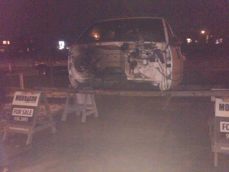

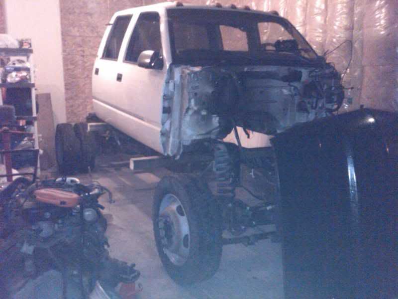

OH YA! 20 minutes with the pressure washer makes a world of difference. nice to work on a "clean" slate! and I bunged it up. the truck only had 55,000km (34,175 miles) on it when it came off the road, not 80,000km like I thought. and it was a soft roll in the farmers feild. it just weighed so much it destroyed the cab and box.
No question that the frame is beef, but holy jeebus you're going to mount the chev body on that frame.:eek1: Thats going to be some long hours of fab work there....

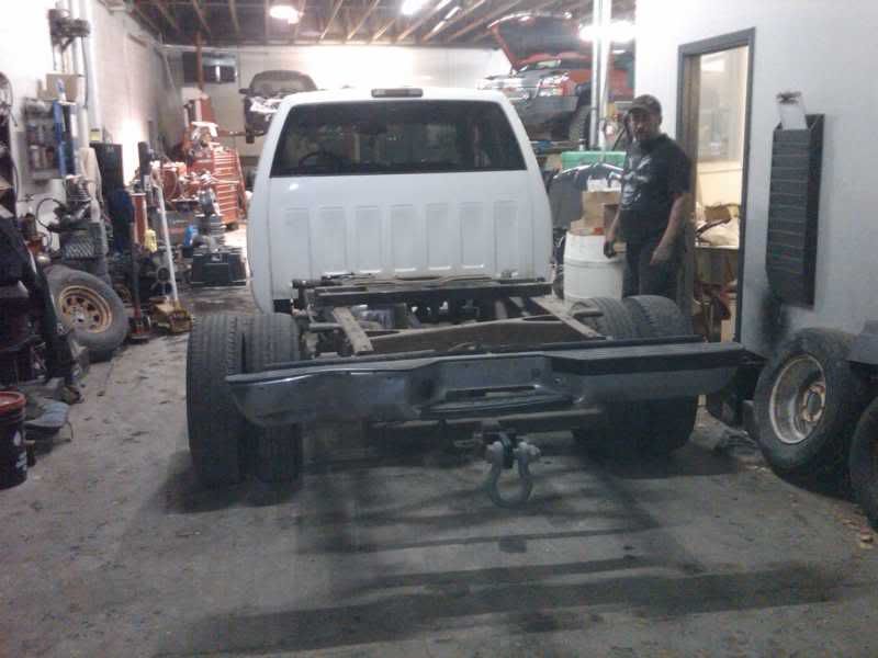

and its badass bro.low pro or not the 22.5s are fukin cool on a dually.sweet deal Luke.:bow: oh and you need to drive to detroit to give me a ride. FOCKER!:haha:

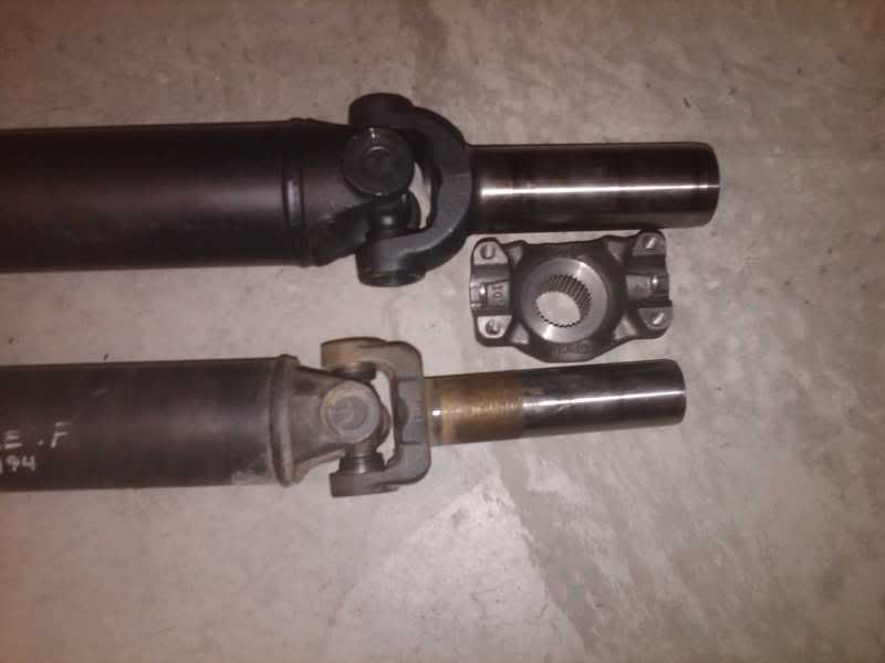

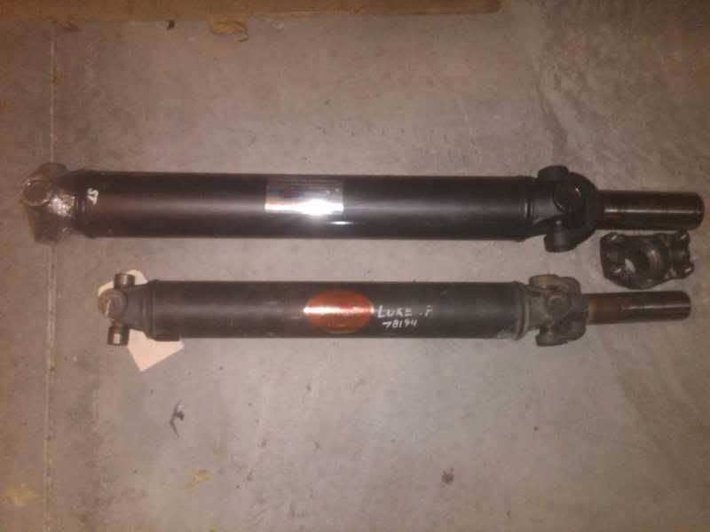

my new intermediate shaft for the 2wd NV4500 vs the old 2wd 47rh shaft. the smallest ujoint in any of my drivelines front rear or jack shaft is a 1410. and the rear diff is 1480.
1410 32 spline yolks for the ford divorced tcase.
