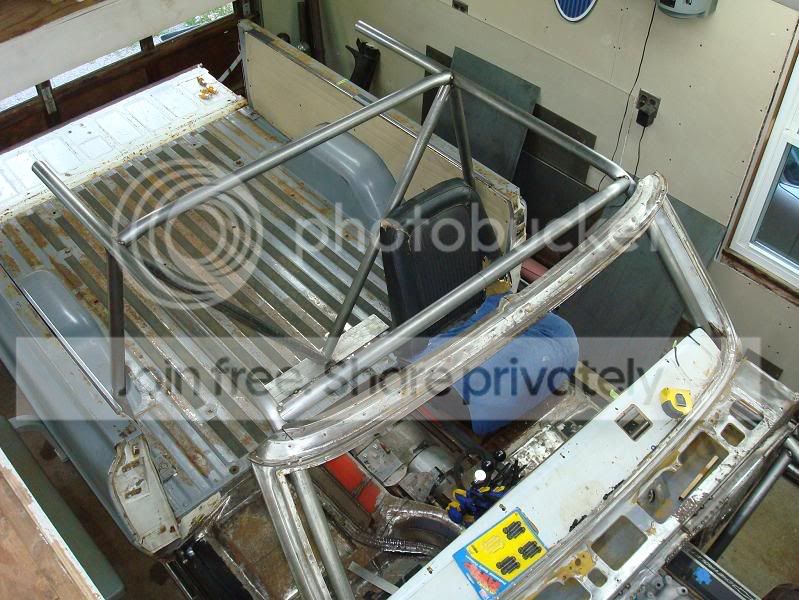

Here's a pic....
I put a set of rear trim panels in when I was doing the cagework to make sure I could still fit the chrome strips without rubbing. If you zoom in, you should be able to see the small chrome strip at the top of the interior panels. That's the part that is screwed to the bedrail that the panels tuck up into for installation.
-G
Here's a pic....
-G
