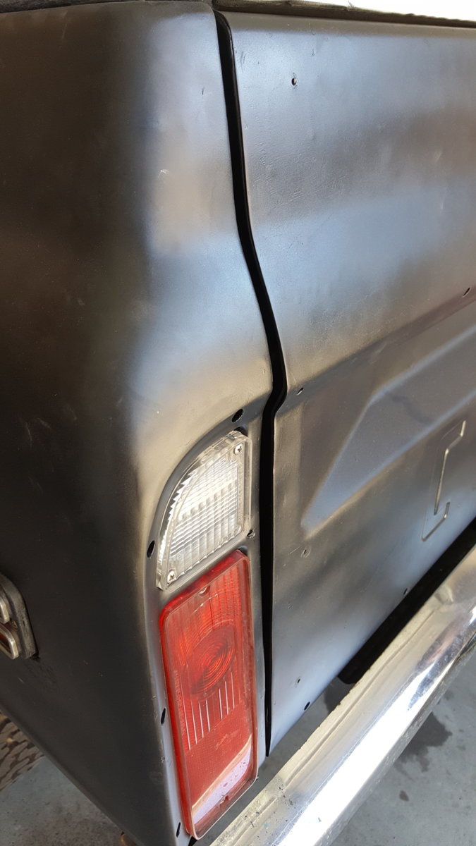

I know I see a lot of tailgates that don't line up perfect but would like to get the left side of mine better, any tips?
full
There isn't enough room in the bolt holes to move it up?
After it goes up, I think a little in with the latch plate.
Haven't really looked at it yet, just looking for suggestions before I tear into it.
Ahh, well I loosen the upper bolt on the pivots, the close the gate. Then loosen the lower bolt, move the gate where it's close.
Tighten the lower bolt and if things stay where you want, open the gate and tighten the upper bolt.
The latch plate may have to move to get the gate where you want too.
But you may have to find a "good enough" spot, no telling until you play with it.
