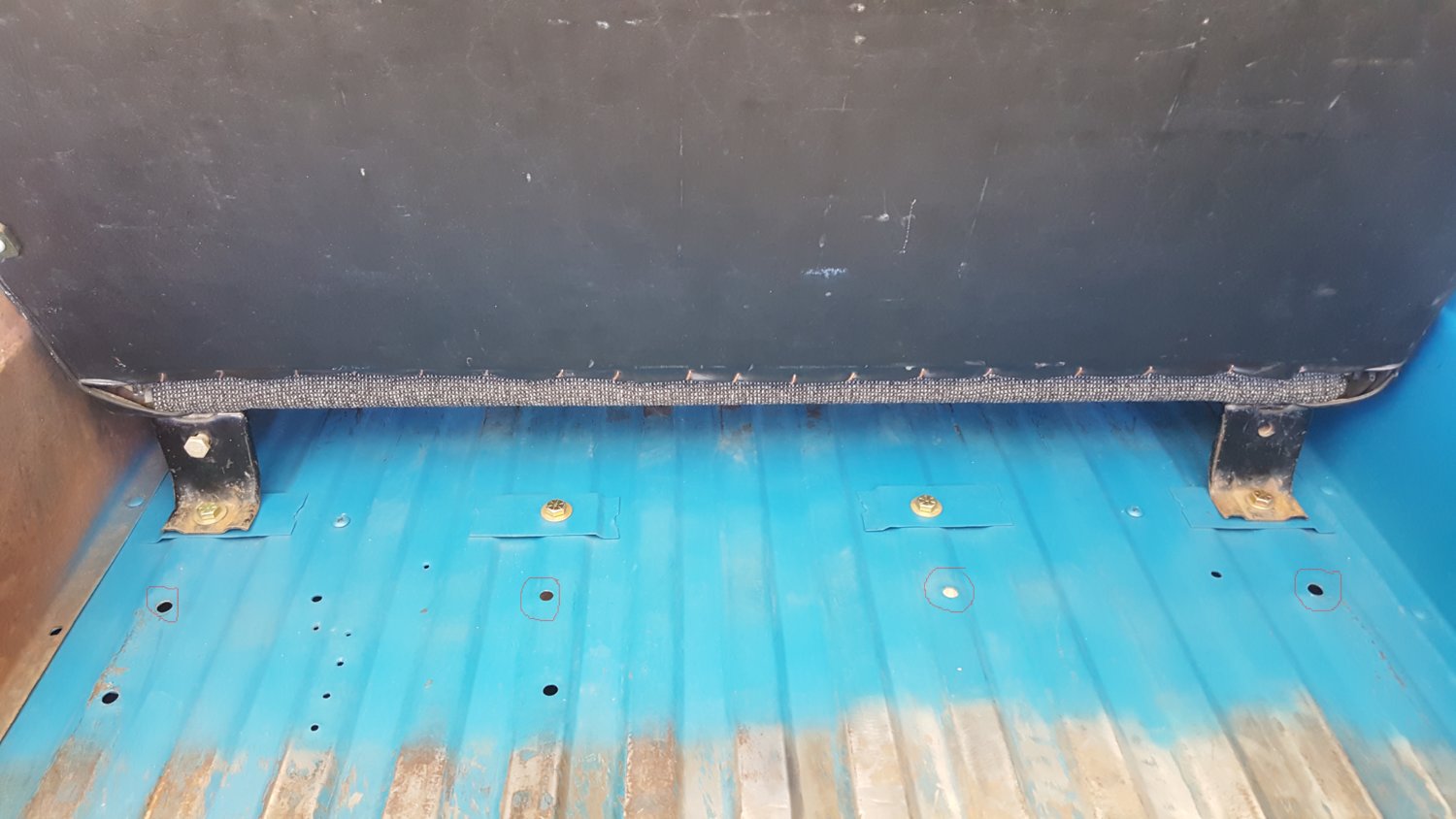

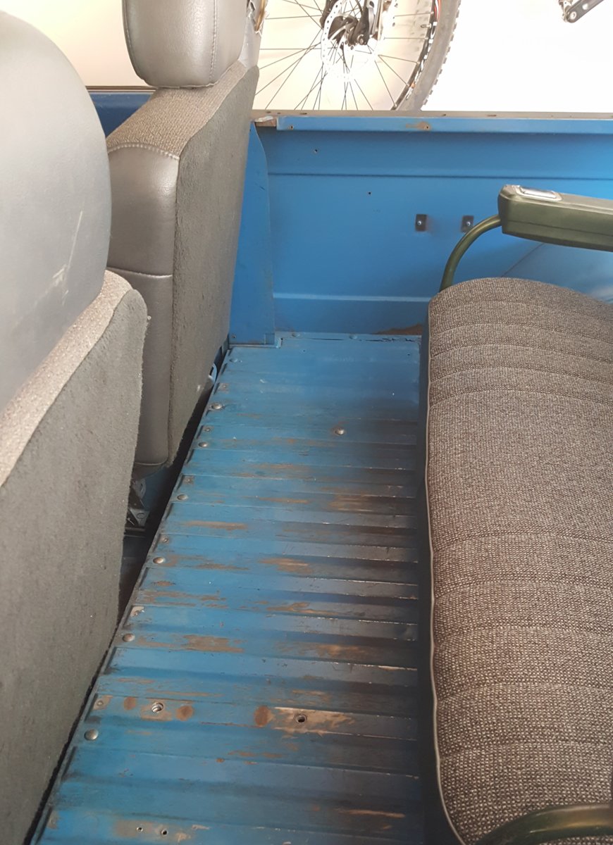

Finally got the factory rear seat installed. I moved it up about 6" from the factory location and now I can lay a 35" spare between the rear seat and close the tailgate. I still have no idea why the factory location was like dead center of the bed. The top picture is the stock location and bottom pic with it moved up, I don't think anyone would even notice.

You can’t hardly tell it moved. Did you also move the crossmembers under the body? Or just use bolts and washers to bolt it to the body in the new location.
I had a hard time telling you moved it. Makes sense though when I think about it.
Yep, moved the rear seat cross-member right up to the floor cross-member. I'm also going to weld the 4 plates on the top in the new location as well.
From the side you wouldn't even notice that it was moved but it makes a big difference in the space behind the seat.
Mine only has two brackets. The other two holes are for the center seat belts
  • Like
Reactions: CK5
curious, the 72’s don’t have 4 brackets on the back of the seats or you just didn’t install them back?
From what I can tell, early production year in 72 they went to 2 brackets and carried that through going forward.
