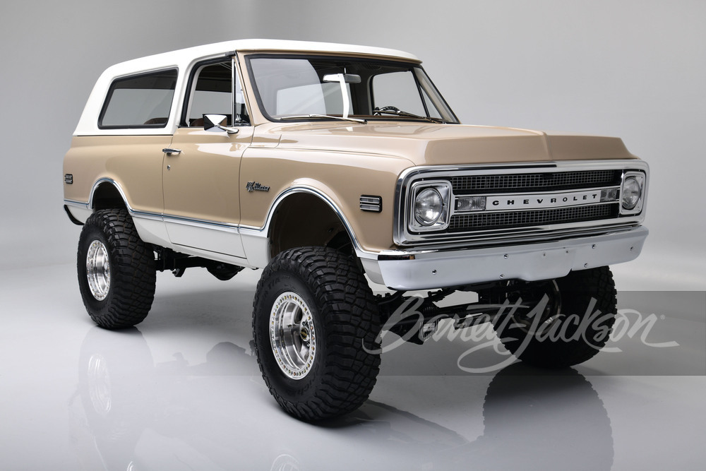

Not going to put the stock trim back on, probably going with the 67 truck style eventually.
Just so we are on the same page, like this.
