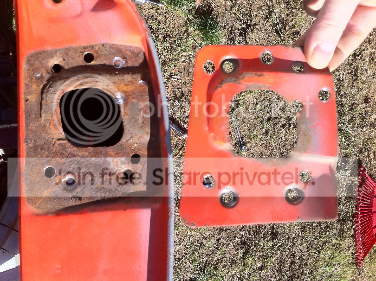

Well crap! Just noticed that my drivers door does not have the "latch reinforcement plate" and the small "brass brace" above it. Anyone have those 2 pieces?
The passenger side door has them and I also have the other brass pieces on the B pillars.

If it was removed from a Blazer door wouldn't it just get held into place on the new door by the 3 screws?If you want that plate it's going to have to be cut from a Blazer door and welded in. There are about 6 spot welds holding it on.
Chevy did a lot of head scratchers in the 70's.The small brass brace was always ugly to me and l'm sure it was an afterthought from GM. I've never found anyone making replacements, but it wouldn't be that hard to cut out a piece of brass and sand it down into shape. Not totally sure why they added it but I'm planning on removing them and plugging the holes. I wonder if a rubber bumper would work as a replacement.
@bp71k5 I'll buy them from you when you take them off... I'm going for 100% stock just like @Greg72The small brass brace was always ugly to me and l'm sure it was an afterthought from GM. I've never found anyone making replacements, but it wouldn't be that hard to cut out a piece of brass and sand it down into shape. Not totally sure why they added it but I'm planning on removing them and plugging the holes. I wonder if a rubber bumper would work as a replacement.
I think you miss understood what I be sayin... "after" the part is removed (3 screws/spotwelds) from the "old" Blazer door, couldn't it just be bolted on to the "new" door with just the 3 screws?

I personally know someone who did just that.![]()
I am learning quick how flimsy these first gen bodies are! And yes I know, brace those doors!So your sayin 3 screws is not enough contact area to stiffen the latch area it also needs to be welded... why didn't you just say that in the first place?I am learning quick how flimsy these first gen bodies are! And yes I know, brace those doors!
Curious, do the new repop doors come with the reinforcement plate's welded to them?
