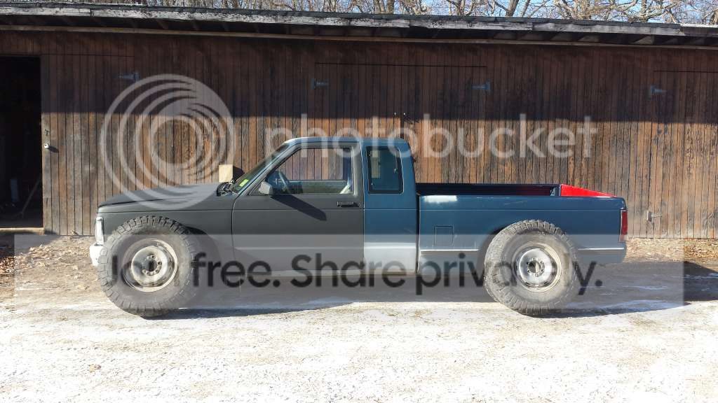

Snapped some daylight pics. Heres the 255s against a stock 2wd s10 lol.

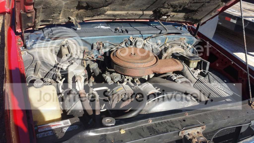

Underhood.

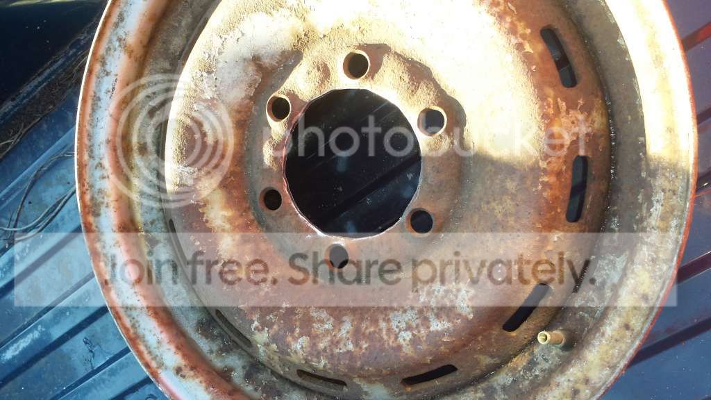

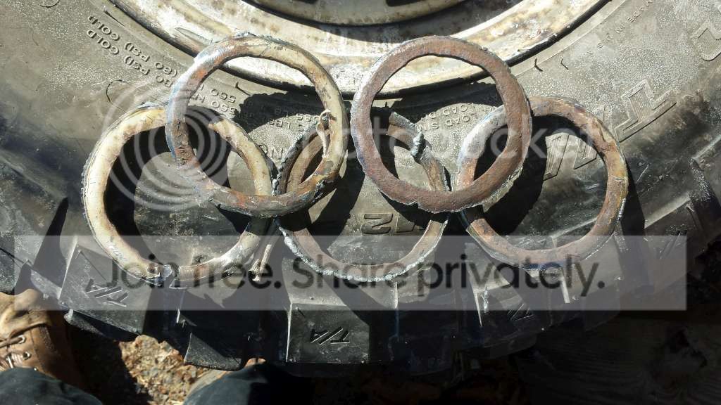

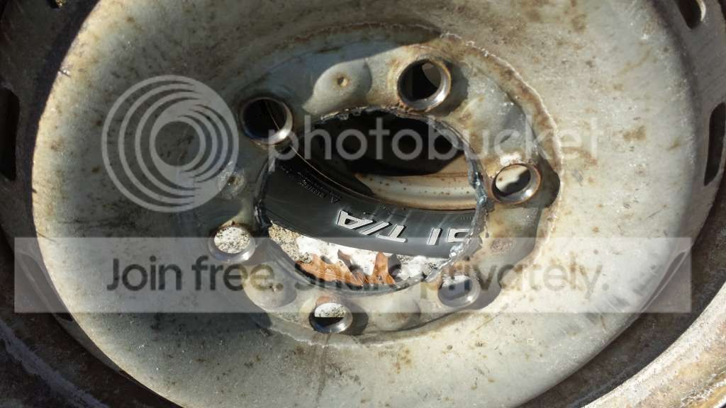

Because I used the Black 8 holes wheels unexpectedly on the work truck I had the 255s put on the Gmt400 slotted steelies. They are the right width for the narrower tires whereas the black wheels were 16x8 and would have stretched the tire open and lost some height. There was two problems with these wheels on a straight axle truck. First being the hub bore in the center is super small and wont fit over a lockout. This was an easy fix. Paul knocked them open with the plasma for me in a matter of half an hour. Thanks again btw.
Thats how we got the olympic rings lol.
I was happy to see my box of goodies from Roark Supply arrived just before I left the house today. On top of the cutoff wheels, flapper disc, fiber paper, and sanding belt I ordered I also finally picked up a couple carbide cutting bits. So I knocked off the slag with the angle grinder and stone and smoothed the cuts out with a carbide bit. Btw have no qualms about buying carbide bits from them, they work awesome.

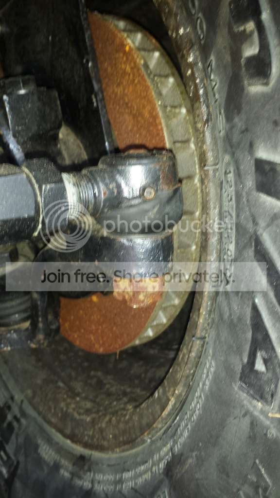

Second issue I knew I was going to have from trying this before with the troopers stocker IFS wheels was I was going to hit the knuckle where the tierod hooks up. Which I did. I knew I was going to need spacers in the back from the start. So even if I bought new wheels with the right backspacing Id still need spacers in the back. So I just ordered the correct stagger on two pairs to get the track width the same. 1.5" for the front and 2.5" for the back. I ordered trail gear spacers but summit stocks them now so Ill get them probably tuesday.

After a little bit of researching last night Ive basically came up with my motor game plan. Ill be sticking with the 4.3 TBI and basically doing vortec heads, small cam, and intake on it. Should be about 230-250hp and 280-300ftlbs of torque.
Why put that money into the 4.3? For the cost of the heads, intake, cam, and all related parts to make it fresh, you could have a junkyard 5.3L with about 300ish hp. :deal:
Well its really not that much money. $200 for heads, about $300 to do the bottom end, $200 for the intake, and $250ish for a cam. So for $1000 Ill have a totally fresh motor making the correct amount of power for the drivetrain. Plus no investment in wiring harnesses since its a TBI truck. It cost me $1000 just to do the bottom end in my 5.3. I decided against a v8 because I want packaging easy to work on just in case of breakdowns, I dont want to have to worry about nuking toyota transfer cases, and I dont want to invest money in wiring harnesses.
Yes I'll be around the power level of a stock 4.8 but the packaging will be much simpler and parts are even cheaper and more abundant. (Lol is that possible?)

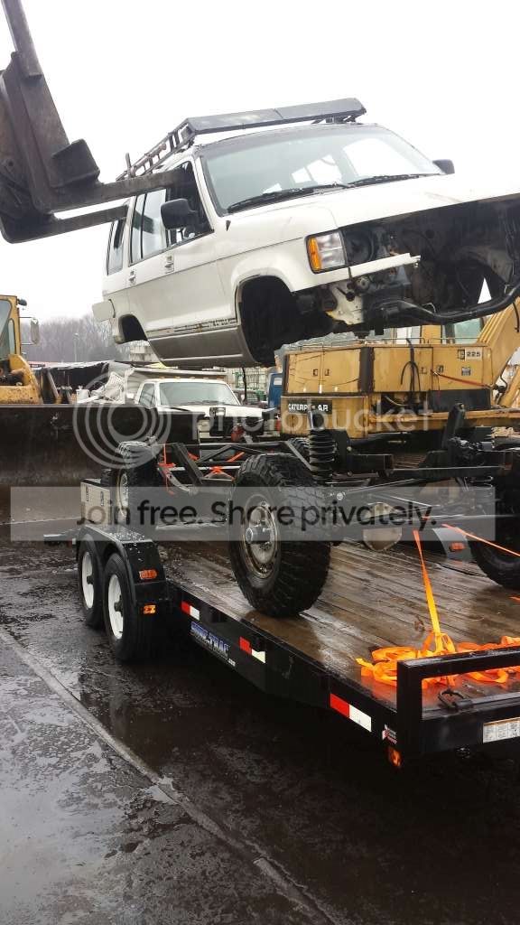

So first thing this morning I hooked up the trailer that me and the wife put the 442 on on saturday. Hauled it off to the boneyard. I salvaged the gigantic pop up sunroof and electric cooling fan from the 442 and pulled the rad out to scrap separate. Really didnt bother me much to see it go. Just kind of sucked to scrap a true blue real 442 but apparently no one found it to be worth saving and Im not really that sentimental about hanging onto stuff for the "sake of saving its rarity".

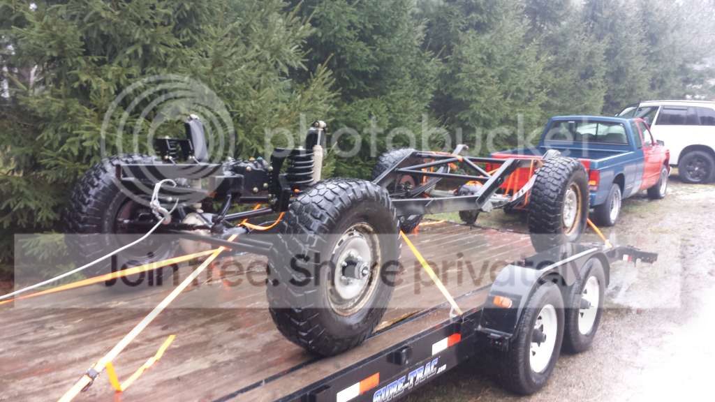

Then I came back to the yard and got the spacers and wheels all bolted up on the frame, guess this will be the last post I reference it as a "trooper frame" lol.
Looks good sitting on 255s with the shallow steelies. The track widths now match front and rear with the spacers staggered. 66" front and rear with obviously very tucked in wheels. Its 1.5" spacers up front and 2.5" spacers out back. Just for reference the 1.5" spacers are the absolute minimum one would need to bolt an IFS 7in wide steelie on a straight axle. I think an 8 lug setup would clear with no spacer due to the hubs being wider by the same amount as the spacers IIRC. So I guess in the future if I ever wind up 8 lug I'll have the same track width. But I really dont foresee that happening.
Heres the tierod arm clearance. About 3/8ths

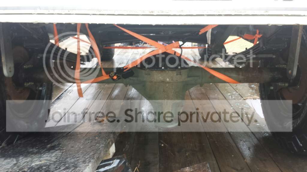

This pinion angle is good right?
