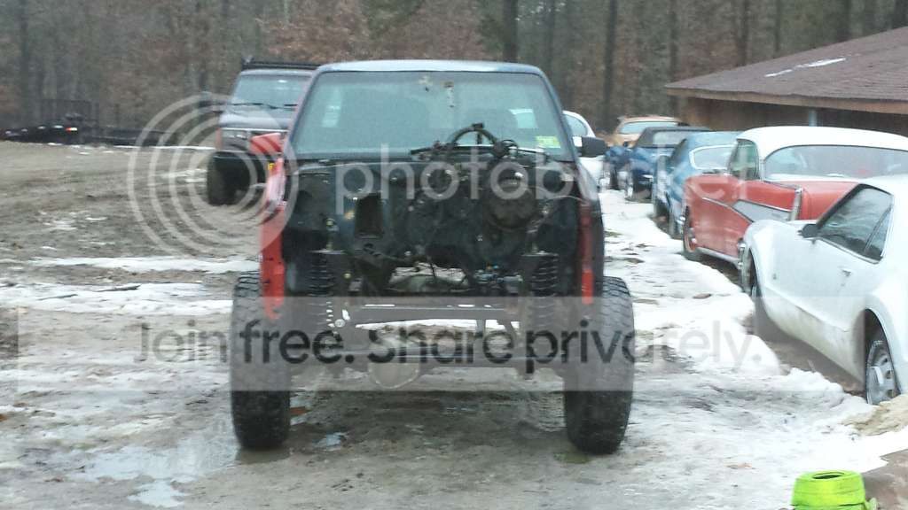

Im sticking this picture in here more for me than you guys, but you can look at it if you want :D

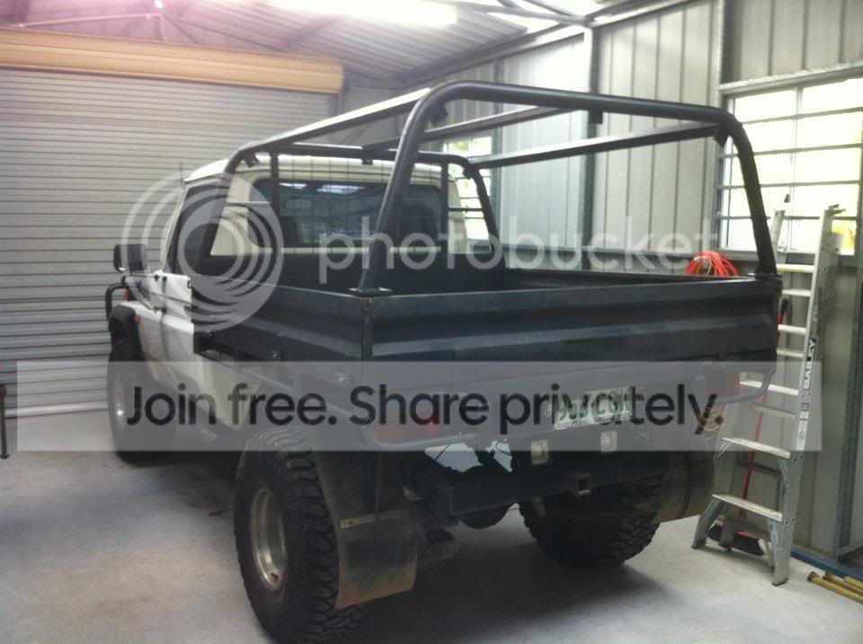

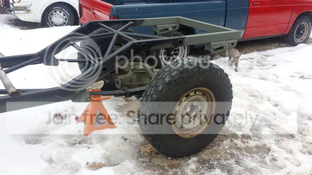

This is basically what Im going to do on the back. Except it will go over the cab as an exo and be structural with tie ins through the flatbed to the frame. Excuse me while I put the horse in front of the cart.

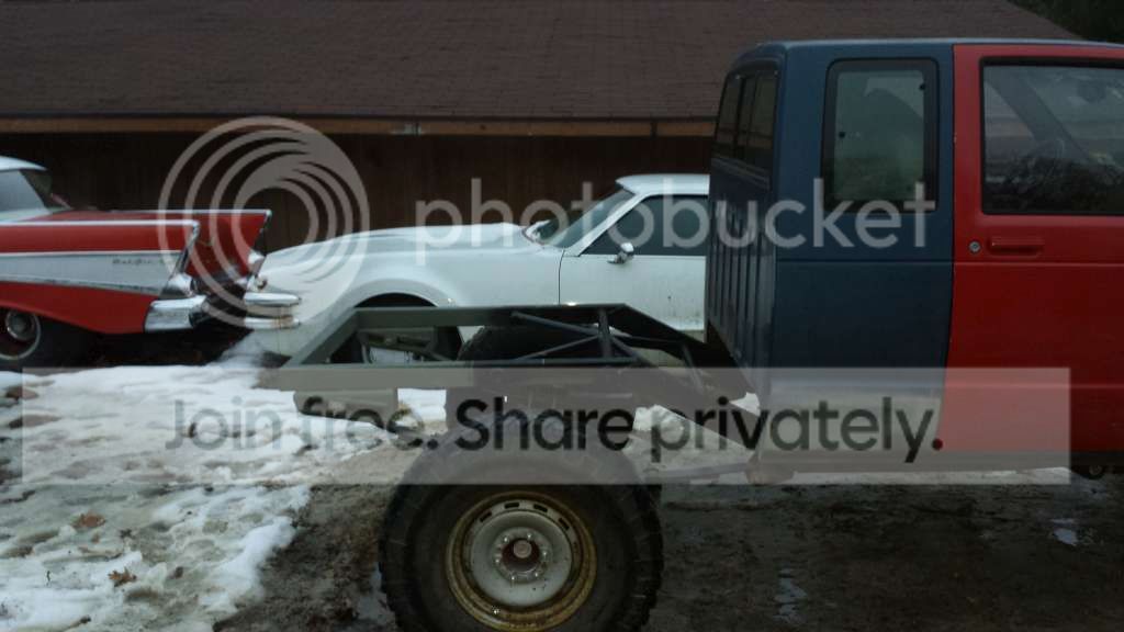

I also measured out the cab vs the frame today and despite it originally being designed for a trooper the ext cab will sit almost perfect on the flat belly of the frame and rise up right at the rear of it. Im going to try to tear down the s10 this weekend if we dont get bad weather and I would like to consider getting the cab mounted and then taken back off this coming week.

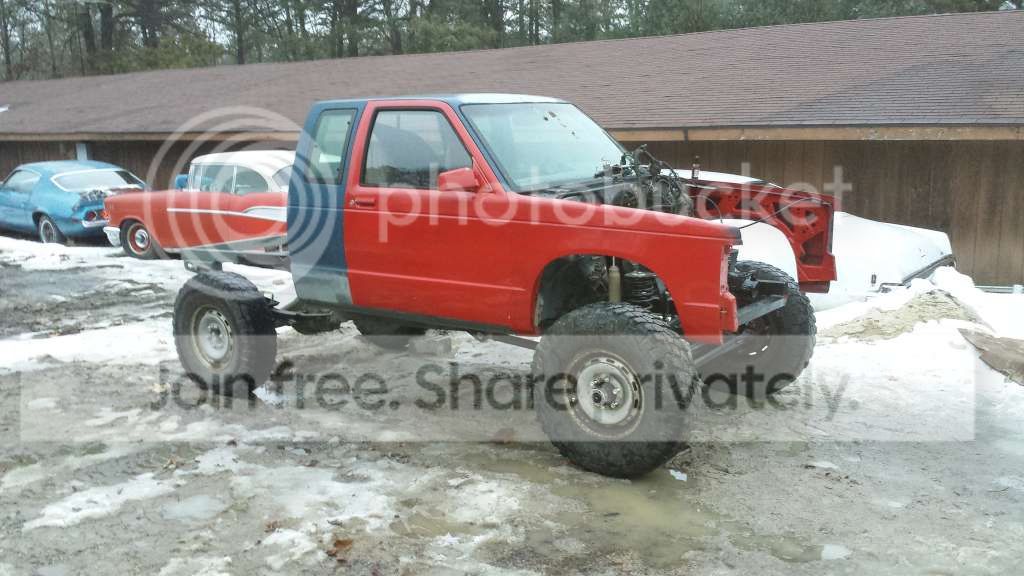

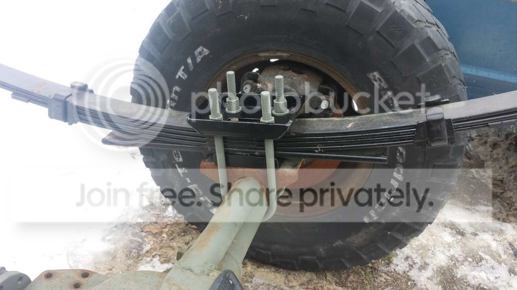

So I got a nice box from kert today. Goodies for all the projects lol. Got spring plates for the back of the truck and zero rates. I pushed my axle back an inch since Ive got no wheel well to shoot for anymore just to improve departure angle.
Not much to show picture wise though. It was fairly warm so I painted some **** up including the fuel cell straps for the shortbed.
Ive had these terrible thoughts in my head about re-doing my rear axle though. I kinda really want to make it a full floater. Ive always wanted to do it but when I built the thing I didnt have any tools to do a custom rear. Now Ive got the true bar. I was thinking of having brackets cut to bolt a dana 44 spindle to and running drive flanges with a double splined shaft, one side 19spl the other for the 8.8.
Well after getting it all installed and looking at it the zero rates are not going to be ran. Part of what I liked about these spring pads is how much contact they had to the spring and with the zero rate you lose that. But I did get U bolts and spring plates on, not that thats very exciting.

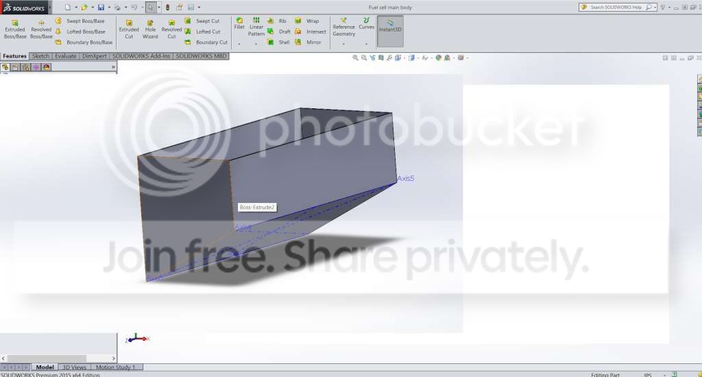

So I drew the fuel cell up in solidworks. Ive got a lot to learn lol. I drew the sump too and after fighting to try to assemble the two pieces for an hour I gave up because I basically decided this wedge shape wouldnt work offroad. Too much weight on the one point me thinks. The nice thing about solidworks is it will calculate the volume for you. This worked out to about 38 gallons.
Pretty sure I'm going to do a flat sump up front where the wedge was and make the tank extend under the bed towards the axle more. I was shooting for 40-50 gallons but 35-40gal should do it. Anything I ever actually need beyond that can be supplemented with jerry cans. Sitting here Im also wondering if an 8in tall cell could sneak in between the bottom of the frame rails and the axle at stuff if I built a subframe for it to live in. Could keep my COG down way better....

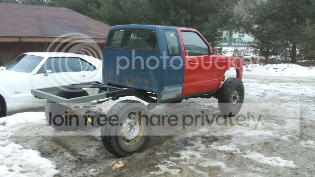

I also took some rough, but close measurements for the cab position again and figured my window height above the frame roughly. Looks like the bed will be 60in long and about 66in wide. Proportionally the truck should be exactly how I wanted it, an extended cab with a "stubby" bed off the back but not ridiculously short.

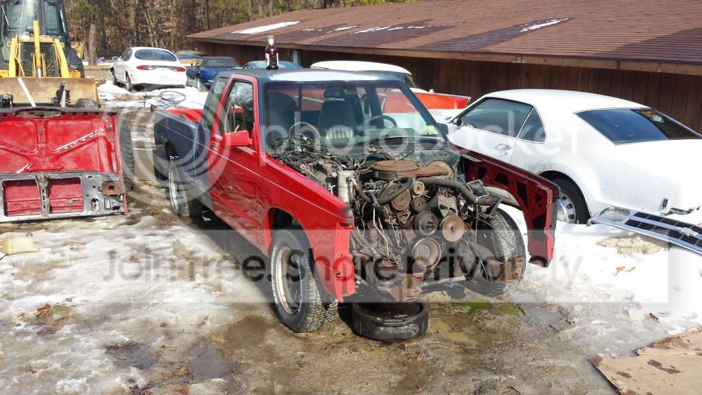

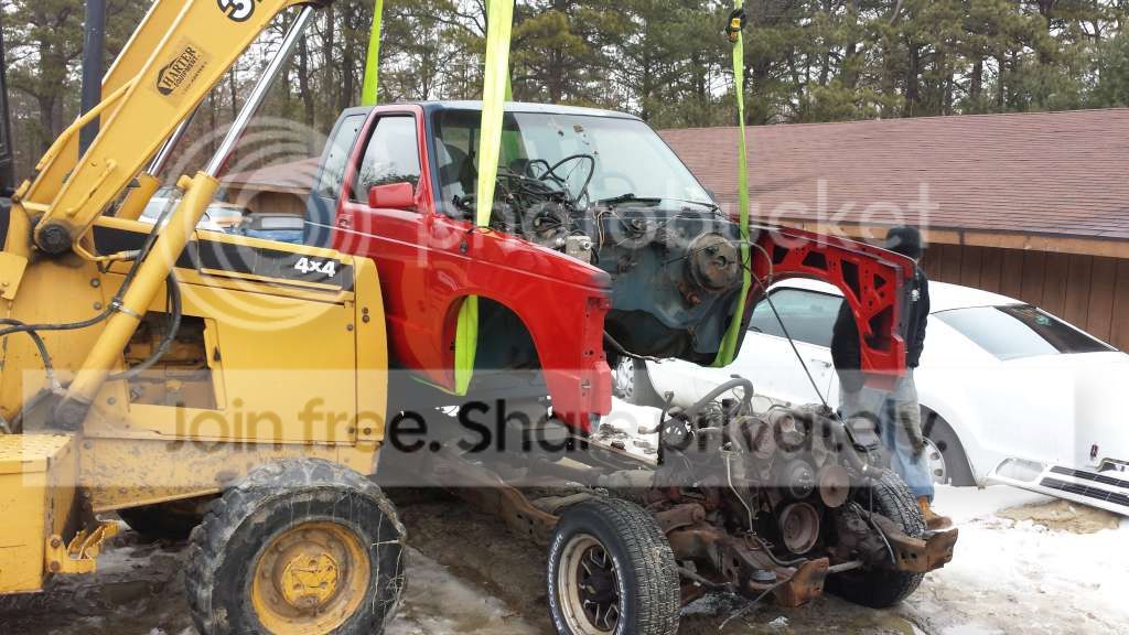

So I started the new job yesterday, Saturday is an odd day to start working somewhere lol, and lost the only day that was suppose to be nice. Then I guess the storm held off so I really lucked out so me, the wife, and my buddy got to work today.
Tore the front end down.
I pick things up...
...and put them down :haha:
Its amazing how good an isuzu trooper frame fits a first gen s10 lol. Some things arent ideal. I may have to ditch the air conditioning and move to a smaller boost or hydroboost due to my shock towers. Im going to see if maybe I can pie cut them and pull them out further away from the frame. This should at least fix the issue on the booster.
Also the front cab mounts are about 16 miles away from the frame. Not sure what Im going to do there. Im considering building a body mount into rock sliders because other than that a bracket would be like 10-12inches out off the frame due to how early the taper started on the trooper frame.
Im pretty damn pumped though. The trucks proportions look great and the height is like exactly what I wanted.
