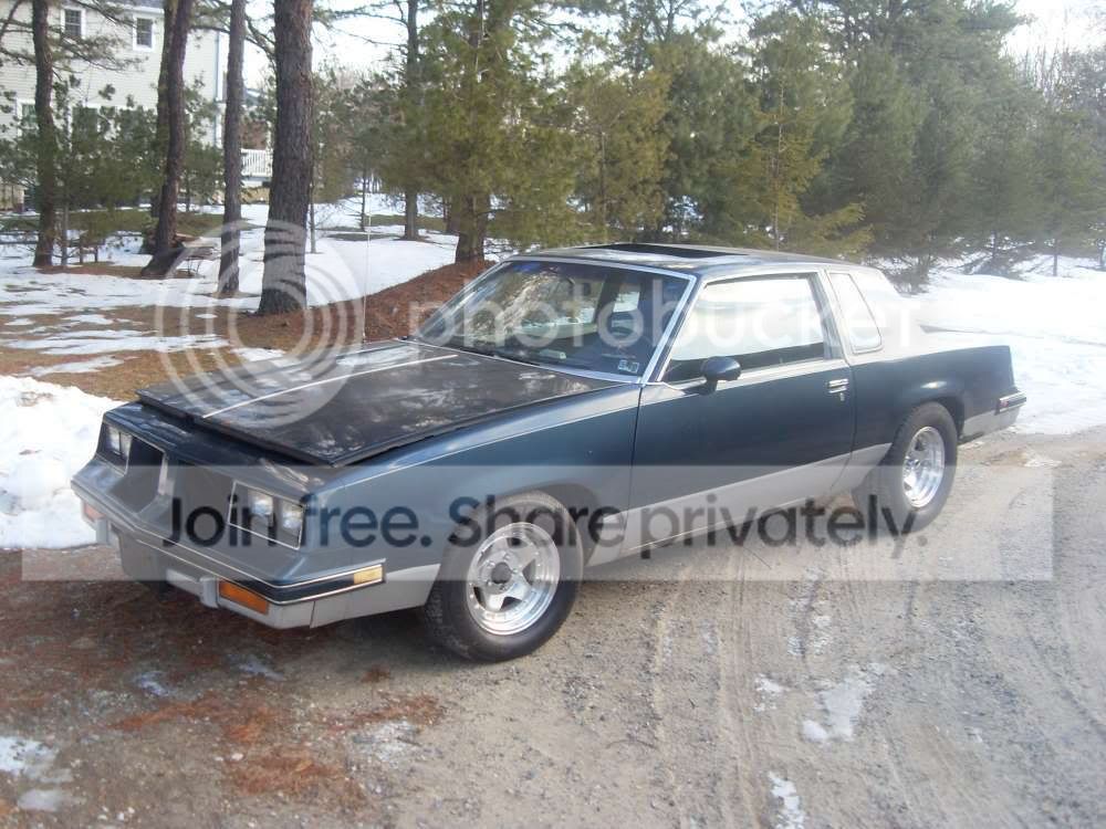

So first thing this morning I hooked up the trailer that me and the wife put the 442 on on saturday. Hauled it off to the boneyard. I salvaged the gigantic pop up sunroof and electric cooling fan from the 442 and pulled the rad out to scrap separate. Really didnt bother me much to see it go. Just kind of sucked to scrap a true blue real 442 but apparently no one found it to be worth saving and Im not really that sentimental about hanging onto stuff for the "sake of saving its rarity".

This is as far along as I got it.
sucks you had to junk it.. I know a couple g-body guys, grand nationals and such.. never built one myself, but it was one of the better hotrod looking bodies of the 80's..

Damn. That was a nice car. Sharp. Typical g body rust? Or what was the reason you couldn't move it? What yr? I have a a 87 now with 69' rocket 350.

It needed floor pans and I hodge-podged them together with patches and regretted not doing full pans. The car wasnt terrible rust wise on the body. Typical door corners, couple quarter/sail panel spots but easily fixable. In fact I did the one under the quarter glass from inside the car, piece of cake.
I just have a terrible habit of losing interest in things w/o a bowtie on them. I wont be making that mistake anymore lol.

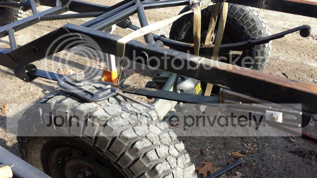

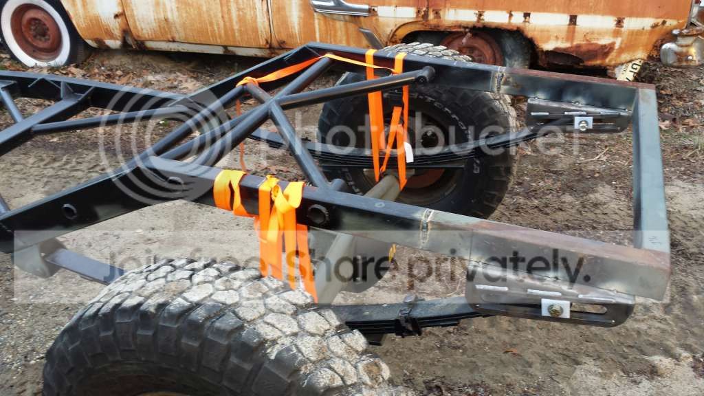

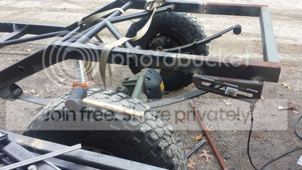

I put the rear piece of the frame back on that I had cut off to try to clear the trooper tub in the back. Then I went about getting my leaf springs in place, so I finally broke open the pimp slider boxes Ive had for two years...
I called the guy who makes them, whos actually a friend of a friend, and asked him about how to orient the slope. I either heard him wrong or his misunderstood the way I posed my questions because I tacked them on like this first.

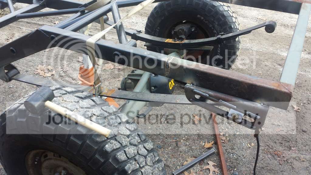

I started looking at them and cycling the leaf spring that I tore down to just a main leaf and it just didnt seem right. The motion of the slider was counter productive to the way the spring flexes with travel. Then I started googling shots of them and his bolt on ones and they are all oriented like this, which makes way more sense. One of us got confused lol.

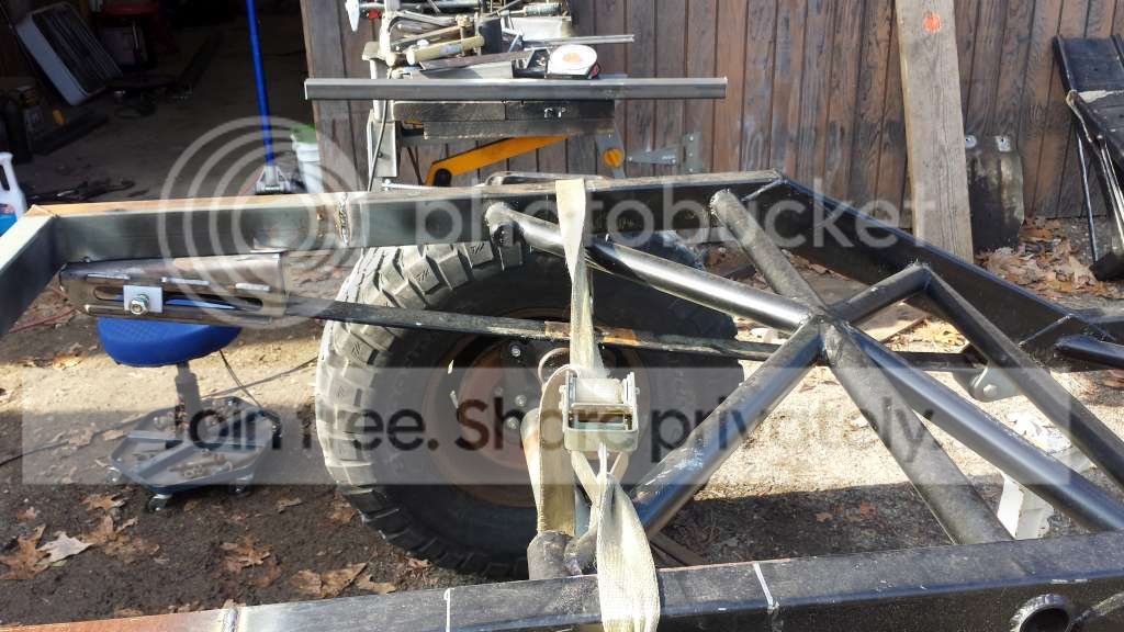

So I fixed them and they work great. Heres full stuff, leaf spring is flat at 5" of up travel.
And static ride obviously unloaded pretty much. Both sides with heavy tack welds on them. 99% sure the rear suspension is staying right where its at. Especially since I can just build my bed around the wheel base.
We'll see how it plays out with weight on it but Im guessing down the road I'll be ordering a set of rear lift springs for this thing. The lack of shackle just tucks the springs up so high you lose like 2-3" of lift. Its great because like I had said in the other thread theres one less giant pivot point for the body to roll on and they are amazing for departure angle.
