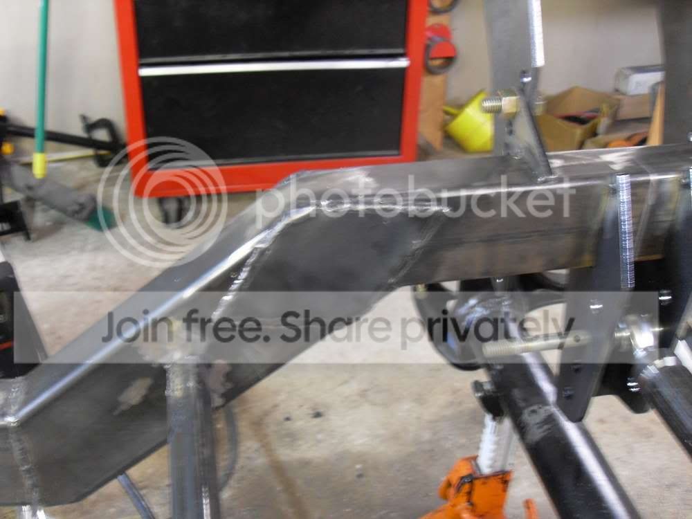

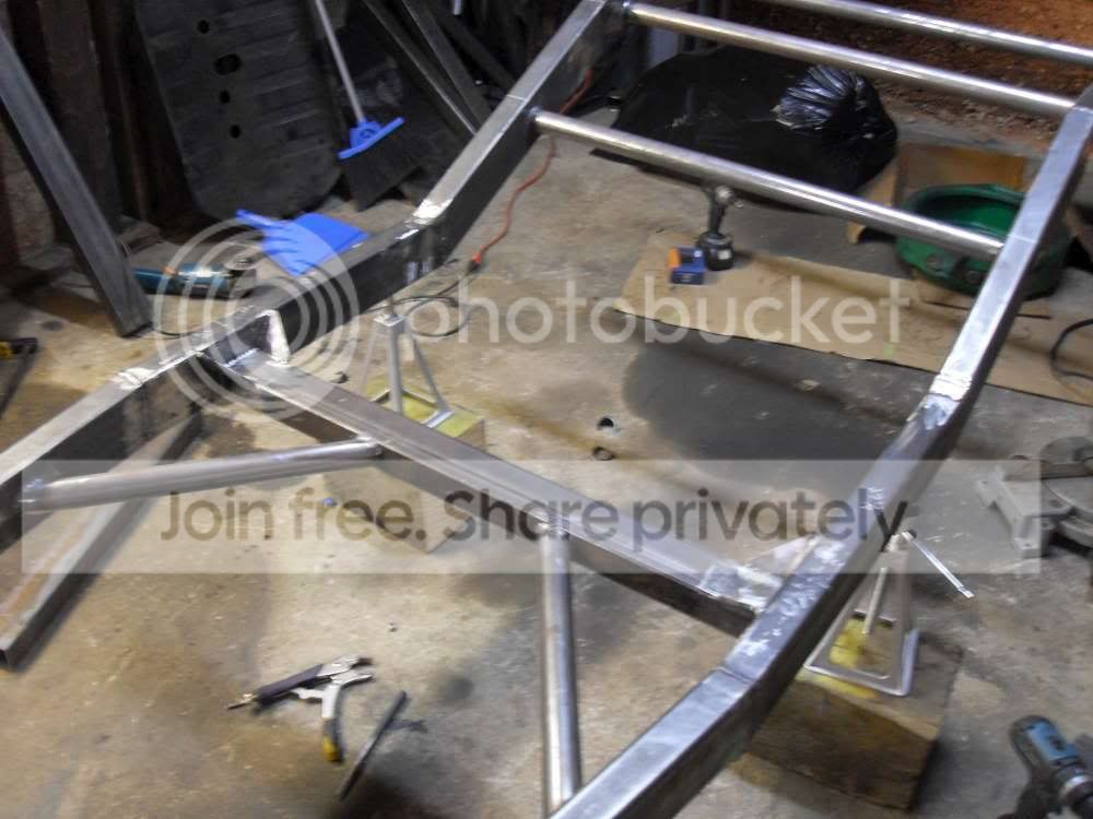

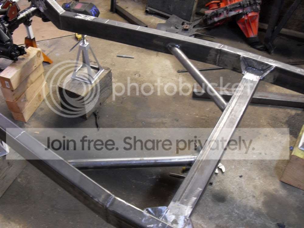

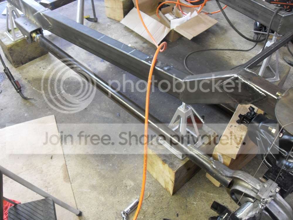

So after showing my frame to my senior at work he had a few suggestions. He said that without any diagonal support he would be worried about the rails trying to shift forward and back from each other.
I thought about it for a while and at lunch we were brainstorming a little bit. We both agreed that tying the plate coil bucket bridges together in the rear kick would be more than enough for the back but something was needed in the middle. At the same time I was worried about pulling my temporary brace off the front of the angle section of the frame as I thought they might pull in or bow out.

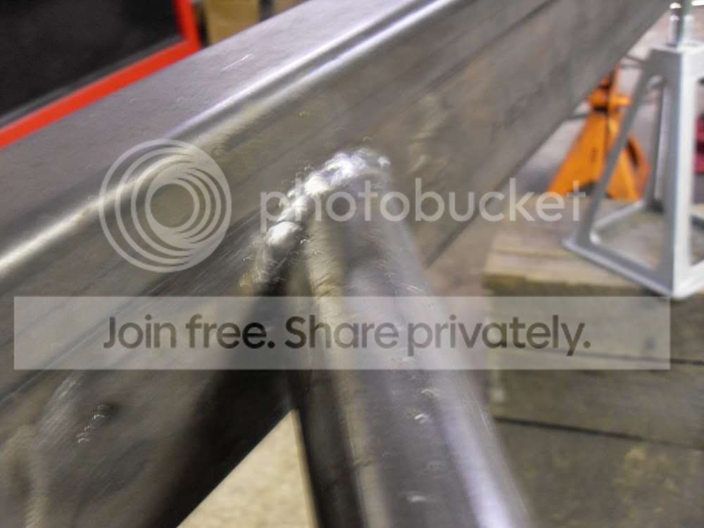

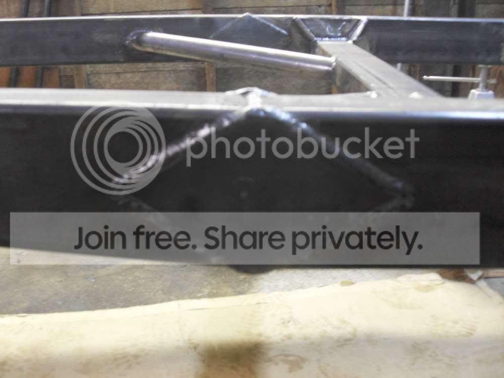

So this was my solution. Some left over HREW and wahlah.

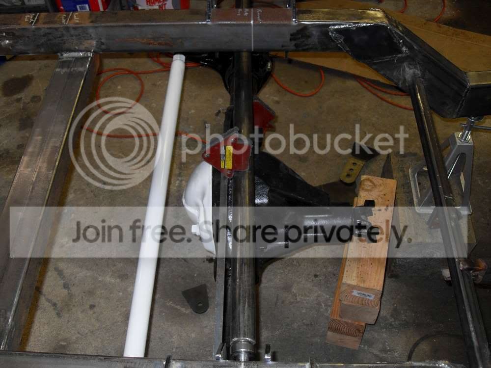

Not only does it tie the frame rails in on a diagonal but also completely prevents the angled section of the frame from moving in out out.

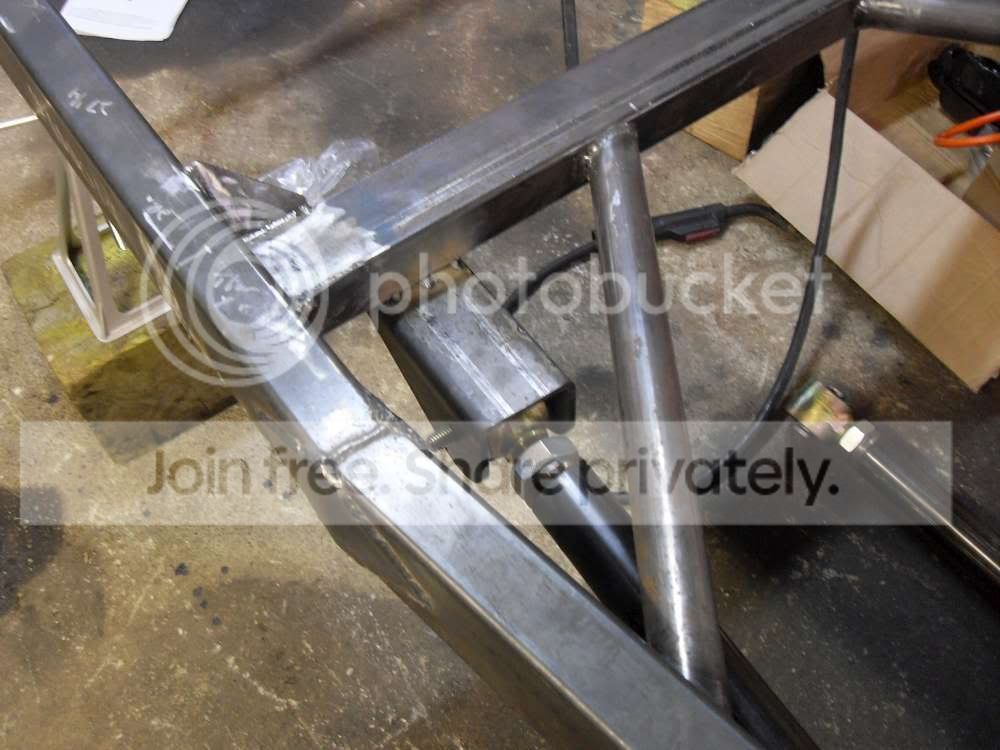

After doing this I added in a permanent radiator crossmember
I placed it all under the frame rails do to how my frame is higher than the stock one. This should alleviate body interference.
Then I cut out all the temporary bracing except the one Im leaving in until I have a motor to mockup for an engine crossmember.

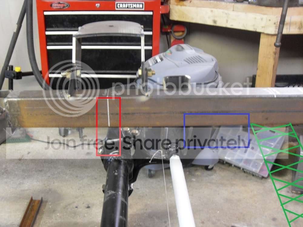

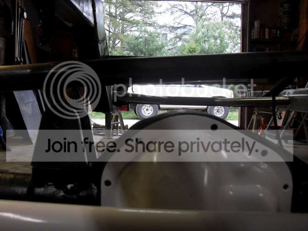

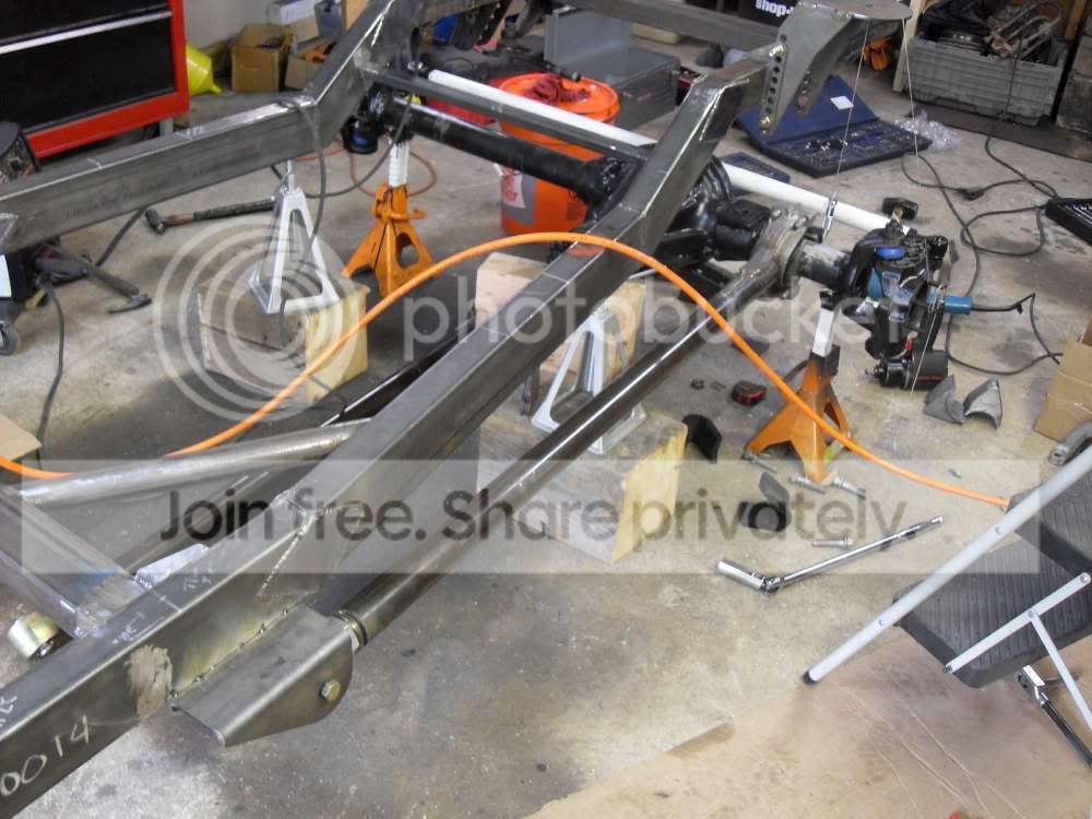

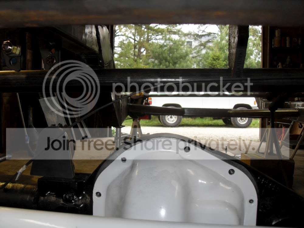

This was just a shot I took trying to envision my panhard and draglink.
Now dont make fun of my mad paint skills :pimp:
Red is my panhard mount on the inside of the frame rail on the axle center line.
green if my radiator crossmember which you can see I did in these pictures today.
Blue is where my steering box will be on the inside of the frame rail.

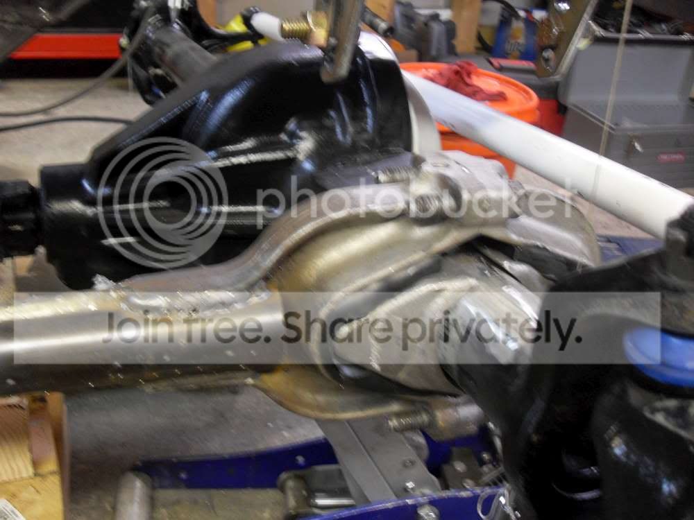

Not too much done today. Put the correct pinion nut on my dana 44 after fixing the threads, which for the record a dana 44 pinions threads are 3/4-16 if you've ever got to run a die down one to fix the threads.

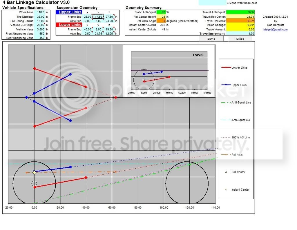

O and Ive decided to go 4 link in the rear.
Some ideas for rear suspension from the 4 link calculator. Looking good but I think ill be adding another crossmember for the lower links to mount in the center of the frame. :doah:
First though was to run a single triangulated setup and retain the stock lower links that the 3 link had. But thats gonna cause severe rear steer. Like 7* of rear steer severe which I dont want.

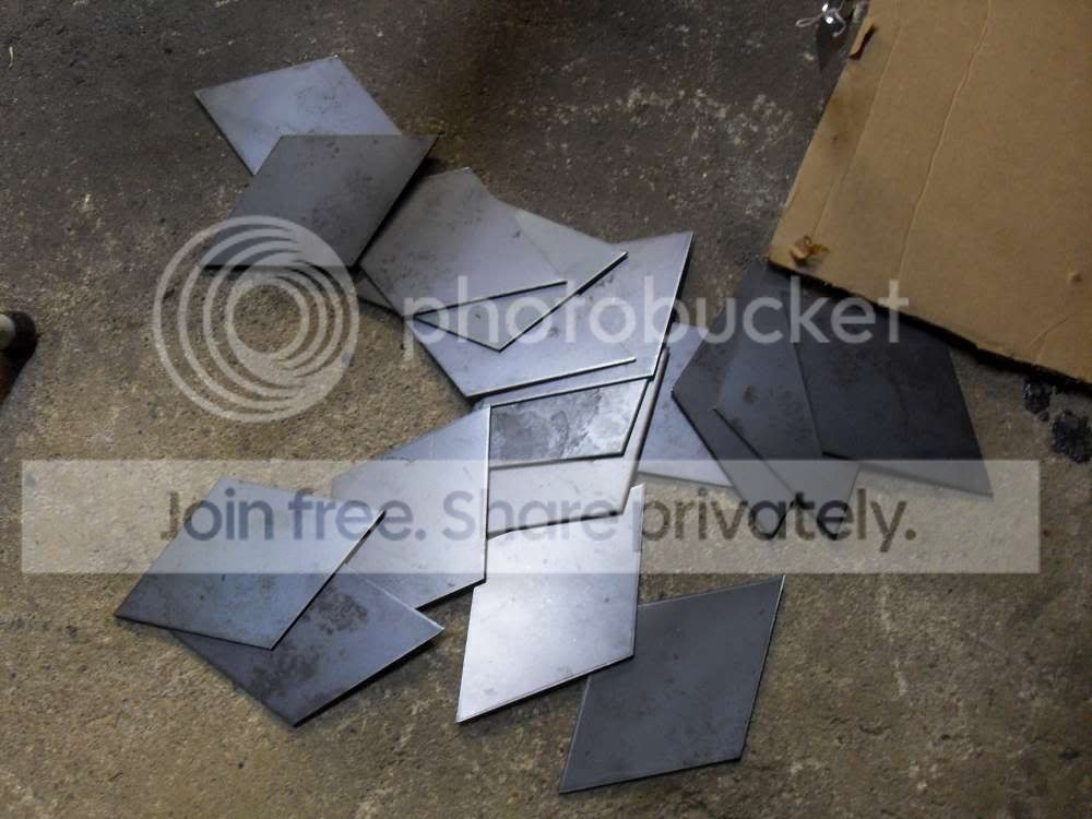

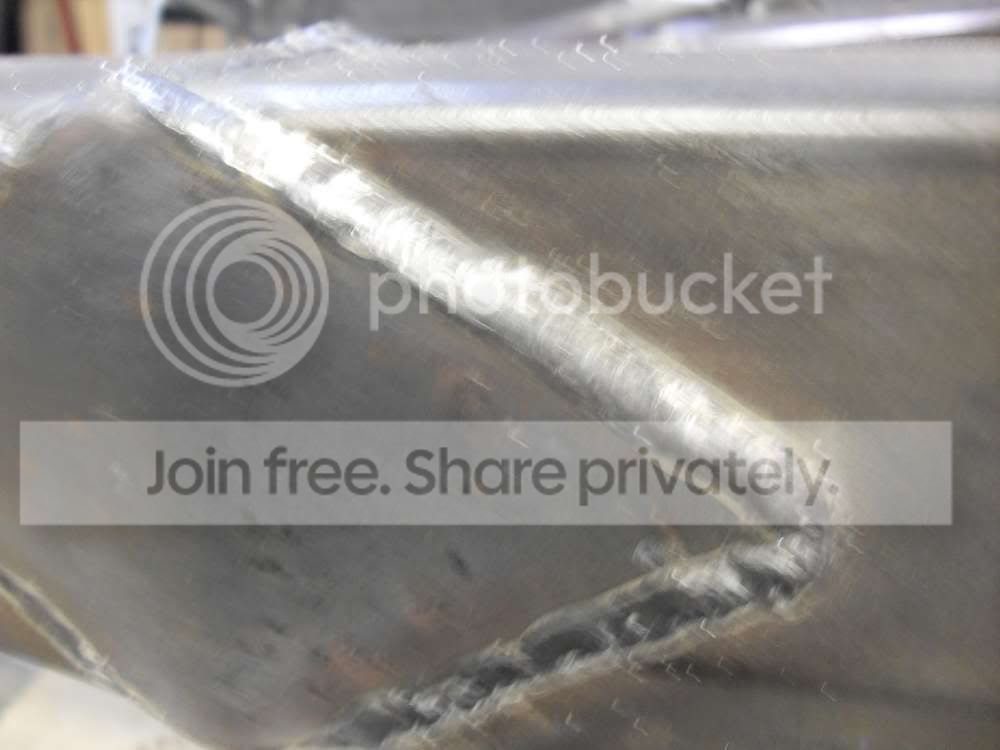

Had a yearning to get something done tonight. Tuesday is my dinner night with parents and the GF had work late so I stopped by the shop on the way home. I picked up my fish plates that my steel provider was kinda enough to chop up for me for free.

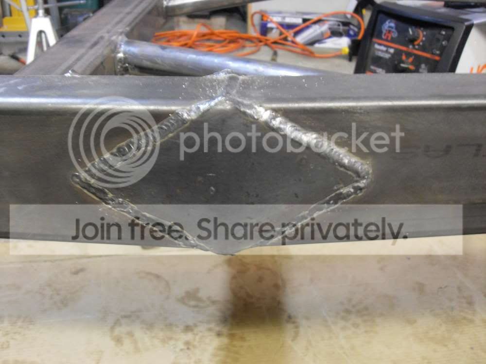

Saved me a **** load of torch time and they even threw in a few extra. $40 for 25 1/8th plate 4in side diamonds!
I got started on the only 2 joints that were ready. Every other joint needs to be filled and tapered in with plate or might have a crossmember landing on it for my 4 link...
Pics
And 4 down 16 to go tomorrow... :doah:

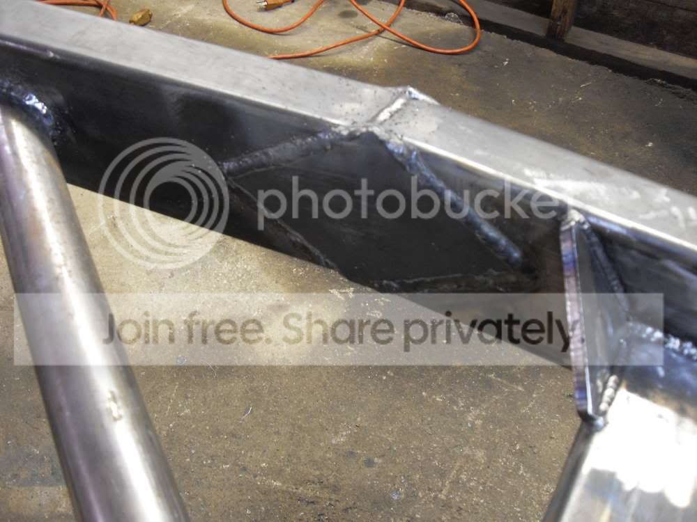

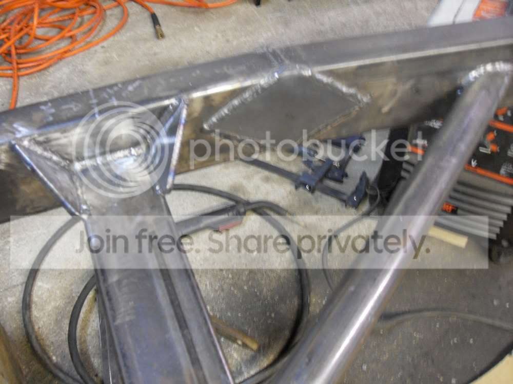

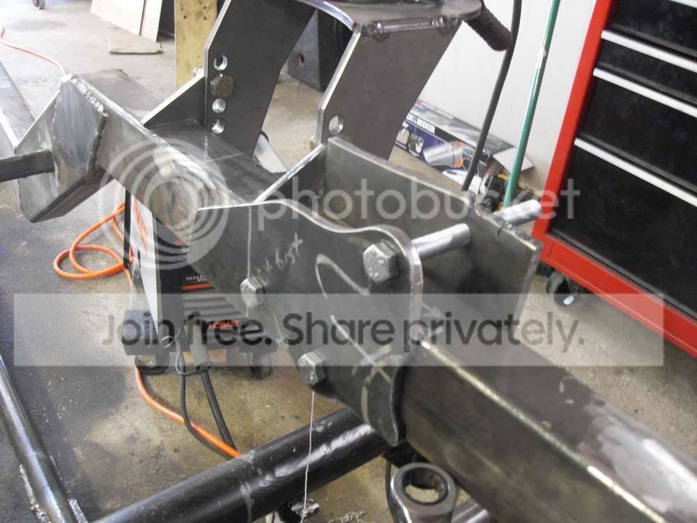

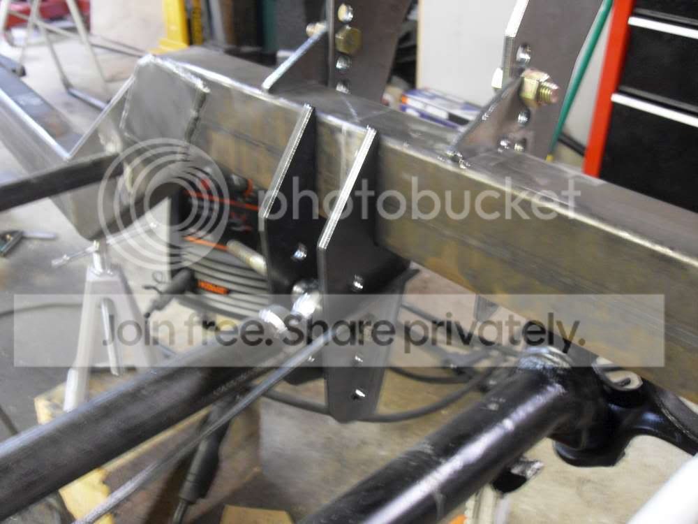

Got some work done last night. Filled the gaps on the front riser and fish plated it.
Knocked out my last temporary crossmember cause it was in the way of my fish plate and the damn frame bowed in 1/8th an inch at the back of the top riser. Was lucky enough that knocking it back in lower down put everything back into alignment but Im going to have to either figure out some way to stress relieve the frame or just retain a temporary crossmember until I make the engine crossmember.
Here the new, inside the frame panhard bar mount.
Not sure if you can see the black line in the above picture but Ill be trimming the bottom two holes off this bracket more than likely. Just dont need that height with how little lift I have.
I also got my heim joint, insert, and bushing kit at the same time. So I threw a bolt in there to start eyeing things up.
The bent piece of flat stock is to get an idea of the bend Ill be putting in my panhard bar. So long as I make my mount high enough and set my bump stops correctly I should have 6in of up travel. Not sure how the space between the diff and the bar is gonna go when I stuff just the drivers side tire though. Wont really be able to tell til I can cycle it.
The panhard mount on the frame may or may not be on the spring pad. Ive got to get my radius arms mounted on the axles first and see how much real-estate Ive got left on the tube.
It may be half on half off but what ever happens Ill be welding a piece of 1/4in plate to the spring plate all the way around to give me a mild steel base. Just more surface area on the cast section. The way I have it mapped out in my head it will be super strong considering the brackets just welded to cast Ive seen take a beating before.

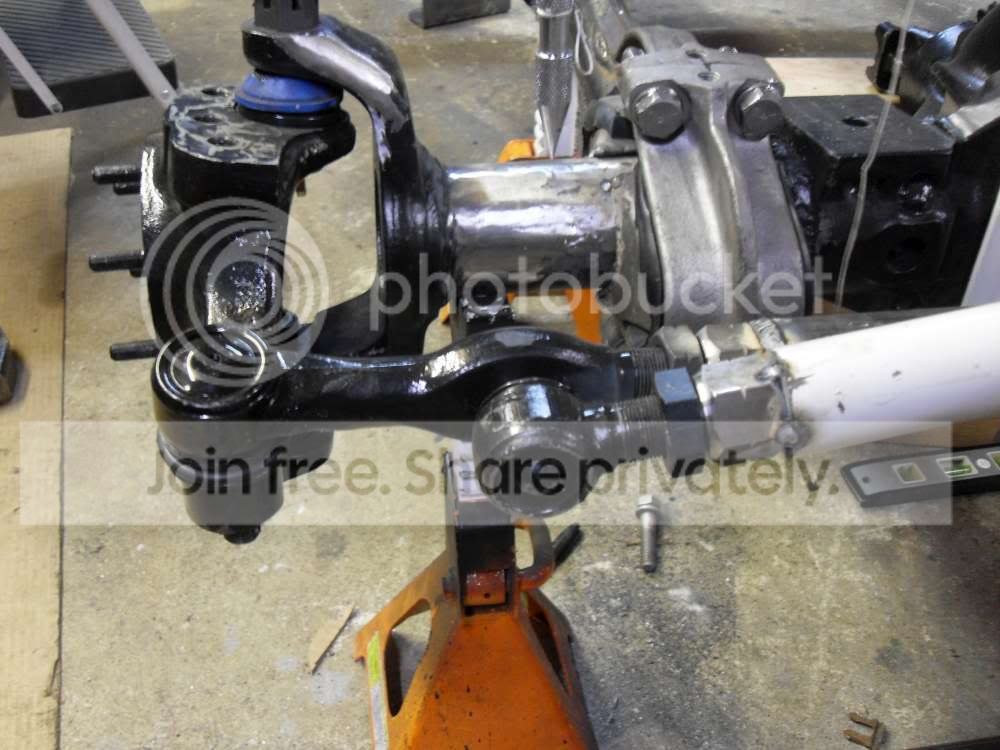

So Im going to ditch the crossover arm and run the draglink into the tie rod with some brackets and a heim like the jeep guys do.
This will give me a much shorter draglink that I can easily match a panhard bar to near the spring perch like I was originally planning.

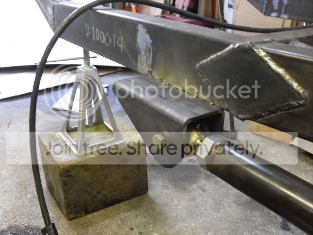

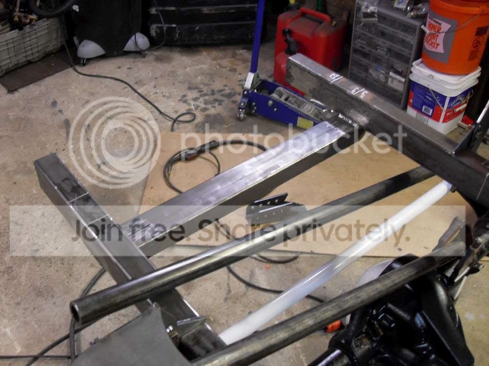

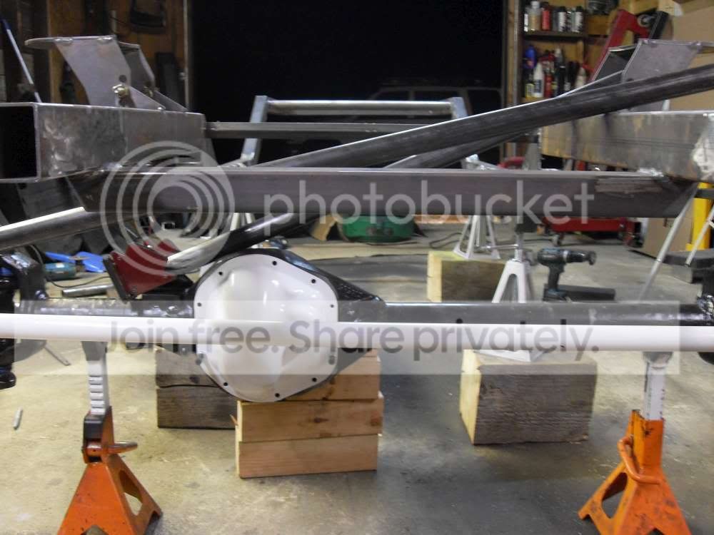

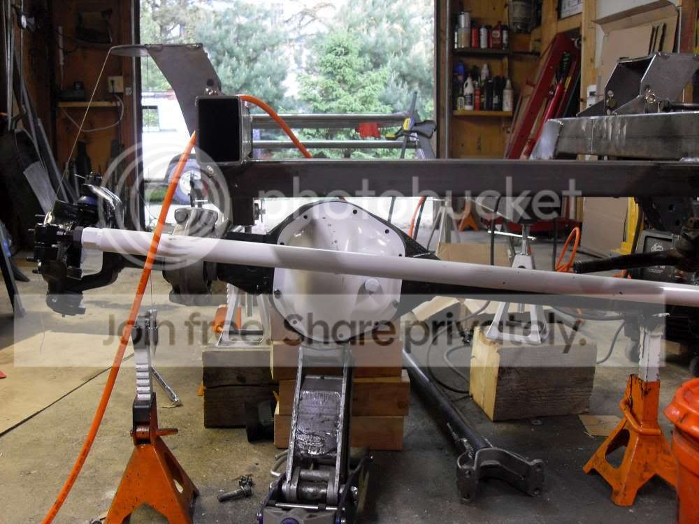

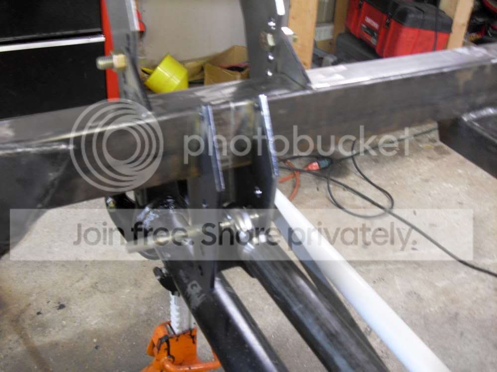

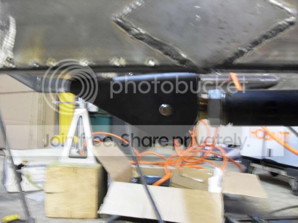

Well a bunch of parts came in last night so I brought my radius arms to my shop from work and started eyeing things up!
The axle wedges that mounts the radius arms are designed and angled with the bronco frame and axle width in mind.

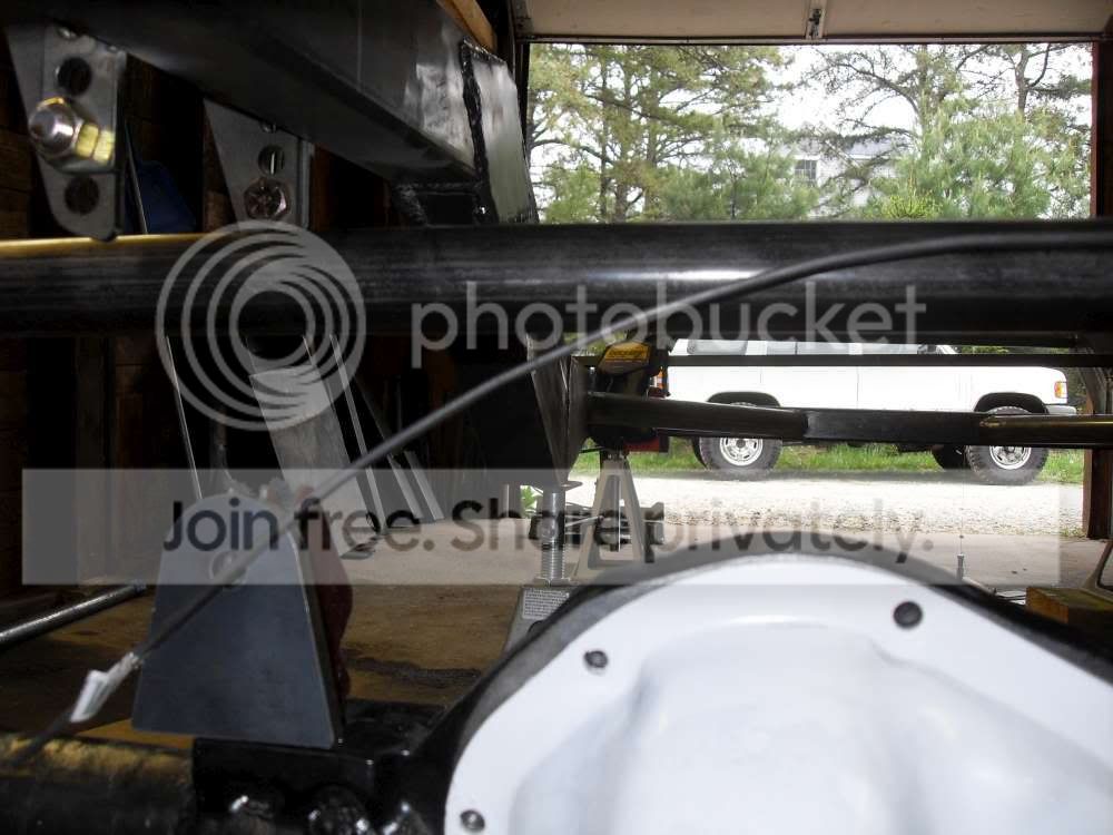

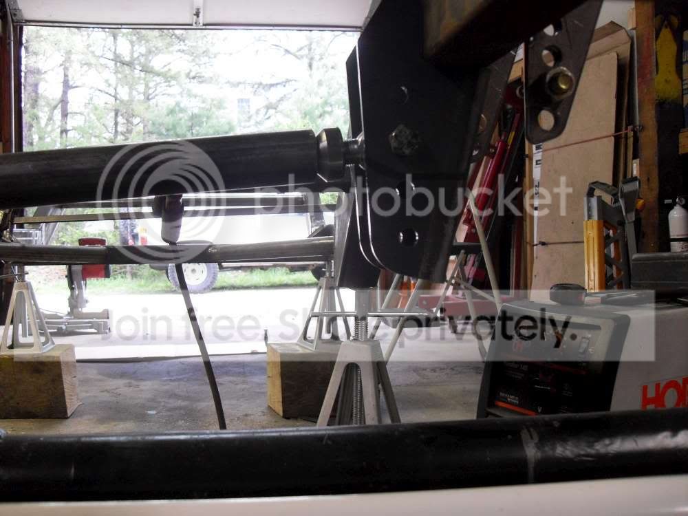

First I tried outboarding the arms. But looking at it they would be in the way of my slider supports and having the arms bow out from the axle is bad for geometry.
So I reversed the wedges and think it will work quite well. Ironically despite no planning my mounts wound up in boarded on my "torsion bar" crossmember.

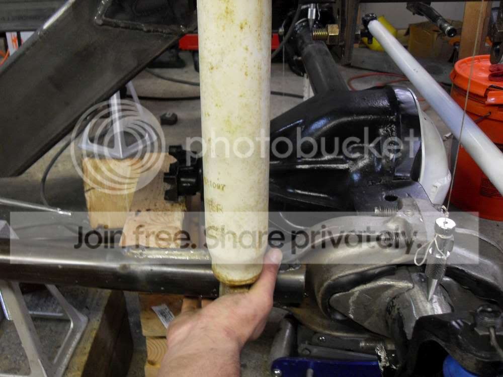

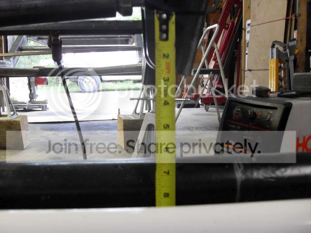

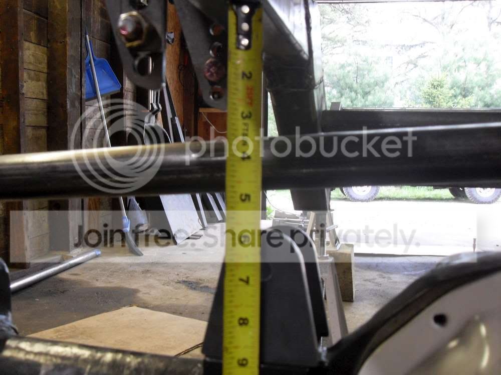

So obviously the downside to inboarding the mount is the up travel being limited by the link/radius arm hitting the frame. So I threw a jack under the pumpkin...
Exactly 4 inches of up travel before the arm bottoms out on the frame. I figure I can probably get another 2in of up travel at the axle by spacing the link mount off the crossmember 1/2in to 1in.
I was shooting for between 4 and 6in of up travel, more than Ive ever had in a leaf truck lol.

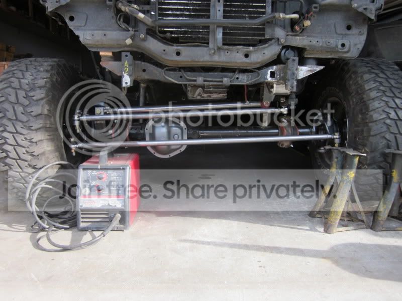

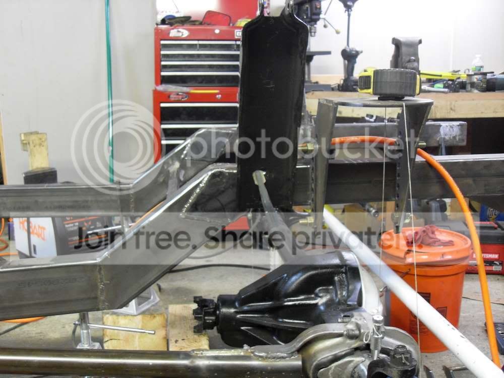

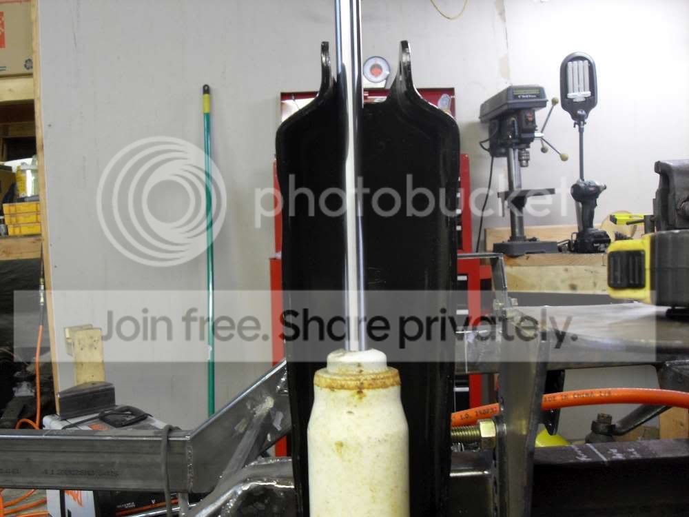

I also snapped some shots of my shock towers.
They'll mount on the side of the radius arm as show. Things are shaping up. Had to call it quits before I wound up being there all night and being dead at work tomorrow with a concert to attend afterwards...

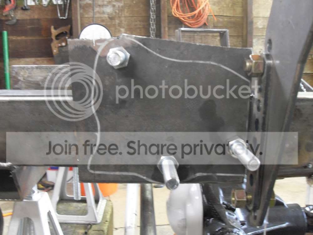

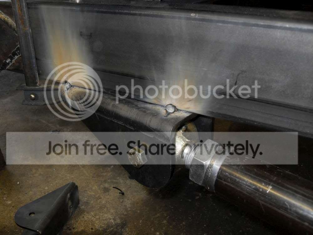

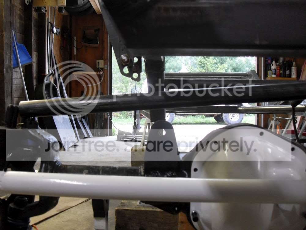

So my first dilemma last night was figuring out how to take some of the angle out of the way the radius arm wedges are design to mount. So I ground the wedges down a little and tacked in a shim to re-align them a bit more straight.
After some tweaking I got the mount under the frame and threw some heavy tack welds on the mount.

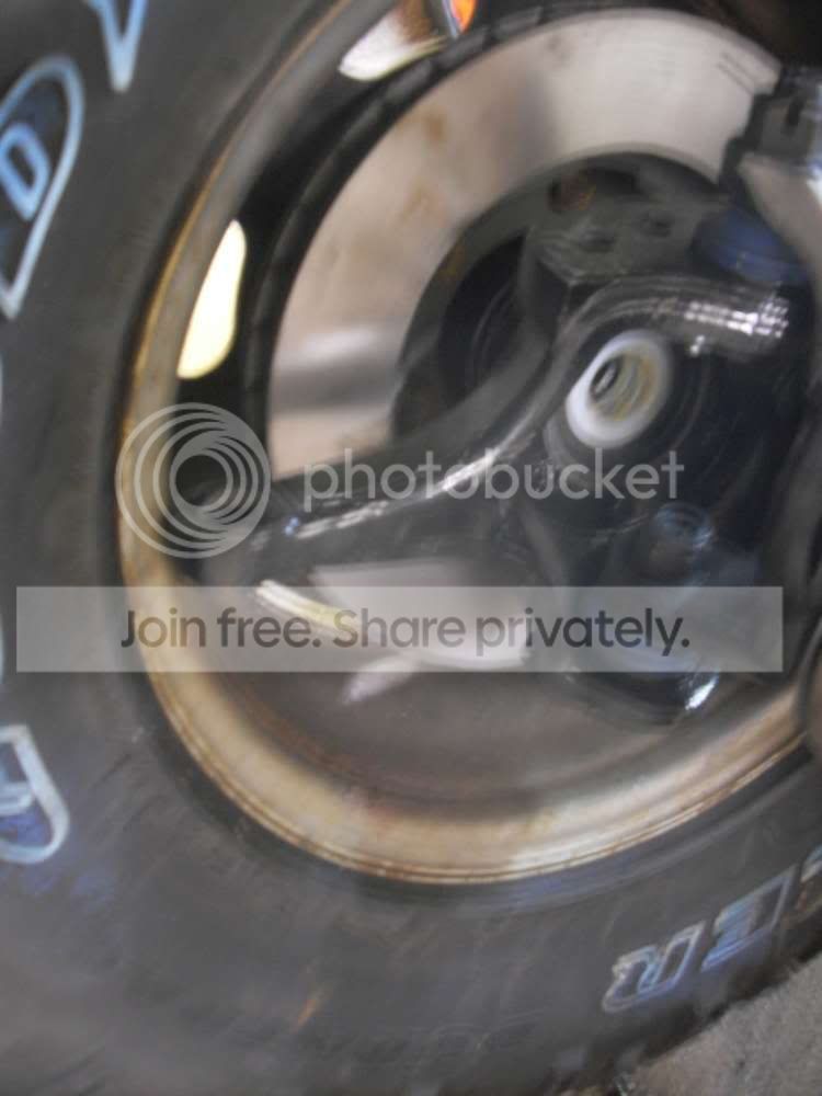

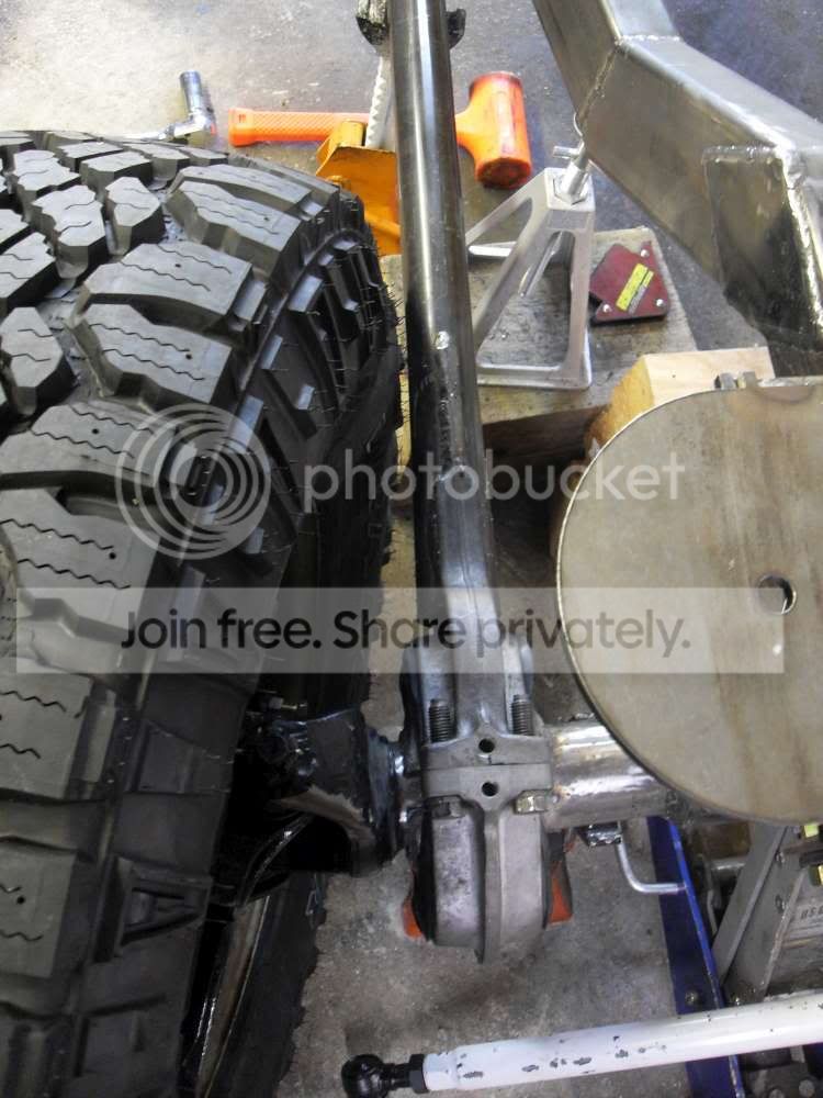

Then I figured I better test for that dreaded tire clearance that ford style radius arms are notorious for. I realized two things: I should have built my axle wider, and my IFS stock wheels will never work.
The stock wheels are 16x8 with 6in backspacing, or there abouts. They rub the radius arm like no ones business, not even close to the original steering angle. But that was a minor problem considering the fact that they hit the tie rod arms cast into the knuckle.
So obviously new wheels are in my future. I have a feeling Ill be running spacers up front too :rolleyes:
From a rough mock up it seems like if I leave the arms where they are Ill need 2in back spacing wheels to clear full lock. Obviously I can get that a jillion different ways, probably 4in backspacing wheels with 2in spacers.
I think Im gonna cut the spacers off the wedges and get the arms angled in more and possibly run a crossmember where they mount. I dont want this truck getting stupid wide on me and Id like to clear 35s in the future.

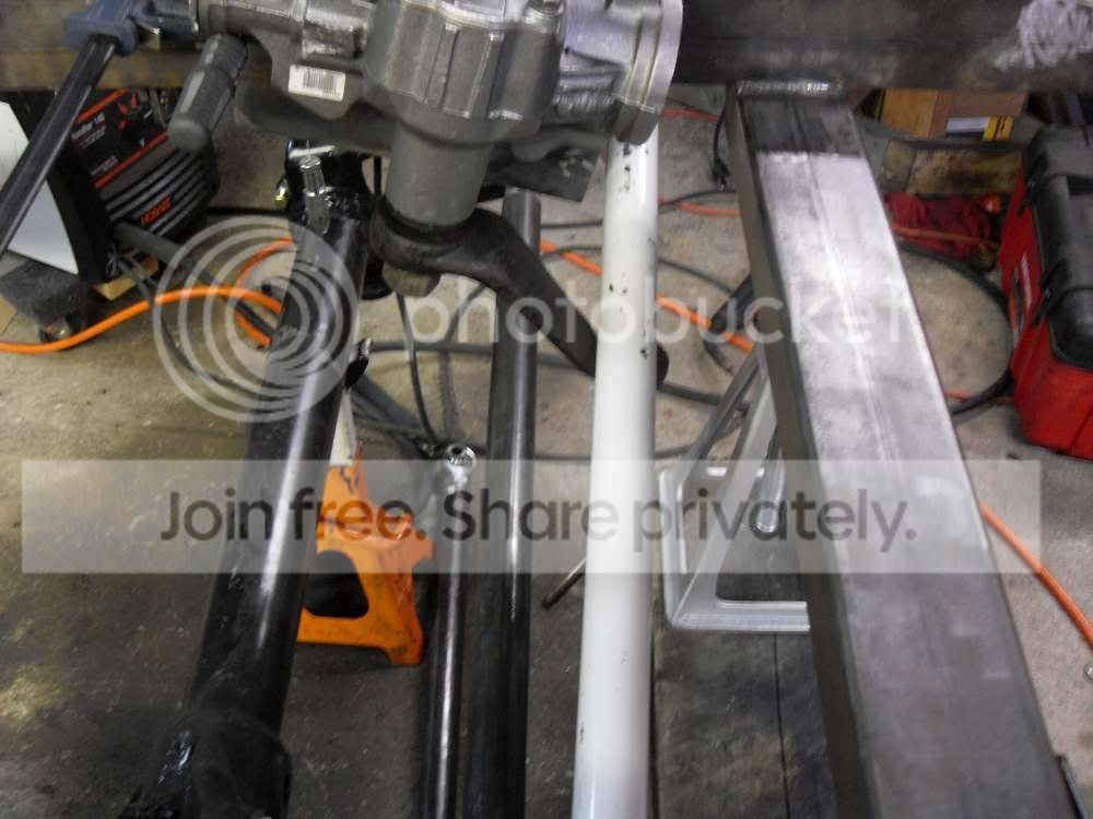

O the bright side I did get my toyota steering box. I had no idea it was an inside the frame box but it looks like it will be perfect.
So funny story. Apparently when I order a toyota IFS steering box they decide to send me a Right hand drive FJ 60 steering box.
IDK how the hell that happened but I think Im gonna roll with it. Its got a forward facing pitman arm like an astro box except its nice in the way that the body of the box is over the frame like other toyota boxes.

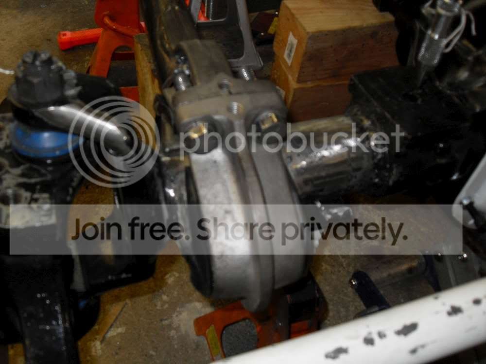

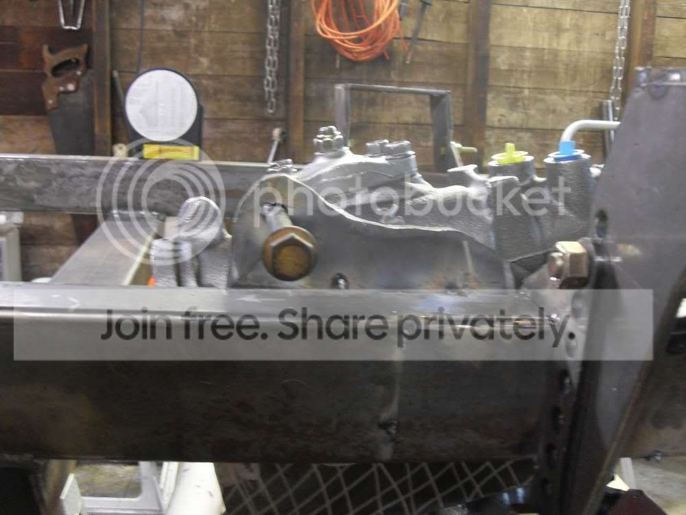

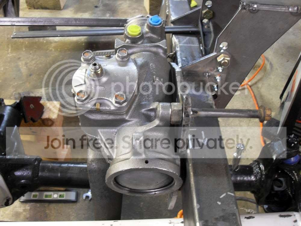

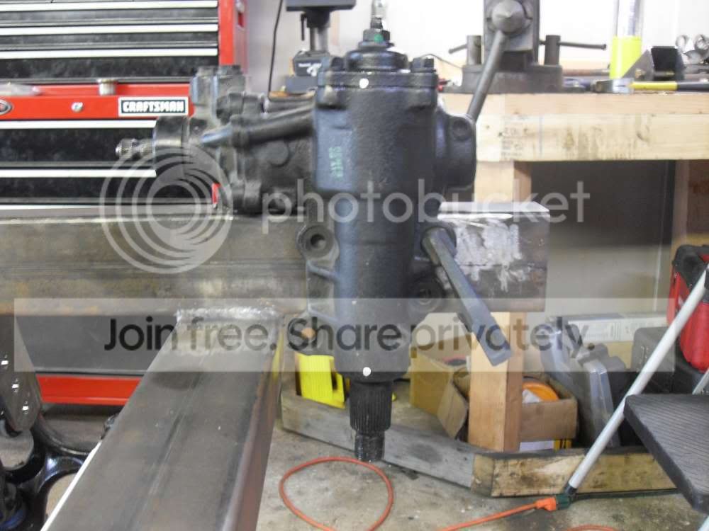

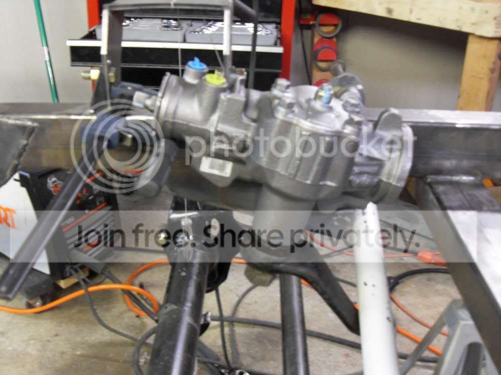

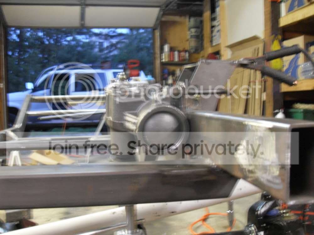

So I decided to order an astro van box and see if I could manage to squeeze it on the frame.
Le results were decent.

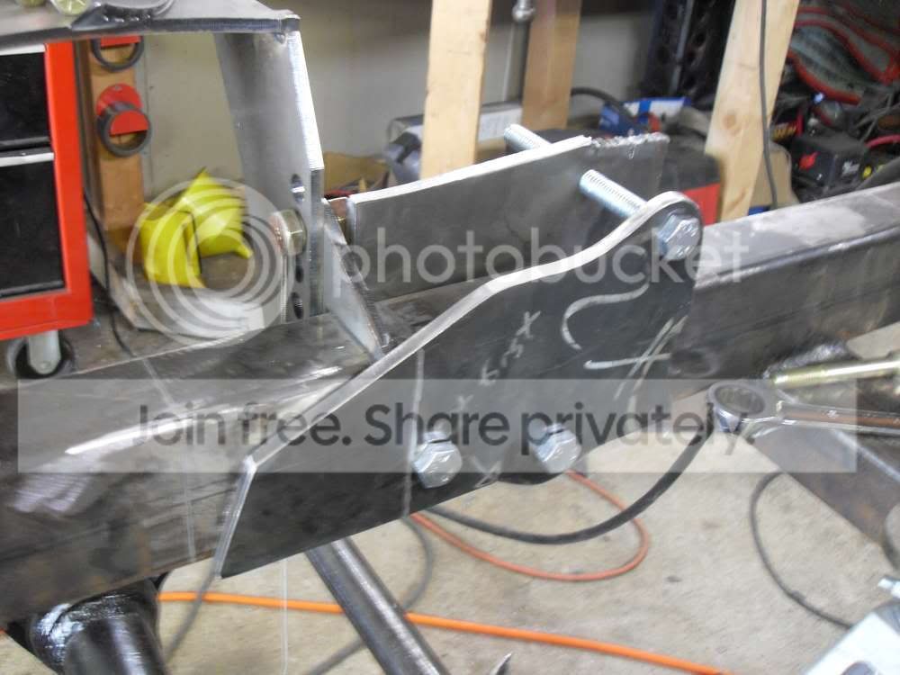

Began making a mount plate out of 5/16ths plate. I started off way too high and way too big with the plate but after playing with it I figured out where I want it.
You can see the back side of the plate and how much overhang I need to cut off under the frame here.
Ordering this box was my last ditch effort to make an inside the frame steering box work. An actual right hand drive toyota box would have packaged better cause the box is mostly above the frame rail but I feel this will work. And if I run into issues Ill simply mount the motor offset in the frame as a work around.
I also moved my radius arm mount wedges back in where I originally had them against the spring pad. I picked up a piece of 2x5in 1/8th wall box that Im going to french the mounts into to gain more clearance instead of having the bracket totally hang below the frame.

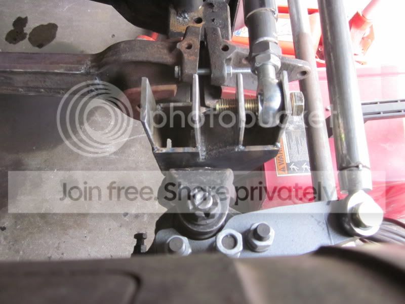

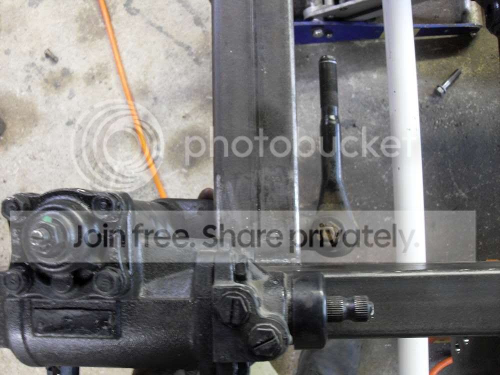

Yesterday I made my new inverted T tie rod. Much thanks to WFO for giving me some tips on draglink to tierod clearance with this setup.
If you look in the steering box pictures you can see that the draglink will be on a slight rearward angle.
Also now that I had the steering box actually mocked up where it needs to be I determined Ill be running my panhard over the center of the axle like I had planned originally. It will be mounted on the axle on the spring pad and Im going to slightly modify the prefab'd bracket to give me the exact length I need to match the draglink.

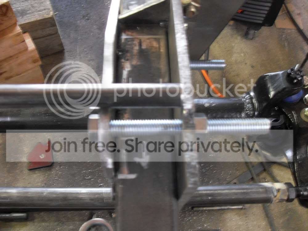

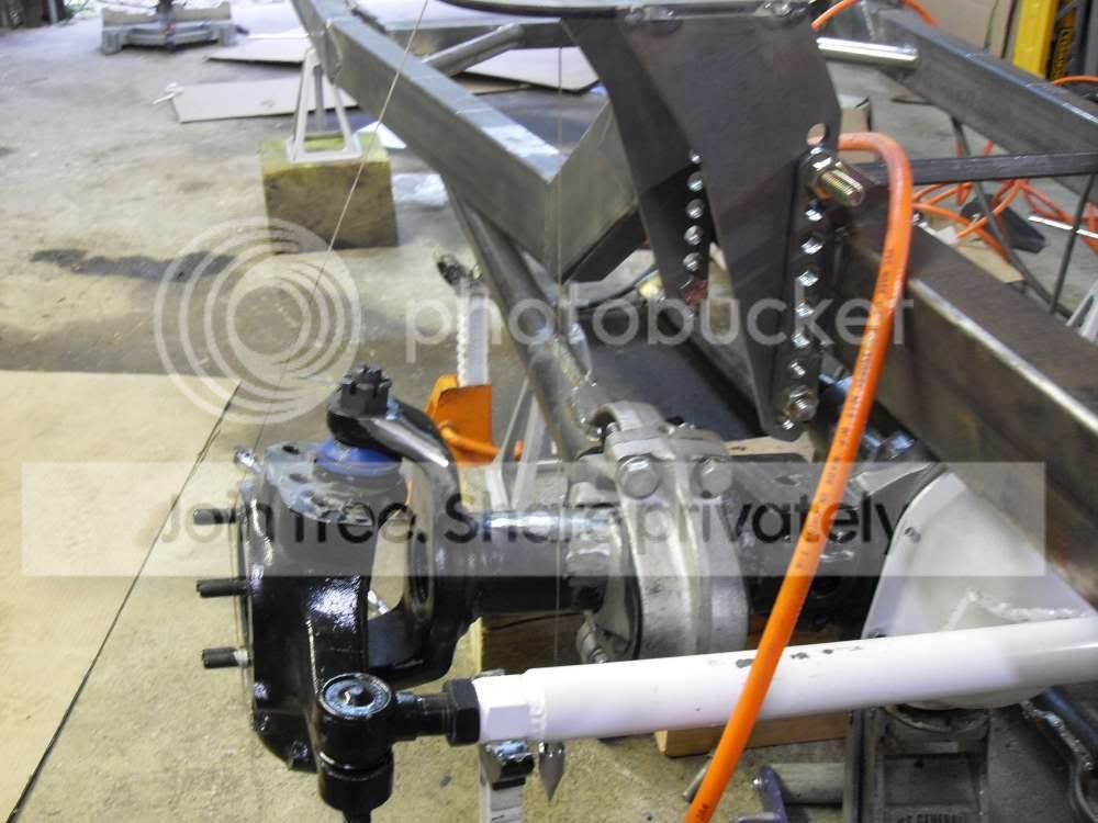

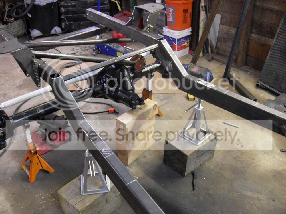

Made a little progress with my steering box mount. I got my inside plate trimmed down and prettied up. I was going nuts looking for the correct diameter DOM that was thick enough to use for sleeves and standoffs for the steering box bolts.
I decided to just run 3/8ths black pipe for the frame sleeves. They are 1/2in inner diameter and 5/8ths outer. I will bore the holes out to 5/8ths and run the sleeves through in one piece.
I also rough cut my outside plate with a sawzall and got the frame all aligned and drilled on both sides. May also wind up moving the frame side coil bucket brackets from outside the bucket to inside to add some clearance to the steering box rear bolt.
Some pics
Also debating whether Im going to box over the top of it when its done. Probably just to stop **** from getting stuck in there. Dont think its necessary at all for strength.
