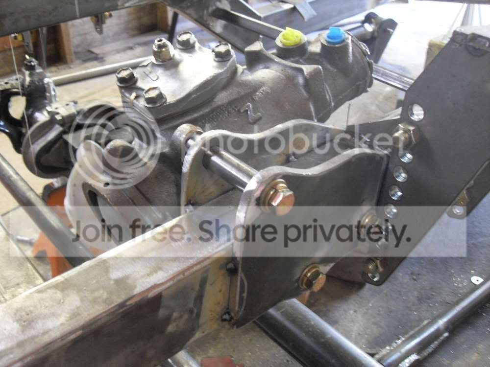

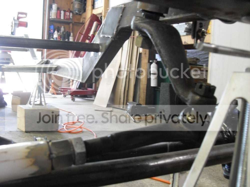

I love this build!keep the pic´s coming!
