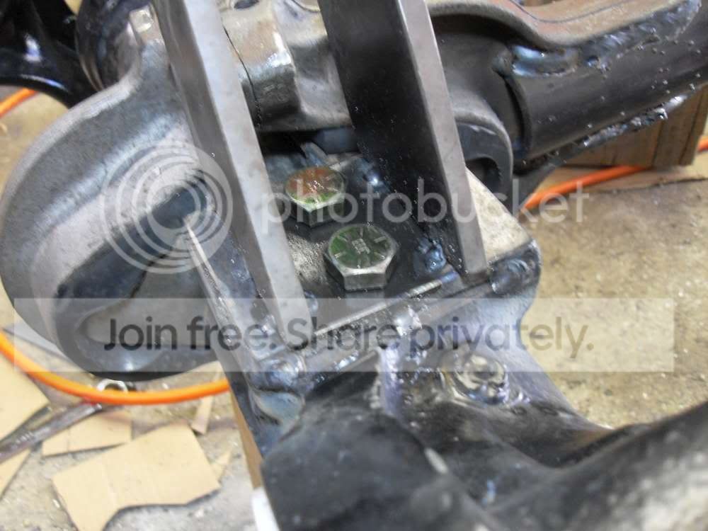

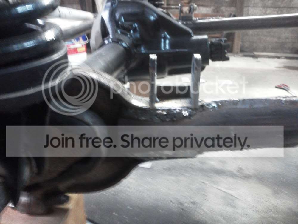

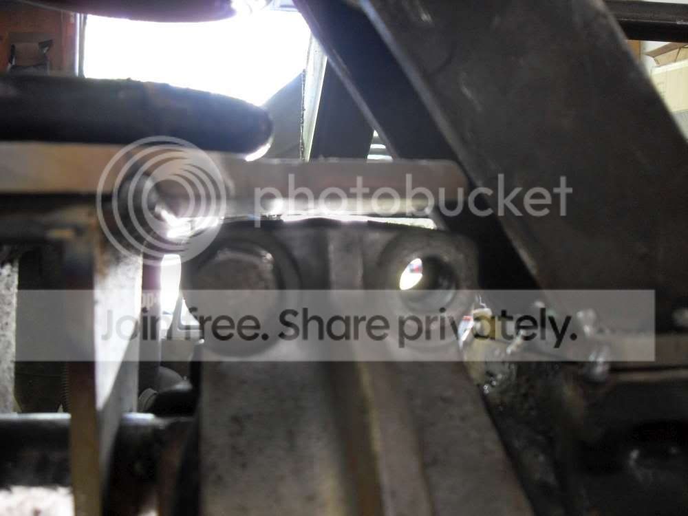

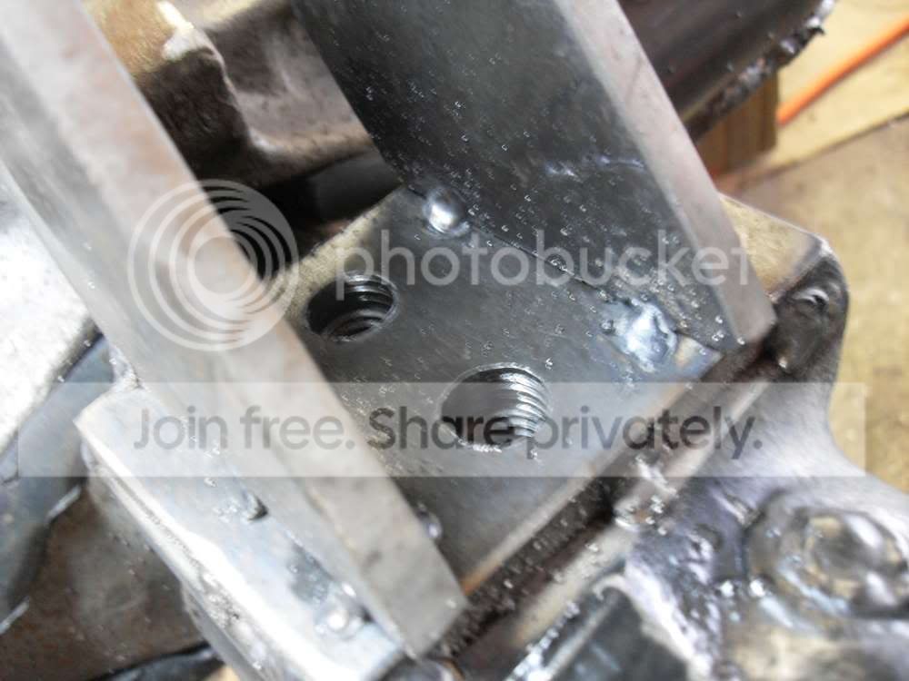

The other day I got the idea that while the panhard bar mount is open I would bolt it to the axle. I wanted to do this as a reinforcement due to the panhard mount being on the cast iron spring pad.
So I drilled two holes about 1-1/4 deep through the piece of plate that I tacked across the spring pad that I built the panhard bracket off of. I drilled the plate 1/2 and then another inch into the cast spring pad with a 3/8 bit.
Then I drilled and tapped the spring pad for 1/2in course bolts. NOW Im not worried the panhard mount will ever go anywhere. Its got two bolts, torque holding the base and its going to be fully welded and boxed on top of that.

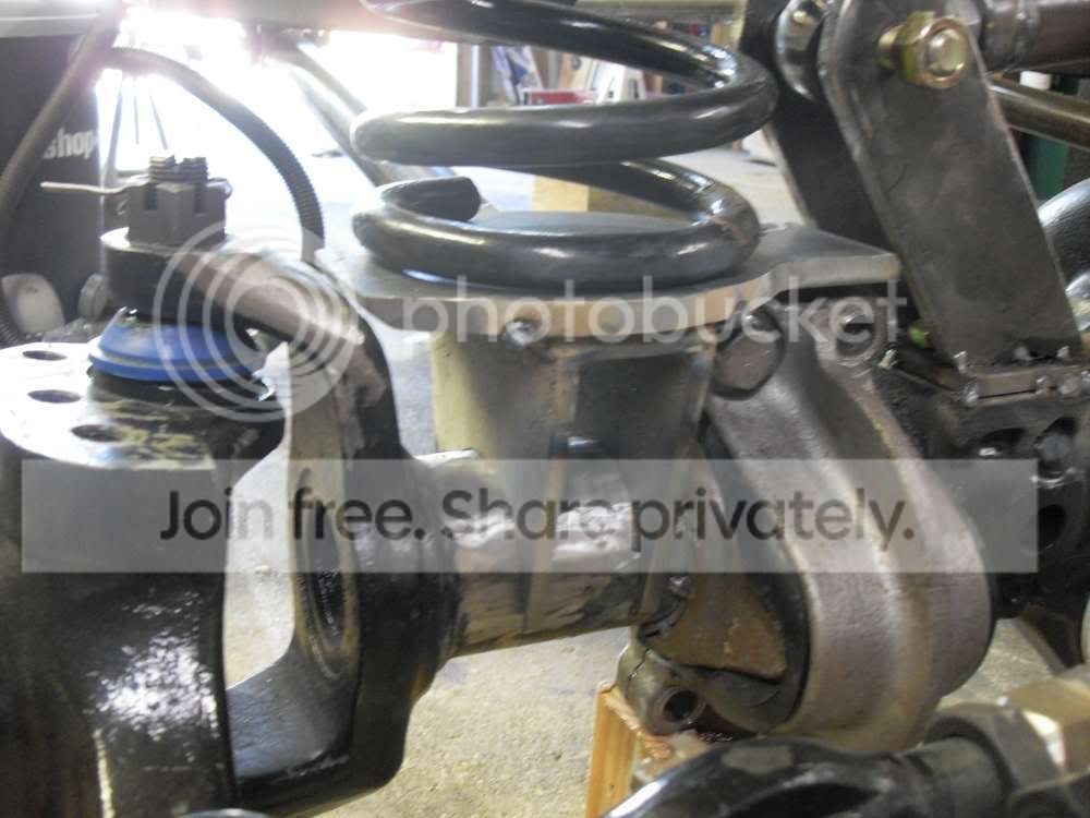

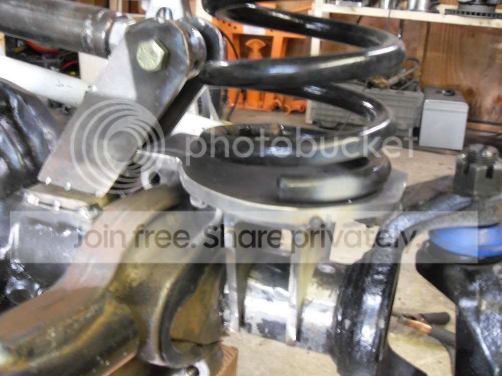

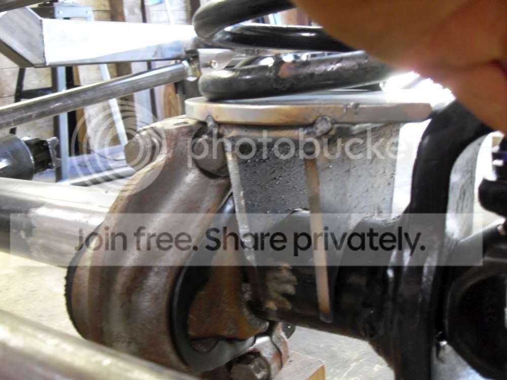

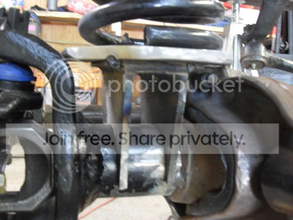

Got my lower coil mounts done today on both sides. Came out really good, was a seriously long day fighting the hole saw without the right tool to spin it and cutting 1/4 plate with the grinder not to mention making the edges nice nice on 3/8ths plate.
When I was grinding the tie in to the panhard bar mount to fit snug I got a little over ambitious. Looks like Ill be boxing the panhard bracket on the outside to make up the void.
Drivers side.

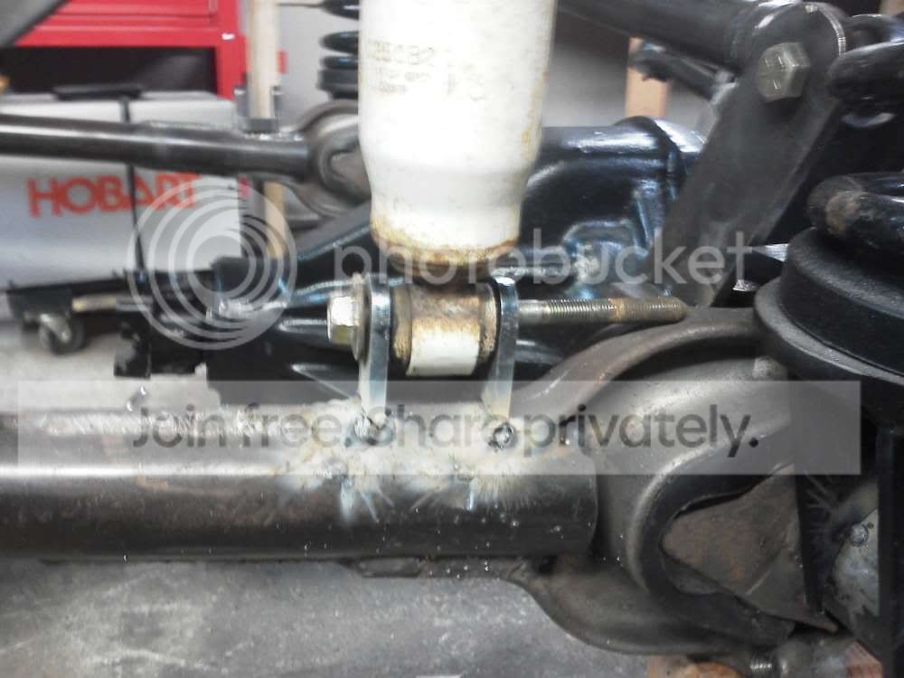

Frame side panhard bracket clearance. Still to be reinforced. Wanted to make sure it would clear before buzzing it on...

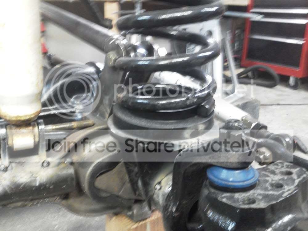

You can see with how much of the coil sticks over the radius arm clamp why I went with 3/8ths for the spring pad. Im going to add probably a capped 6" long piece of pipe in the center of the spring pad to locate the spring since I dont plan on trapping them on the bottom unless someone has anything to say against that.
The top buckets will have retainers.

After digging around on the net I think what Im gonna do is run a poly pad that gives the coil a flat bottom. Then put a piece of pipe the height of the seat in the center of the pad with a bent piece of 1/4 thick 1in flat bar across the pad.

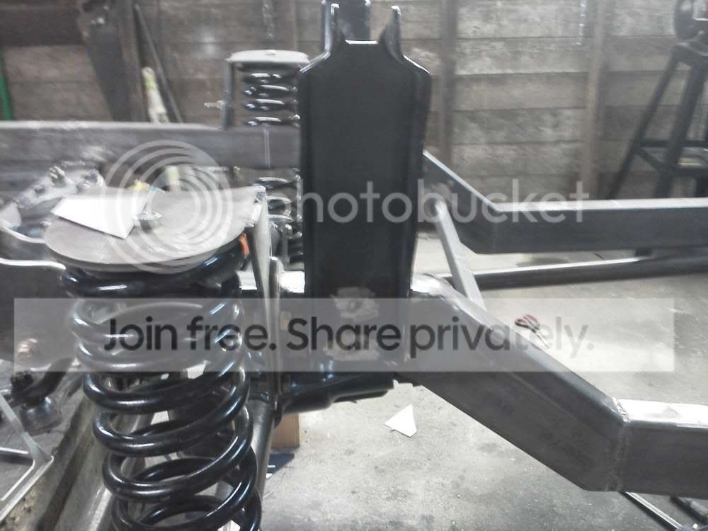

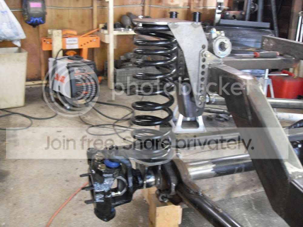

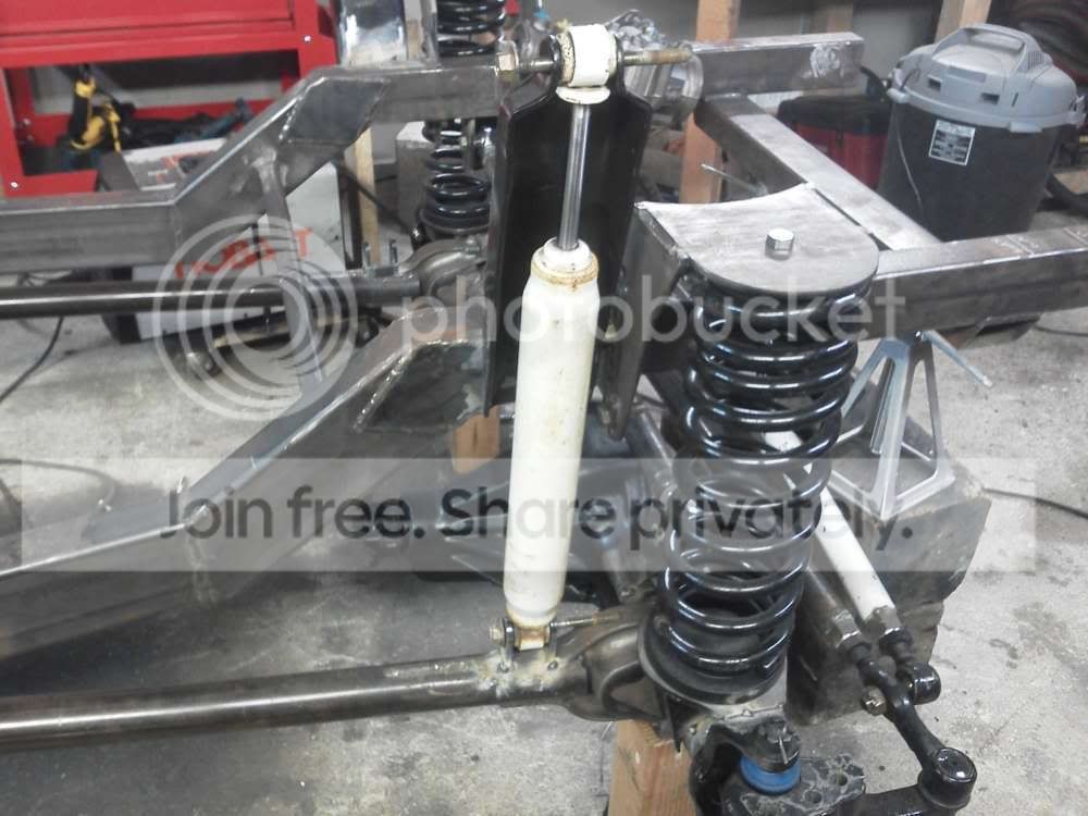

Some real progress finally. Got my coil buckets tacked to the axle last week and lined up with the coils sitting on them. Clearance is still good on the panhard with everything lined up as planned.
I made some frame plates to give myself a flat surface for the shock towers since they sit half on fish plate. Then I got the shock towers tacked on.

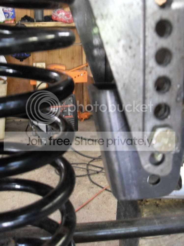

I set my shocks up for 4.5in up travel. The half inch is just a safety margin so they dont fully bottom out. I was happy I was able to leave the Ford towers uncut by mounting the lower shock brackets on top of the radius arms instead of out the side.
Theres a crap load of room around the shocks. Came out really nice.

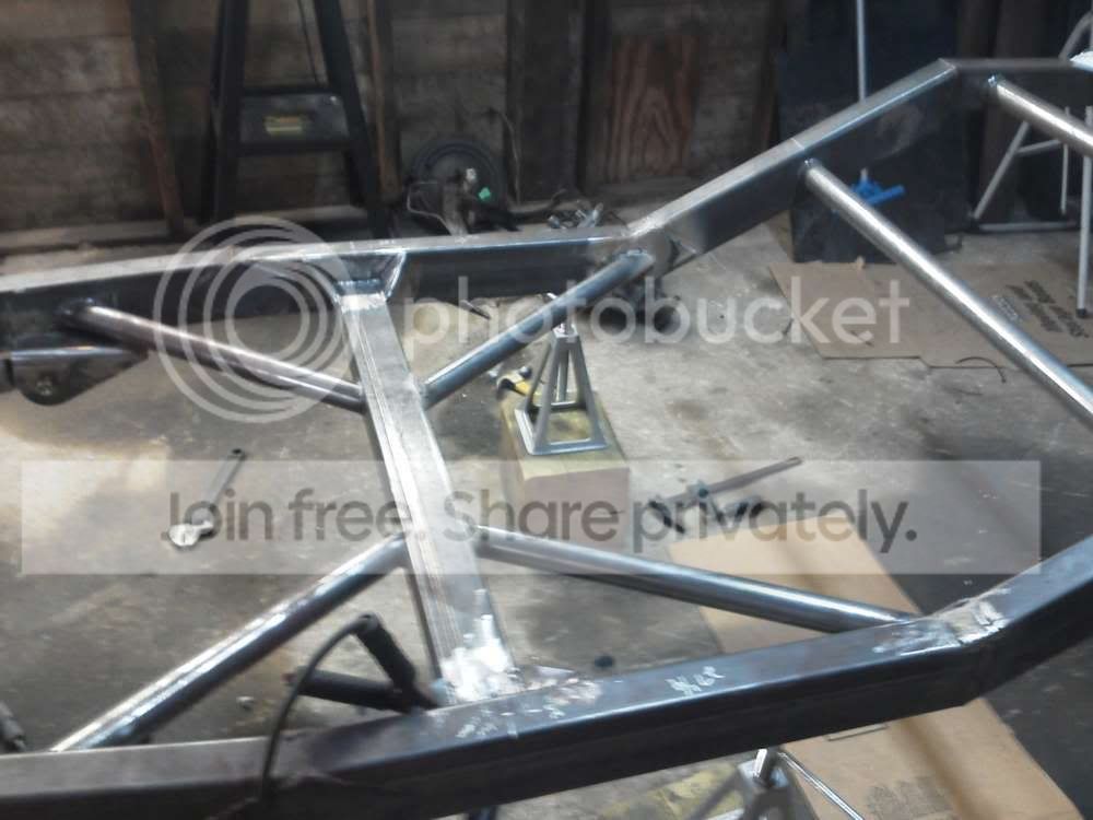

I also decided to bang out finishing my X member now that I dont have to be concerned with where lower 4 link brackets might end up later on. I fish plate the rear joint and tied the tubes in right in the middle.

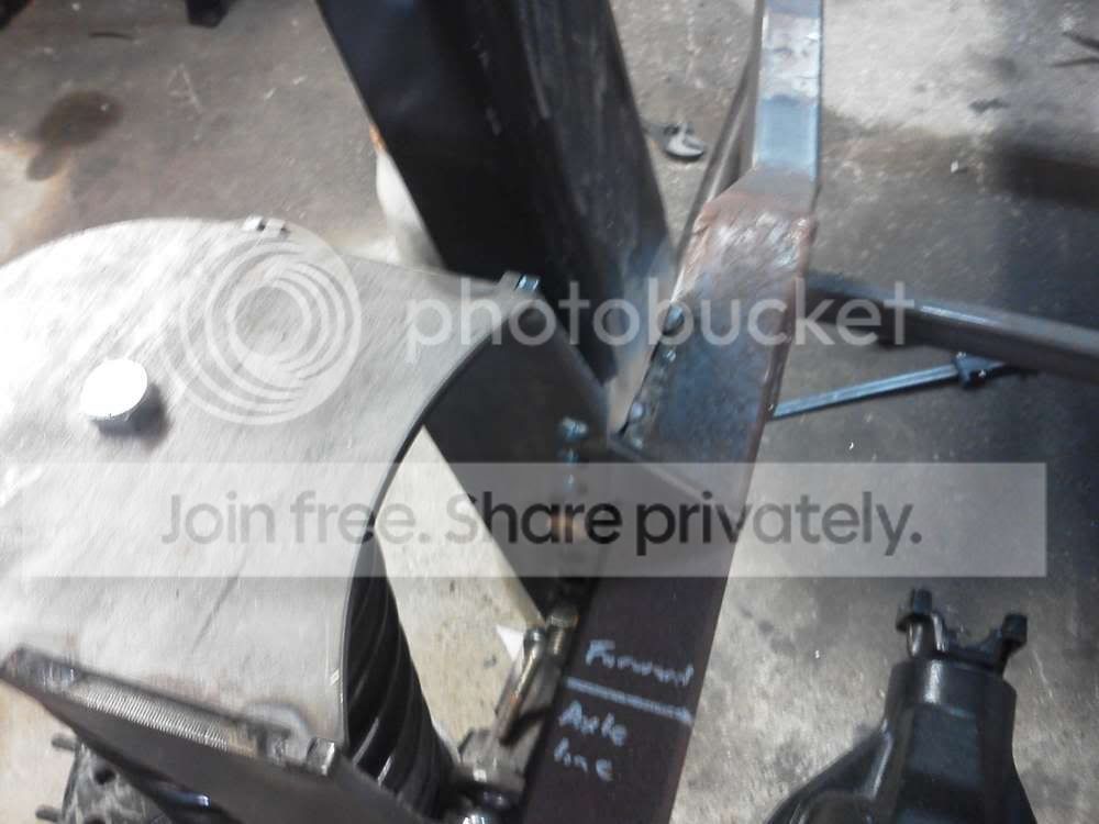

I also cut out the rest of the plates for my axle side panhard bar mount at my buddies with his torch. Now that everything is tacked the only thing left to do is add in some short pieces of pipe to center the coils with a retainer built in. After that I can pull the gears back out of the rear and fully weld up all the brackets at work.

Then we finally got to work on the frame. We got my panhard bar mount on the frame gusseted and that was it. Ive got to locate some 3in schd 40 to make my spring guides and retainers out of and then the axle is coming out to get welded up.
