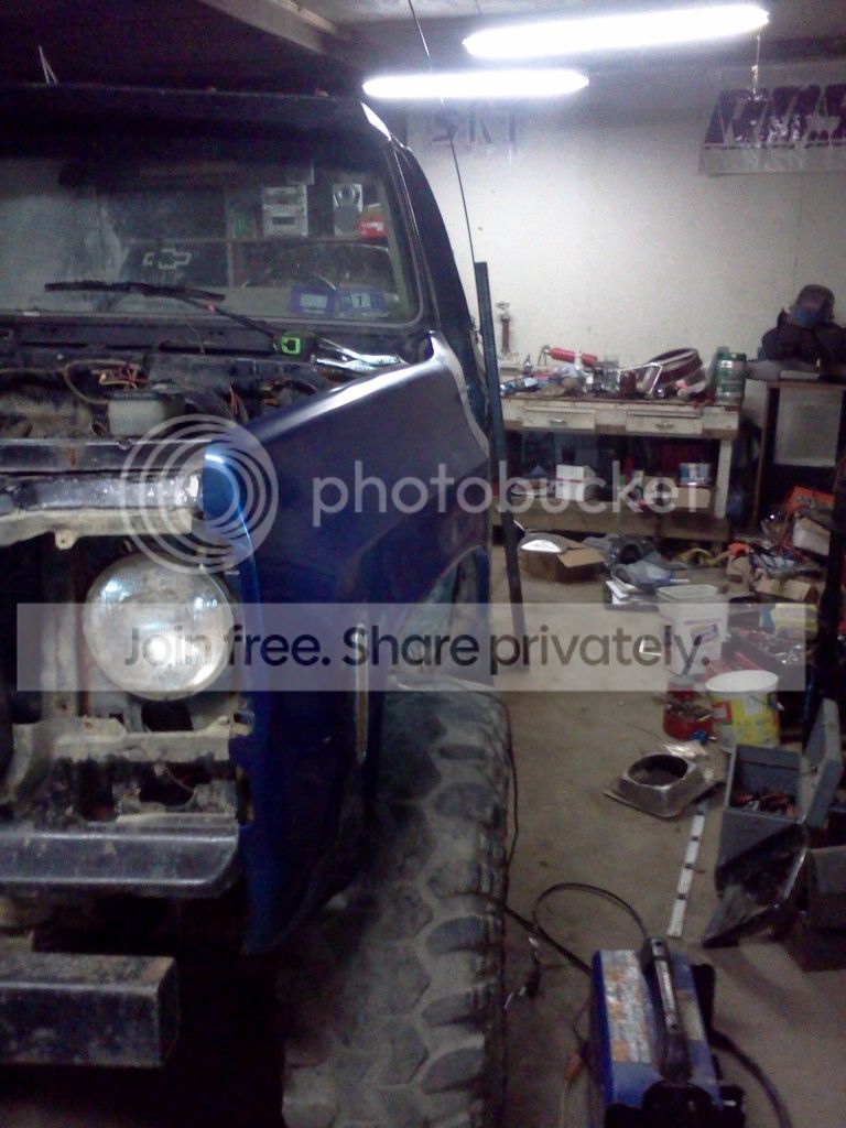

first face lift went from 85 front clip to a 78

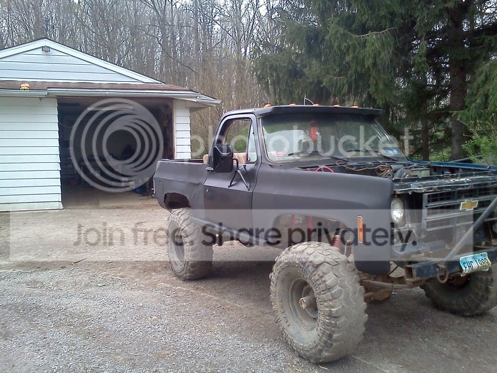

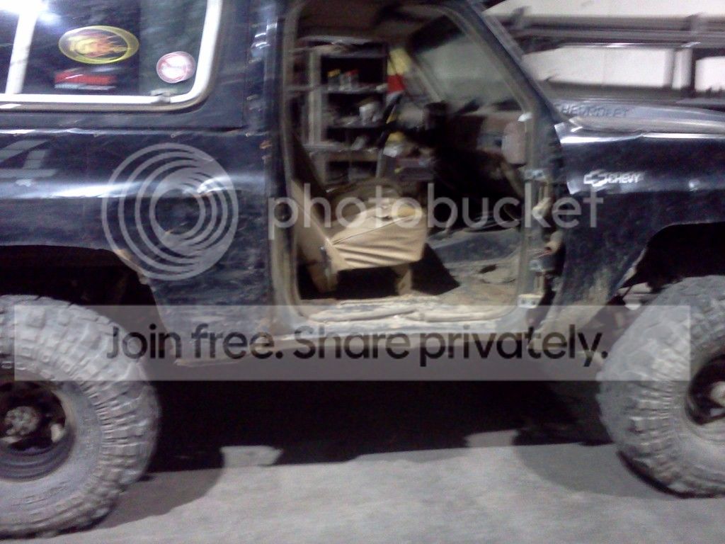

this is how i drove the truck for two years in highschool playing in the mud and being a kid who didnt know any better. the truck did have some hidden rust but it was fun for me.

half doors
and i started getting ballsy with it too leading to more body damage.

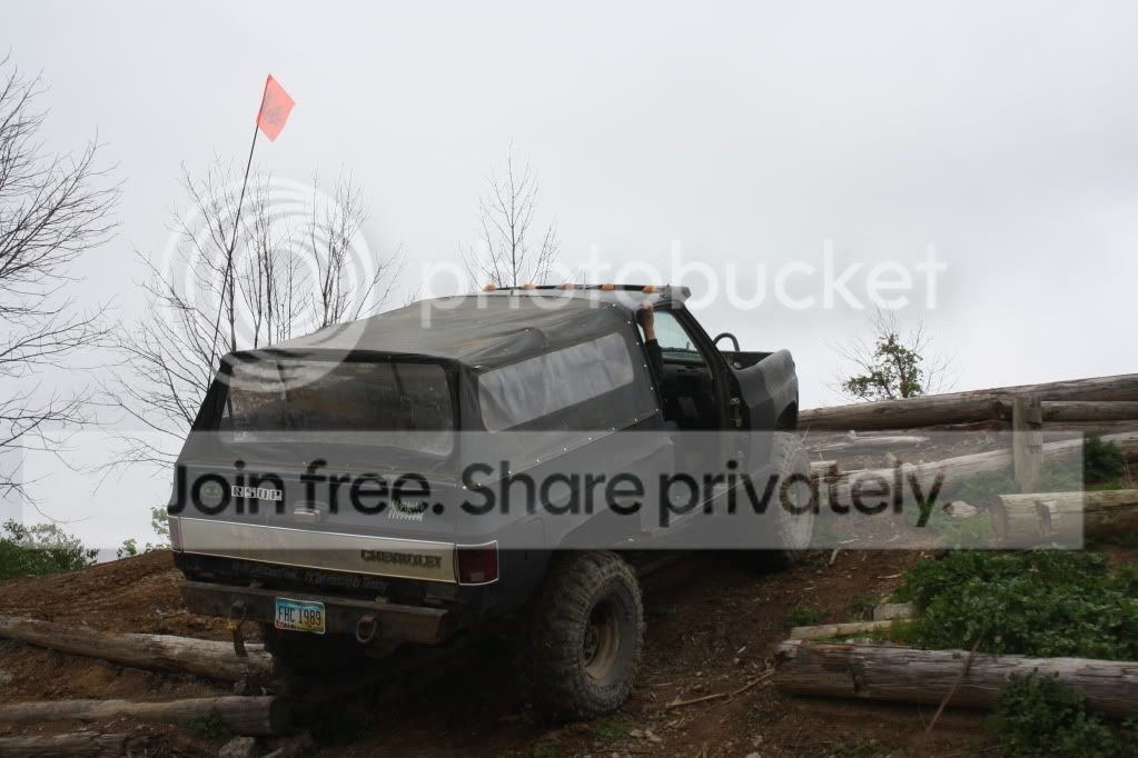

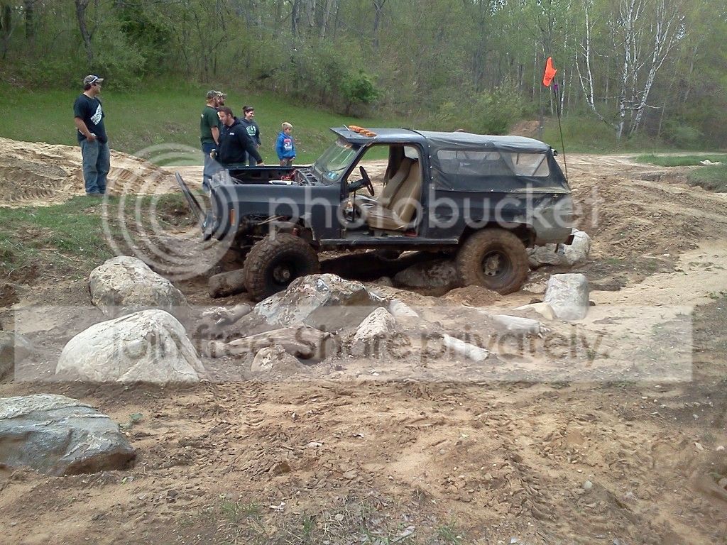

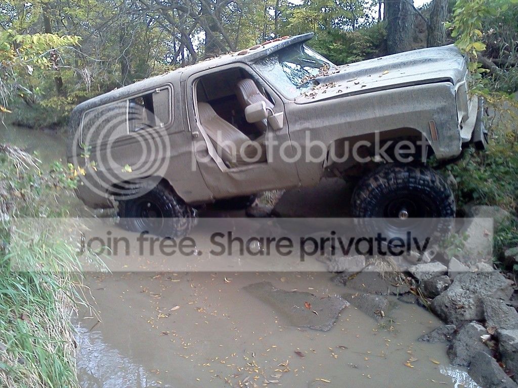

the truck saw parks such as badlands offroad, haspin acres, bundy hill, big rock, and more all leading up to making it look like this.

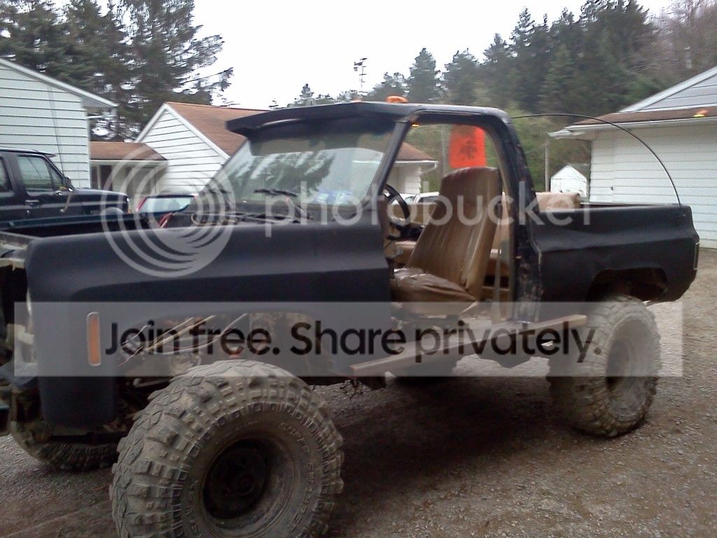

first major project on the truck was to dove the nose in six inches on either side pictured here(sorta crappy but the only two i had of the first attempt)
as you can see the fenders where rough and i didnt get anything to line up right but i left it for a bit.

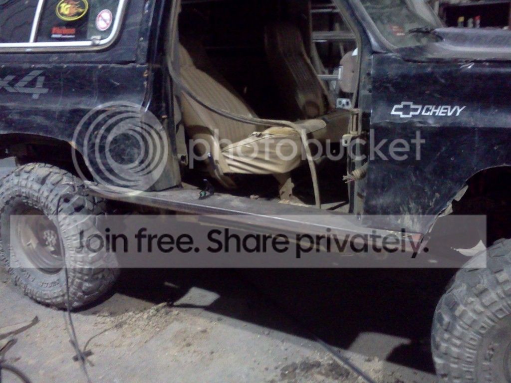

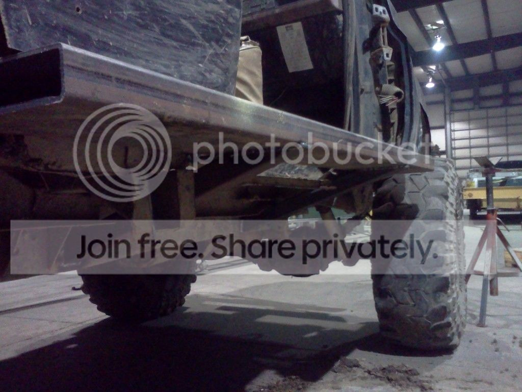

i then went and started my boatside project( which is still in the works)
each side has 8 by 2 box tubing across the top and 2x2 quarter wall as the supports i am in process of adding in more supports and working with the design a little bit until i can afford the amount of 1/4 plate needed to plate the boatsides.

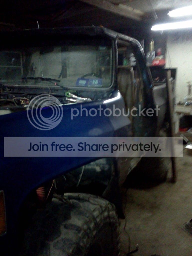

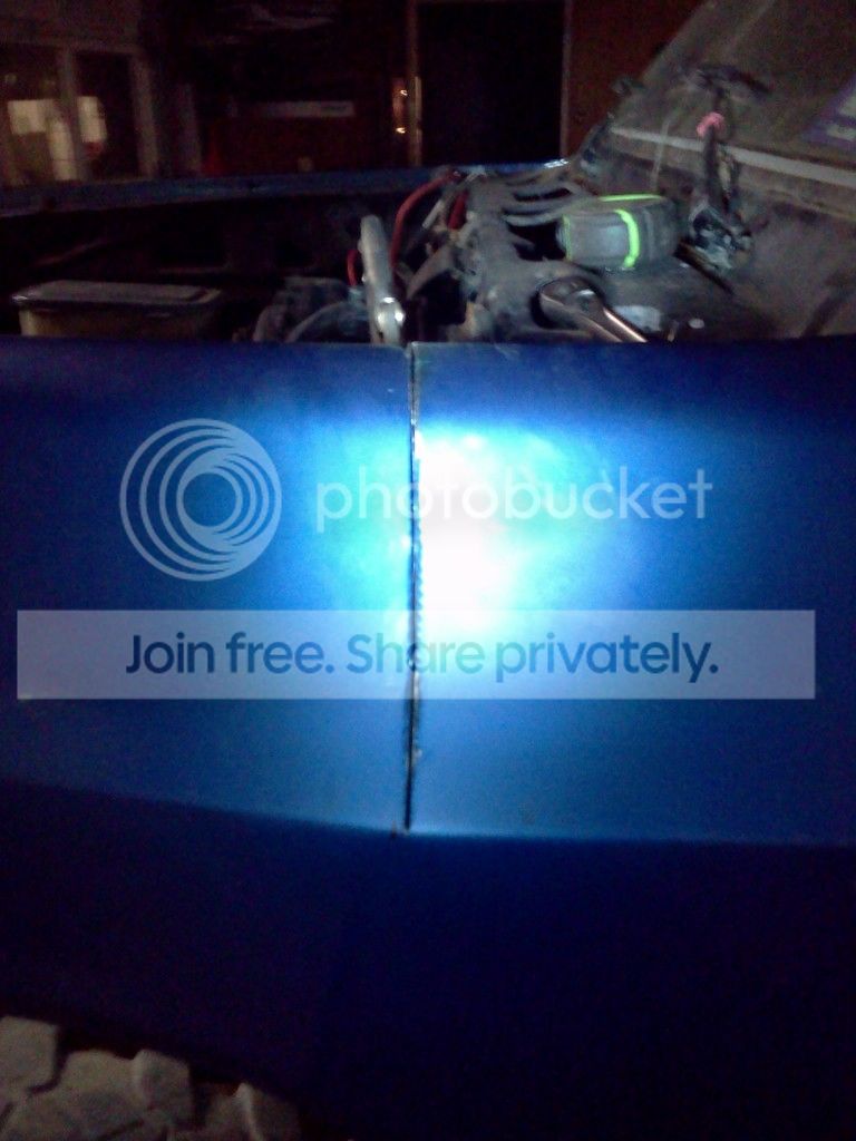

i then went and redid my front dove nose with new fenders.

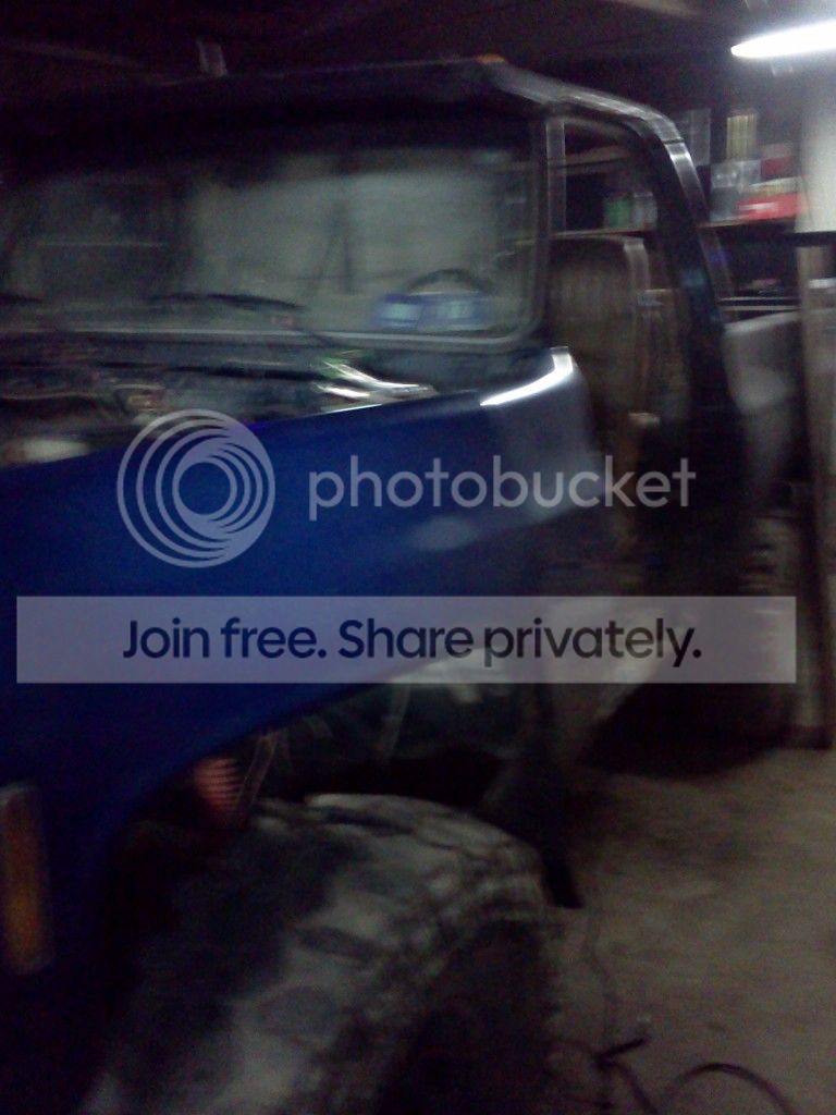

i then started work on the hood after obtaining a new one.
im currently still working on the body work for the hood sanding bondo by hand is a royal pita.

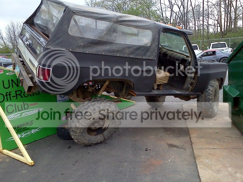

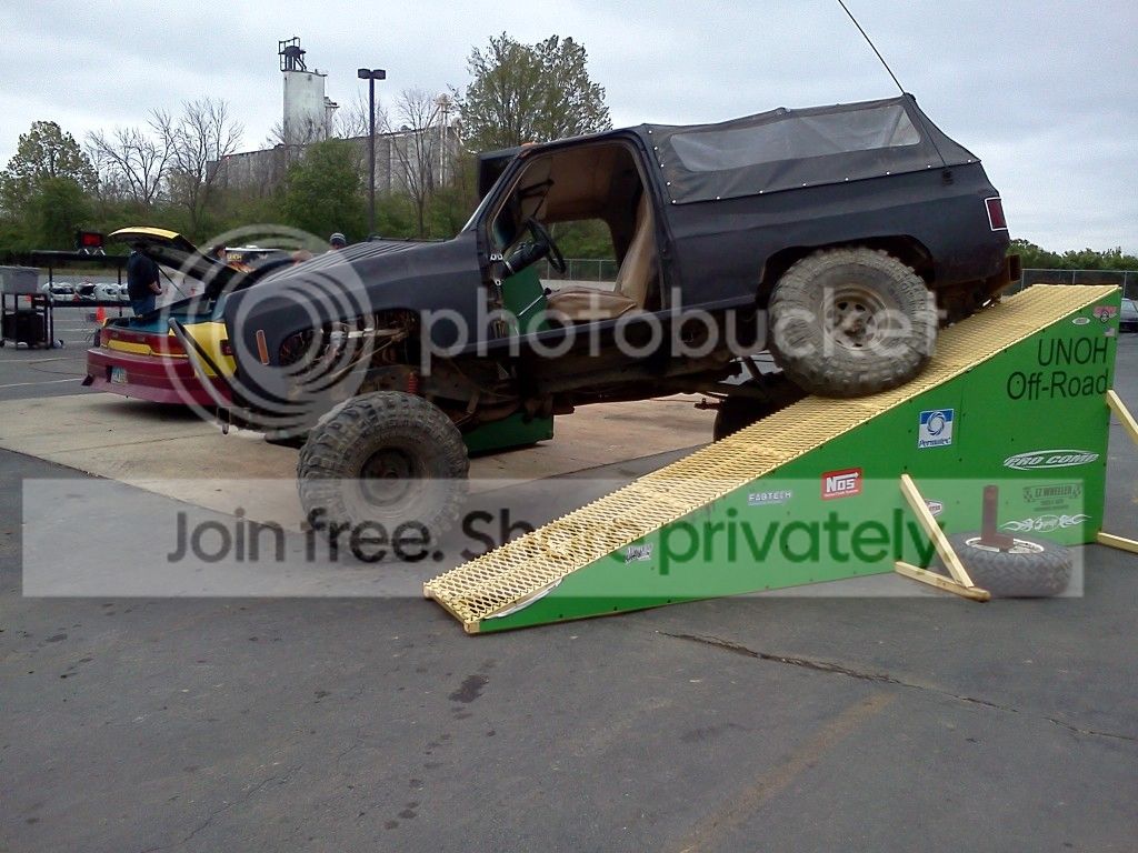

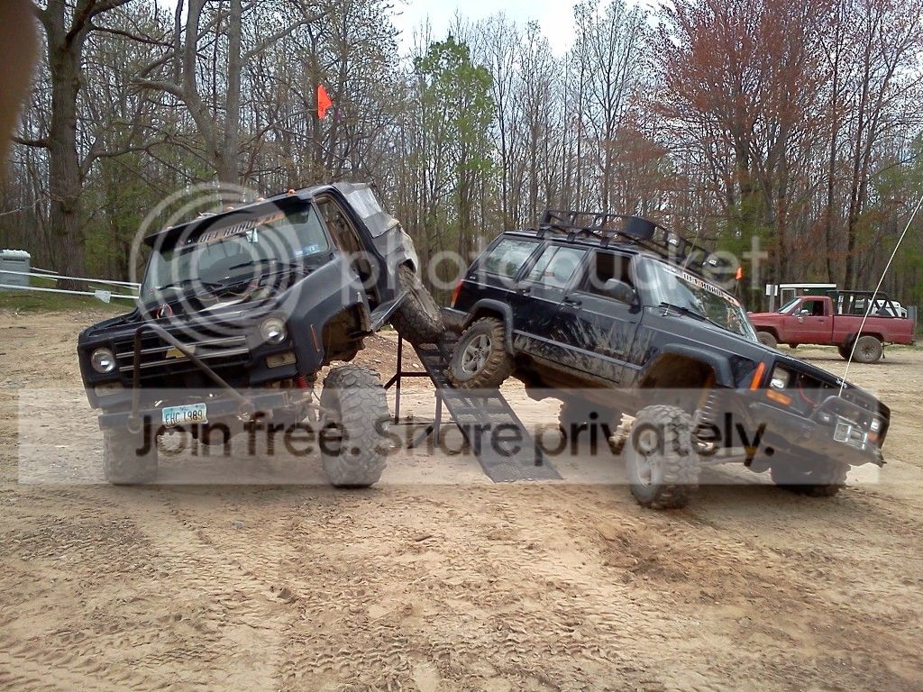

ive had the truck at school in the shop all weekend and have been getting a decent amount done. lots of little stuff like sealing exhaust leaks, checking steering linkage, engine tune up, and so on. i was able to get the rti ramp out last night and see the difference with the engine cage and it was very noticable ill let you compare the before and after pics here
before
after

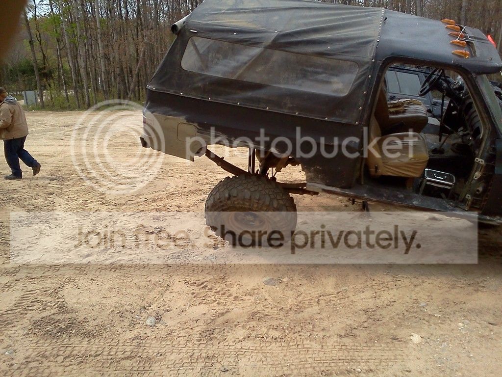

then i decided how much more flex i could get out of the suspension so i unfolded the front spring "wraps" and put her on the ramp.
this led to having to unbolt the front shocks because they where limiting the travel. guess its a good time to build some shock hoops into the engine cage.
i know that this probably isnt the greatest for the leafs but im planning on running it for a while to see how they react and if anything happens i have spare spring packs to go in.
i did notice that the rear frame is still flexing a bit but im not to worried bought that for now the interior cage ill be installing later on should fix that.
in the end through the cage and boatlsides the body will be solid with the frame essentially creating a unibody style design. now today i added some support to the boatsides and tied the engine cage to them. i forgot to take pics but will have some up tmw for you guys. gotta say having easy acces to an rti ramp is a huge help in discovering little flaws and sometimes big ones.

the boatsides angle into the frame behind the front tires so i ran a bar down from the cage to them dont have pics just yet but i will post em asap

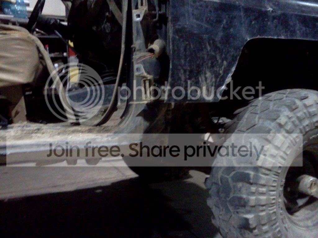

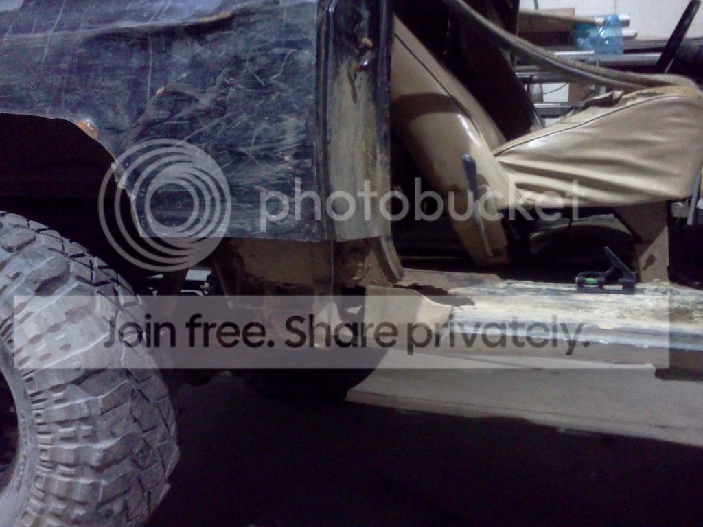

passenger side
driver side
more
here are the pics you asked for still have to finish this up but i have to wait to get her back in the shop for access to a proper welder. couple little things to do such as capping the boatsides and front and rear bumpers, add reinforcment to the boatsides with more 2x2 and then hopefully plate them here soon and then as soon as money allows i will be making an order from ruffstuff for some ubolts, springplates and couple other odds and ends for the 14blt so more to come!
