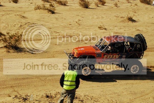

i plan on having the spare tire mounted on the back of my cage along with two jerry cans and a high lift all this and still have room under it for the gas tank to be in the bed and more storage. tryin to fit all that under the top with a 40in or so tire will just be too tight and access to items will be a pain.
for example not similiar to my truck but it gives you the concept of how the spare will be positioned.
