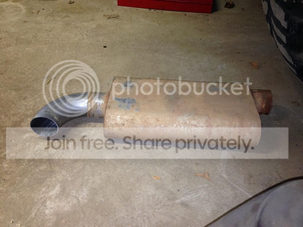

had to build this piece to run over the antiwrap bar and sneak above the diff
layed out after final welding

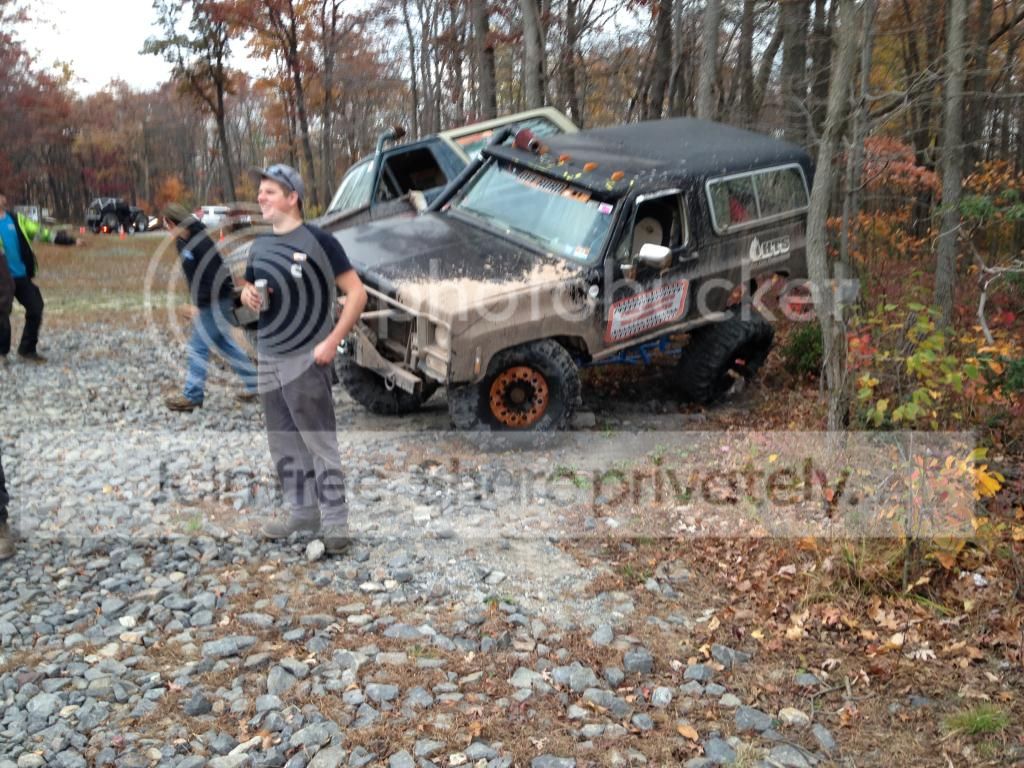

wheeling pics from rausch
Some pics of some wheeling at rausch this past weekend.
and my favorite pic
so to make up for all the poser shots (i was the only one really taking pics:dunno:)
