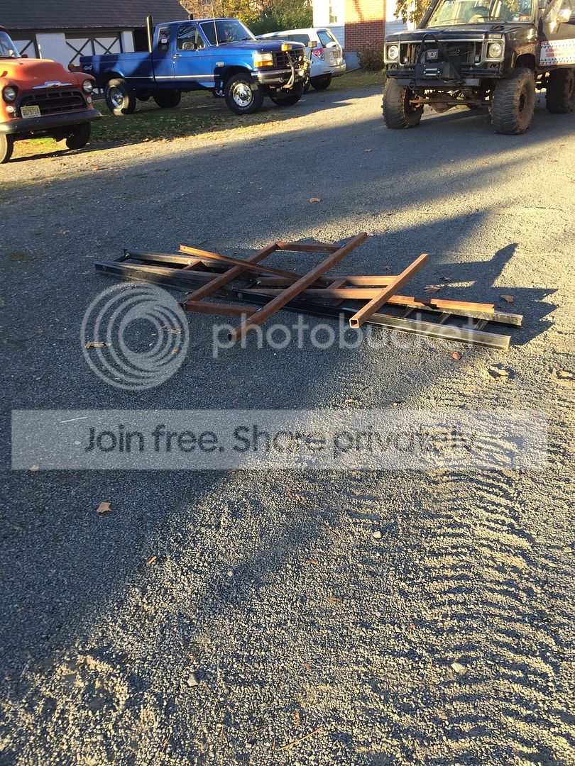

starting to make some progress in areas ive been ignoring. so the truck has always rode like crap and ive known for a while my front shocks where limiting the travel in the front. decided it was time to order some new ones and set them up properly. best way i know of for measuring out suspension travel is to put it at full flex. my buddy cord and i had two "flex" ramps that we brought to car shows so i took the two and built myself a folding 30 degree rti ramp.
folded upside down
unfolded upside down

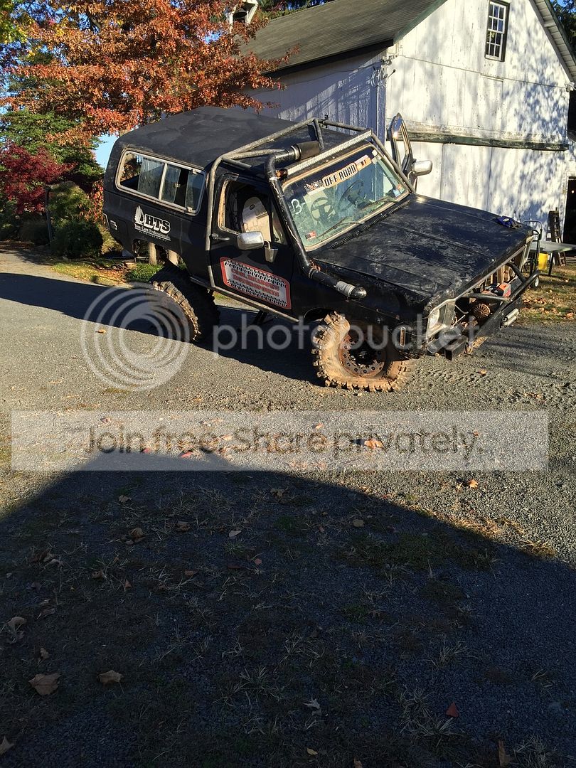

from past experience my truck tends to flex the most when its backwards on the ramp so thats how i measured.
i picked a fixed point on the frame on both sides for the front and then two mating points for the rear.
after measuring i ended needing 11.5 inch travel shock in the rear and a 10.5 inch travel shock in the front. i was planning on going with bilstein 5125's they only offer a 10" and 12" travel so i went with 12" for all four corners ordered from ORD. ill be changing the shock mounts according to the amount of droop and compression i measured off of ride height to fit the extended and compressed length of the bilsteins. for the front i ordered the ford shock towers and the rear i be building a shock hoop up through the floor on each side.
also discovered i need to trim the rear quarters a little more on the ramp.
the truck absolutly stuffs the front tires now with the front end not being limited by the old pos ranchos.

It flexes really well for factory length leafs. Not too sure mine would flex that well. Lookin good man.
Yeah I can't lie. I've pulled the overload leafs from the rear and removed another leaf. Helps a lot. Also why my truck sits so low. I've left the front rancho Spring packs completely alone.

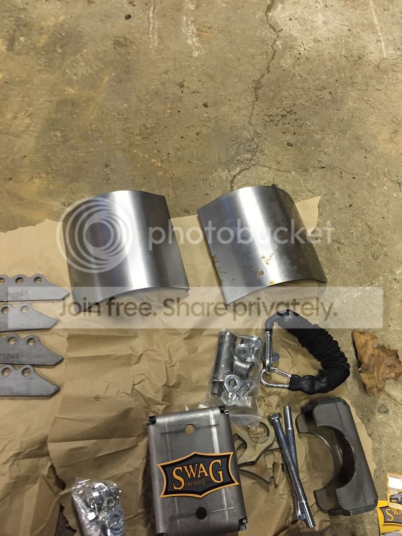

Tracking says I should be getting all my tabs, mounts, and shocks in tomorrow. Looking to get that set up this weekend. Won't be getting the kit from swag till Tuesday so looks like I'll be bending the shock hoops on the jd2 by hand one last time :doah:
parts! parts! parts!

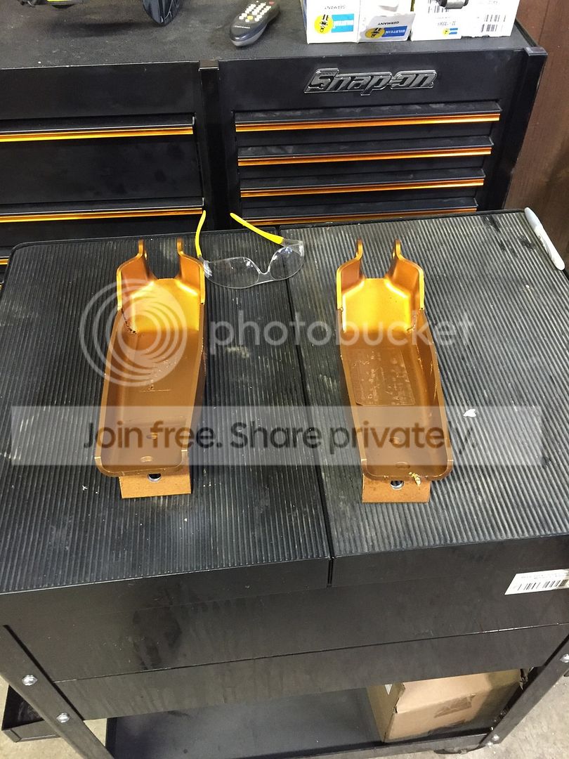

got all my shock tabs, 4 bilsteins, 2 ford shock towers, the swag ram mount, replacement tie rods for my front steering, and filler panels for my rear taillights which is for a small project down the road.
i kinda already had an idea on how i wanted to set up my front shocks so i dove into modifying the ford shock towers.
i then tacked the mount in place and tabs on the axle for the night just to get an idea. im going to need to move the upper mount higher up. the truck has about 6.5- 7 inches of compression off of ride height and 1.5 inches of drop from ride height. so from where its set in this pic it needs to go up about 3 more inches.

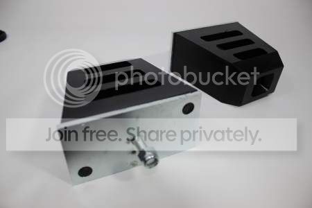

was working on that today. im going to reuse the stock bump stop mounts
and i have a set of these to bolt up to them.

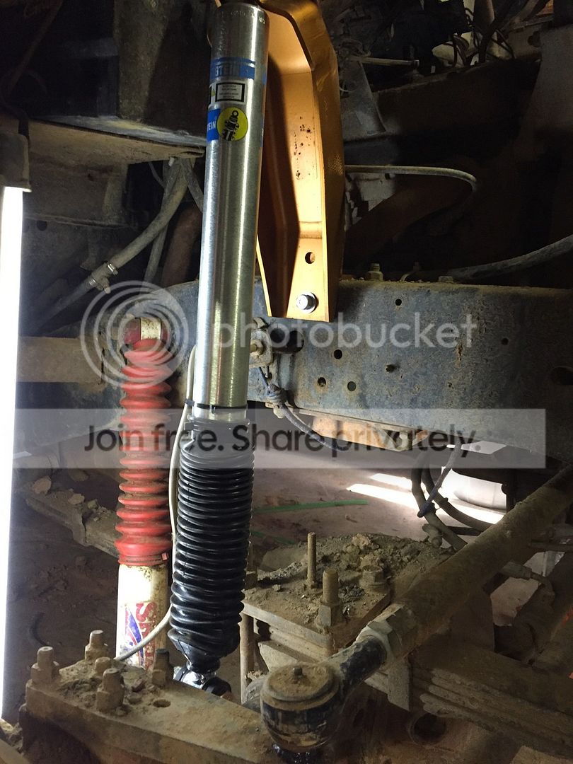

got the front shock set up finished up today.
welded a piece of angle to the back of each shock tower. and drilled a whole through each.
then naturally painted them the VHT copper.
i made them so that they bolt up to one of the two bolts here that hold the motor plates to the frame.
so it bolts up like so
finished setup
im now going to be looking into setting up the front bump stops. gonna keep it simple and reuse the stock mounting plates.
i removed them a long time ago but luckily held onto them.
ill be replacing the rubber though with a set of these
i just have to figure out what to do for a bump pad on top of the ubolts.

Did you cycle the suspension to see if the shock body is going to get into the steering shaft on the driver's side?
