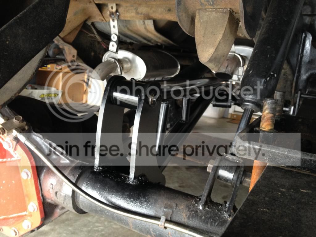

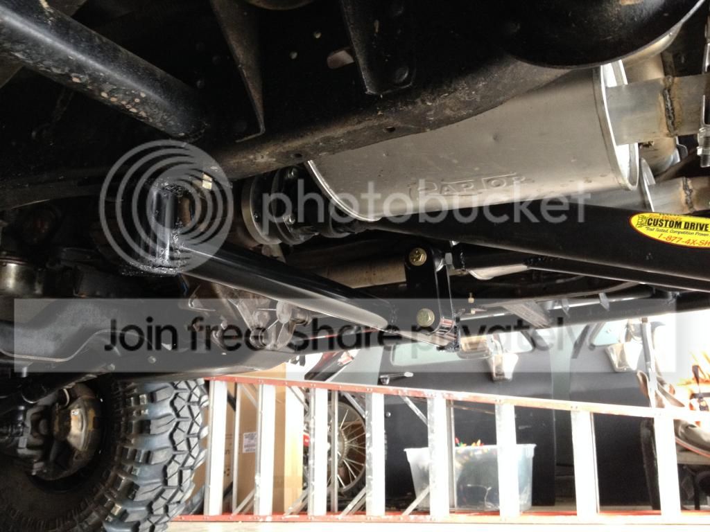

I added mine because when I welded the tubes together up front, I had a hell of a time getting the rear bolts to line up with the bushings. So once I got them installed, the plate was just to keep the holes in line later.
thanks for the info :D
That's what the spacers are for in the kit - to keep the bushings on the bar side lined up with the holes on the axle side.
With the ant-wrap up above the driveshaft I'm not concerned with dragging it on rocks so I don't think I need to add anything between the two tubes :dunno:
The center gusset is not just for bashing strength. These bars see an incredible amount of force. If not designed properly they will bend up just from the rotational torque. I haven't heard of anyone bending one of Kert's backbone antiwrap systems but then again I haven't heard much feedback good or bad from owners of those. WFO Concepts also designs their bars with a heim and no center gusset though so maybe my design is just stupid overkill but I'm ok with that.

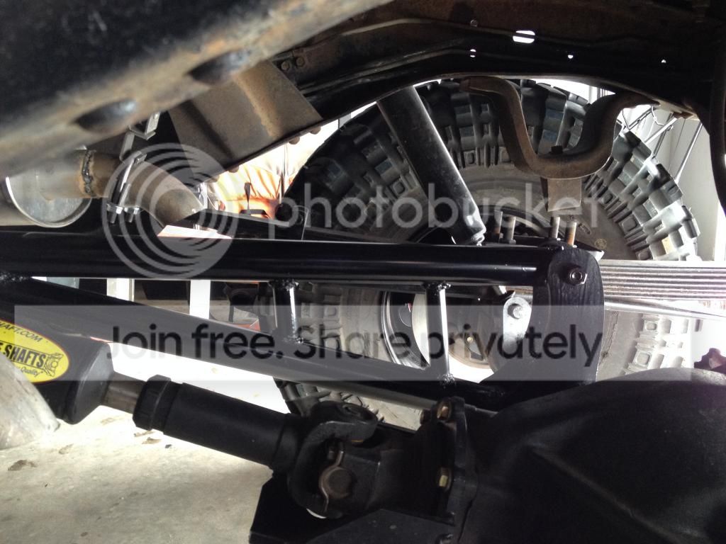

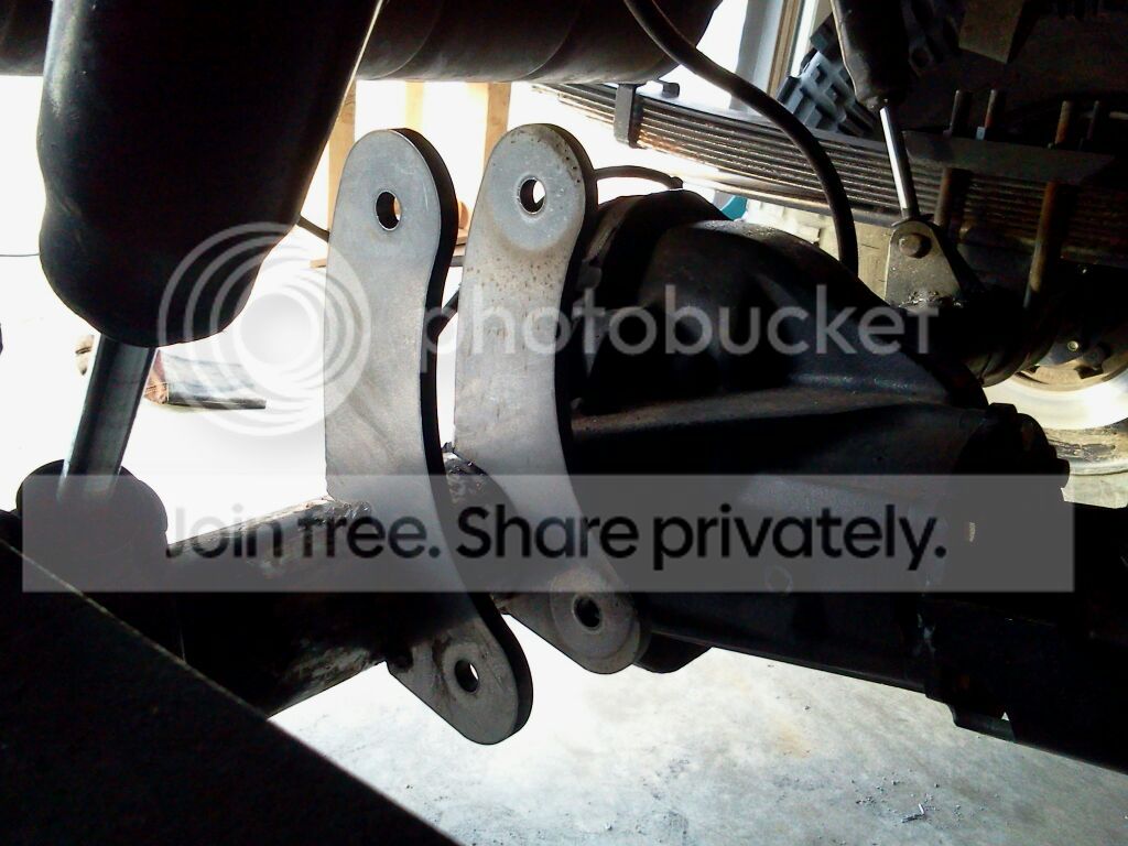

I guess I can contribute to this thread as well. Built this out of some RuffStuff axle brackets, 4" shackle, 7/8 heim w/ a mis-alignment spacer, and a fabricator set from DIY. Built a simple cross-member that eventually tied together with a tranny cross-member/skid plate so it's all tied together and really strong. Also used leftover 2" HREW tubing for the main tubes and 1" tube for the bracing. Seems to work really well and was cheap

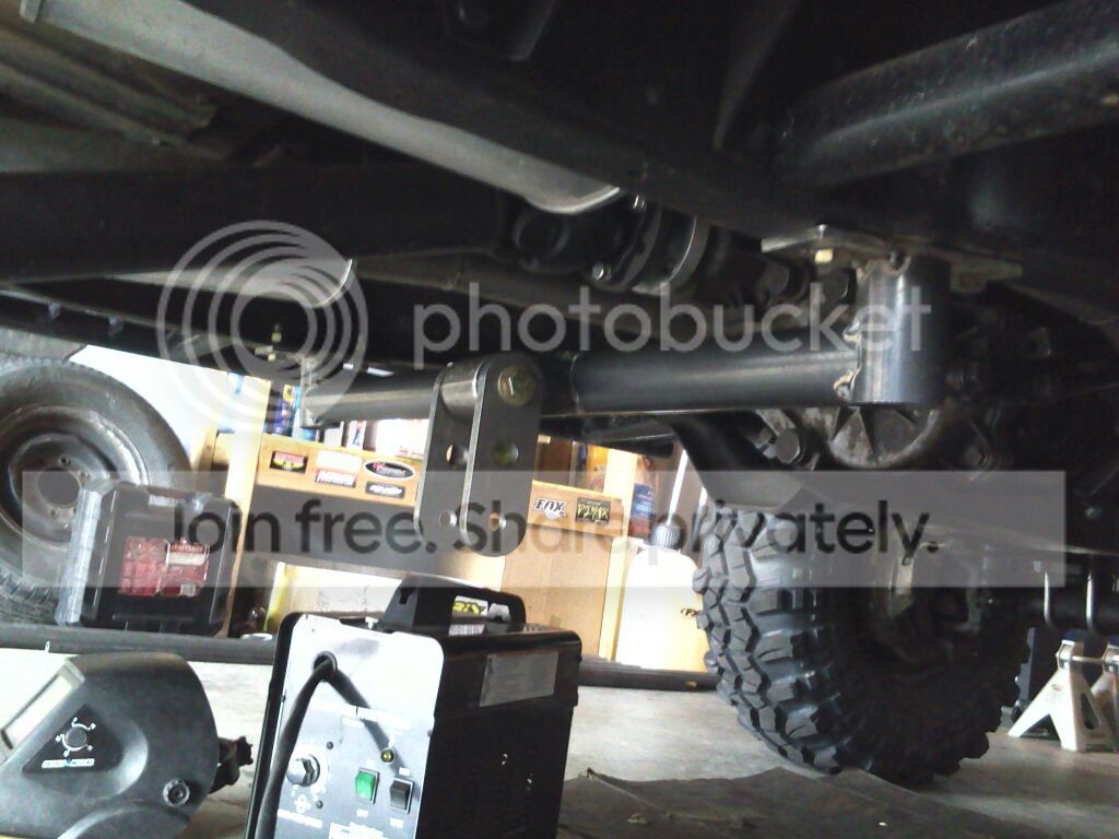

I have Kert's backbone installed and I was planning on using a heim similar to what truck-oholic used however I wasn't planning on plating the gap between the two tubes so the heim is functional. With the ant-wrap up above the driveshaft I'm not concerned with dragging it on rocks so I don't think I need to add anything between the two tubes :dunno:
That depends on the location of the two joints on the axle. If they were near 180 degrees apart around the tube it would not be necessary as one would be in tension and one compression.
However, if one of them if halfway around then the axle, rotation can put a bending moment on that tube(or just move it if there is a heim at the other end), so you would want to at least add a link between the two like shown on Zim's rig.
Thanks for the info, I may need to add something between the two tubes after all.
