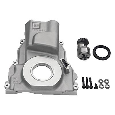

) and will be working 100 hrs p/week until early November. Looks like I'll have time to think about all this and make a good decision. I'll likely get on this motor project sometime around thanksgiving, or a little before, since work slows down to a comfortable pace that time of year.Oh contraire! There is a gmpp front drive distributor kit that uses a small block FORD distributor! Get a dui hei sbf distributor and your good to go! Even allows for use of a mechanical sbf fuel pump. Pretty bitchen setup. But also like $450.
