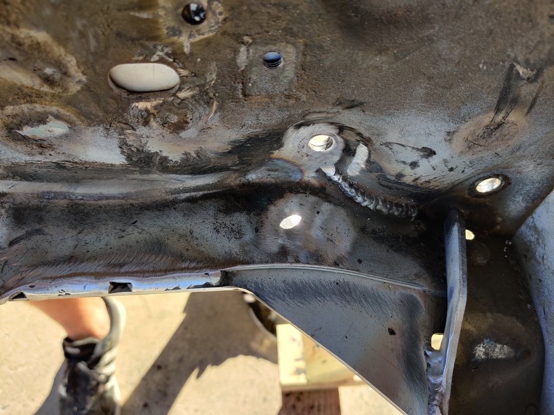

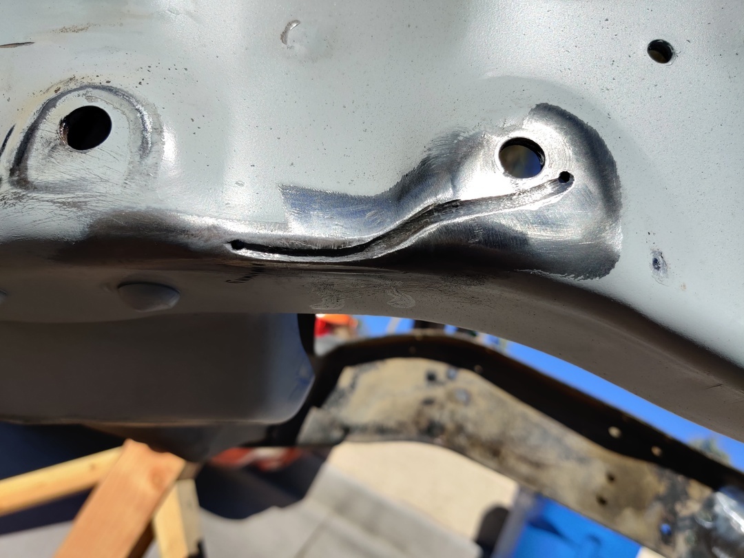

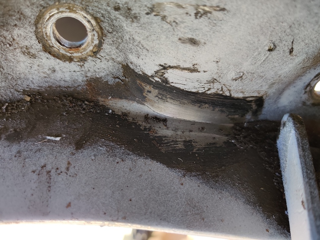

Got the frame reinforcements plates welded up this afternoon. My frame actually looked pretty good, but upon closer inspection I found a hairline crack:
I ended up drilling a couple of holes, one at each end of the crack, grinding a valley, and then welding it up before burning the plates on.

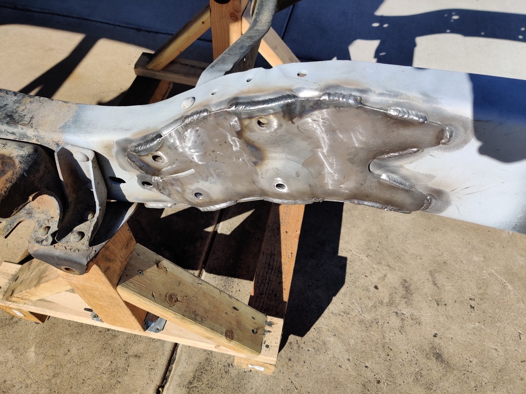

I had to use some heat and a BFH to get the plate to sit flush, but I think it came out OK.
I am also planning on an ORD steering box brace, so I should never have to worry about problems in the future, right? :)
And like usual, not the prettiest of welds, but this project is forcing me to get better!

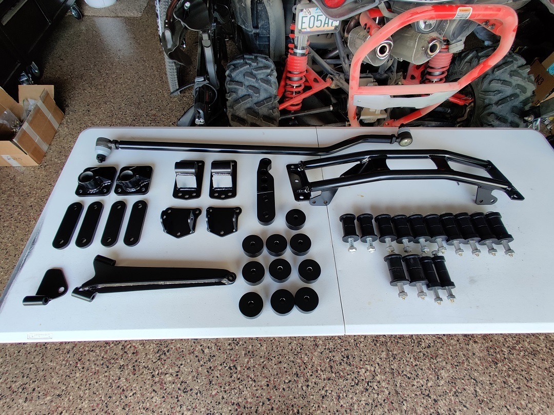

Lots of freshly powdercoated ORD parts ready to install.
I also ordered custom front and rear springs. Still hoping to drop off the frame for powder this week, and then will start on rebuilding/regearing my axles. Ideally will have the axles ready by the time the frame is done, but I'll probably still be waiting on the springs anyway. No worries, still plenty to do!

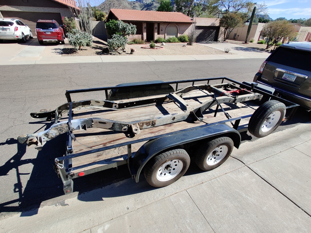

Progress! Just dropped off the frame and some other misc parts at the powdercoaters!
Should be about 10 days before it's ready. Now it's time to move on to rebuilding and re-gearing both axles!
