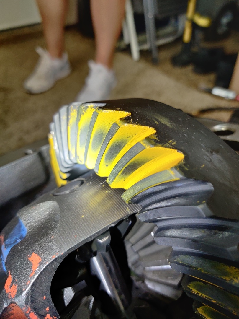

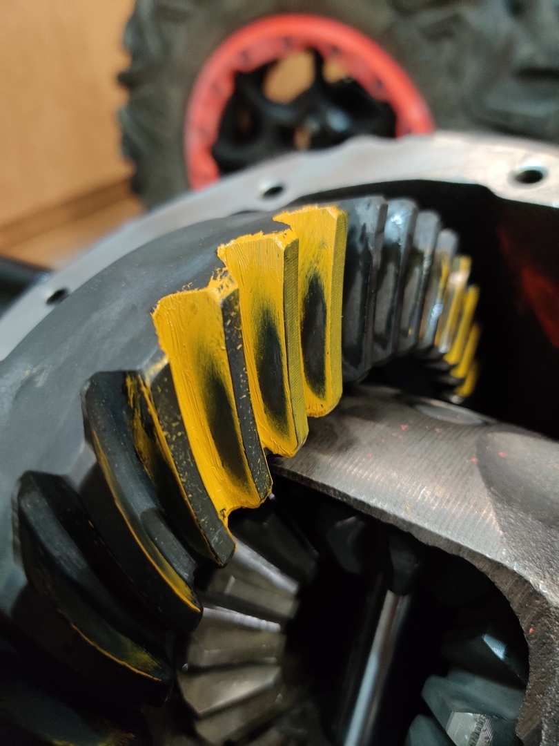

You could maybe run the pinion a hair shallower.

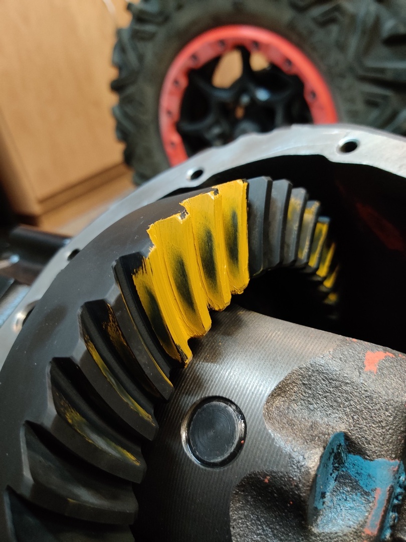

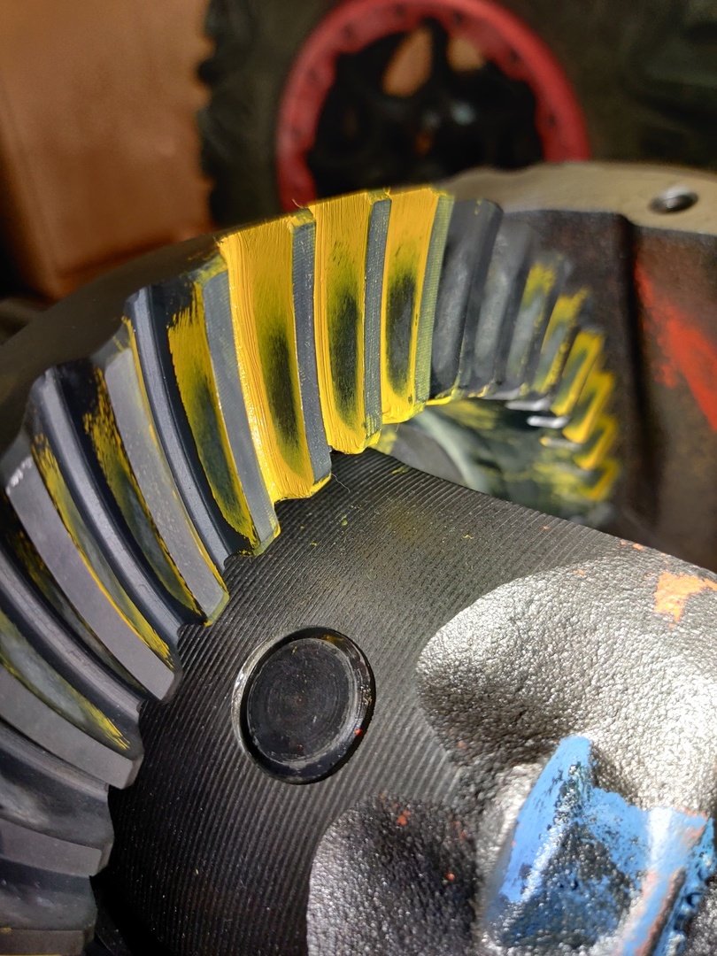

Cool. I'm going to remove 0.005" from the pinion shim pack and then try and loosen the backlash to 0.008-0.010" (this is what is engraved into the ring gear). I'll post up some pics of the new contact pattern hopefully later this evening.
Hmm, not sure if this looks better or worse than the previous pattern. It does look a bit more centered to me, but I would appreciate any feedback!
I decreased the pinion depth by 0.005" and decreased backlash by 0.002".
Pinion Shim: 0.030"
Backlash: 0.008"
Drive:
Coast:

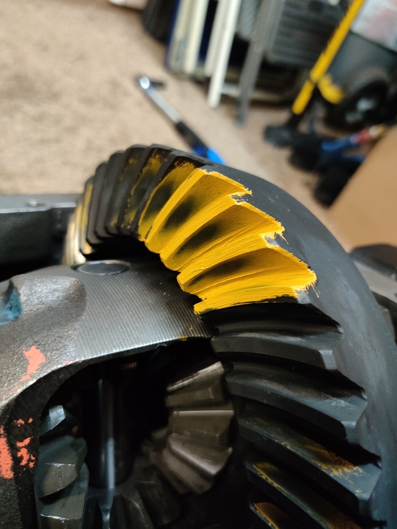

Before on the left, after on the right:
After looking at tons of contact patterns online, seems my pinion depth may now be too shallow? o_0
Needs to be deeper in the ring gear if you can. I have run worse for 100k miles with no issues.
I was thinking the same, I'll try removing 0.0025" from the shim stack which will put me at 0.0325" and see how things look. Thanks for sticking with me on this! :waytogo:

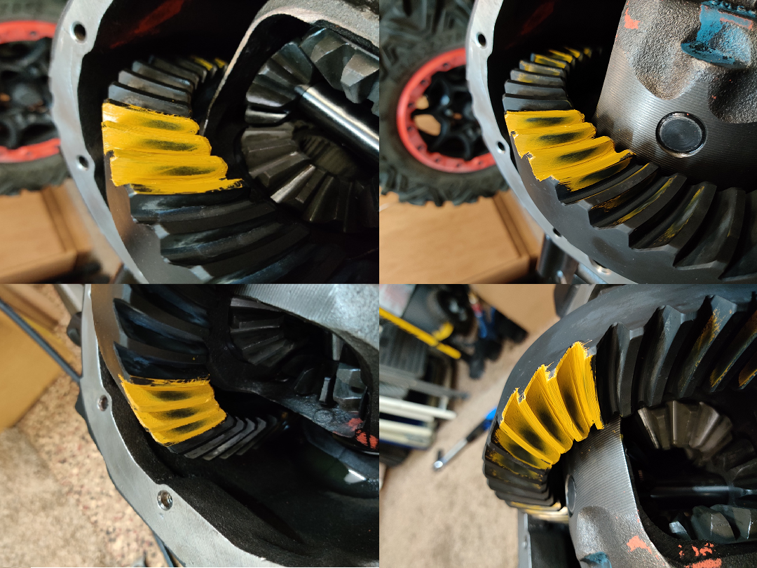

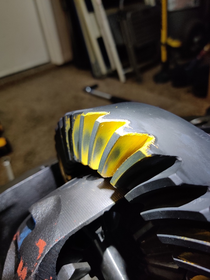

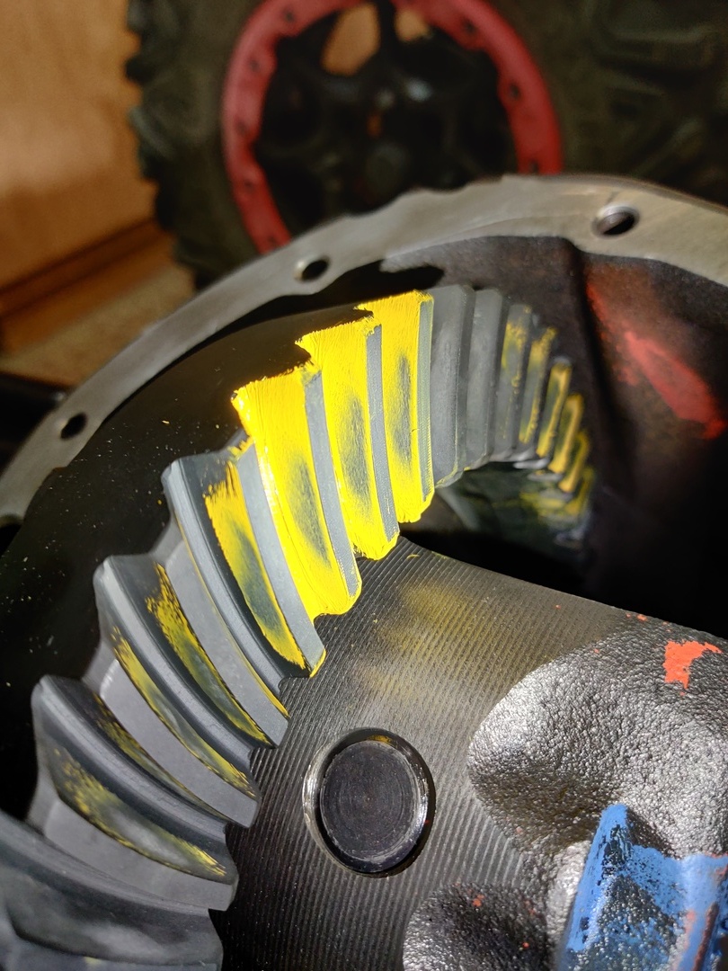

Wipe the outside top of the teeth off so the edge shows better in the pictures. Can not see the depth well.

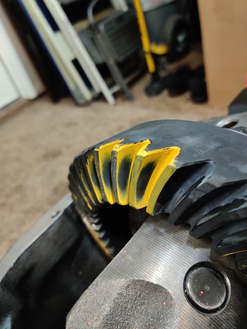

Alrighty! Pinion deeper by 0.0025".
Pinion Shim: 0.0325"
Backlash: 0.0085"
Drive:
Coast:
I think this looks the best so far. Does the pattern seem like it's riding a bit high on the tooth, though? Or am I good? :)
That is the one.
Yup! What the old guy said! That will work.

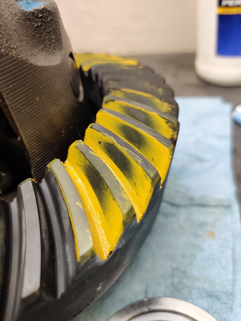

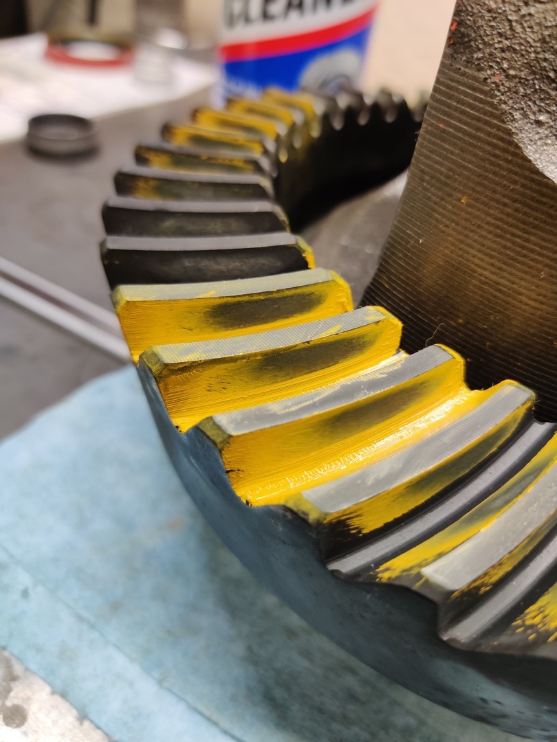

Great! I ran with it and pulled everything apart for hopefully the last time, cleaned everything up, and figured out the proper shims for the crush sleeve eliminator to get around 15 in/lbs of preload on the pinion. Installed the seal, pinion and yoke, and finally the carrier.
I ran one last contact pattern to make sure everything still looked OK.
I think I'm happy with this. Thanks for everyone's help! Now on to the 14 bolt! :D

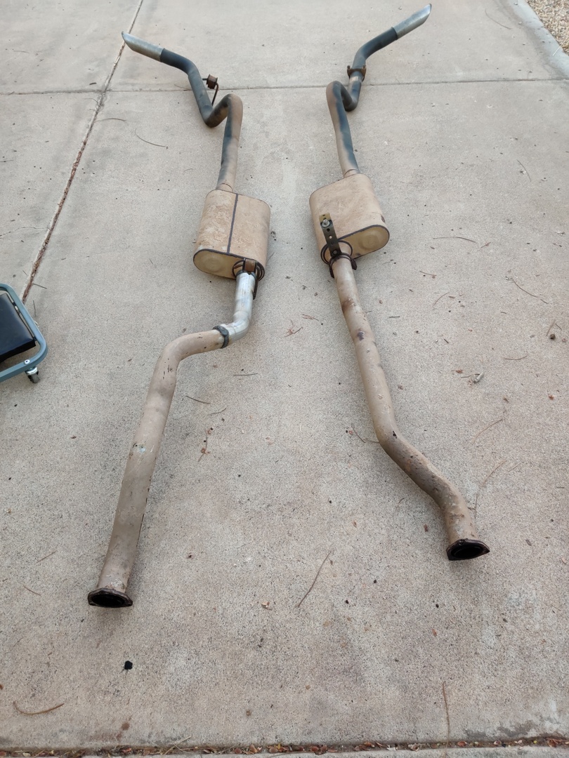

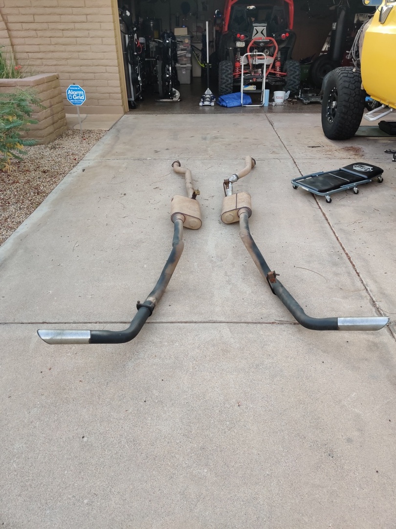

I would like to ask if you can post photos (if you have them) of your exhaust from engine to tailpipe. I am having issues determining what to do with my exhaust. Currently my exhaust terminates immediately after my Mufflers underneath the vehicle near the midpoint. It is my intention to install a new exhaust that will run from the engine out the traditional exits after the rear tires. There are few if any kits available and I will probably have to be frankensteining exhaust system from early Chevy truck Kits and various universal straights and Bends. also, would you happen to have any original documentation on your Blazer. Pennsylvania is giving me fits while I try to get it inspected and make it roadworthy. I have a post in the general forum regarding the original equipment in missions on the 1977 Blazer with the 400 engine. I have the original repair manual and the emission schematic doesn't even show an EGR valve. It is my argument to my particular Blazer never had a catalytic converter or an EGR. I'm trying to find somebody with a similar VIN number that also has documentation from the factory.
My blazer currently has a bored over 454 engine (468ci) with rusty headers and a leaky exhaust system. I need to get new headers along with the new exhaust system.
Any helpful response is greatly appreciated.

Before I tore it apart, my Blazer was emissions tested and registered with no issues here in Phoenix, AZ. My truck also originally came with a small block 400 and no emissions equipment. Here in AZ, they check the exhaust emissions on a roller, and also do a visual inspection. Each time they would get a bit confused about there not being catalytic converters or an EGR valve, but they were always able to determine that the vehicle never came from the factory equipped with these things. I think this is based on the GVWR (6000+).
In any case, I was running long tube headers with dual pipes all the way back. Again, no cats. No crossover either. Here's everything after I yanked it. minus the long tubes:
Perfect. Thank you. That is along the lines of what I was looking for. Hope I can sell that info to the Pennsylvania authorities.
