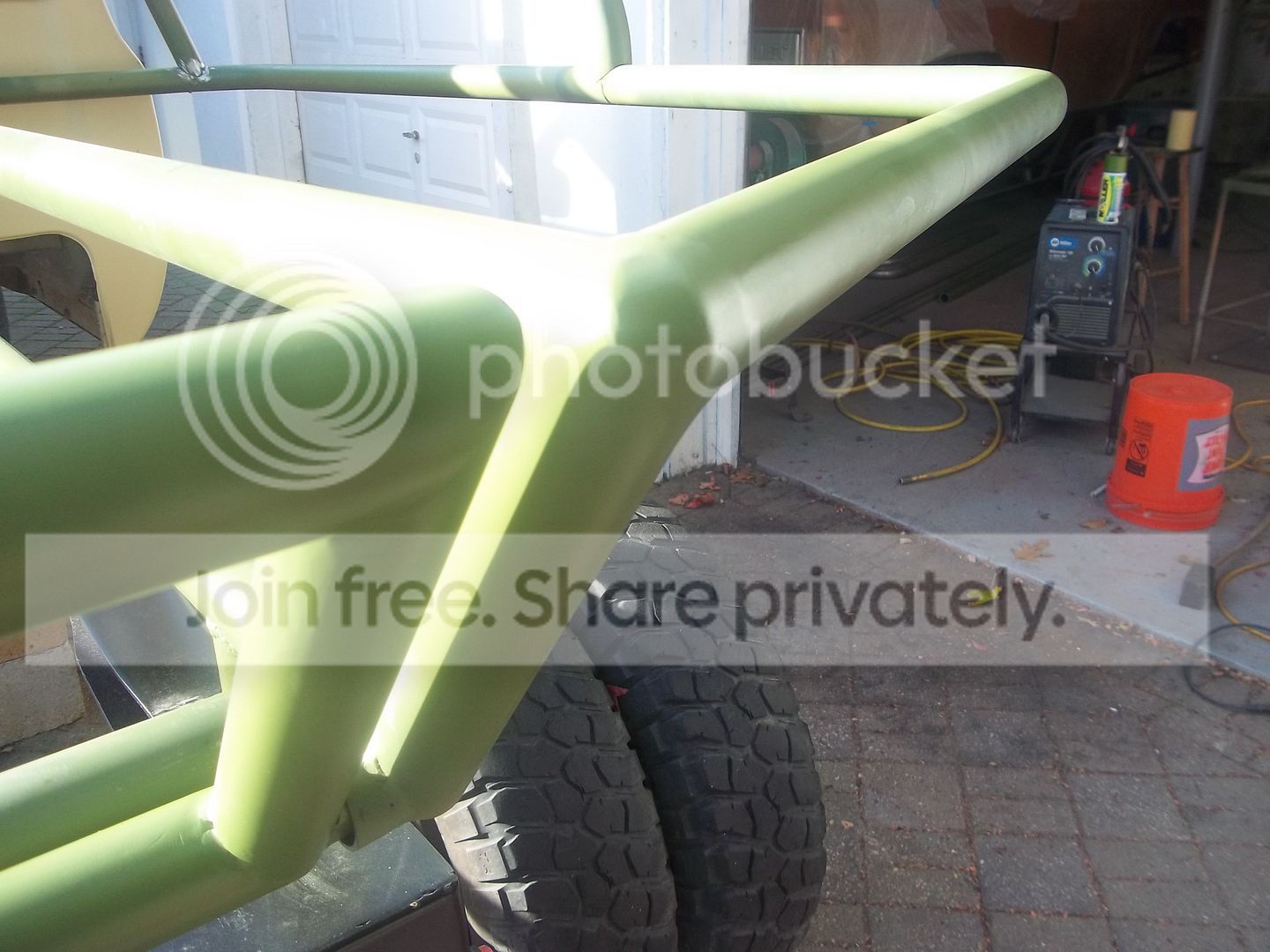

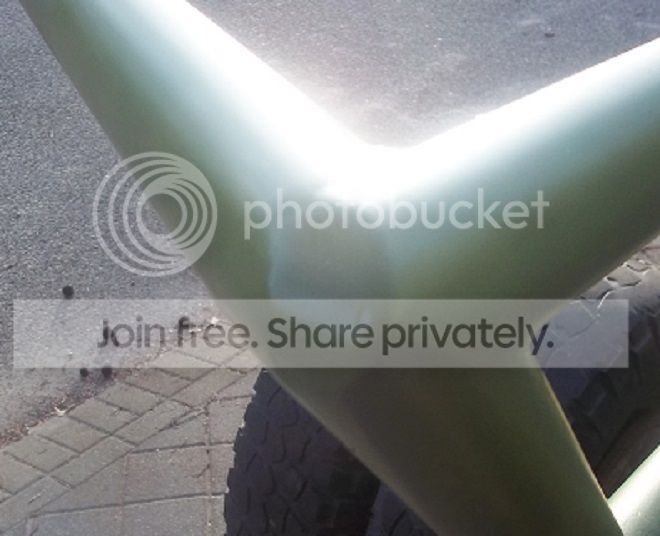

chopped off the rear coffin points. welded in some crescent shaped pieces of tube and shaped em....
working on the rear hitch receiver section now...

thanks boys... doesn't photo well... i'll try to get a couple other angles tomorrow.. I'm real happy with it...

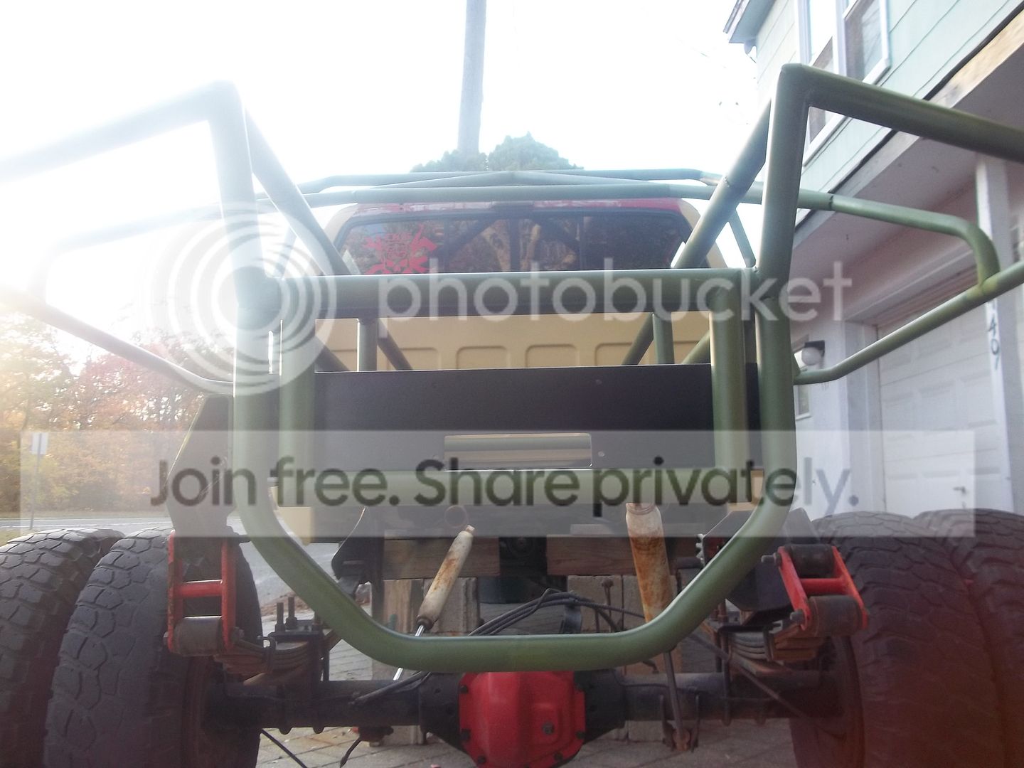

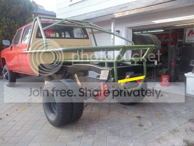

here's the beginning of the rear bumper/receiver.....
once I get the new axle under it, I'll do the receiver and the tubes that angle forward to the underside of the frame... they'll be bolt-in...

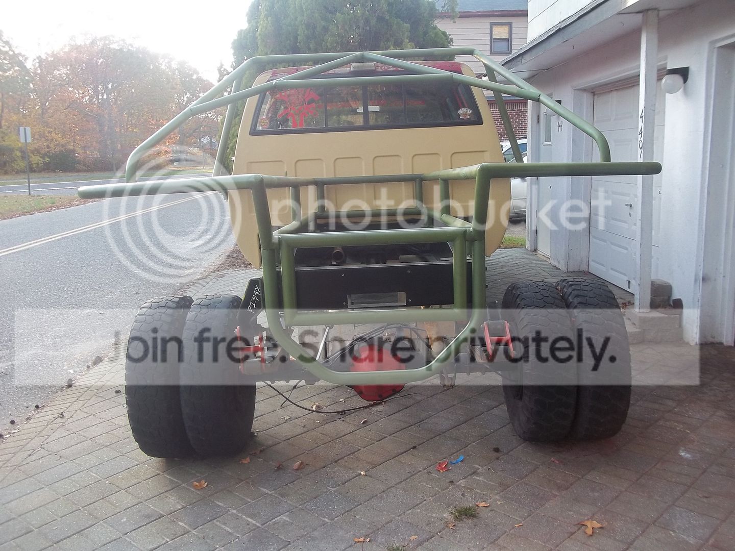

tailgate up...
and tailgate down....

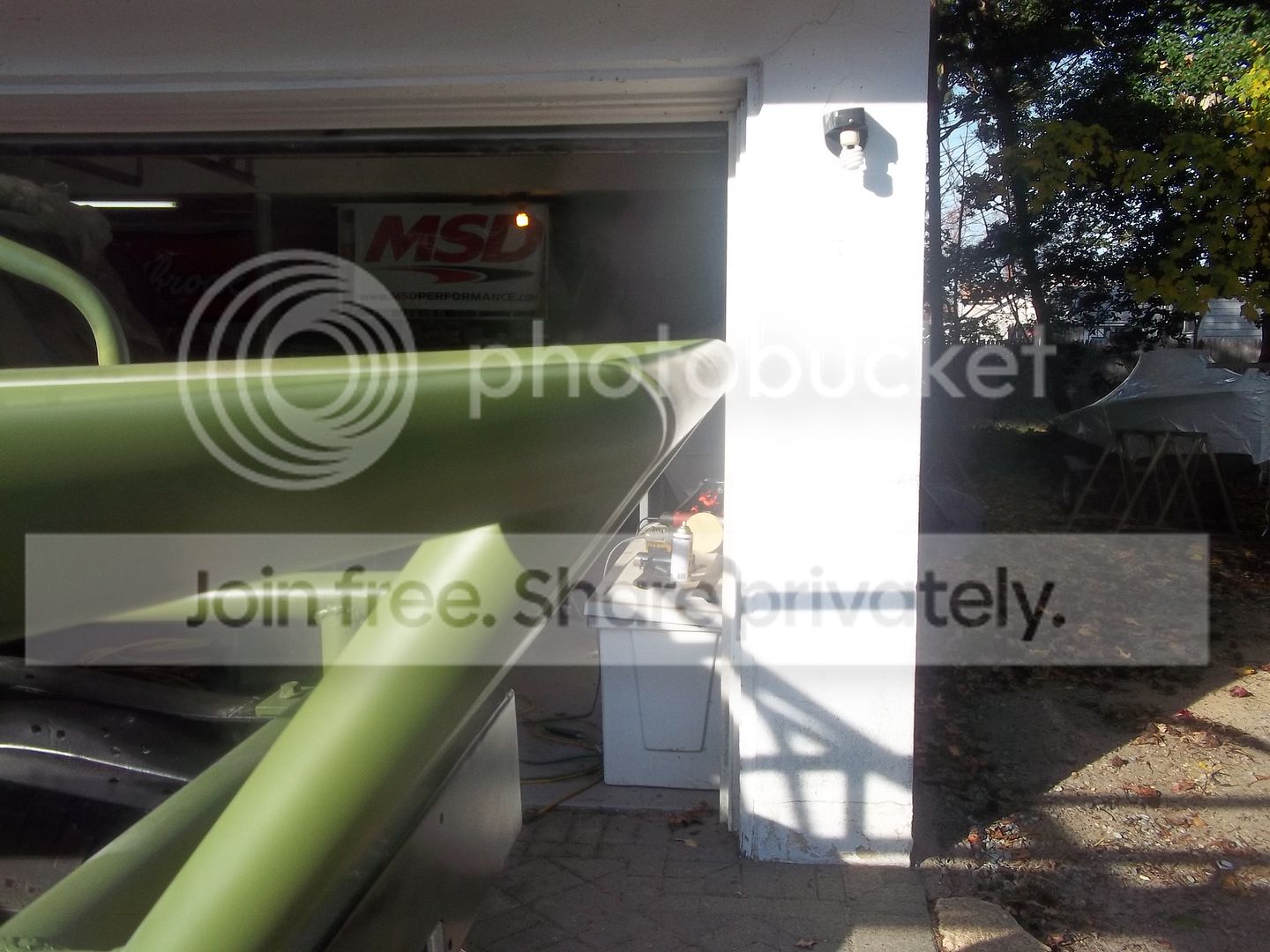

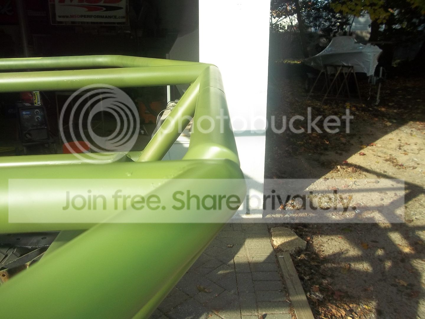

focker took forever... :doah: f*cked up the first attempt, scrap pile.. :angry1: couple hr's down the tube, pun intended... :haha:
nailed the second effort tho... poifect.. :pimp: only took freakin 5 hr's..... :doah: musta reloaded it in the bender eleventy times to tweak a few more degrees here and there...

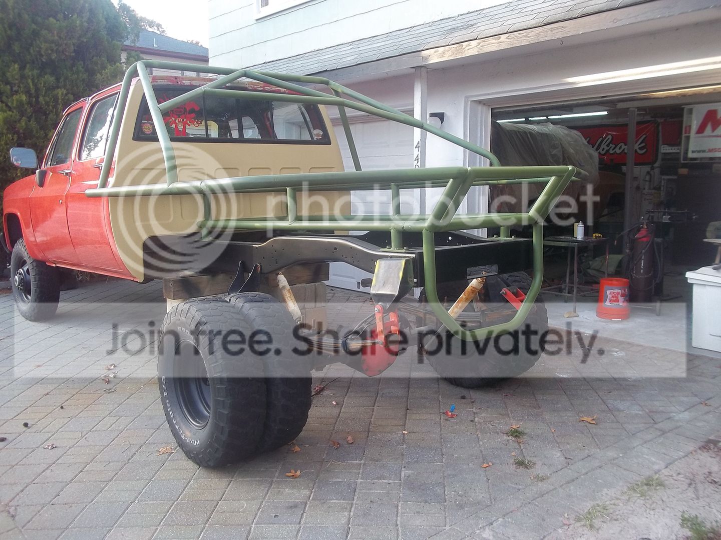

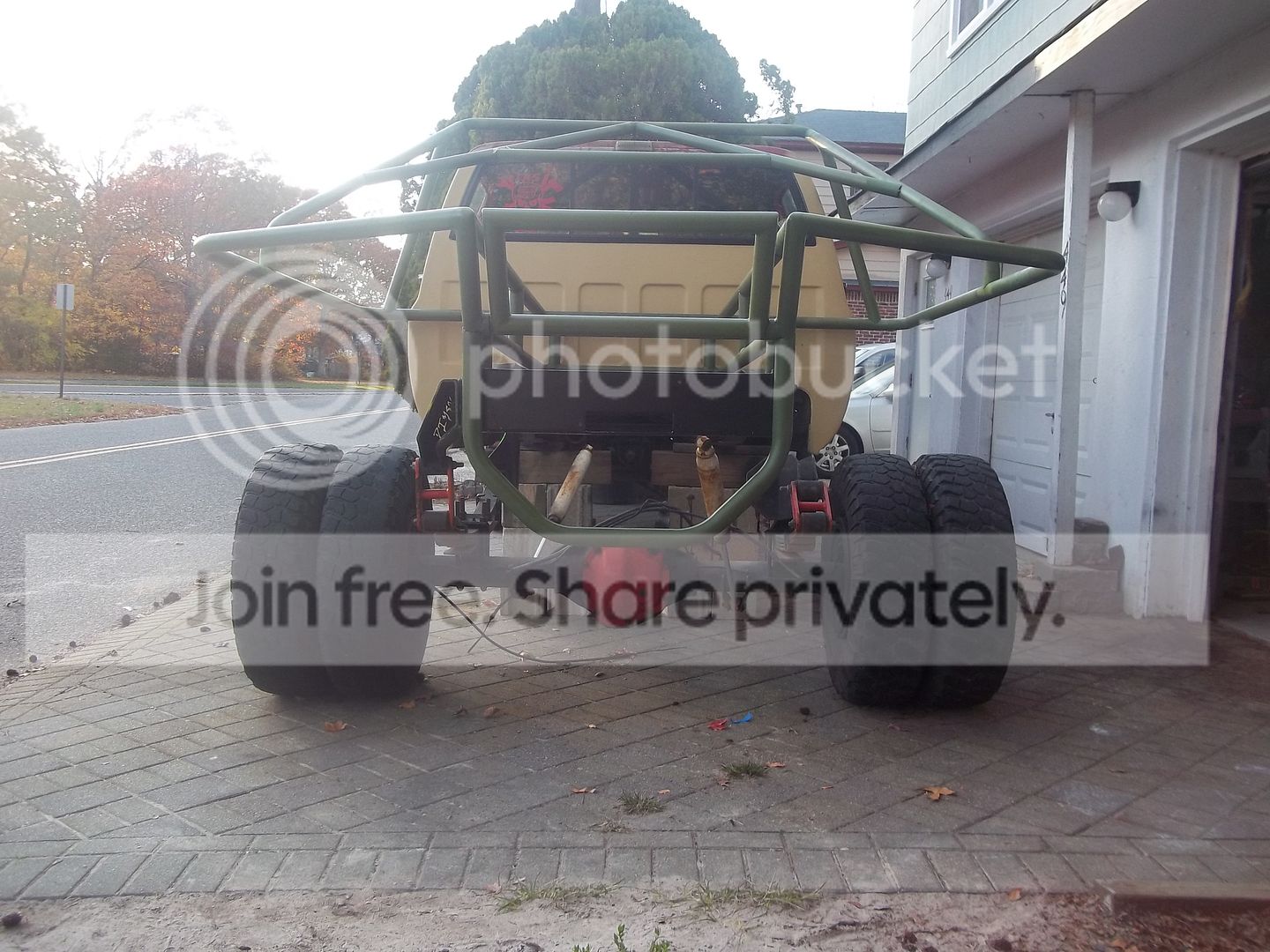

oh, and here's another angle of those points now too..
oh, I forgot to mention, when I get into the receiver and tubes, I'm more than likely adding a x-tube here... right below where the tubegate hangs to...
but before I continue in the back, I wanna get the axle/tires under it and work on the 1.5" box support tubes.. mainly cuz I need to check shackle clearance to that tube I just put in...
