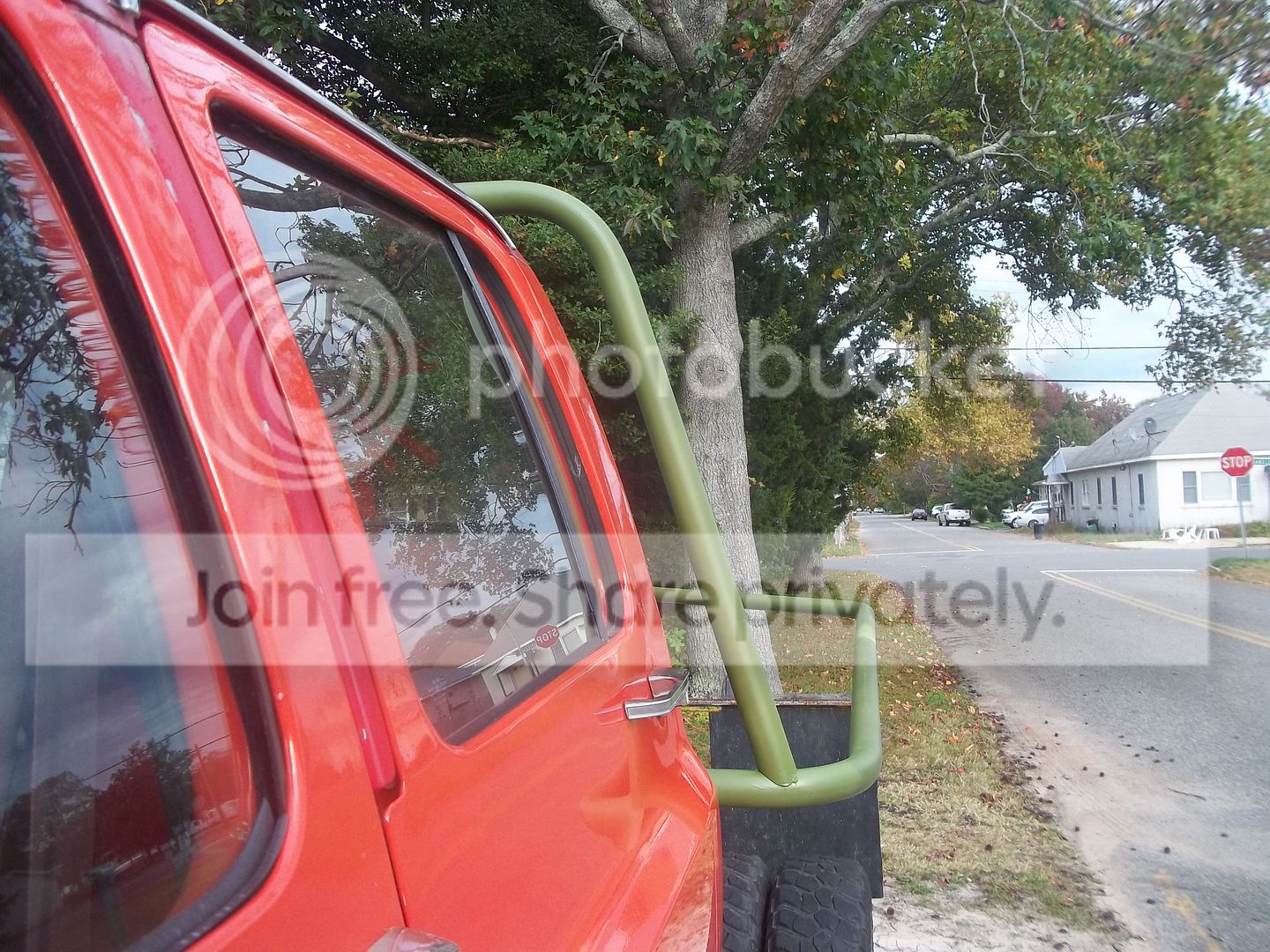

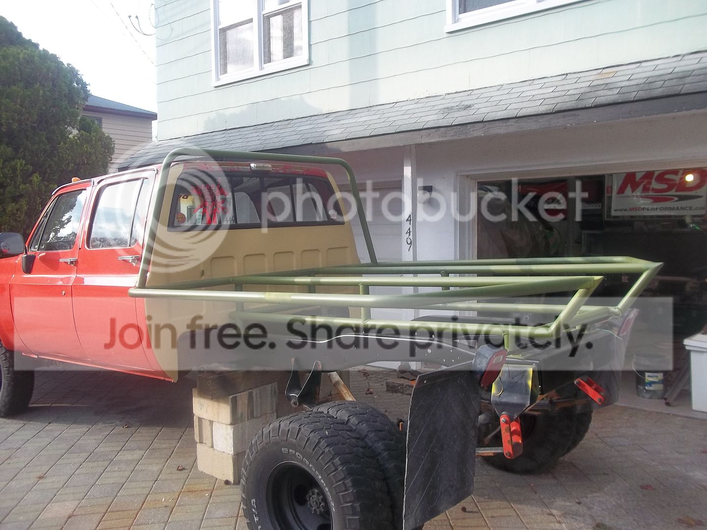

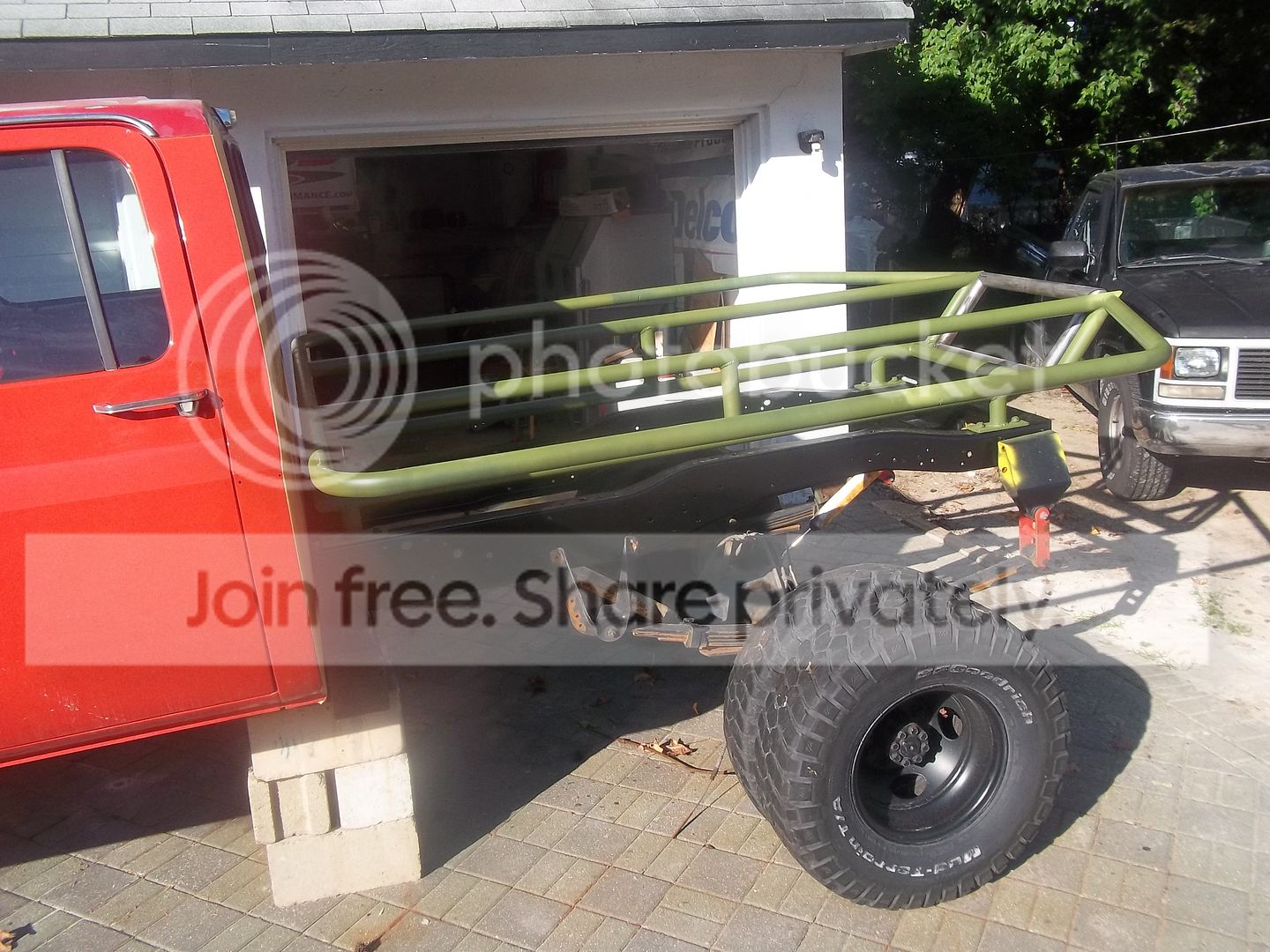

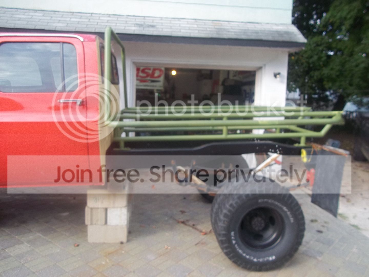

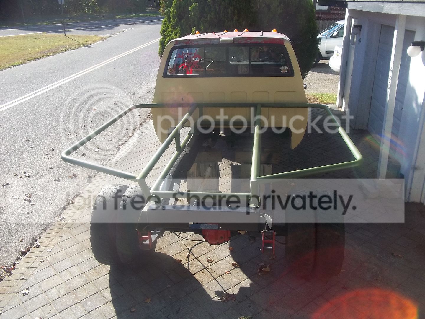

upper side rails are in... next week I'll get the C-hoop in....
don't mind the axle, it's just rolled under there till the new stuff get's here to keep the township from complaining..
Looking good...great actually...and your weather looks good too judging from that shot....wish it would stop raining here.
thanks.. today was nice, it poured ALL day yesterday... cleaned the Lab and rebuilt my welding helmet.. if I had both days, I would have had the C-hoop done too...

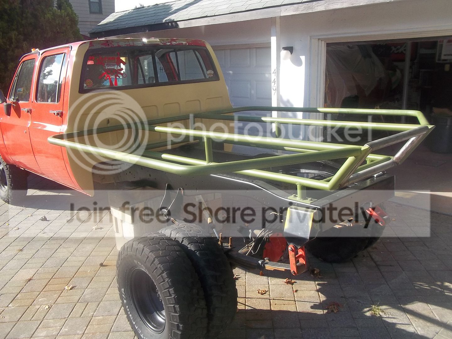

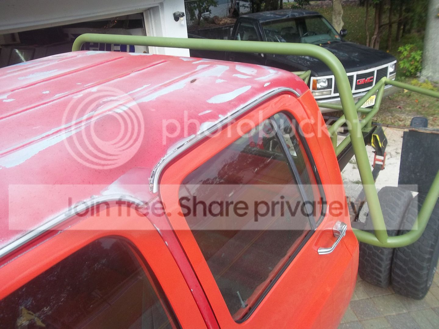

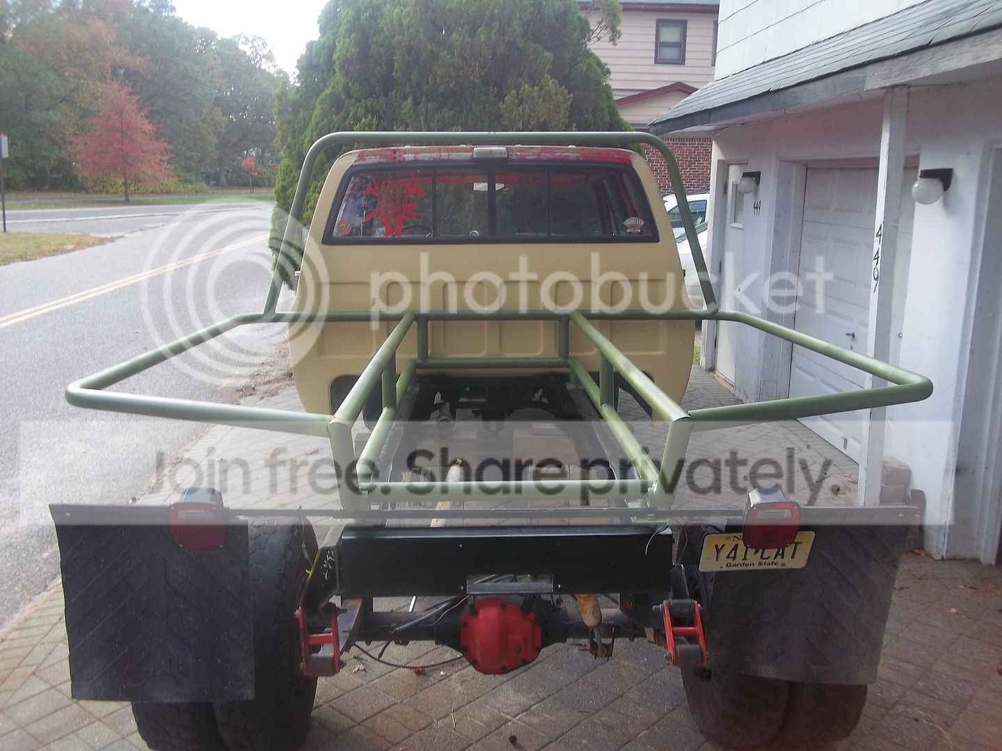

C-hoop is going in... :popcorn:
one of those kinda Saturdays... 5 hr's bending, fishmouthing and fitting the C-hoop, only to run out of argon after 6 tack welds... :doah:
obligatory slutting...
so... tomorrow I'll start bending up the 2 down angle tubes... basically it's just a radius right above the bed, so it goes vertically into the bed tube..
but I only have 1/2 a day so I'll probably just get the bends done on each and rough cut em to length... doubtful I'll get the fishmouthing done, but we'll see...
