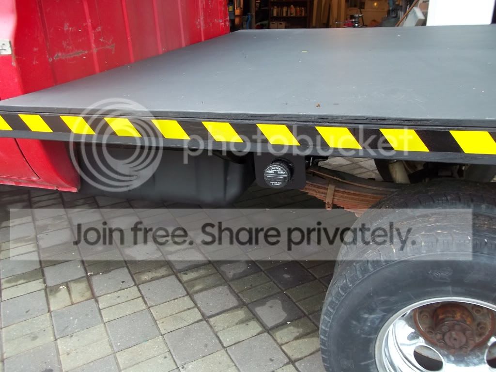

fuel fill....
I think that filler and cap looks great...what did you spray that tank with?

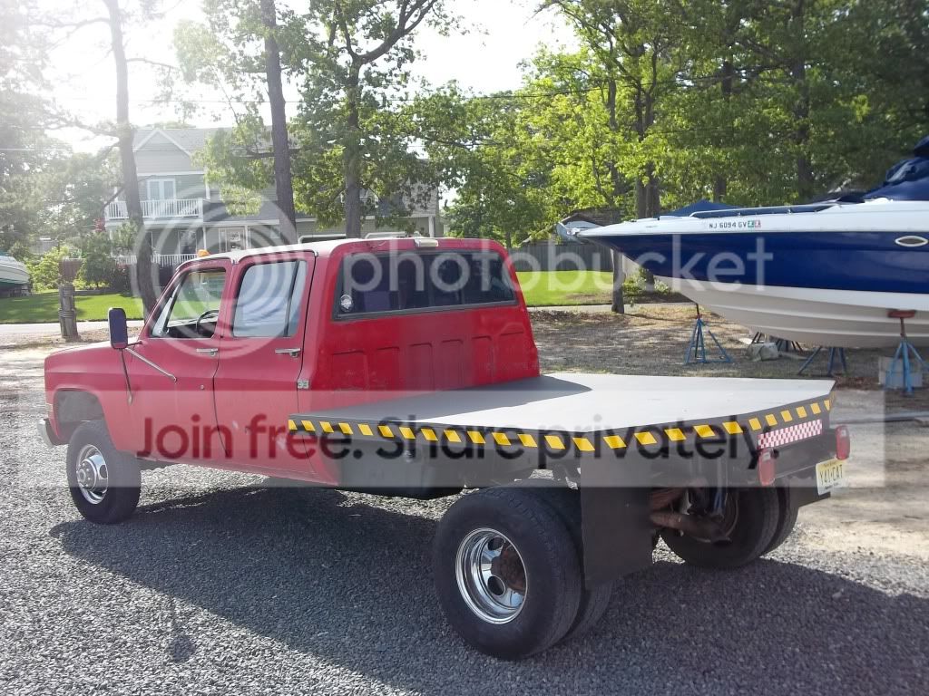

Honestly, your attention to detail is nothing like I have ever seen before. Even on the wood bed, which is temporary, it looks awesome. I commend you on your effort.
thanks, just some 1/8 plate screwed to the backside of the 2x4... as simple as I could make it.....
it's duck blind paint on the gas tank.. same flat black that's on the bed... just brushed on... works real good at covering, hiding stuff, etc... it's like a black stain...
not very durable, but it's a good visual stopgap till parts can be blasted, coated properly, etc, or in the case of the fuel tank, be replaced with a custom one...

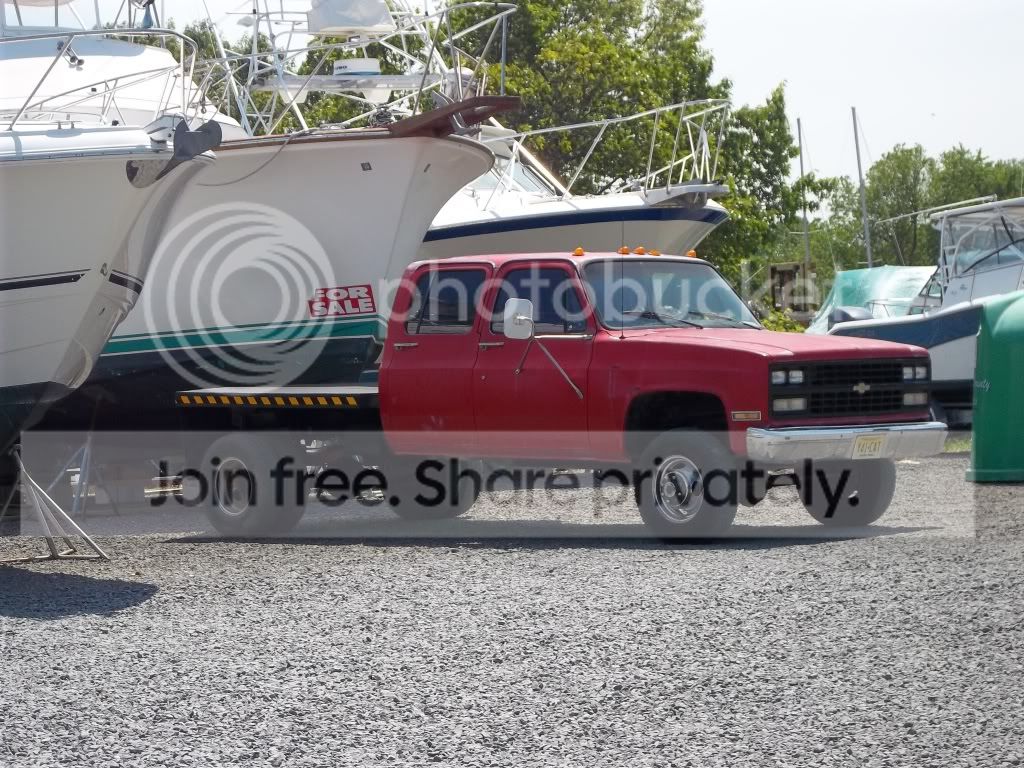

the Mutt looks right at home in a marina.... ;)
it actually doesn't ride that horrible in the back... could use improvement for sure, but i was expecting MUCH worse with that spring pack in there....
Love it man! That thing just LOOKS like it wants to work:waytogo:
