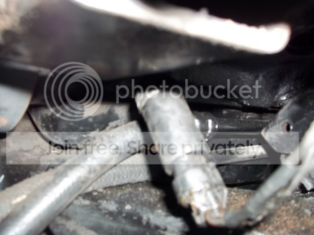

all moot at this point cuz I lost fuel late last night when i went to fire it after pulling the ac compressor temporarily.... hate that sh*t, do one thing and something unrelated comes up...
does anyone have an idea what this sending unit is? it's the only thing I was remotely near, and it's wires are melted, have bare spots, and the plug is all f*cked up...
it's down at the front ds of the block... 1/8 npt.. looks just like an oil pressure alarm, but a with a long black plastic tube coming off it... it's got a 3 wire plug running to it... never seen one up front before... at first i thought it might be a crank trigger... but now I think it's a low oil pressure fuel cutoff...
I'm pretty sure you are right, I remember my dad having to change his a few years ago
Yea, Oil pressure. The reason it has three wires is that it also is a fuel pump relay override. So if the truck looses oil pressure it will shut the motor off. Also if the relay fails, the truck will continue to run.
cool, thanks... yeah, got it today.. there are 2 different ones, gauge or idjit light... got a new one and replacement plug/pigtail today...

well, that was about as easy and cheap a fix as it gets.. those wires shorted and it blew the ECM fuse... now I can get back to my regularly planned mayhem...
