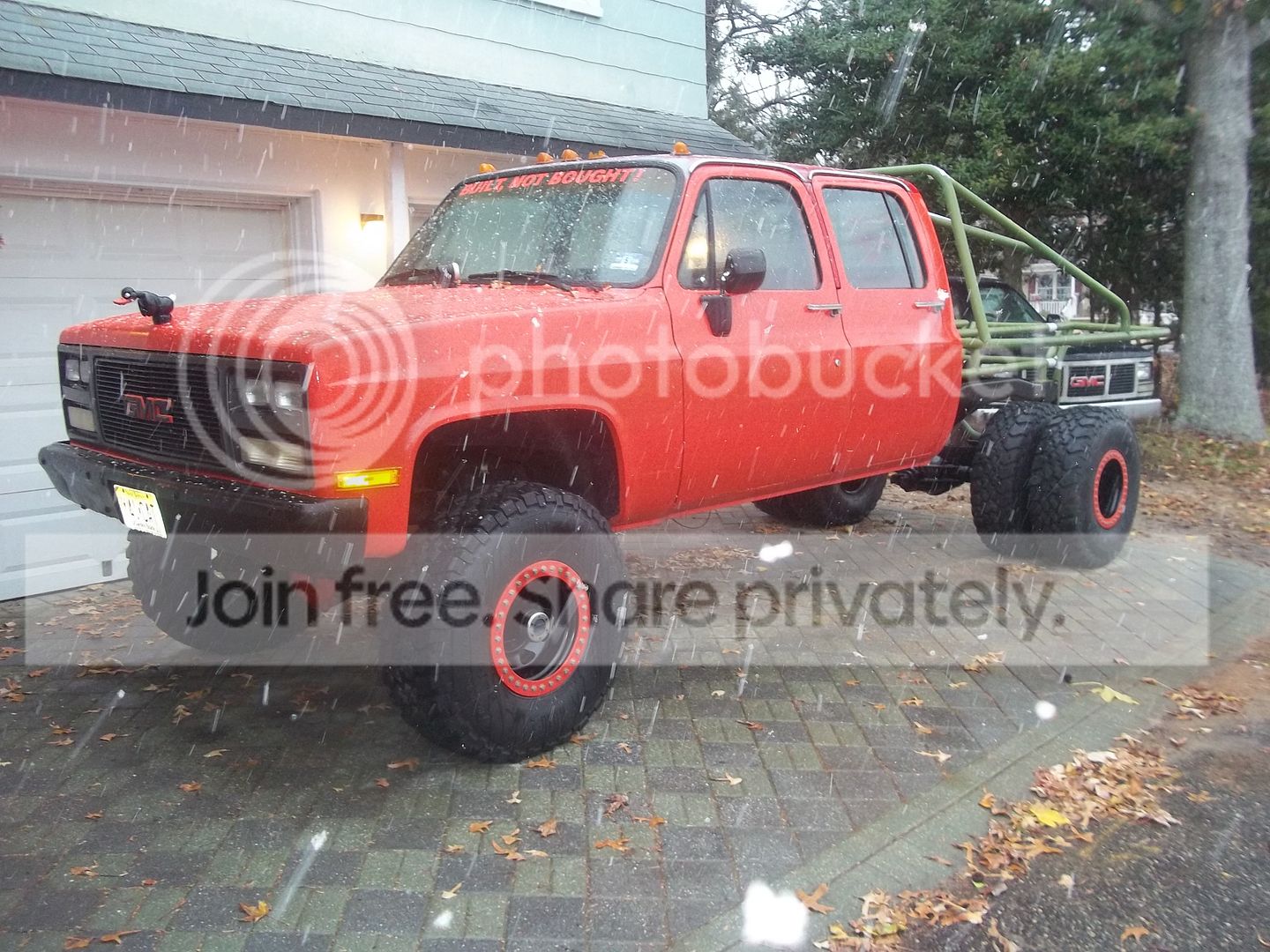

WOW!!! Haven't looked in here in a while. I DIG the crew cab Paul. Tube bed Looks AWESOME! You're NOT making it easy to get rid of my crewcab seeing this :doah:. I really do not want to AT ALL. Maybe I don't have to now :whistle: :D. Hehehe
with the black and aluminum on the bed that's gonna be one of the sweetest flat beds ive ever seen........ I can see it in my minds eye well and :bow: so jealous
thanks mang... glad someone else see's it too... :haha:
I think the rims/meat/beef add's some great proportion to the tubebed.. :pimp:
stooopid thing is, I haven't even talked to the toolbox company yet.. I don't know if all 6 boxes are gonna be $1700, or $2900eleventynine smackers... :doah: :haha:
I'm hoping that it's gonna be 2500 or less...
Looks great.
Rear axle forward? Looks good where it is IMO.
The only thing I was going to say was I would like to see the front axle forward a touch. Not sure on the rear axle but I am sure you have good reason to do so.
So I need full resolution pics e mailed to me. :bow: Also can anyone lend me some time and a babysitter so I can get to work on mine :D
as I've mentioned, with the tubebed design, I'm running into possible mudflap issues... dragging on the meats... forward is good... throw in the queen mary turning radius too...
and yeah, I definitely wanna bump the front forward, so that just adds to the WB issue and another confirmation to move the back one up...
tho, I am going to get back to the tubebed now and get the lower 1.5" tubes done to confirm the mudflap deal... that will let me know how badly I need to move the axle..
I probably wont bump the front up till spring/summer when I'm driving it..

Good job getting it all done before the snow! Great timing. So, is it drivable again now? I mean all the suspension and drivetrain hooked back up?
nah... I could get it back up relatively quickly.. but I'm not gonna bother till march/april-ish..
main thing is I'm gonna temporarily run the ps saddle tank till I get my custom center one made later in the summer.. and I really don't want to install that just yet, to keep good access for the tubebed stuff/fab..
the other things it needs are the frame hardline and soft drop brake line for the rear redone.. rear shaft put back in (may need to shorten if I move the axle forward)
needs the back shocks done too... and a muffler.. tho that's kinda a secondary thing at this point..
Yeah, I knew you didn't plan on driving it until spring, but I was just curious from a practical standpoint how far away from being drivable it was.
It sure does look good though. :)
thanks man... :D
I'm just VERY glad to have it back as a roller... just looks better in front of the house.. the rig is actually reg'd and insured.. i'll do the lines and see about ordering a muffler, etc as time fit's over the winter... shocks I'll prolly do pretty soon, prolly around when I get the gooseneck plate in...
not that my neighbors would ever complain.. but I do rent, and the town does complain if ya have too much cr@p kicking around...
they actually complained to my landlord years ago about my yard looking like "Sanford & Son" :haha:
I thought that was kinda unprofessional... :whistle:
do that today, and you'd be declared a racist!!! :popcorn: :haha:
