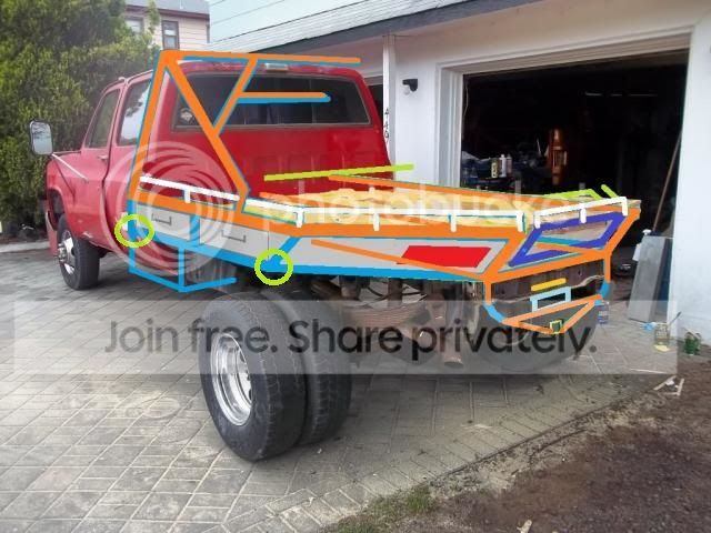

made a short test bend today and realized that smaller CLR wont work... when it's directly below the 2" with a 6" CLR, the "point" of the 90 sticks way further out... looks stooooooopid...
tho smaller, that tube needs to maintain the same radius as the larger above tube, centered below it... at the front 90, and the angle bend at the back...
these 2 spots..

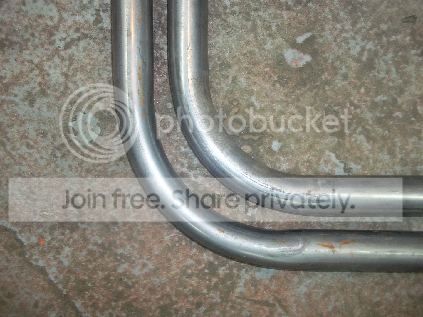

running 1.5" thru the 2" complete die is a fail pretty much... first you could NEVER due a multibend piece...
you also have to space up the following block to keep it in line with the die.. it has crazy springback, to the point that it's difficult to get the next "notch" in..
doesn't seem to hurt the die/block tho..
I did get one fully bent 90.. it flattens it out and deforms it too much for my taste...
the pic actually looks better than it looks in person to me...

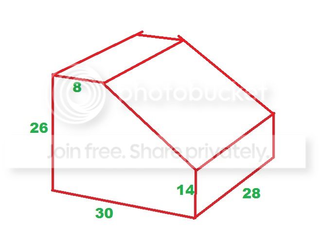

than figured out the final fuel tank size....
wow... around 72 gallons... :eek1: cool...
here's a quickie drawing of the dimensions..
I think that tank, fully loaded, will weigh as much as my girlfriend's car (that's almost 600 pounds of fuel, never mind the metal) :haha:
