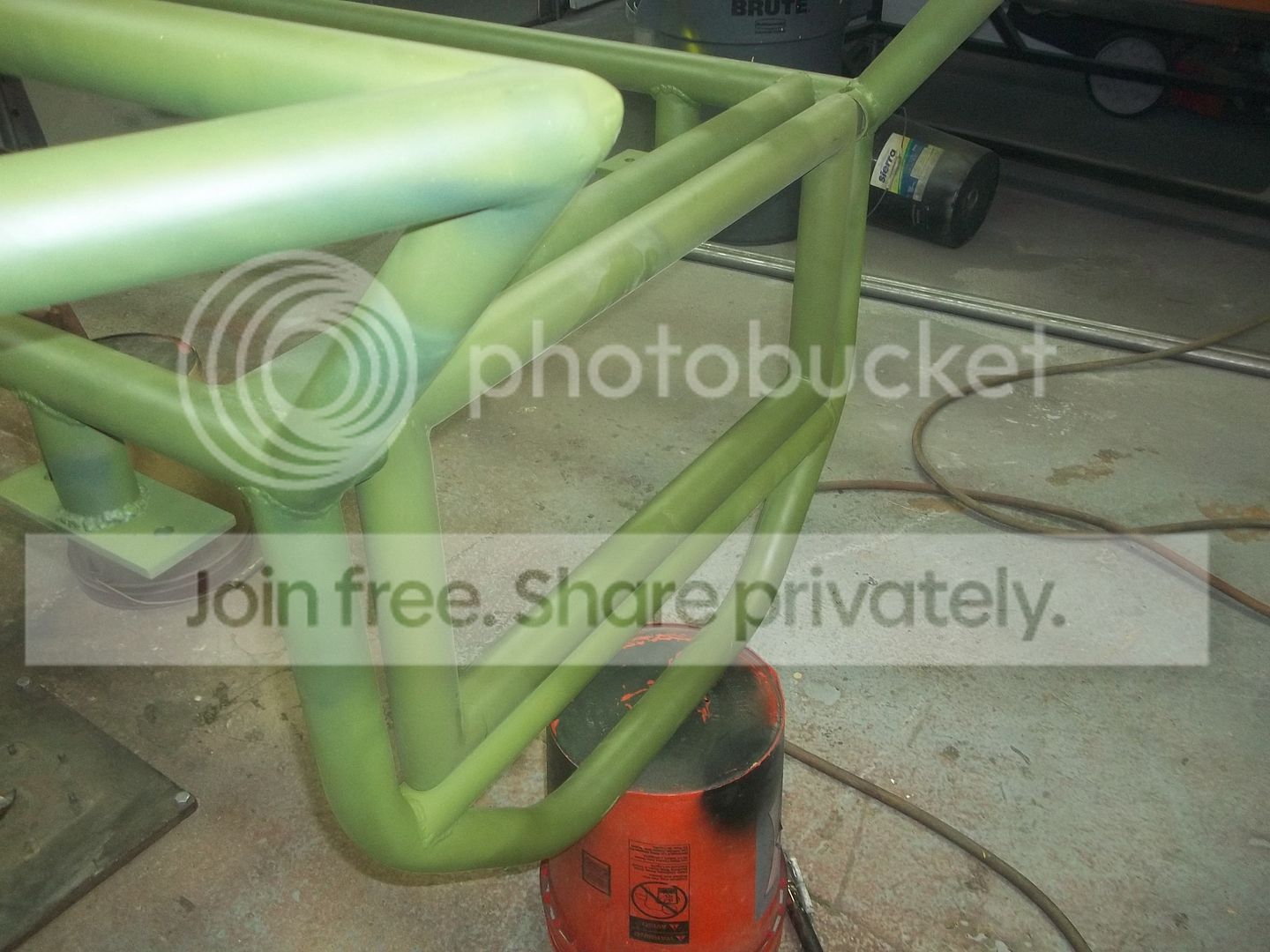

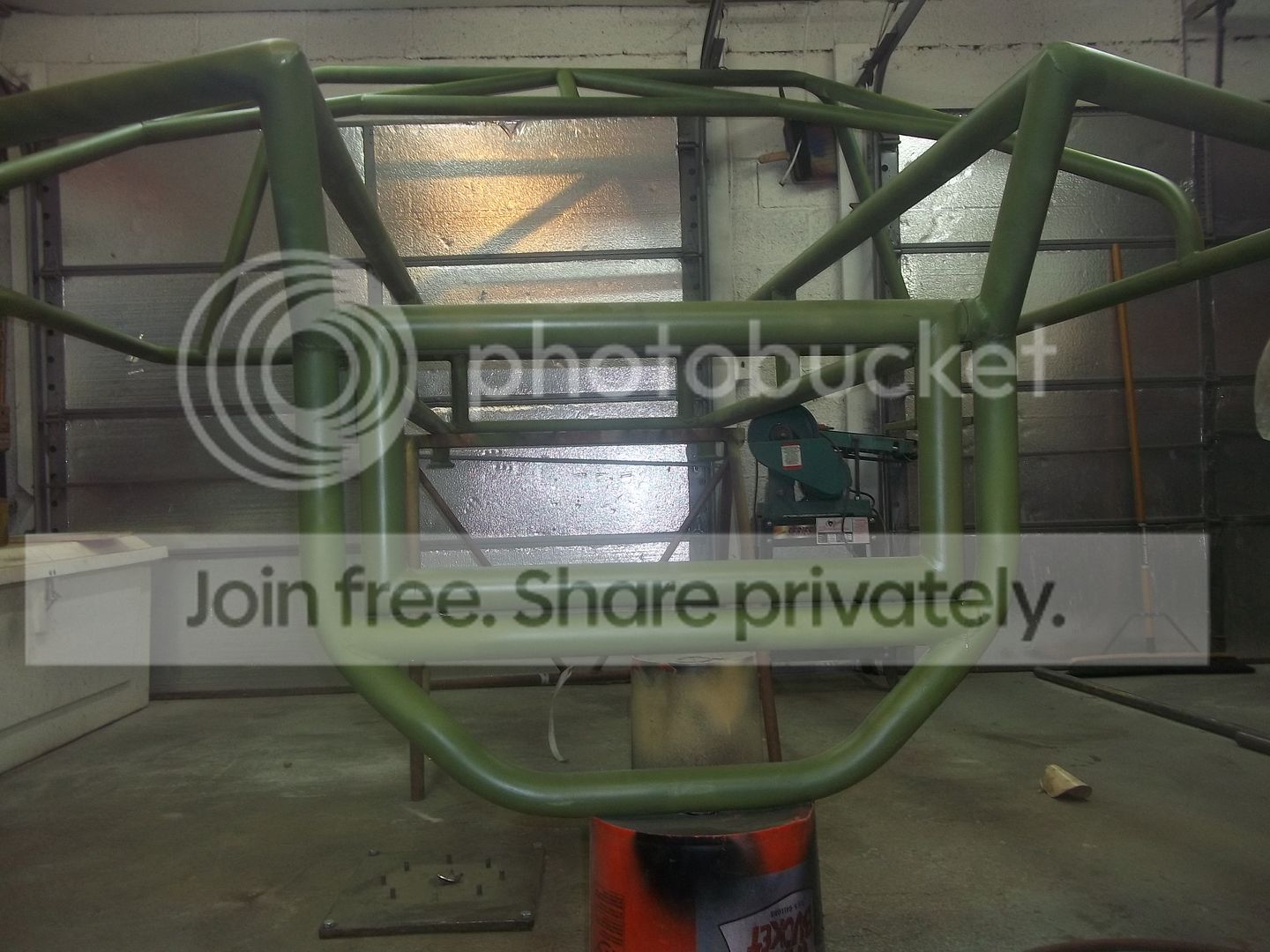

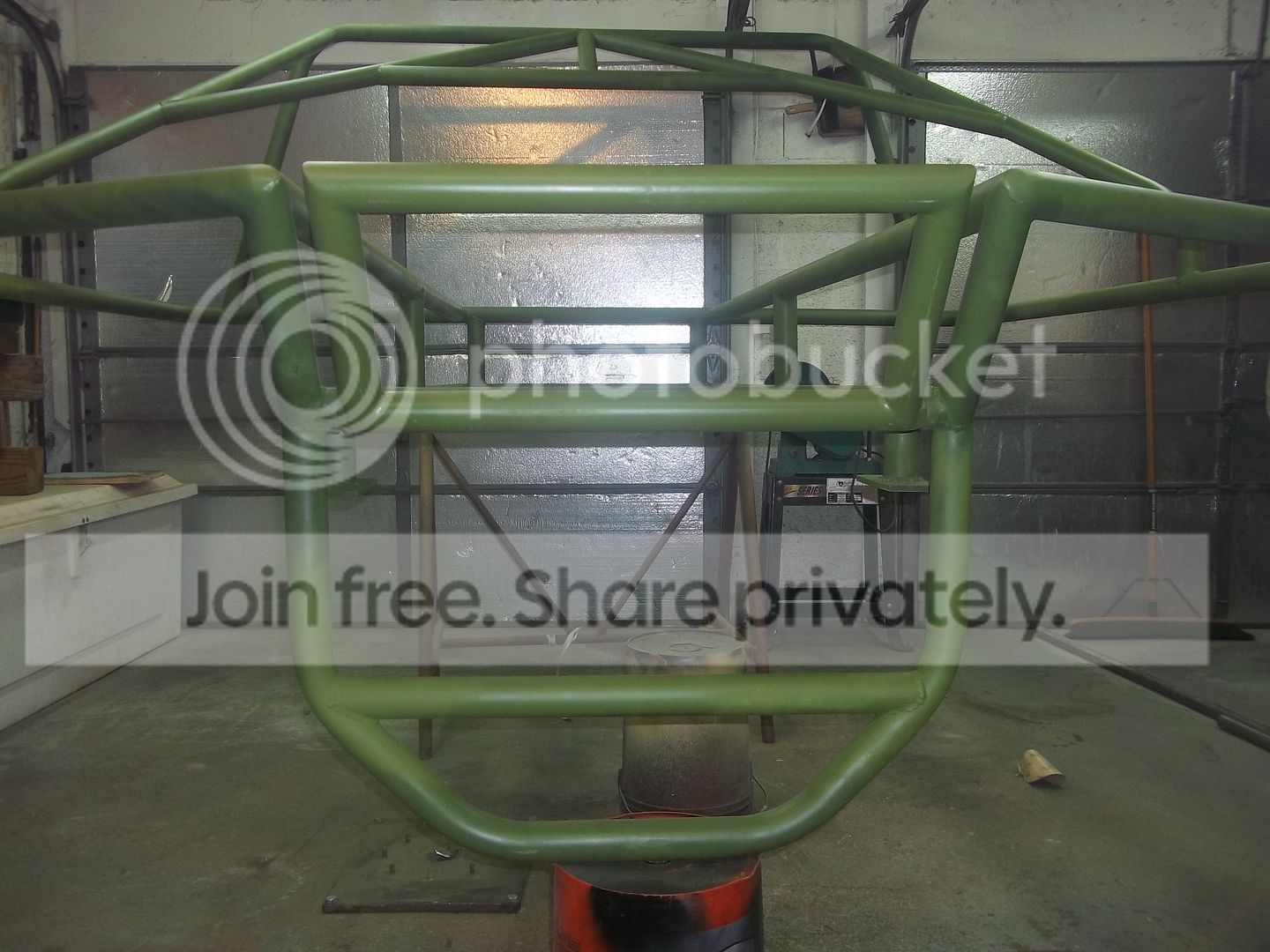

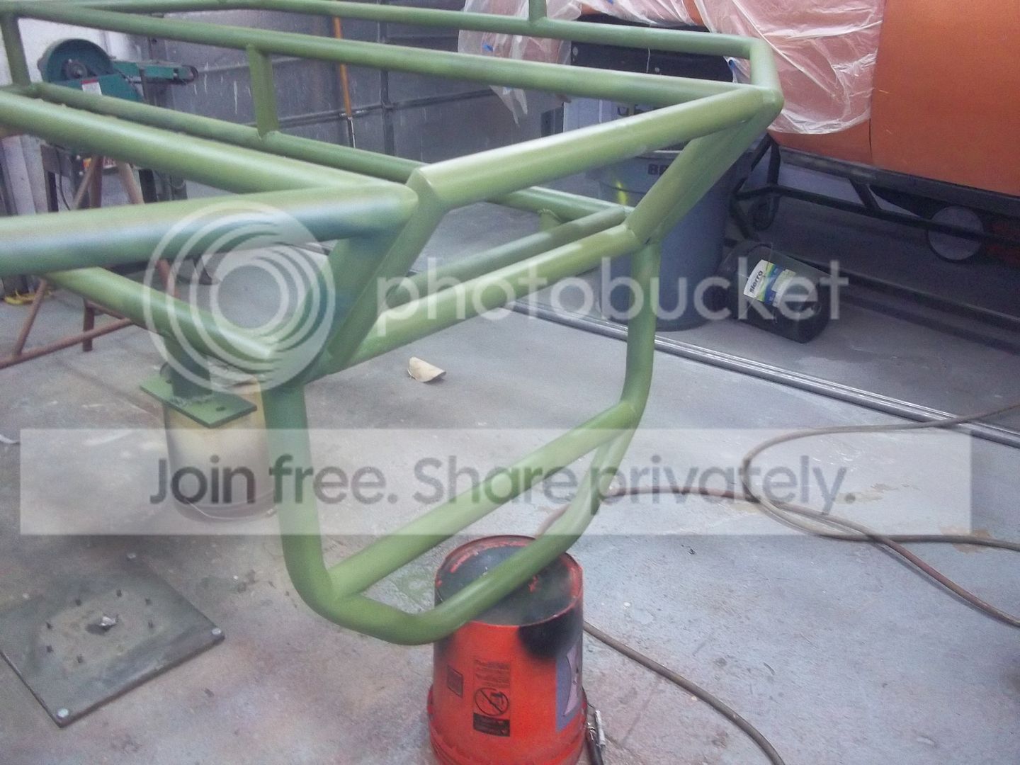

added that lower rear tube today...
and with the tubegate down...
gonna see about getting that die I need in sometime next week.... I think what I'm gonna do is start fitting up the 1.5 lower stuff with just a couple tacks here and there... if I need to cut em off to get it out the door, easy peezy to put it back together and finish weld it outside..

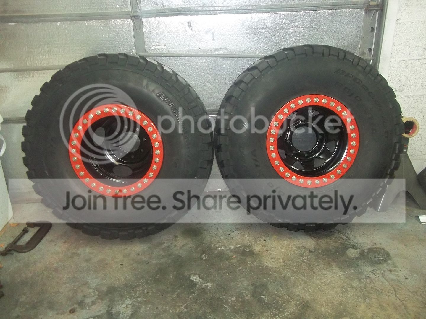

also ordered up stuff I need for the spare tire mount.... btw... does anyone recognize what my front rim might be? pro comp, American, etc? 16.5 x 10.. forget the bs at the moment...
one on the right..
I thought it was a pro comp, but it has 8 windows, not 10...
Only eleventy billion companies made those D window steelies.
Any markings on them?
eh, I don't know, they're out mounted on Mutt in the POURING rain at the moment.... :haha:
when I pull one off to mock up the spare tire mount, i'll inspect it closer... it doesn't have to be exact, but I wouldn't mind it... I'd want to add the simulock too it at some point, prolly # 67 on the to-do list......

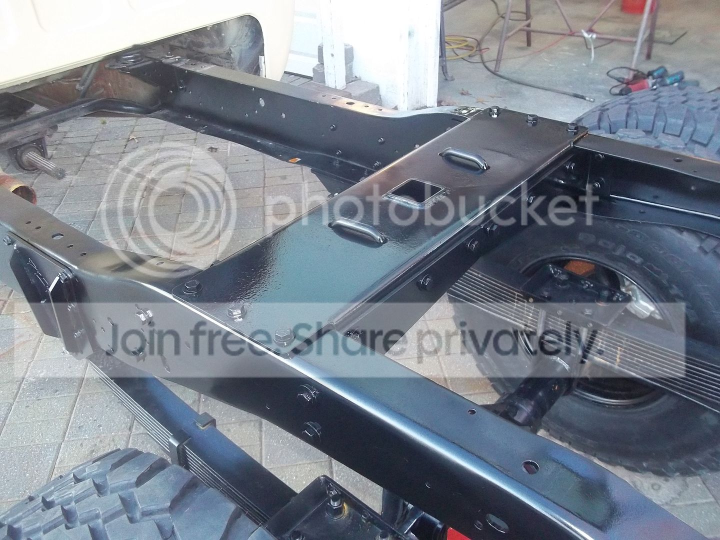

boy, my Milwaukee 1/2" drill is getting a workout on Mutt these days... 14 more 1/2" holes in the frame today.... :haha:
ignore the gloss, I just douched it, needs to flatten/dry..
hardware is 14 1/2" fine thread with heavy washers and pinchnuts to the frame, and 26 all together....
the 6 up top where easy peezy, just stand on top and use my fatarse like a drillpress.. it was the 8 on the sides that kicked my nads a bit... :haha:
