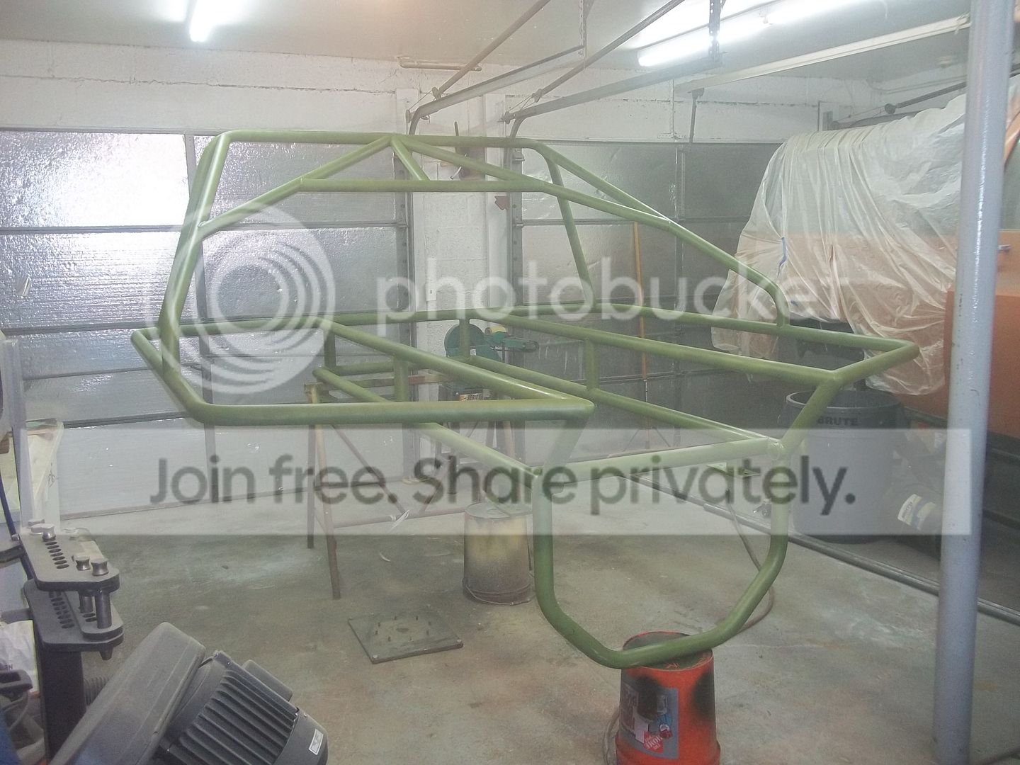

some actual Mutt stuff.. well, hopefully I can get some stuff done the next couple days.. the need for that other die kinda thru me for a loop... so I changed things up a bit till I can get that and decided to pull the bed and do some work on it in the Lab™ .....
have to actually angle it to get it in the door, too wide...
so i'll spend a couple days and do some finish welding, add that tube up by the spare... if it's decent outside I can see about getting the gooseneck plate mounted up...
technically I could probably do the lower toolbox tubes with the bed off.. but considering I can't use the bender with it in there, I'll probably remount the bed in a couple weeks when I get the die in...

well, after flipping this thing over a few times by myself in the shop for finish welding and such....
I'd "guess" the current weight to be about 300 lb's... I can dead lift it off the ground, but barely... flipping it over is an adventure... :haha:
one issue I did not foresee is that I had one of the guys from work stop over to get it off the truck and into the garage.. that was NOT easy as you need to angle it to get it thru the door...
but now that we're going on layoff, it's gonna be more difficult to get peeps over here... tho I may have my bosses stop by on the way home from the boat factory.. more on that in a sec...
with 3 people it would be easy and not get all scraped up... gonna be a week or so till I'm ready to put it back on the rig.. I'm REALLY not sure if I can/could do it with the engine hoist by myself.. or at all.. it's conceivable, but it'll be an undertaking for sure.. i'll see what happens...

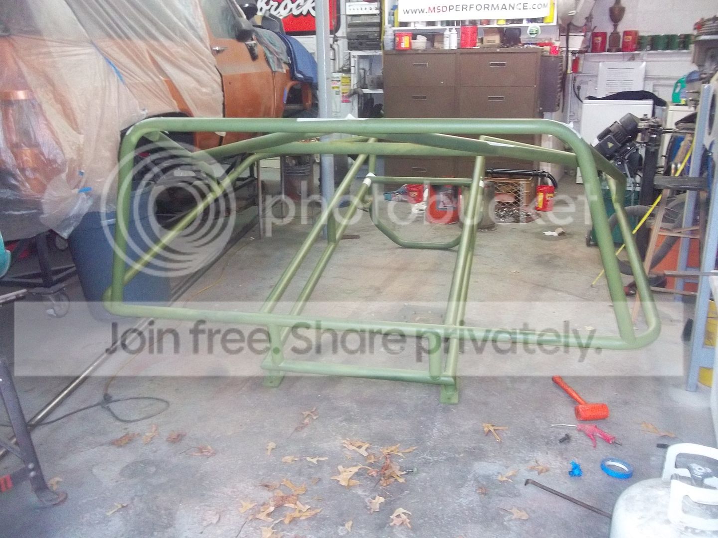

oh, and duh.. huge post and I forgot the bed pic...
added the center spare support.. everything is finish welded, joints blasted and a fresh coat of Liberator green on it.. ready to go back out for the next installment of tube, tabs and goodness...
hopefully weds, I'll get the gooseneck bolted to the frame...

and actually, if I end up waiting on some help to get the bed back out, I'll prolly put that x-bar on the back tube section below the tubegate that I was talking about.. not a big project, but something I can do inside..
I think some creative use of "cribbing" and an engine hoist should allow you to man handle it pretty easily.
it's more the boom length, to get to a centered lift point.. which more than likely is gonna need to be thru the "C' hoop... not a big deal, till you go to set it on the truck..
I'll probably see about draggin my bosses over, they owe me their souls anyway... :deal:
I was going to suggest an engine hoist and some straps. It'd probably be easy if you if you put that center bar in so you have a centrally located lift spot.
