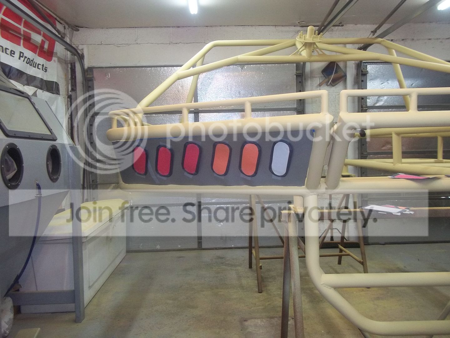

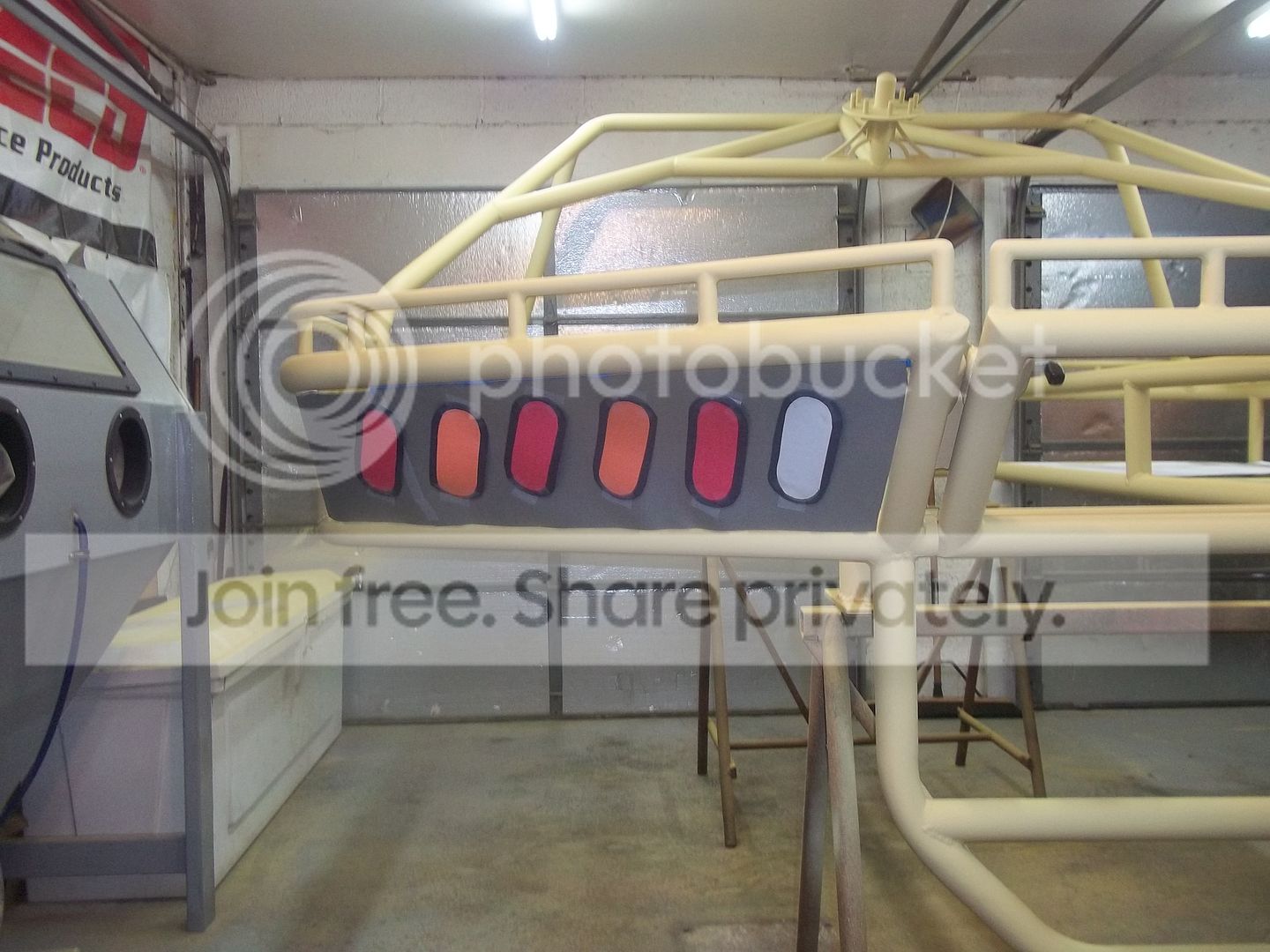

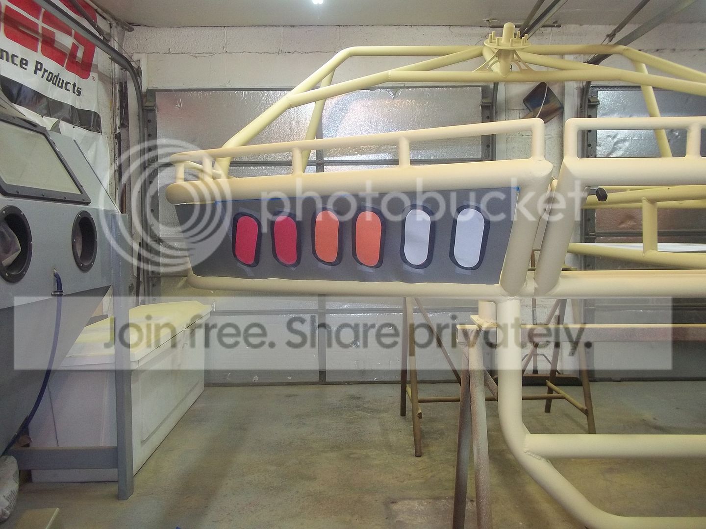

it does look better the other way.... color progressing..
maybe I'll sacrifice what I think is safer, for what looks better...
I like the angled look. If you think it's safer to have blinkers on the outside, then put the two yellows in between the reds. I think it will look good either way though, nice work.
funny you say that.. yeah, something like left to right.. red, orange, red, orange, red, white.. I thought of that.. I may take some pics of it today.. but for as much as I like the idea, I don't.... my mind says it would confuse the issue... but I'll do some pics today and see what I think of it.. thanks.. :D

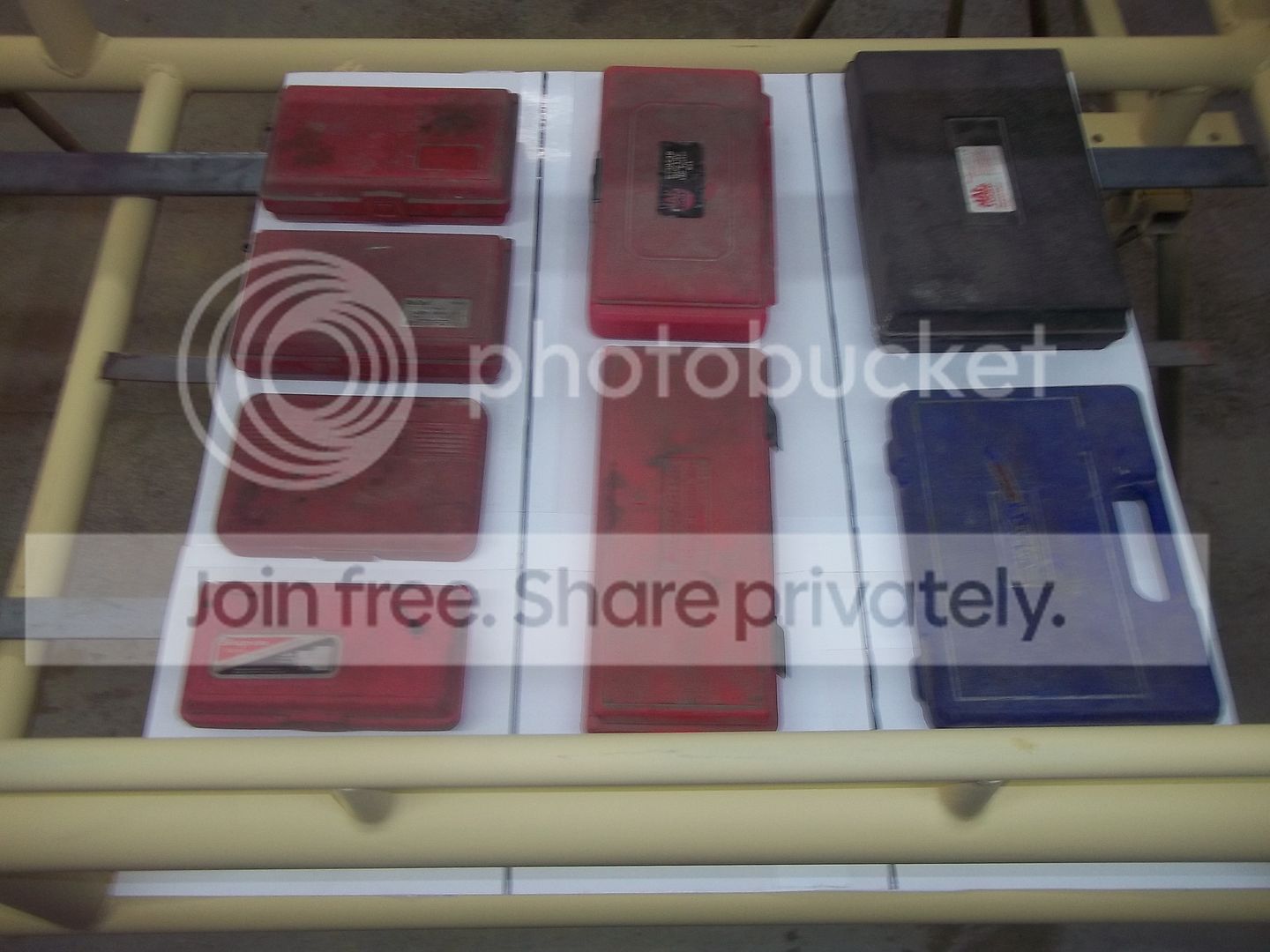

ok... some drawer setup stuff... :pimp:
the plan is to keep this as simple as possible and do 2, and 2, to keep the price down as best as possible...
the first pair of drawers, which btw, I'll be splitting up 1 per side, will just have 3 long compartments...
like this...
they will be full height dividers..... obviously one side will be for stacked plastic cases... the other side will have one compartment for long prybars, screwdrivers, straight edges, etc... than the other 2 will be for cordless tool stuff...

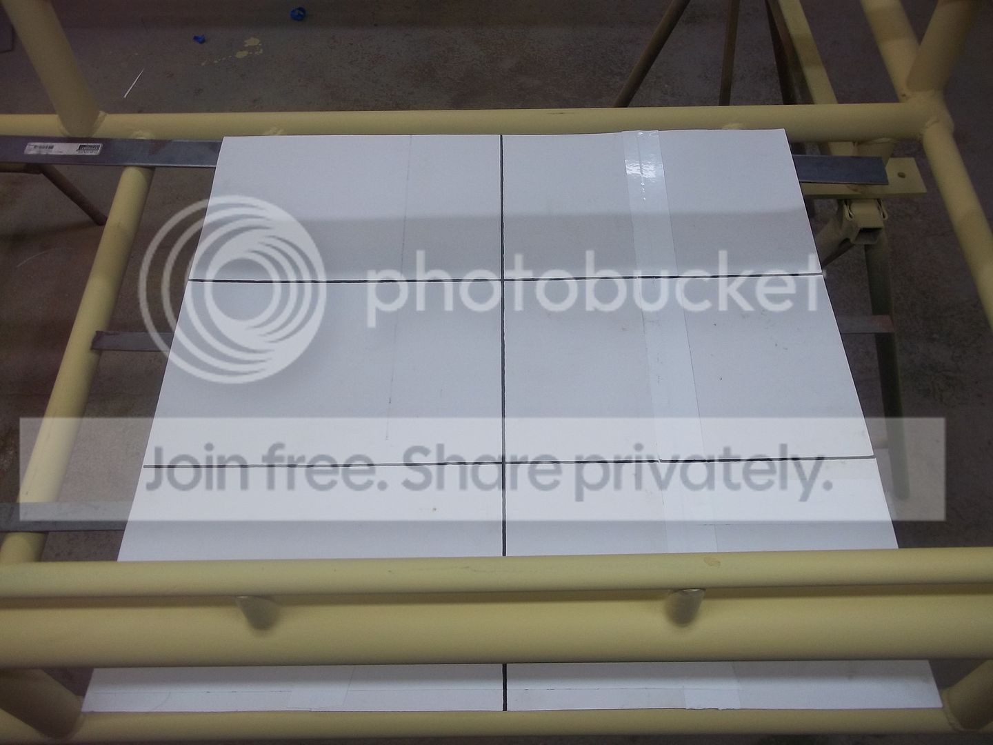

the other 2 drawers will be 6 compartments, with slightly lower, 4 or 5" high walls.. one of these will be for magnetic socket trays, wrenches, screwdrivers, pliers, handtools, etc..
the other will be for misc hardware and parts....
setup like this probably...

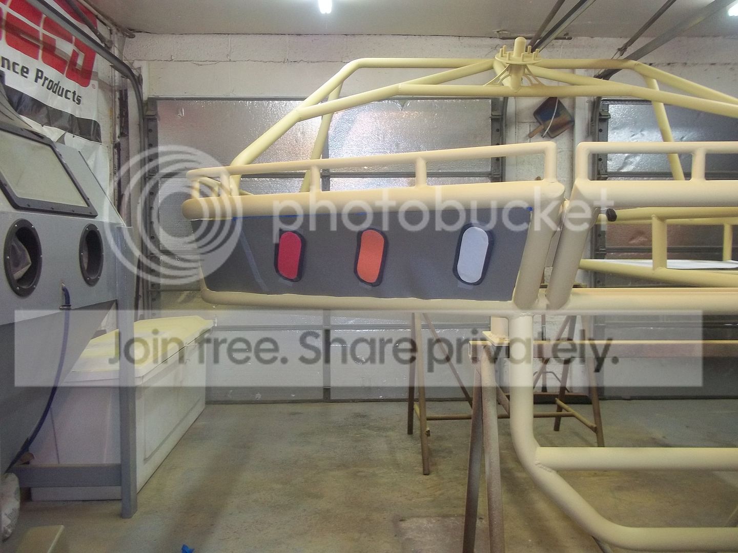

To me that is too many lights. I like the look of the three square lights better.
If you do go with all those lights above, I would like to see those wired up with a sequence turn signal. Like a mustang.
I just can't see doing sequential lights... if it was a whole series of reds next to the white, with no ambers, absolutely... but it doesn't make any sense here with just 2 ambers being the turns...
nope....
ghey.....

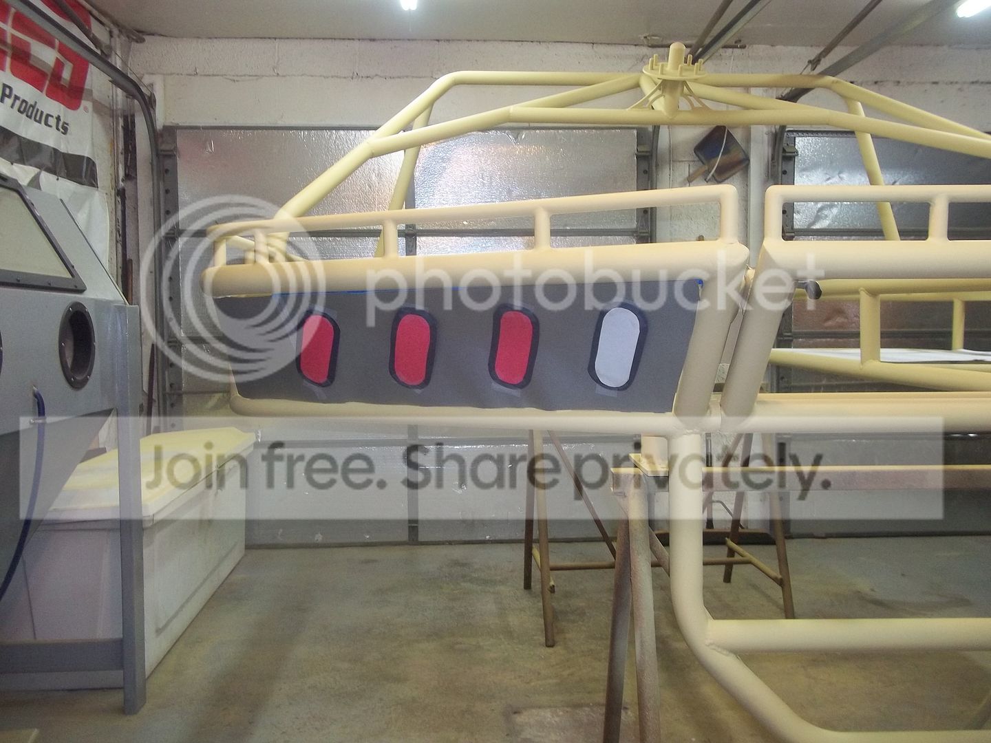

if I should decide to wuss out on the 6 light amber deal, this is what I would go with...
How about a 2/2/2 setup with a pair of red, pair of amber, and pair of reverse lights per side? It'd look pretty symmetrical that way. And lots of reverse lighting is nice to have
#3 2/2/2 I agree the more backup light the better. Just think if you are baking to a trailer or some project in late afternoon it's nice to see how close you can get the "workbench" to it. Also with the angle of the bed the light will be thrown more to the sides. In which case the poor bastage in the lane next to you is gonna get lit up.....
One a side note, I love how the other members think about other build through the day and give good input and resources for each others projects.
tho #3 looks good.. as I mentioned earlier, reverse lights to me, aren't that important.. that may become more important down the road if I start hauling boats around, but I also figure I can just as easily flip the floodlights on for trailer hookups...
it's more important to me that the "proportions of lighting" while daily driving make it "other car friendly".. the 3 park/tails do that.. that's more important to me.. this is "congested as fock, we drive like idjits" joysey after all...
I'm in a #1, or #4, if I feel #1 is a "bit much" category...
another thing to keep in mind here guys is, that it is a swappable format... it's more a question of how many...
