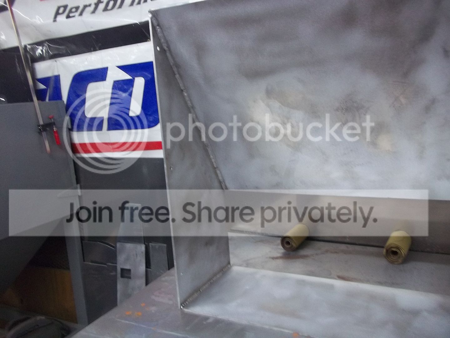

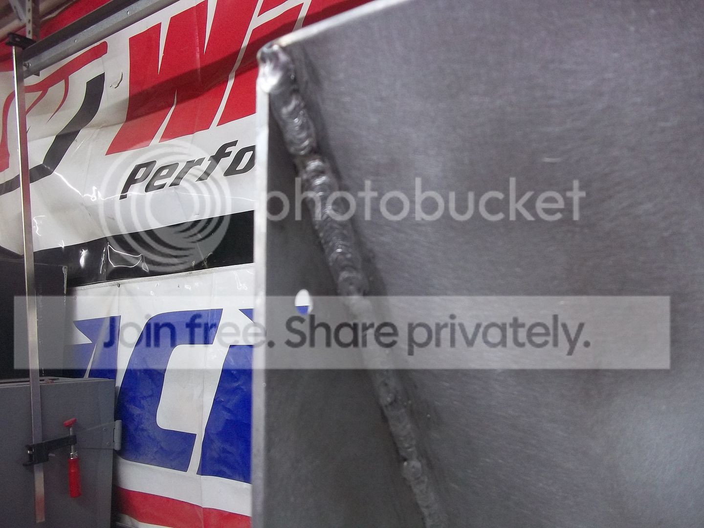

my first Al beads... be nice..... :haha:
need some contact tips for next weekend... I backburned the 2 I had...

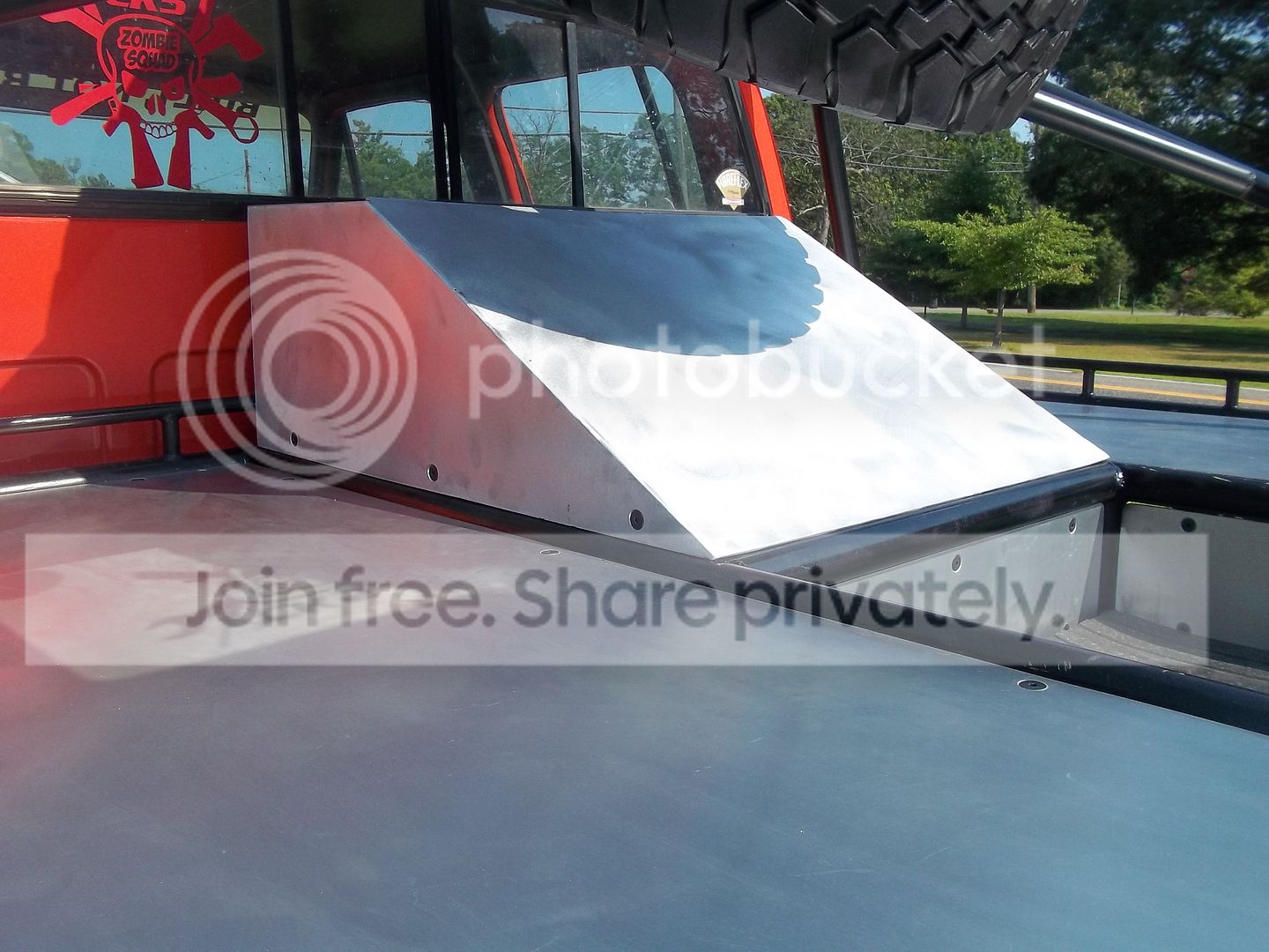

and for now.... a roughed in doghouse... just initial sanded with 150.... didn't get to the frame or lid done...
I'll get to that next weekend... and start making the recessed fill "boxes"... get the doors in, yada...
