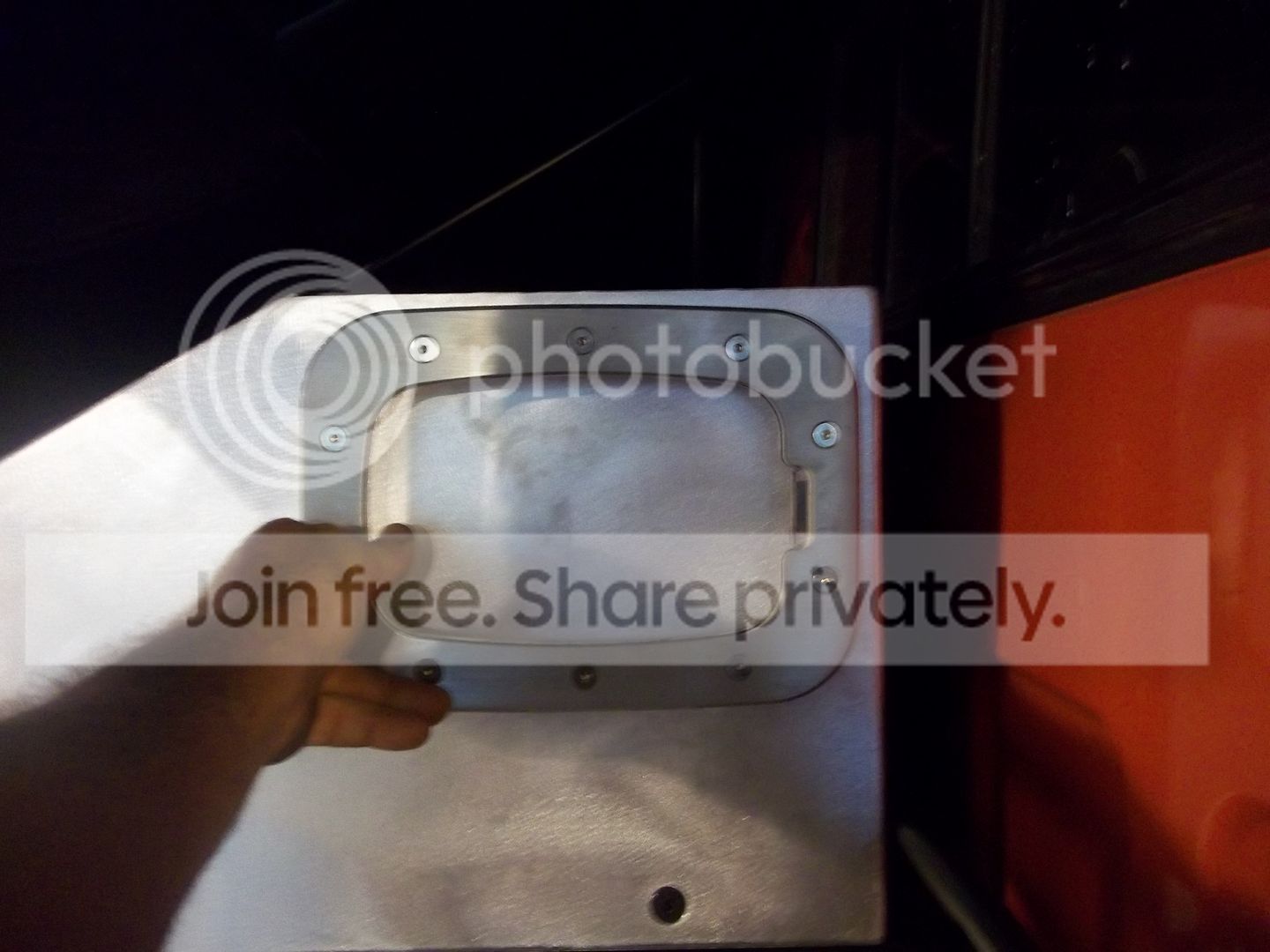

here's a bourbon-infested shot of 1/2" exposed.... excuse da blur... ;)
Either way the space looks good be it 1.5 or .5" with the fuel door not being perfectly square with on the corners like the doghouse it looks good with that bit of room atleast in my opinion
Are those allen screws real mounting screws or just visual? If they're mounting screws, will there be room on the backside for nuts or whatever you're going to fasten it with?
Josh
they are visual.. shallow tapped. there are 4 #10 studs that come out at the corners that go thru the 1/4" alum... thus why it's kinda "stood off" in the photos....
I'm leaning toward option 3 at this point...
so it shall be...
