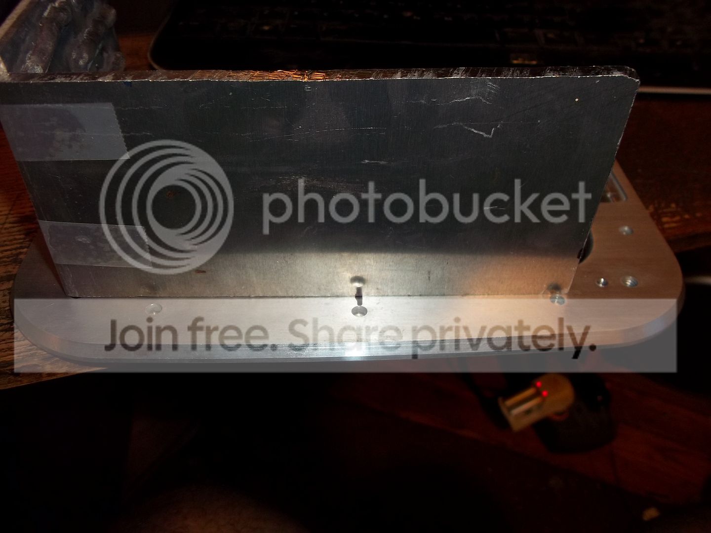

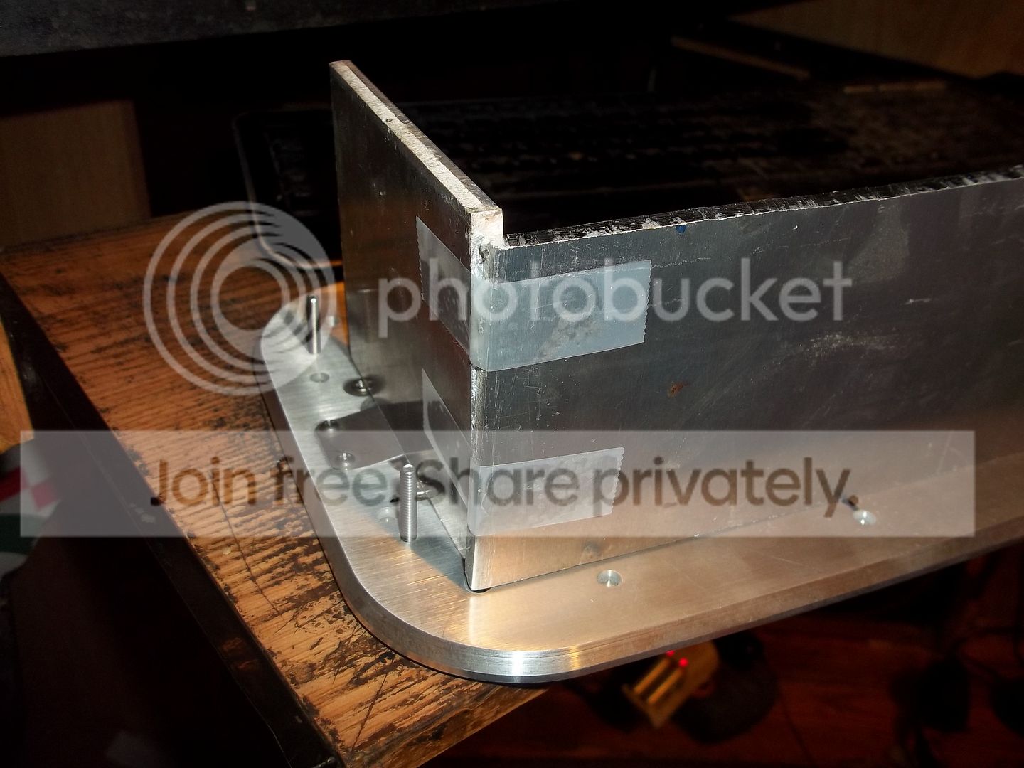

Are those allen screws real mounting screws or just visual? If they're mounting screws, will there be room on the backside for nuts or whatever you're going to fasten it with?
Josh
well, throw all this out the window! :haha: :doah: :popcorn:
while 2 of the small chincy #8 studs are usable at one end
the 2 at the other end, are not... you can see where the little hole was for it was at the corner, right inline with the box wall.......
it looks like I can barely swap out the 2 hex allens at each end, and the one in the middle on the longsides, and put longer ones in and use them as studs.. more beef too....
oh, and I forgot.. I'm actually changing all of the allens (2 different lengths), for black SS.. like the rest of the tube bed...

still waiting on Mig tips, sanding belts and the other door.. but most of the hardware is here and the most important parts, the fills are here...
the green dizzle caps came free with the necks... i'll throw em in the parts bin and put on some black gas ones till I do 6BT......
looks like the recess boxes will be about 2.5" deep or so... If I can have all the alum welding/fitting done this weekend, happy, joy, joy...
oh, and just build babble... I'll actually be mounting that neck flange on the backside of the 1/4" Al of the box..... neck sticking thru... keeps the package as shallow as possible.. and will just look better..
than I'm gonna run 6 of the same smaller 1/4" - 20 black countersunks as the top hatch and gas door, and use them to attach the neck.. so it'll be the cap with all alum behind it.. and the 6 black countersunks in the alum around that...
