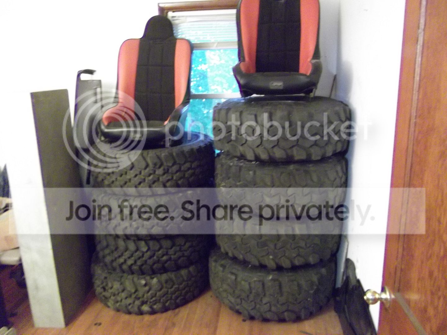

And why are you hording tires! :thumb:
with the Baja's seeming to go away pretty quick from surplus supplies, I wanted to pick up some more to rotate in as needed.. to be honest, I'd love to pick up another 4 or so over the next yr, if I can still find em in the spring/summer...

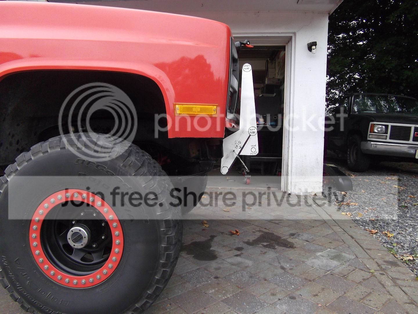

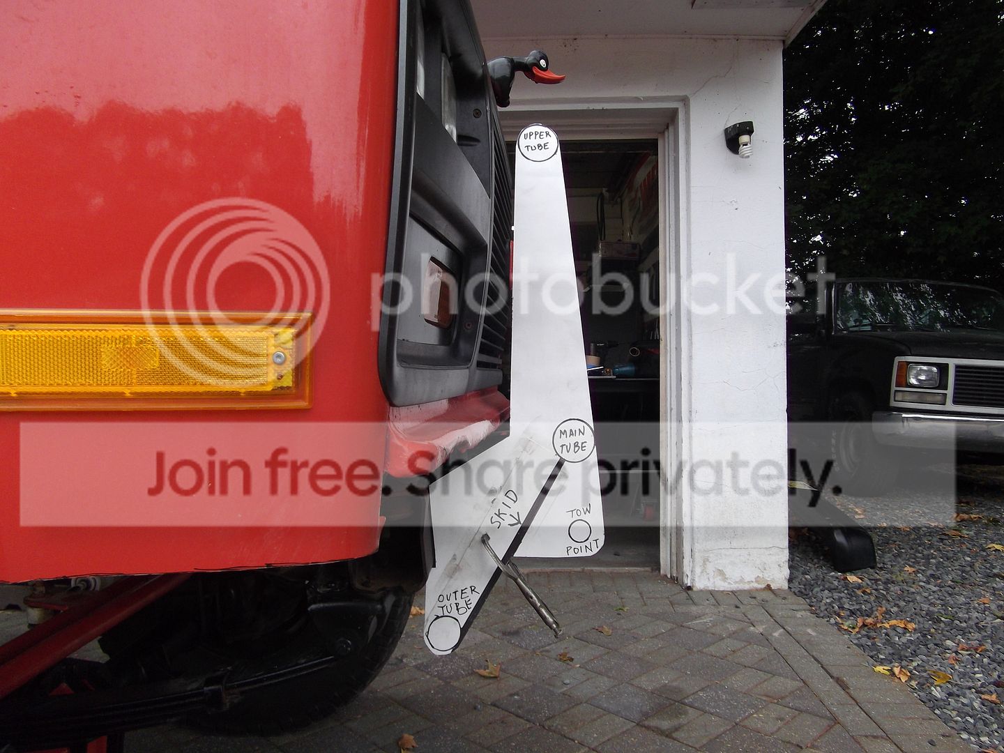

got my final outer template for the uprights done.... this is just the outer 3/8 plate... the mirrored one that will sandwich the frame horn will basically be the same, except down by the rail...
they will sandwich a slightly smaller one that will be 3/16 to make up the frame thickness.... so each upright will be 15/16 thick....
and here you can see the turn signal plate...
the outer angled supports, above the main tube, will wrap around the fender corner like the K5, and they will tie into the uprights about an inch, maybe 2, below where that upper, middle tube will go across...
what are you going to do to finish the sharp edge of the "fang" where you cut it?
That's going to look good.
I have high hopes for it... :D

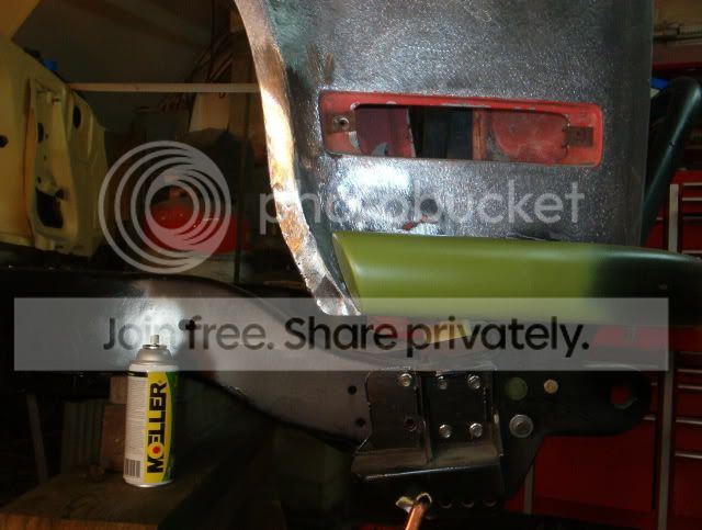

I'm gonna plate the bottom with 1/8" to give it some beef.. kinda like I did with the back of the K5 ones...
the bottom will be flat, but I'm thinking of reworking the back corner so it's kinda like the K5... but instead of somewhat rounded like this.
I'll start it where that rounds, but just do a super tight turn, than have it straight the last couple inches... to match the angle of the cut bumper tube....

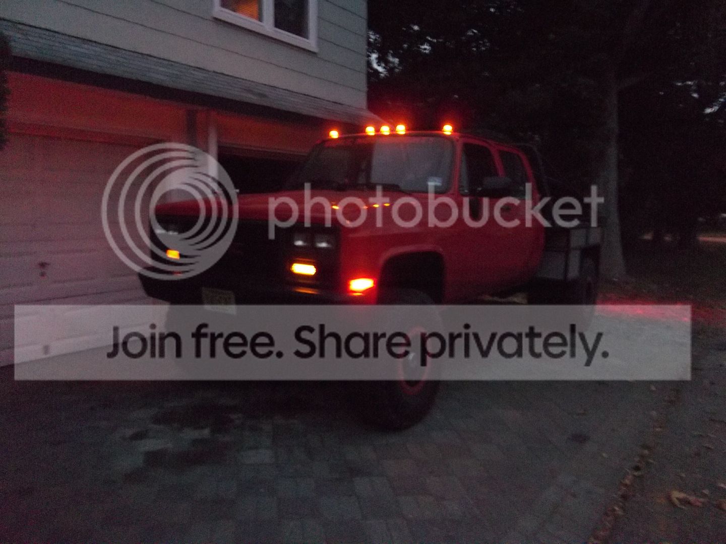

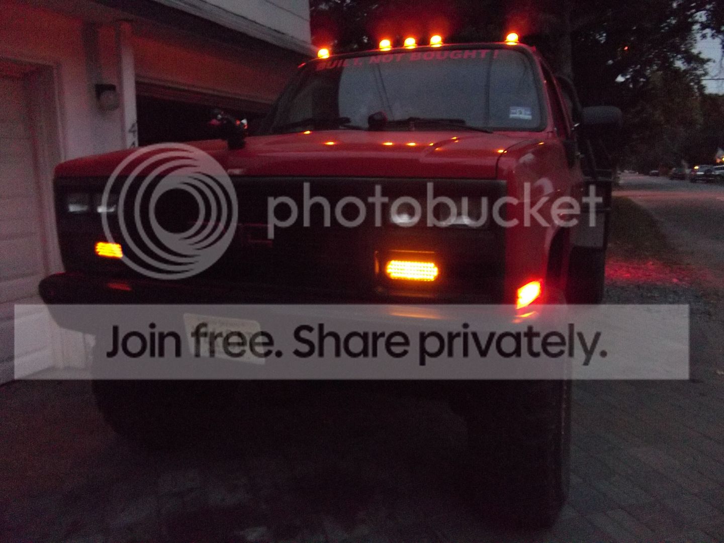

some better dusk shots........
the new LED's for the side markers and roof lights should be here tomorrow or tues... so these will make good comparison shots....
and a quick clip of the slower blinkers with the now installed adjustable flasher.... I think it's pretty "right on the money", maybe just a tad slow...
