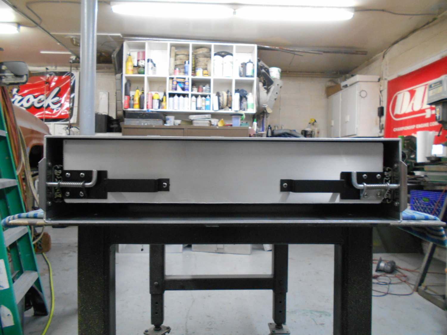

so, I like my initial thought...... satin black handles, brackets and do the hardware in black ss too...
the right bracket/spring assembly is just a clean one to see how it looks with the silver bracket...

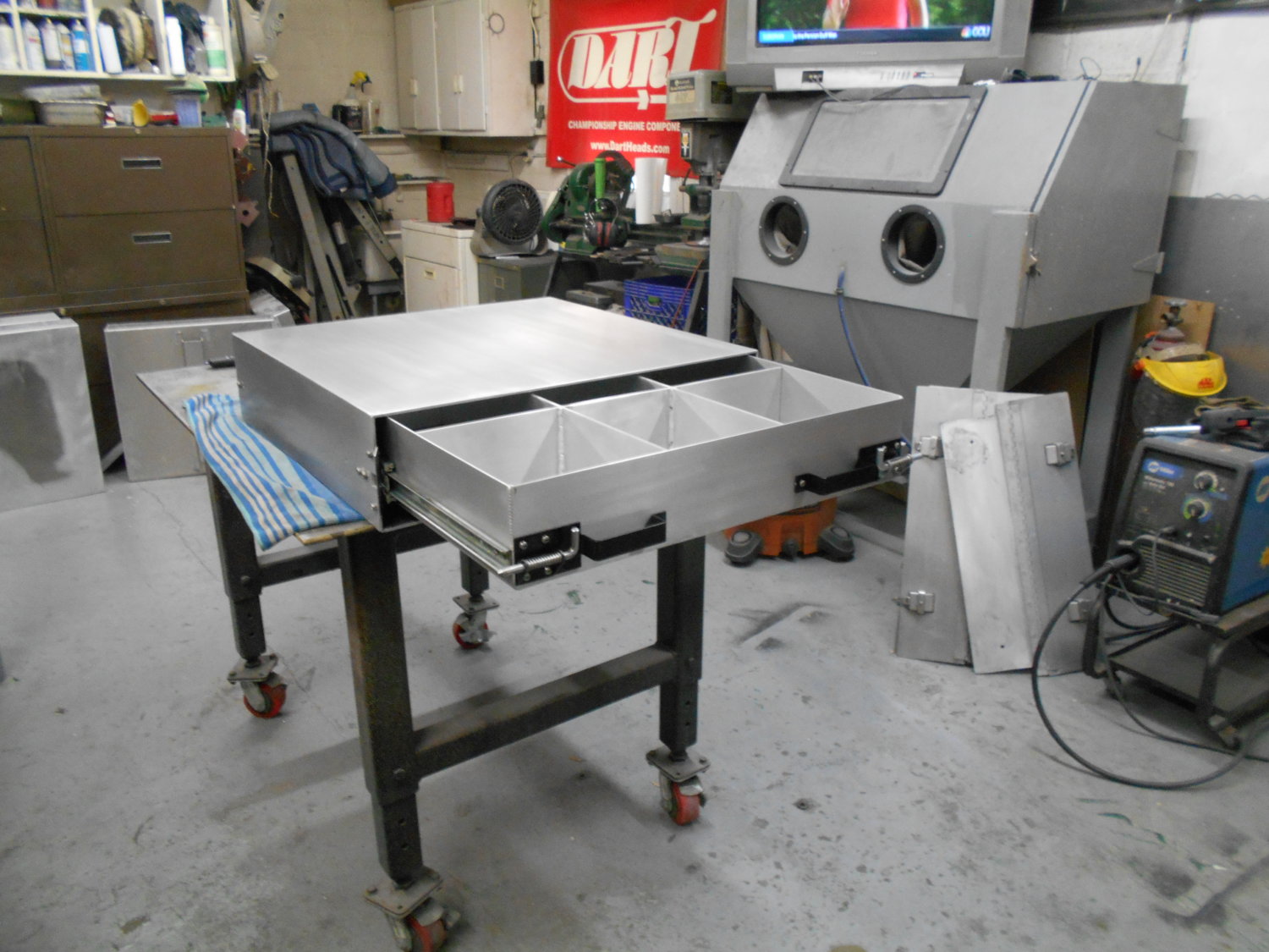

full
full
i also found out the spring latches all face one way on the brackets.. one is up, one is down, but when ya disassemble em, you can put em either way... ;)
stock..
full
I'd use duracoat and/or durabake on the latches. If it holds up to the friction and chemicals that gun slides encounter, it should hold up to a little rubbing and road grime.

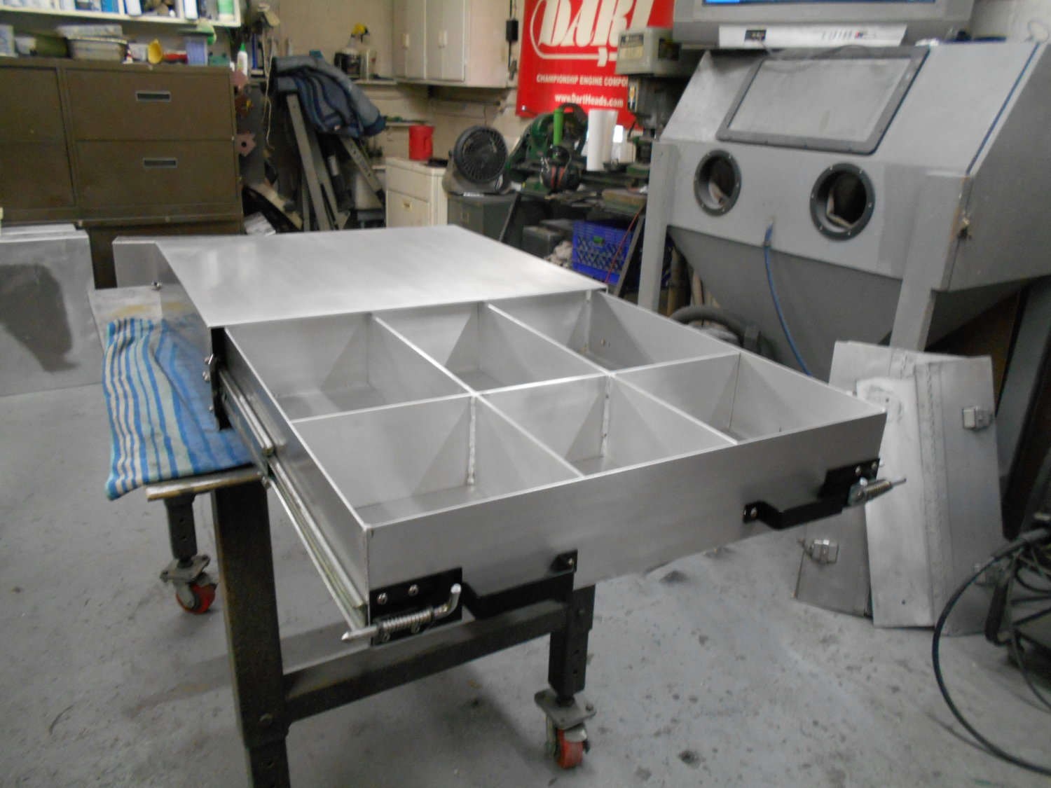

oh, and that divider ended up being fine just slid in there.. doesn't move at all... unfortunately the other 2 will require a tack of some sort...
tomorrow I'll wire brush the welds and Sharkhide it...

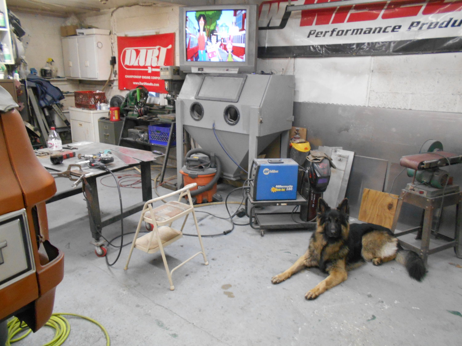

well, my fatarse finally broke the wood bar stool I had, so I had to switch my fab table to dwarven-mode and use this step stool....... ;) 1 hole from the lowest..

need to find a metal bar stool with a butt cushion... but I don't have a hundy to splurge on that...
Nooooo......not above the blast cabinet.....unless you enjoy watching dirty movies..:whistle:
OMG, that freakin freebie TV weighs like 250 lb's.. no joke.... I had to roll it up/down my stairs end over end, and it still worked... i really need to upgrade upstairs and bring the 42" flat down there...
gonna have to get the neighbor to come help me again getting it down before i roll it into the dumpster... ;)
luv having Roku down there.... cranking youtube vids, skate vids, etc..
